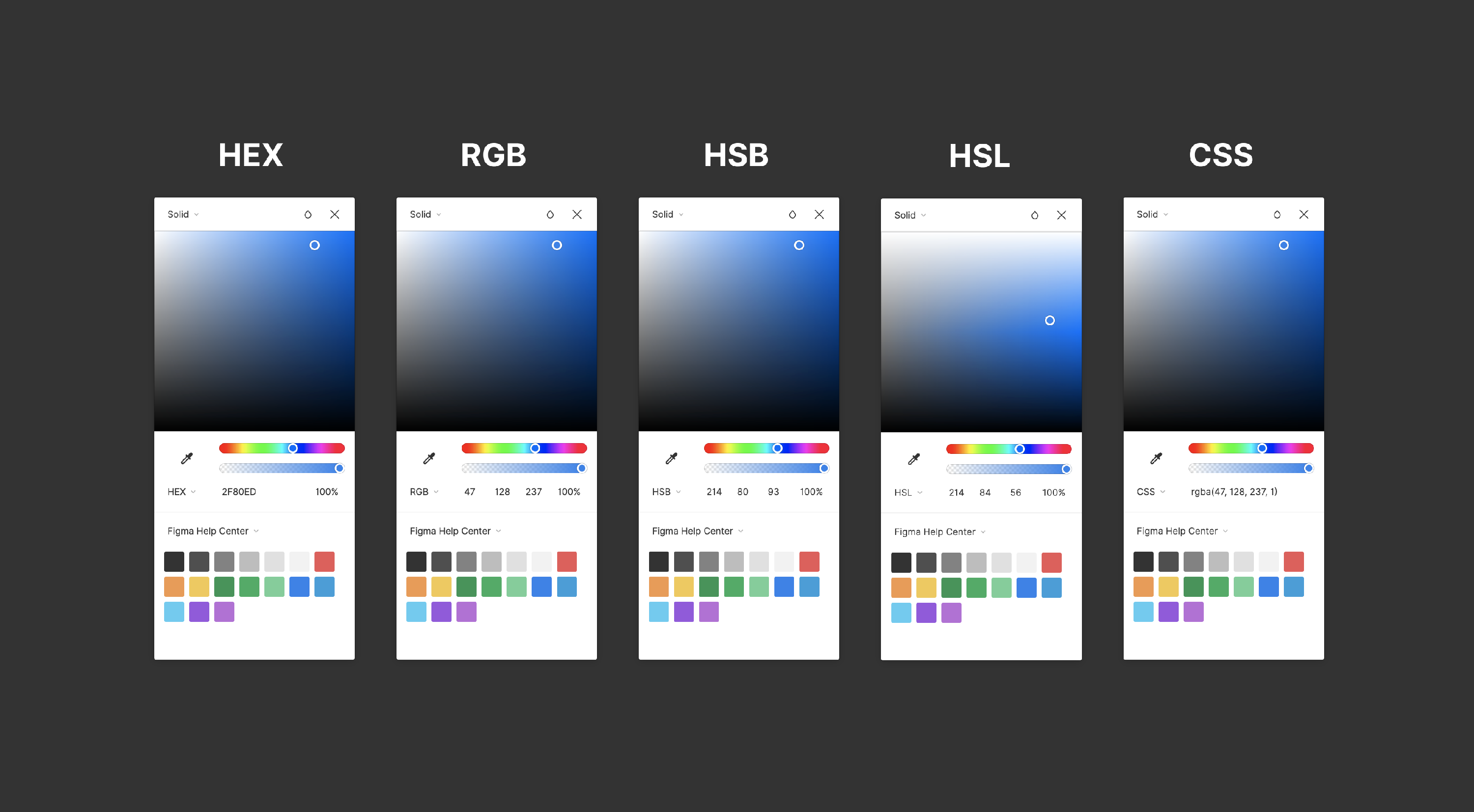

    Check out the following diagram for a full tour of the Color Picker:
  3. In the top-left corner, you can determine if you would like a Solid color, a Gradient (Linear, Radial, Angular or Diamond), or if you would like to use an Image as a Fill instead.
  4. On the top-right corner, you can click the Droplet icon to choose the Blending mode. Learn more about Blending Modes.
  5. You then have the main Color Picker, which shows you the current color of the selected object - indicated by the white circle - surrounded by any related tints, tones and shades. Click and drag on the white circle to adjust the color.
  6. Underneath, you will see some more information about the color profile.
  7. On the left-hand side, the Eyedropper tool allows you to select any color from an image or object in the canvas (Learn more below).
  8. The top slider allows you to adjust the color's Hue - click and drag (left or right) to adjust.
    Tip! You can also use your mouse-wheel or trackpad to scroll along the slider.
  9. The bottom slider allows you to adjust the selected color's Opacity.
    Tip! You can hold down the [Alt] (Windows) or [Option] (Mac) key while scrolling to set the Opacity.
  10. Below the sliders you will see a few different values. This details the selected color's specific values, across a variety of color profiles. Click the drop down next to the value to switch between RGB, HEX, CSS and HSB.

  • RGB or Red Green Blue is the most commonly used color profile. Every color that is rendered on a monitor or screen will be made up of varying amounts of Red Green and Blue. You may have also heard of RGBa. The A in RGBa stands for the Alpha channel, which represents the Opacity of the color (from 100% to 0%).
  • HEX is the default color profile in Figma and refers to the Hexadecimal color. This is an alphanumeric shorthand representative of the RGB values. “Hexcodes” are commonly used by designers and developers in web, or digital design.CSS will give you the CSS friendly format of the currently selected color. You can then copy and paste this directly into a stylesheet, formatting included.
  • HSB: Hue Saturation Brightness is an alternative representation of the RGB model. This is based around how the human eye perceives color, versus how a display would (in RGB).All color profiles will have an additional Alpha channel (or value), which represents the Opacity of the color. This ranges from 100% - 0%.
  • HSL: Hue Saturation Luminance is another color space that is modelled around how the human eye perceives color. Like HSB, it is an alternative representation of the RGB model. The main difference between HSB and HSL is how saturation and lightness are treated.
