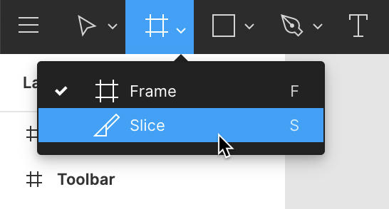

Using the Slice Tool
The Slice Tool is also found under the Region Tool dropdown in the toolbar.
