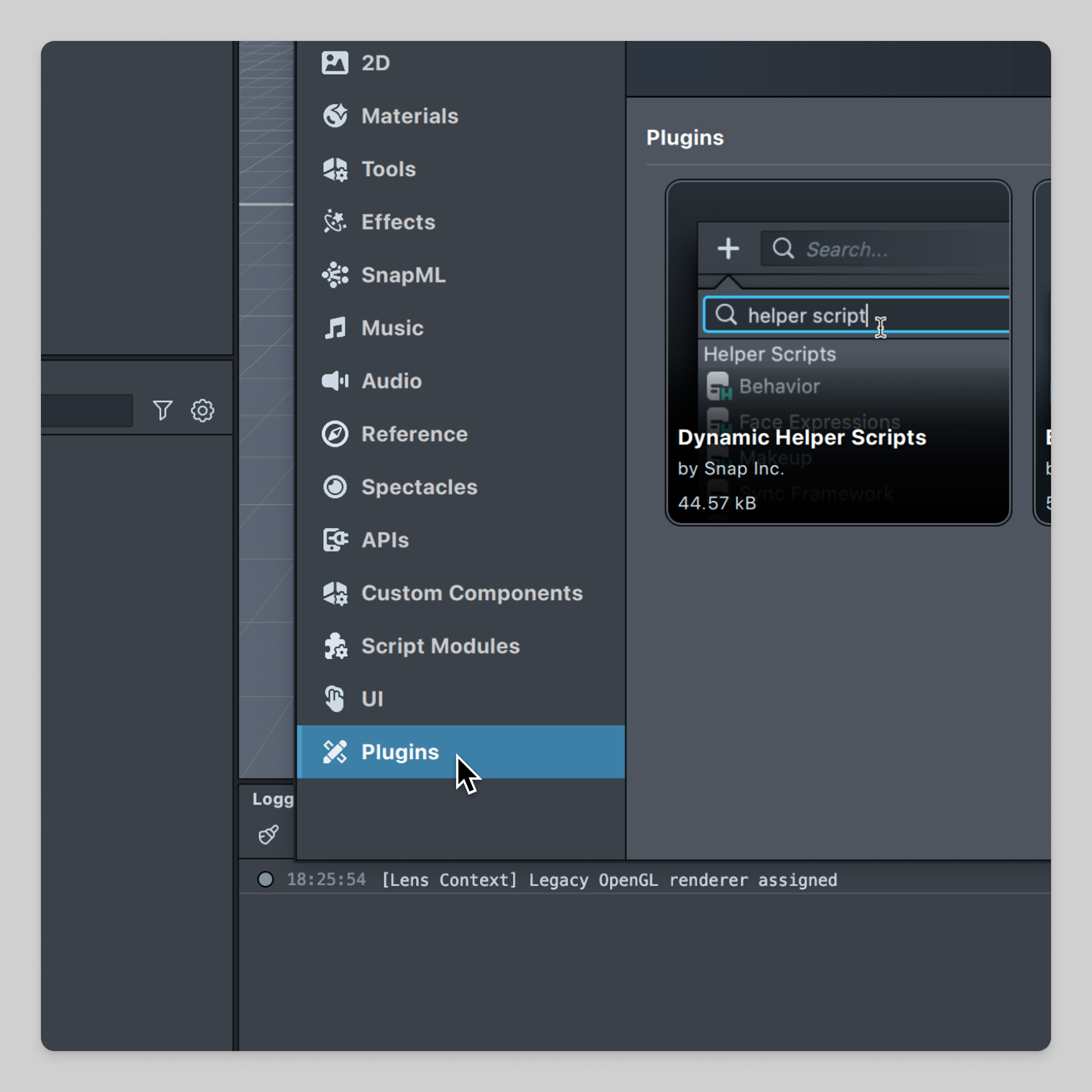

1. In Lens Studio, go to the Asset Library and then choose the Plugin category.
2. Locate the Figma Importer Plugin and click on it to install.

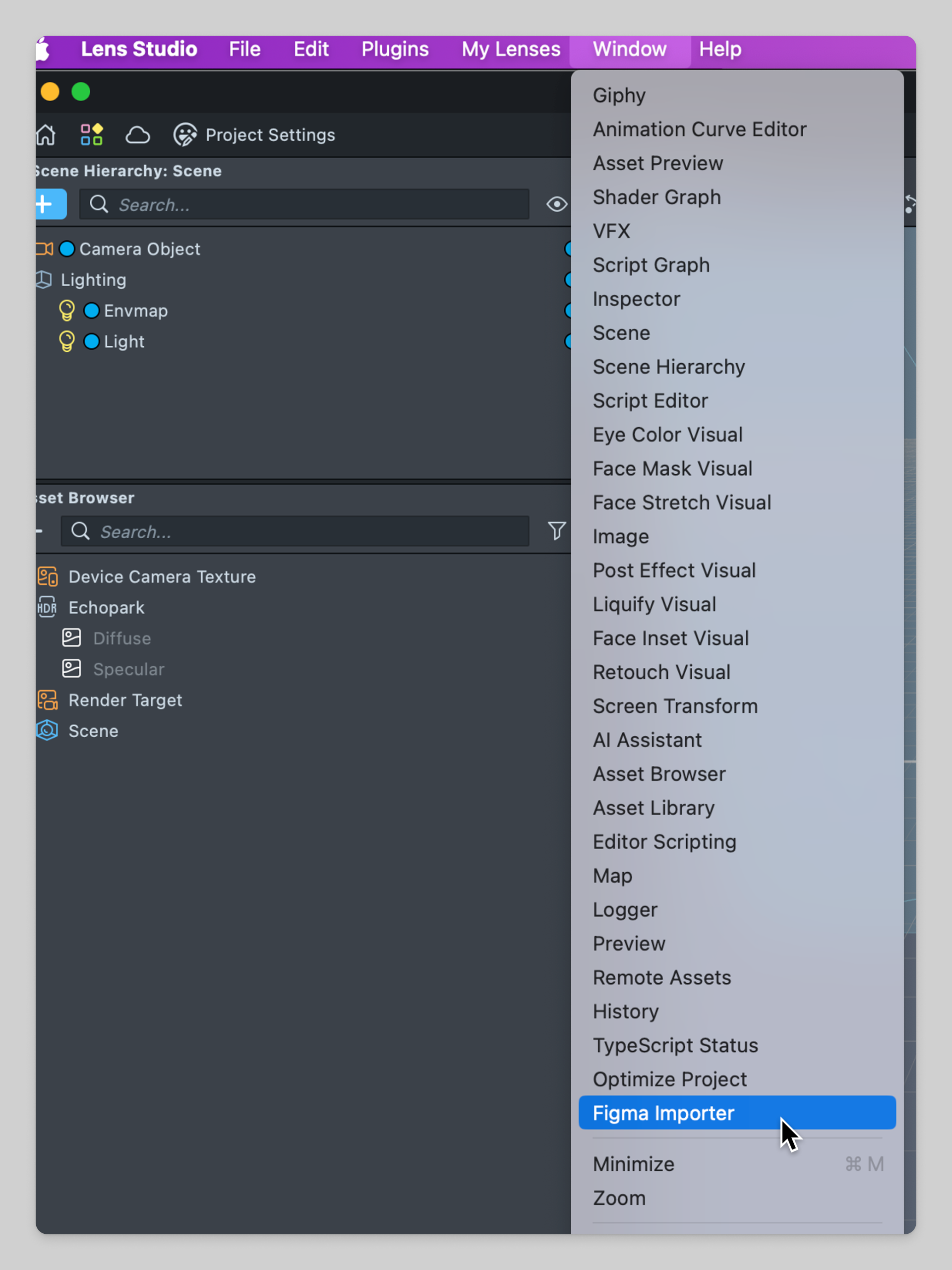

3. Access the Figma Plugin panel by navigating to Window and then selecting Figma Importer.
