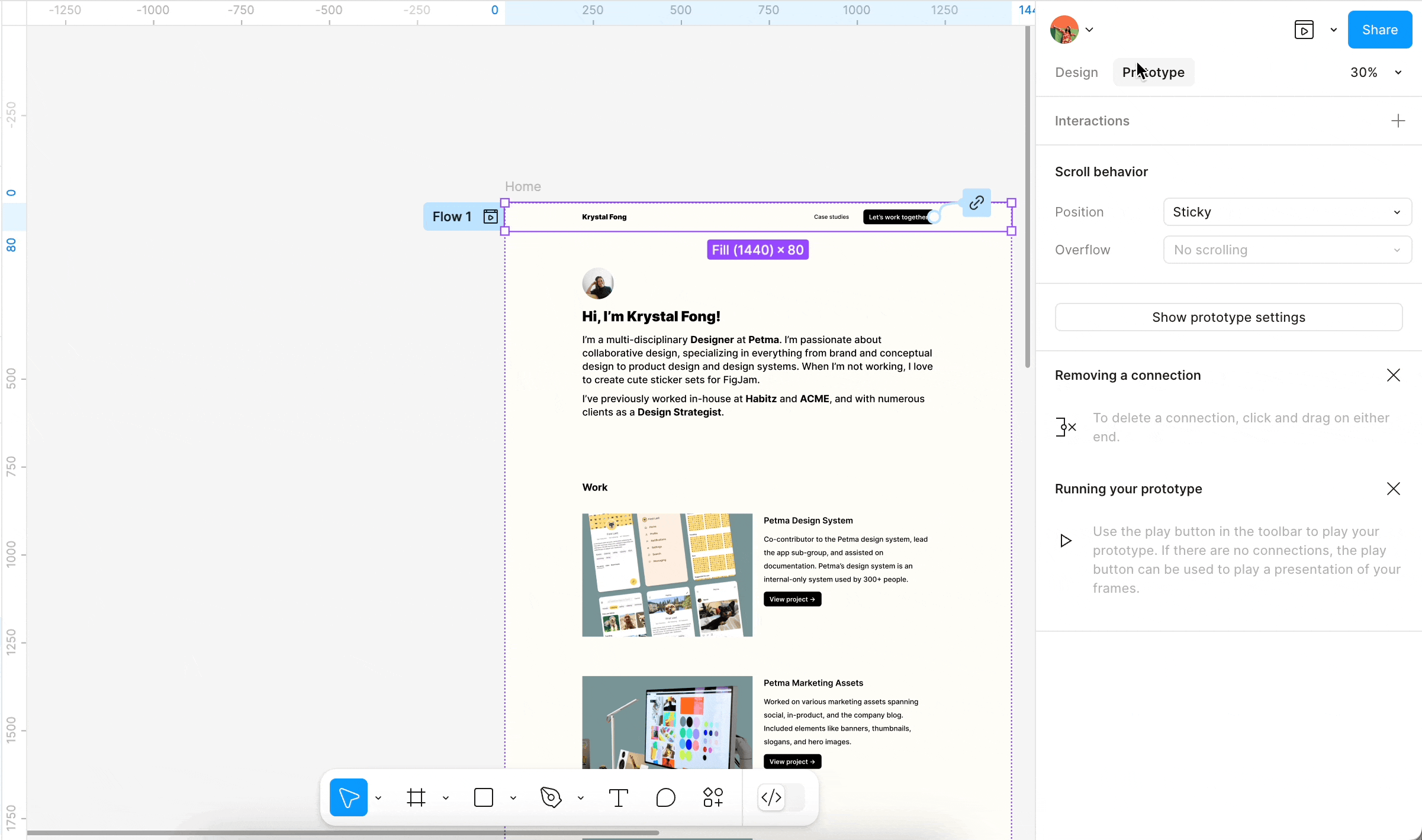

We want the nav bar to be visible at all times, even when scrolled all the way to the bottom of the page. We can use the sticky scroll position to do this.
Change the navigation bar's scroll position
- Select the navigation bar instance in the Home frame.
- In the Prototype tab, select Sticky from the Position menu.
Objects with their position set to Sticky will "stick" themselves to the top edge of their scrolling container. In this case, the scrolling container is our whole page. Be sure to also select the navigation bar in the Case study frame and change its position to Sticky as well.

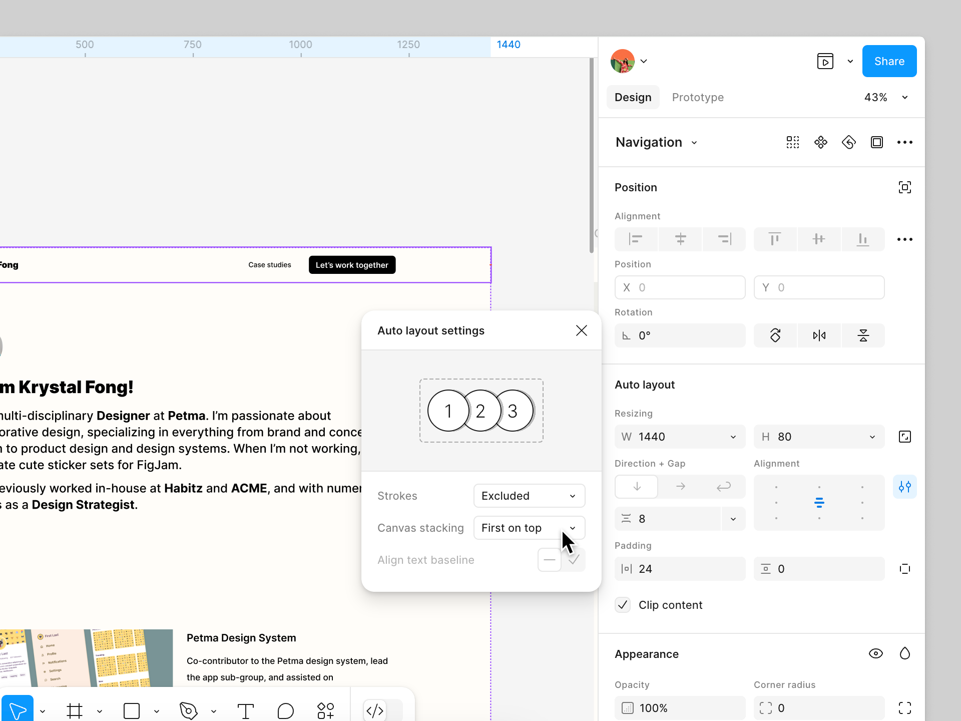

If your page content is scrolling over the navigation bar, you may need to adjust the Canvas stacking property. Canvas stacking determines whether the top-most or bottom-most layer in the auto layout frame appears visually on top.
This is particularly handy is when using negative gaps between items. You may see this in components like a face pile, with overlapping photos—and you may prefer one stacking order to another.
By default, layers in an auto layout frame are ordered Last on top. Open the Auto layout settings, and make sure Canvas stacking is set to First on top. This makes it so the Navigation frame, which is the top-most layer in the Layers section, now appears above all other layers.

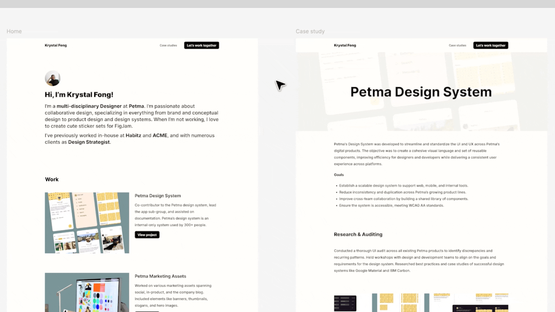

Changing the scroll behavior was a quick change, so we can preview it right away and see if it's the behavior we were looking for. Now, when we scroll, the nav stays stuck at the top. Great!

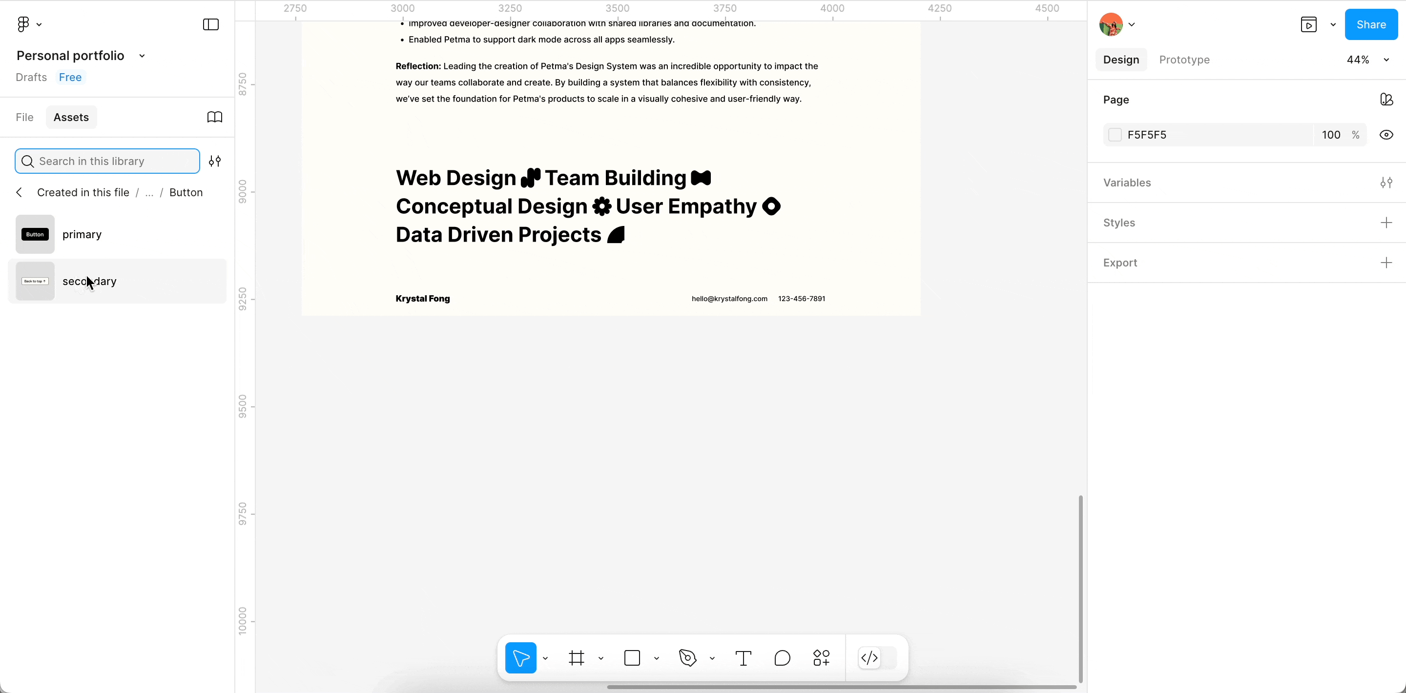

Add an instance of the secondary button

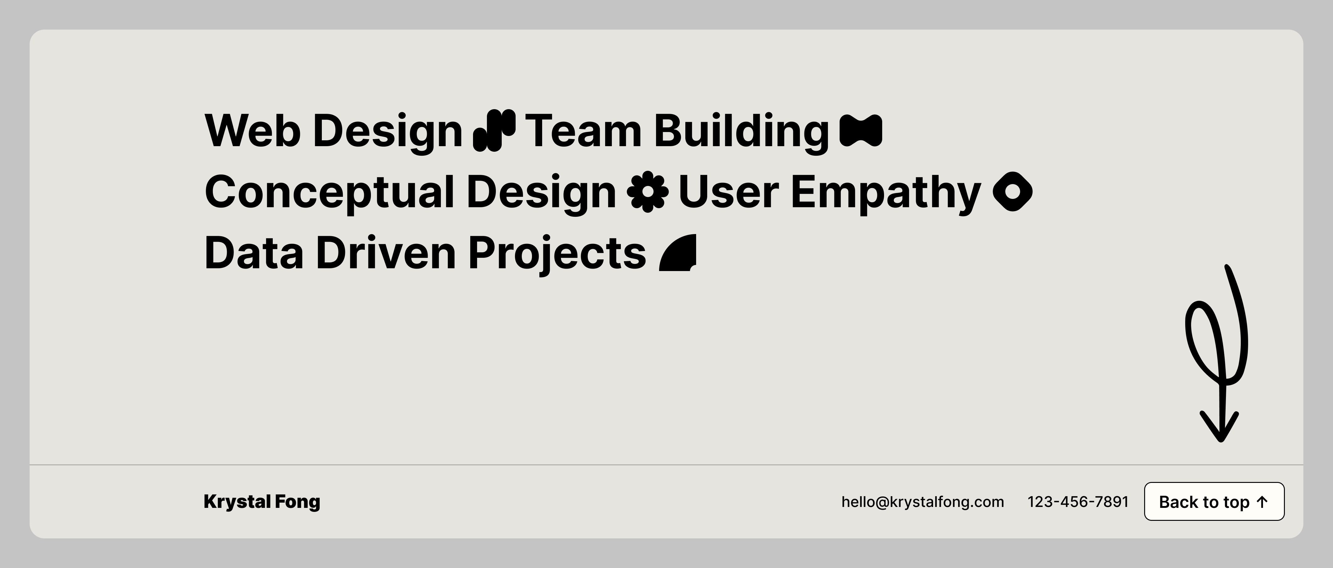

Let’s go back to our portfolio design and add an instance of this new button to the Case study page. Figma will automatically add the button to the auto layout flow.
By default, objects in an auto layout frame can’t be positioned freely, but we can use Ignore auto layout exclude our button from the auto layout flow. This allows us to ignore the rules set by auto layout, so we can position the object precisely within the frame without taking it out of the frame. Learn more about ignore auto layout.
- Select the secondary button instance you just added.
- Click Ignore auto layout in the Position section of the right sidebar.
- Drag the button to a location that you like. We'll place ours in an empty space in the footer.

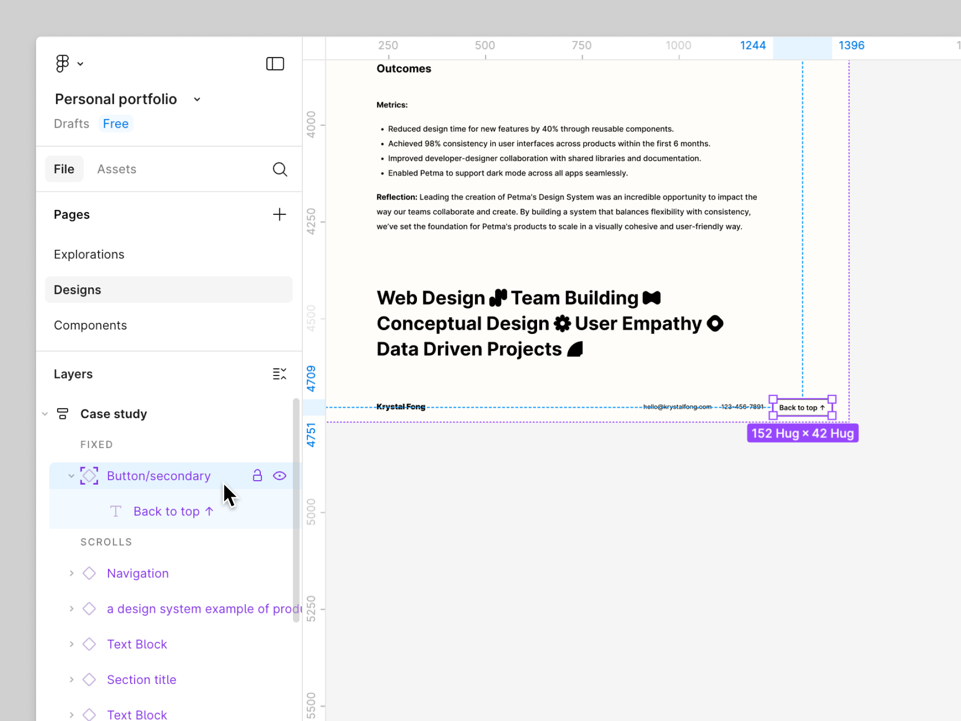

In the Prototype tab, change the button's position to Fixed. When a layer’s position is set to Fixed, Figma Design will move it to a new section of the layers panel, above other layers that scroll.

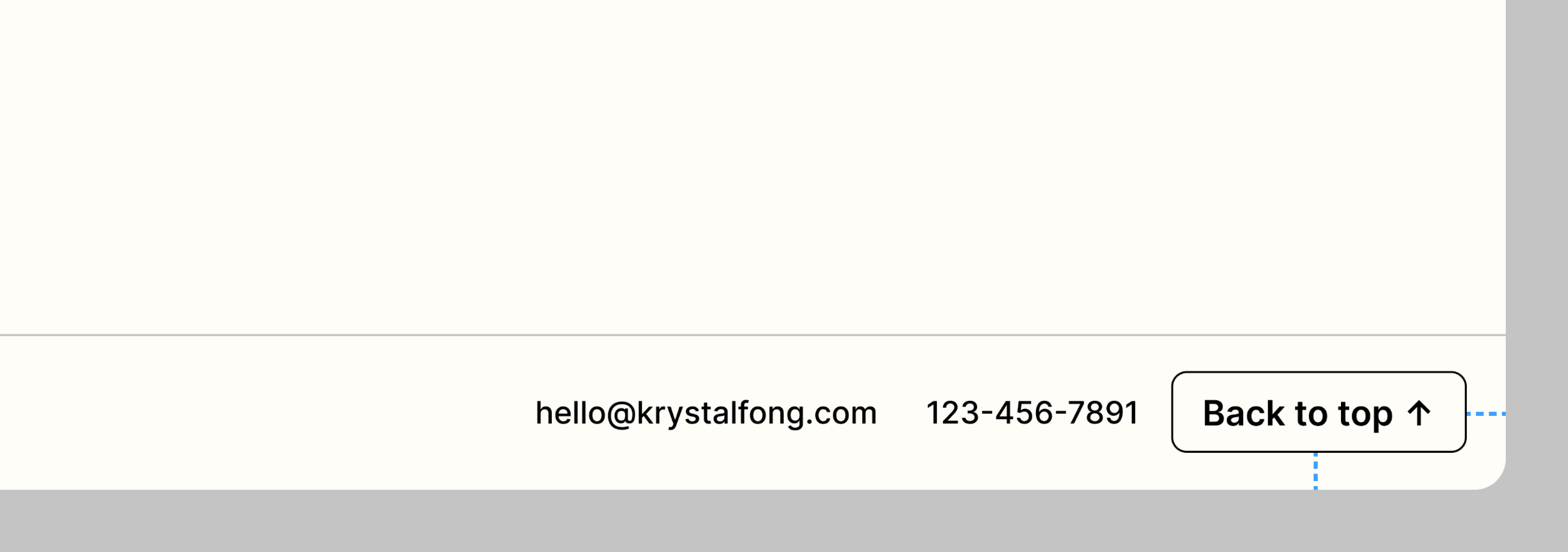

We’ve positioned our button near the bottom and right edges of our frame, so let’s change the button’s constraints to Bottom and Right. Figma Design will display the button in a fixed position with offsets relative to those edges.
Back in the inline viewer, we can see the button appears in the bottom right corner, and stays fixed as we scroll the page, or if we resize the window.
