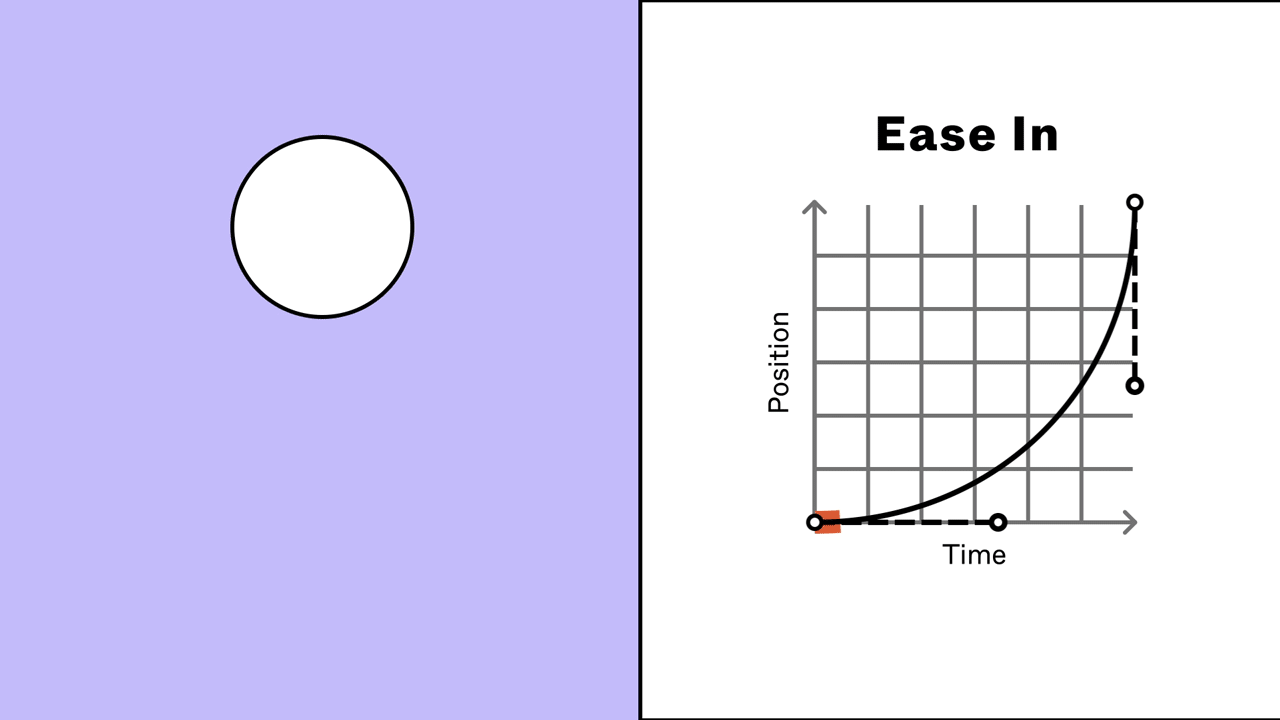

Ease In
Creates an animation that starts slowly and accelerates as it reaches the end of its duration. This works well for smoothly transitioning objects out of view. One downside is it can feel sluggish.

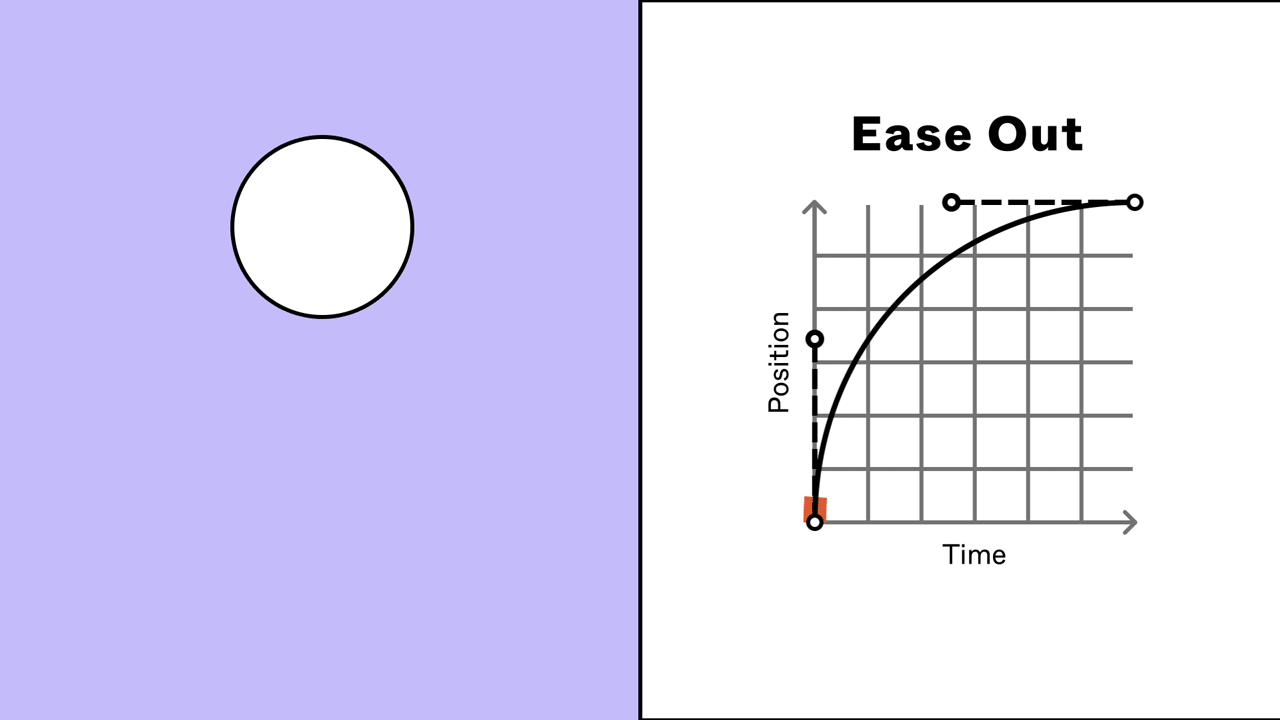

Ease Out
Ease Out is the opposite of an Ease In curve, where the animation starts fast and slows down as it reaches the end of its duration. It works well for moving objects into view and reinforcing important visual information.

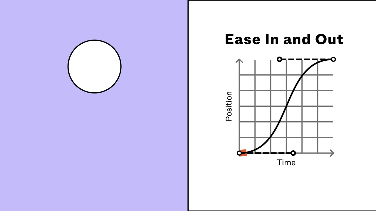

Ease In And Out
Starts the animation slowly, accelerates in the middle, and slows at the end of its duration. For most motion, it feels smooth and responsive, but can feel unnatural or too perfect when applied to everything.

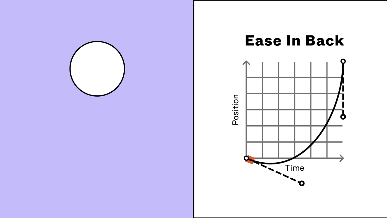

Ease In Back
Ease In Back is when the animation goes past the initial keyframe’s value and then accelerates as it reaches the end. This creates a bounce in the animation that serves as an anticipatory action, preparing the audience for and reinforcing the main action. Much like Ease In, Ease In Back can work well for smoothly transitioning objects out of view.

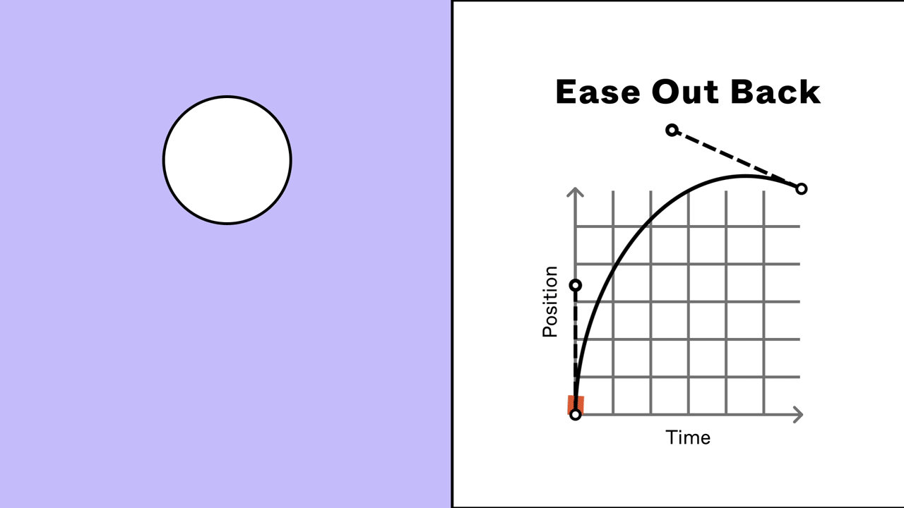

Ease Out Back
Is the opposite of Ease In Back. The animation starts fast, then slows and goes past the ending keyframe's value. This creates a bounce in the animation that serves as a settle that creates a smooth ending transition for the main action. Similar to Ease Out, Ease Out Back works well for moving objects into view.

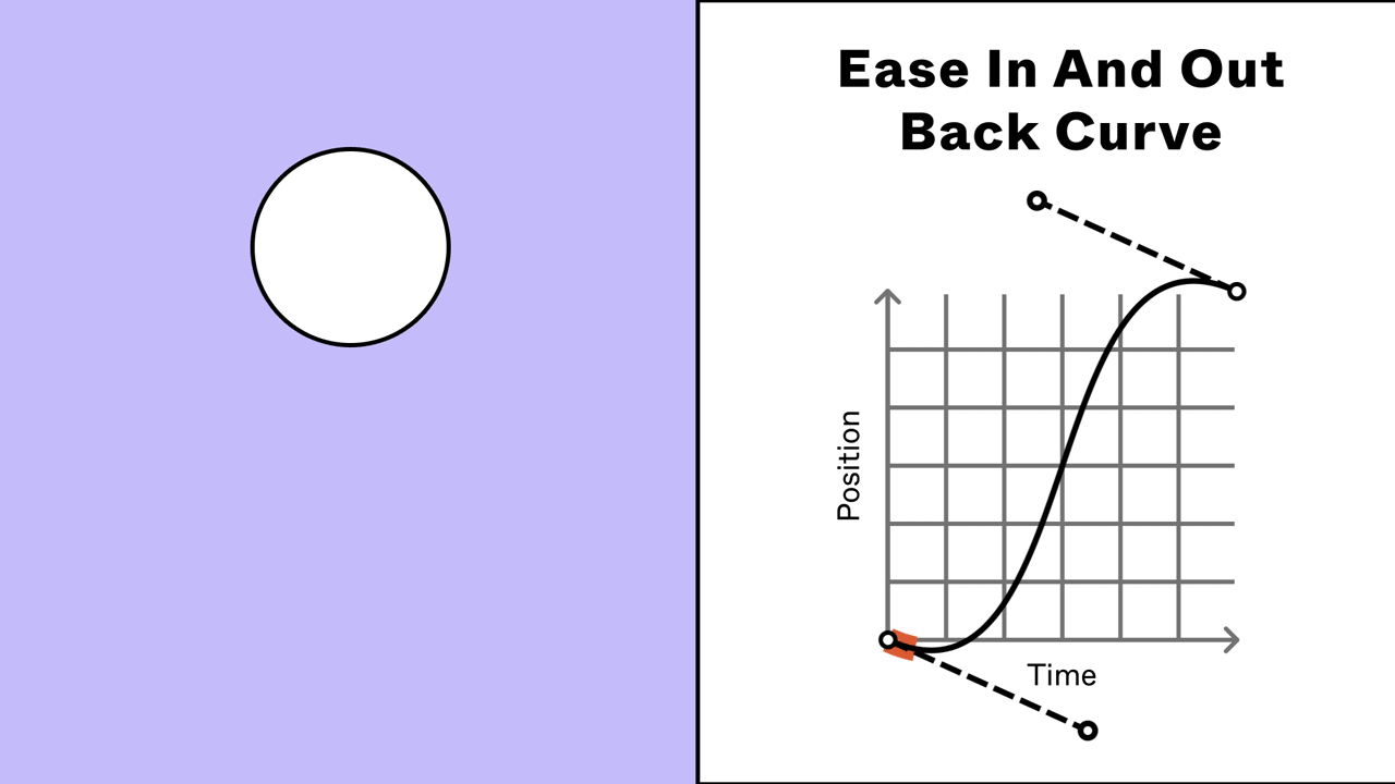

Ease In And Out Back
Starts the animation slowly as it overshoots the initial keyframe’s value, then accelerates quickly before it slows and overshoots the ending keyframes value. This creates an anticipatory bounce at the start, a quick motion, with a rebounding motion before the final state.

Tip! You can use these numerical values when translating the Bézier curve to CSS notation: cubic-bezier(x1, y1, x2, y2)
Note: It's possible to extend the curve beyond the graph's dashed perimeter. You can use this to create an anticipatory bounce at the beginning, or a rebounding effect at the end of the animation. The Ease In and Out Back preset shows both of these effects in action.

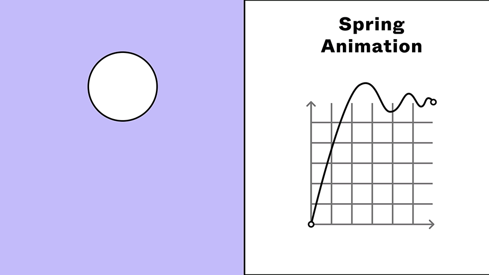

Spring animation presets
Combine spring animations with Figma’s animated transitions.

Custom spring curves
Customize your spring animation by editing the Stiffness, Damping, and Mass values in the Interaction details modal and by dragging the animated graph.
- Stiffness: influences the number of “bounces” in the animation and can be adjusted by dragging the graph.
- Damping: influences the level of spring in the animation and can be adjusted from the graph.
- Mass: influences the speed of the animation and height of the bounce. You’ll need to manually adjust the value in the Mass field. Adjusting mass also changes the millisecond value for the duration setting.
You can copy and paste numerical values to other interactions to replicate spring animation curves. It's not possible to save a custom curve for future use.
