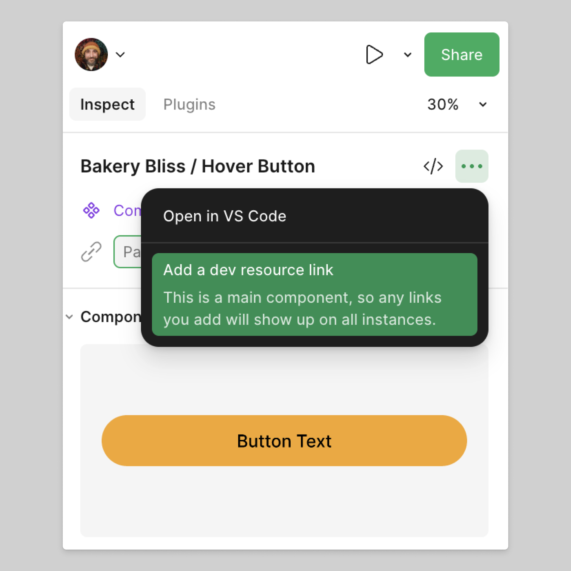

Link to a Dev resource
Dev resources can be added to any layer on the canvas. If a dev resource is added to a component, the link is inherited by all instances of that component. If a dev resource is added to an instance of a component, the link will only appear for that instance.
To link to a dev resource:
- Copy the URL you want to add.
- In Dev Mode, select a layer on the canvas.
- Click Add link next to Dev resources in the inspect panel then paste the link.
- Press Enter

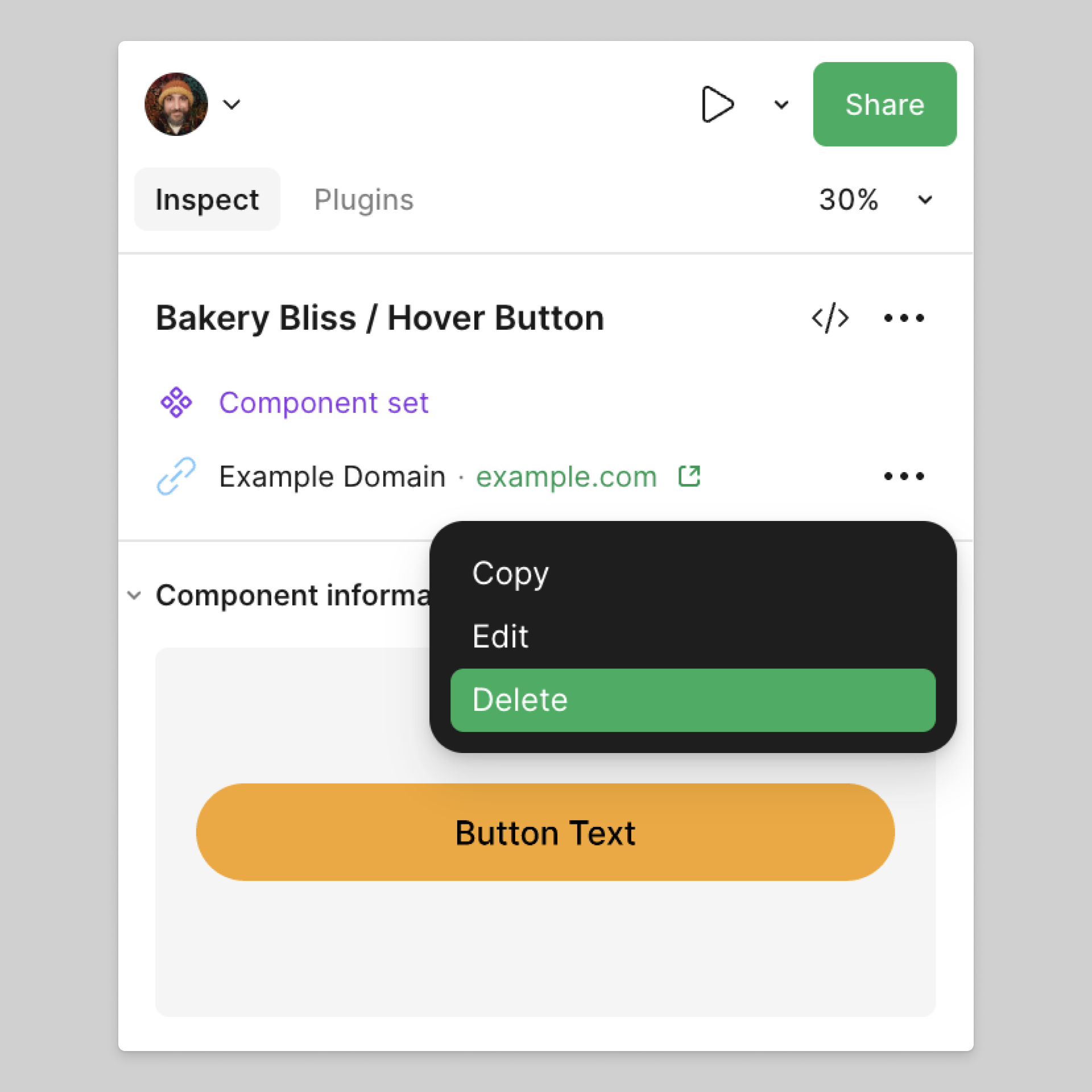

Remove a linked Dev resource
- In Dev resources, click Additional options next to the link.
- Select Delete link.
