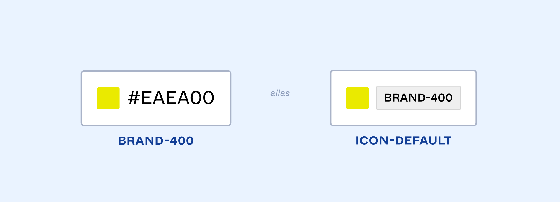

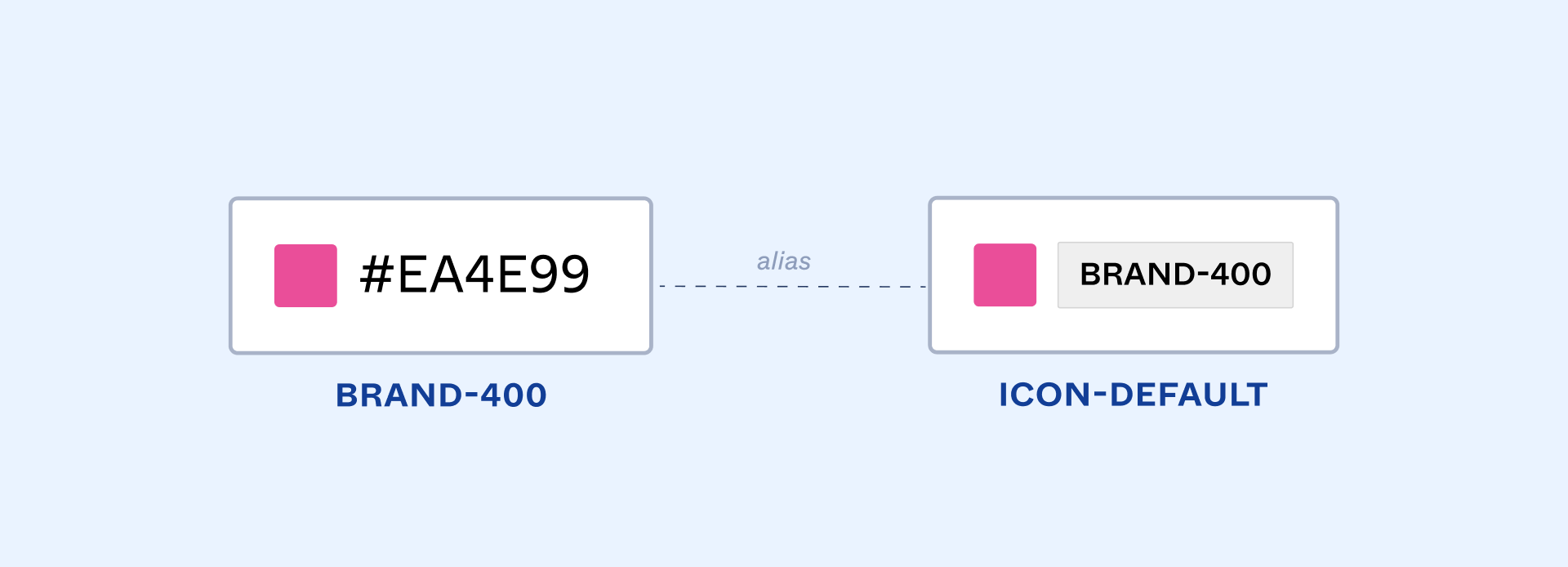

For example, let’s say the variable "brand-400" (which is one of our design tokens) has a value of #EAEA00. We want the variable "icon-default" (another design token) to be an alias of brand-400, meaning it will inherit whatever value brand-400 has.
If the value of brand-400 ever changes, then icon-default will follow suit, as long as it’s still bound to brand-400’s definition.
