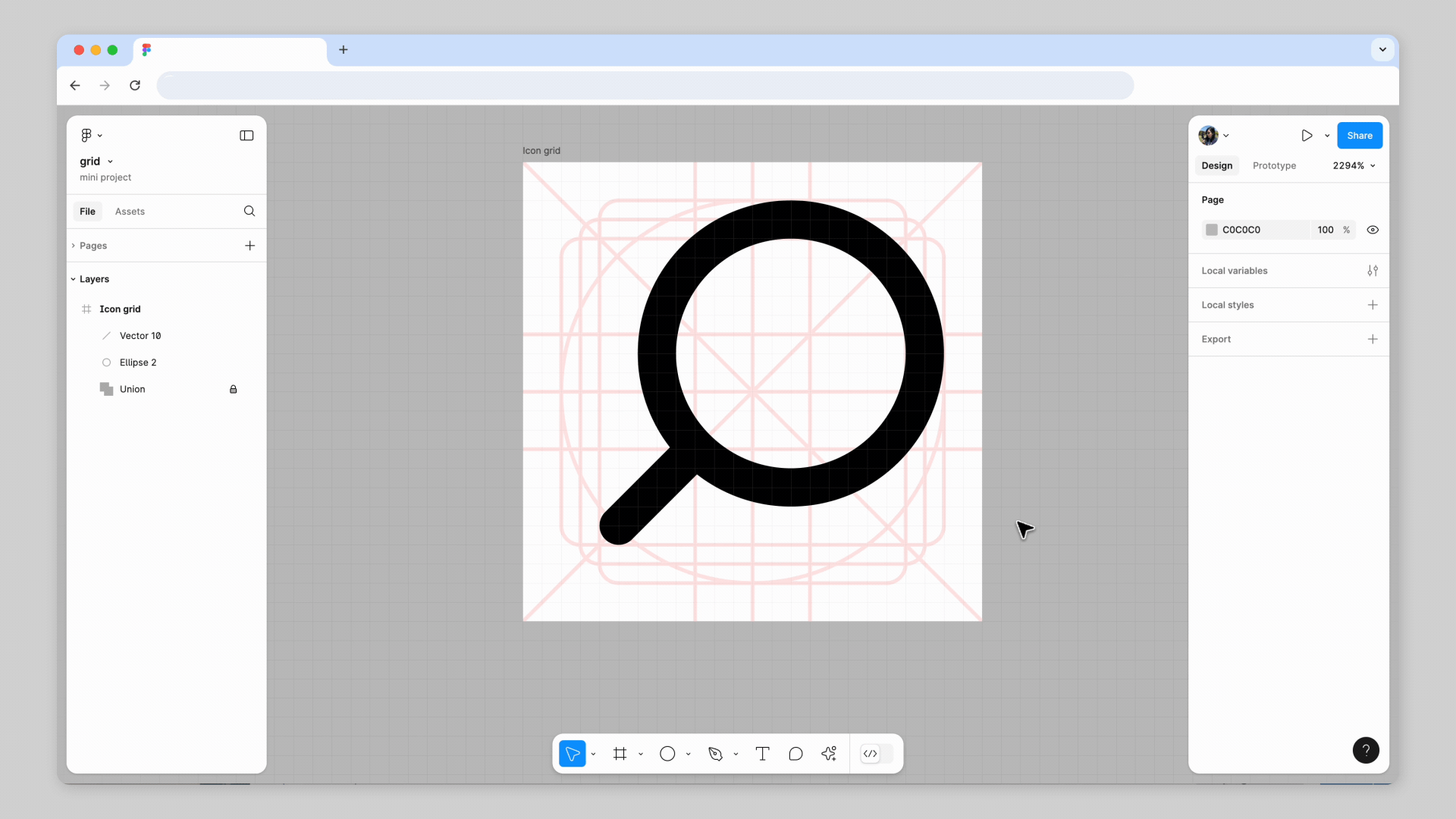

- Hold Shift and select both the lens and the handle.
- Click Union selection in the right sidebar. Notice that the two layers have been combined into a layer called Union in the left sidebar.
- Center the object using the alignment settings in the right sidebar. Now the icon is centered to the frame, within equal paddings on all sides.

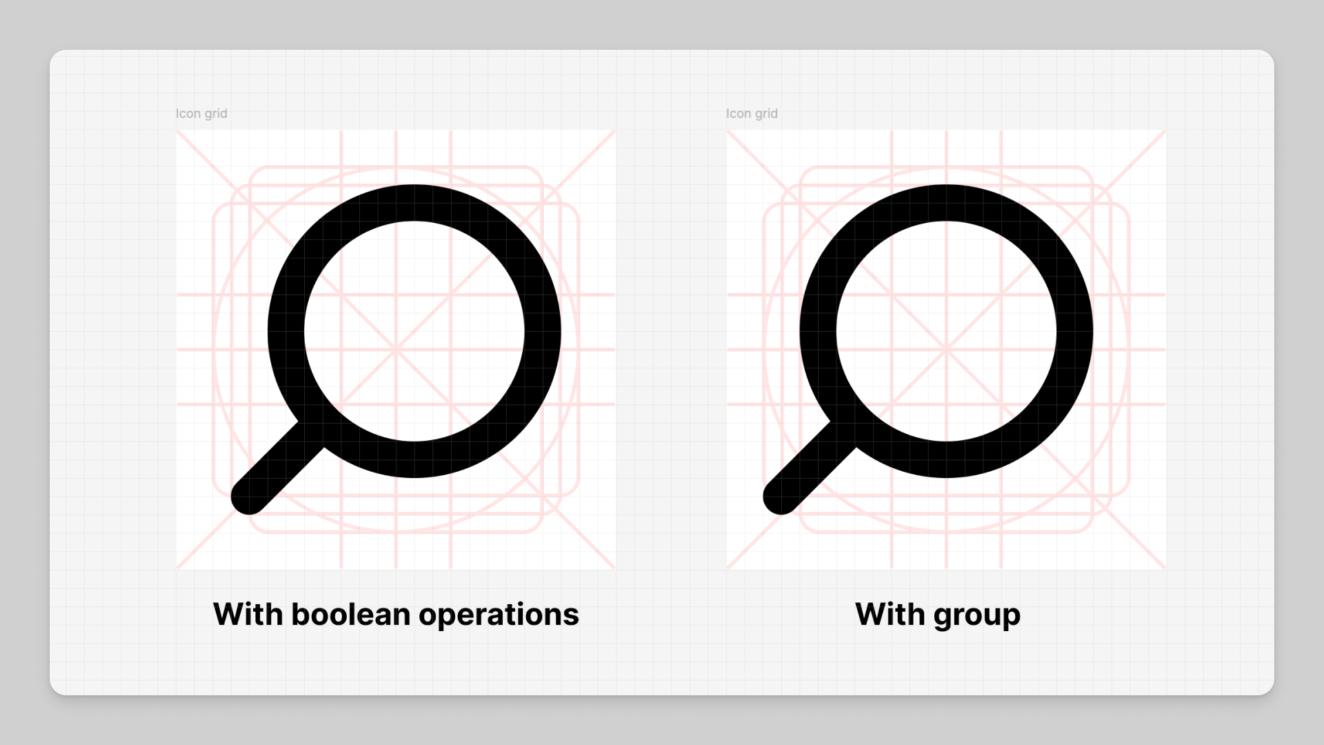

Why use a boolean operation instead of a group? If you use a group to combine the layers, you’ll notice that something is off. When you select the grouped object, the bounding box does not include the stroke of the handle. This might not look like a big deal, but when you try to align the grouped object to the center of the frame, the padding is not equal on all sides. Using a boolean operation ensures that all parts of the combined shape are contained within the bounding box.

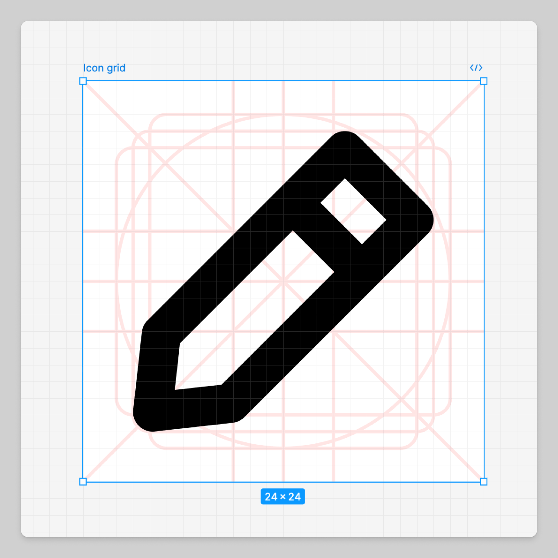

Congratulations on creating your search icon! If you want to challenge yourself, try making this pencil icon using the same things you learned in this tutorial.
