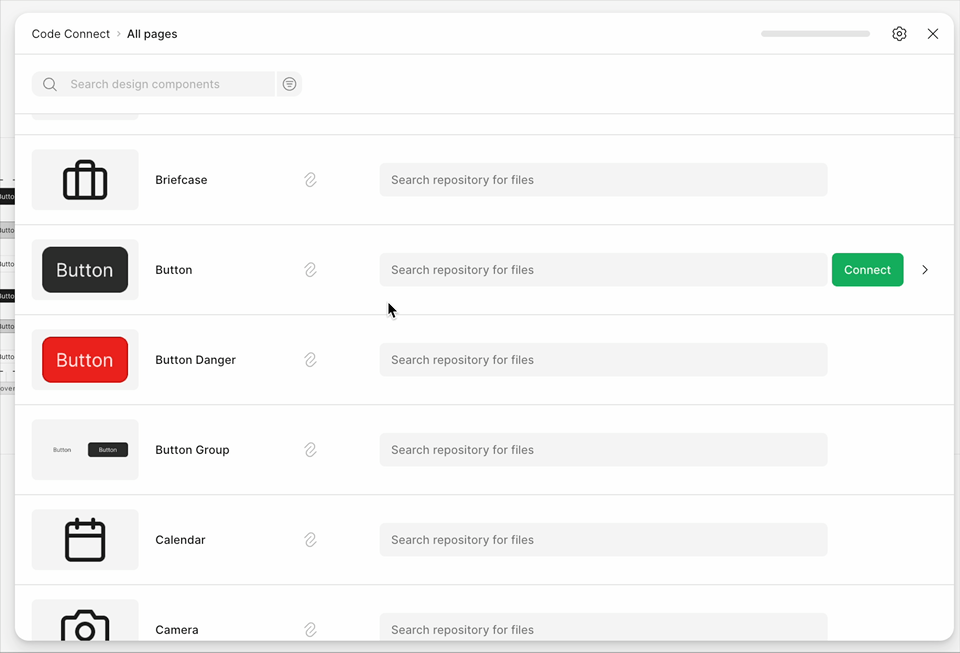

Connect to a GitHub repository (optional)
Authorize Figma to access your GitHub repository and select components directly. Connecting to GitHub is optional. You can map your design system components to code paths manually without a GitHub connection.
Note: You must be the owner of the file you want to connect to GitHub or an organization admin.
Manual mapping
Link components manually by pasting the relevant file path or URL and the component name.
Once mapped, this information is shared with the Figma MCP server. Anytime this design component is used, the linked code info is included in the design context sent to AI agents.

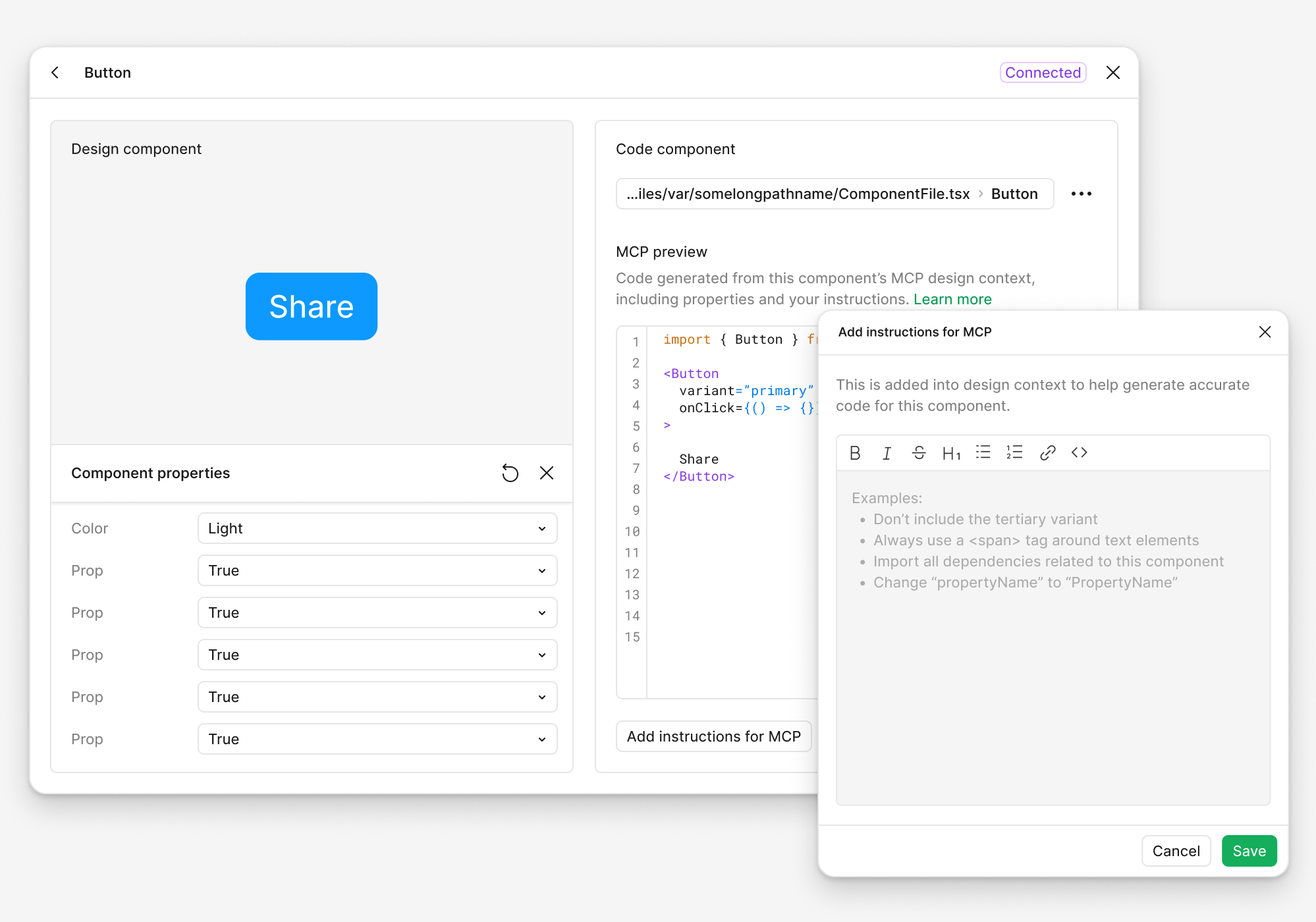

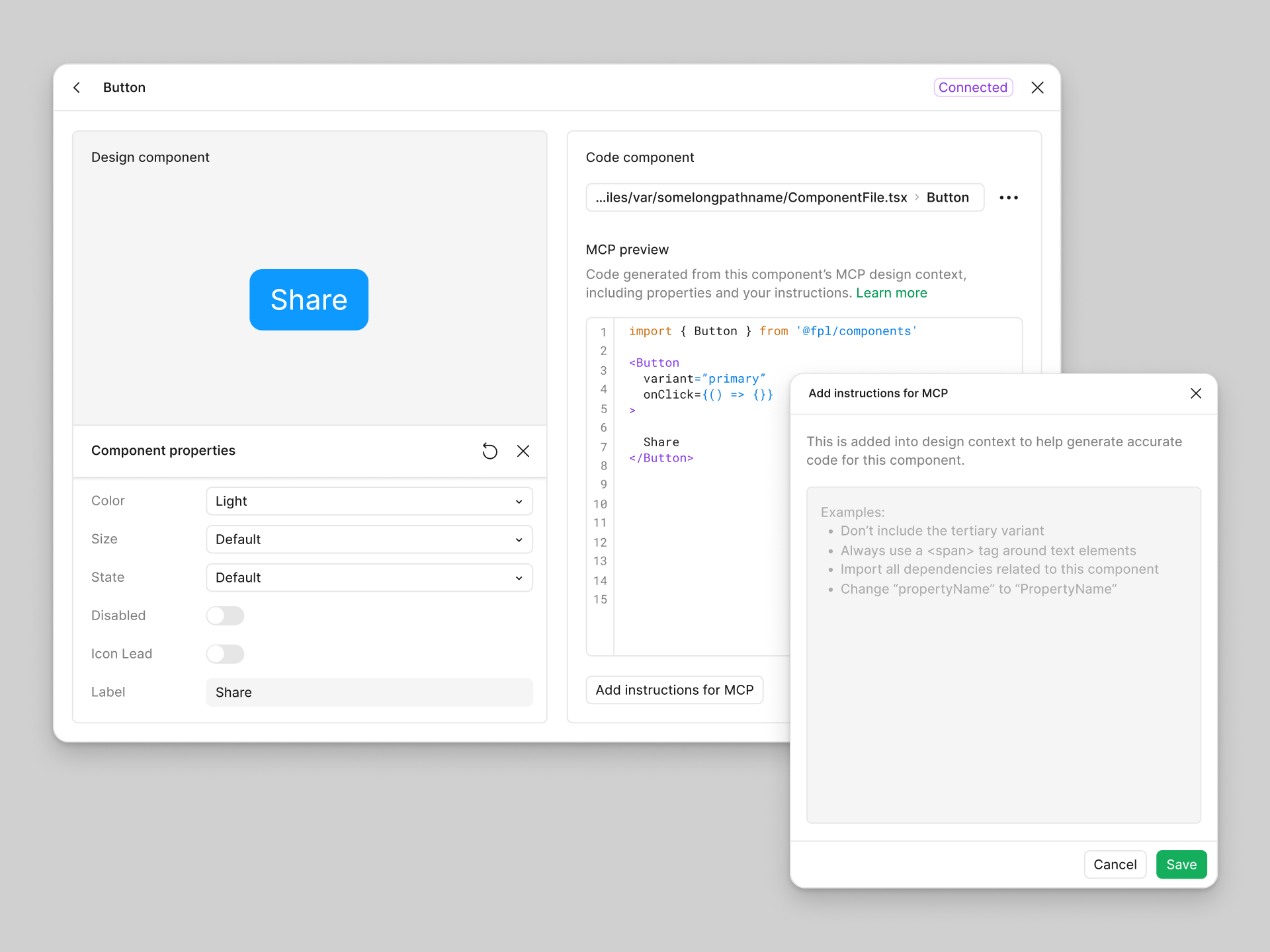

Enhanced MCP codegen with previews
Code Connect UI now includes enhanced MCP codegen, which surfaces example code previews based on your actual connected source files. In Dev Mode, you’ll see AI-generated snippets showing how the component might appear in your codebase, helping you understand implementation details before handing off.
You can also:
- Add custom notes or usage instructions per mapping, which Figma includes in the MCP server output to guide AI-assisted tools.
- Use the built-in component playground to see how different configuration options affect your code connections in real time.
Learn more about enhanced MCP codegen in Code Connect UI ->
Note: Components connected using Code Connect UI do not display code snippets in the Inspect panel. They currently show only the file and component name if provided, and support previews for AI-generated code snippets. To display code snippets in Inspect, use Code Connect CLI instead.
