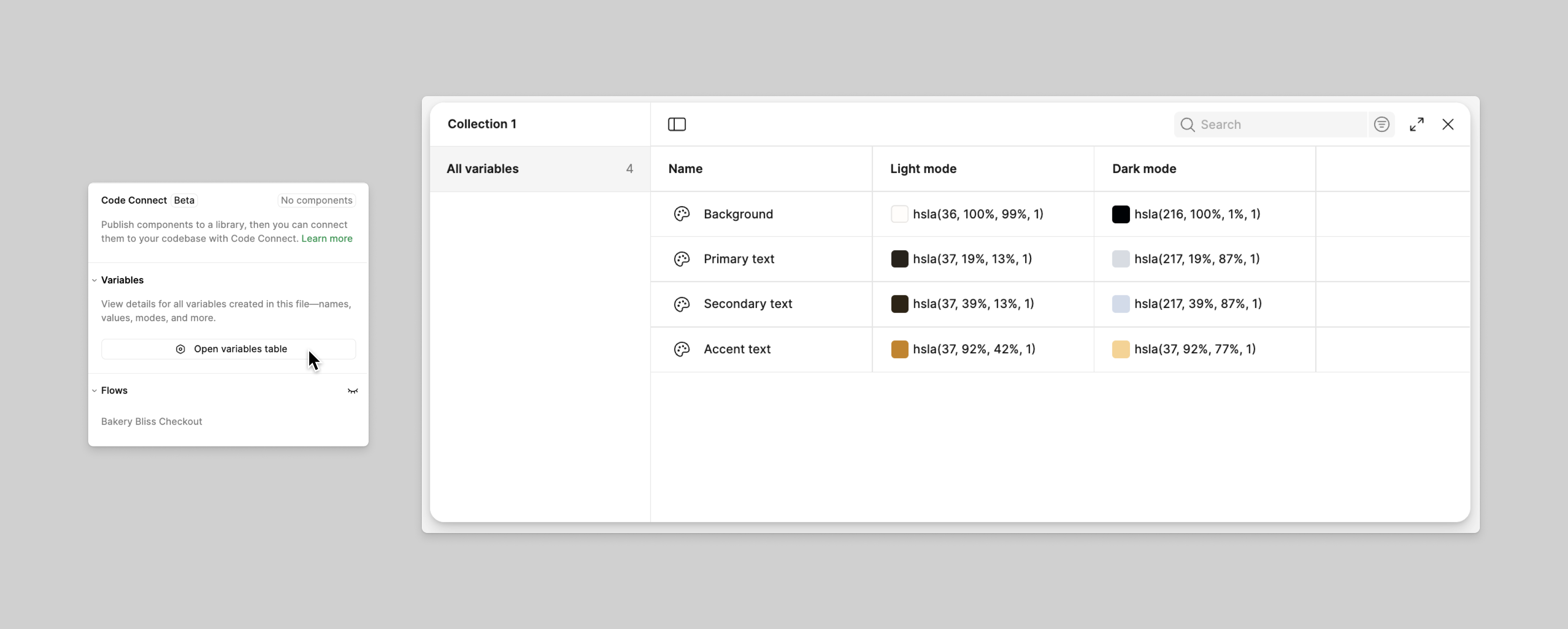

Access local variable collections
In Dev Mode, you can access and view the local variable collections in the file.
For example, in the previous image, in the Collections from this file section, the Color Primitives variable collection is selected. These names are just examples — the actual collection and variable names correspond to the local variables and collections in your file.
Below the Collections from this file section is a list of all the variable groups that appear in the collection, such as Brand, Black, and White. By default, All variables is selected. The groups are ordered the same way they’re organized in the Variables modal.
For the group that’s selected, the variables table displays the variables, along with the values for each mode a variable has. If you have All variables selected, the table is organized by group.
You can click on individual variables and values to copy them to your clipboard and to view details about the variable.

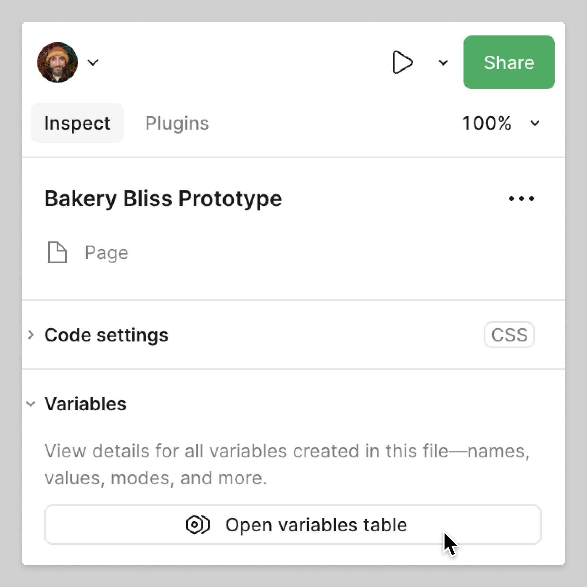

Open the variables table
When you have no layers selected in Dev Mode, you can open a table of all variables that were created in your file. To open the variables table, in the Variables section of the inspect panel, click Open variables table. The variables table expands to fill the canvas.
