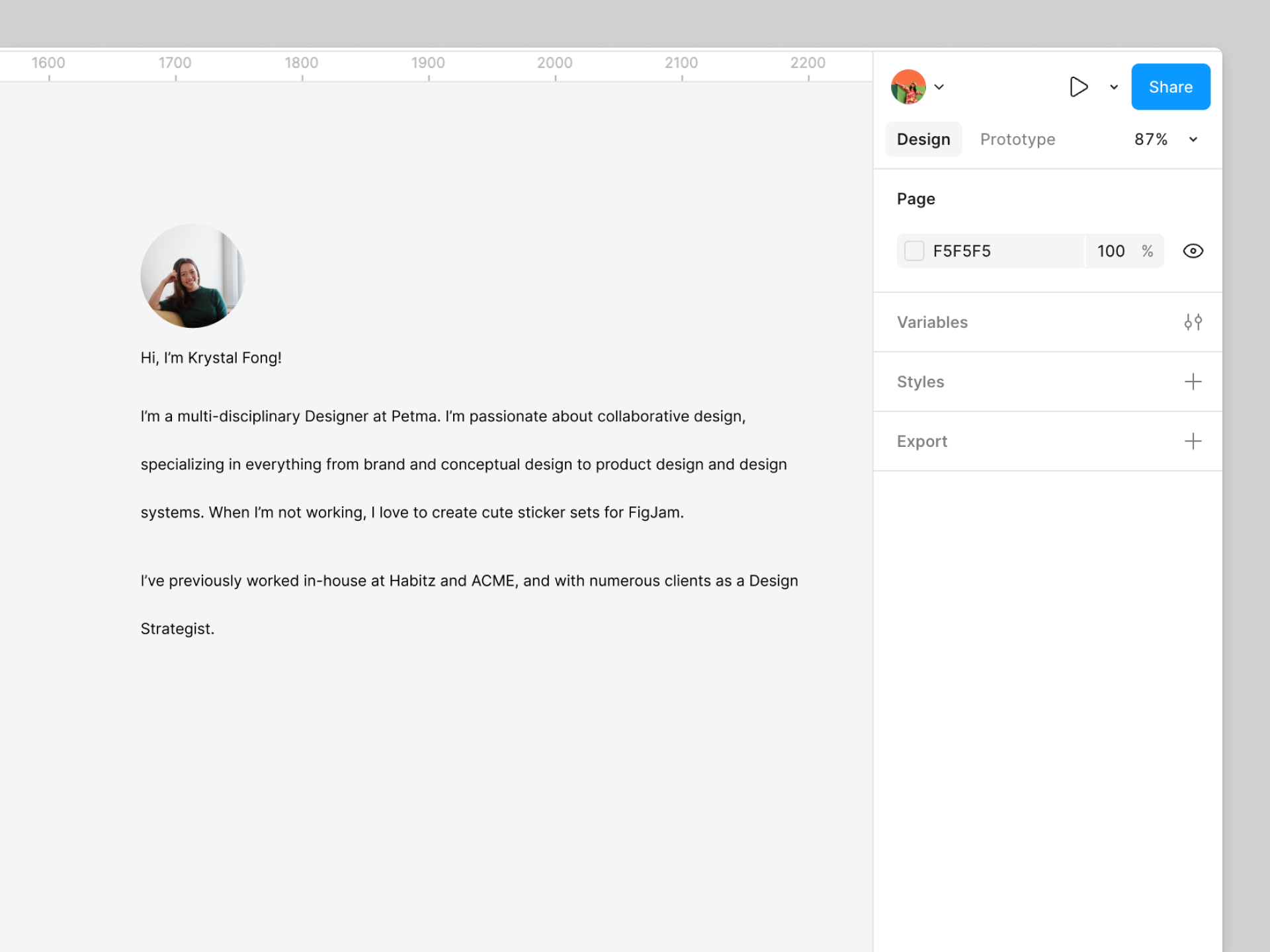

Add text layers
- Select the Text tool in the toolbar or press T.
- Click on the canvas below the avatar and type your name. If you take a look at the left sidebar, you'll notice that the layer name reflects the string of text on the canvas. It will continue to do this until we rename the layer.
- With the Text tool still selected, click and drag your cursor to create a text box below the other layers. Make sure the text box is large enough to fit your content. Don't worry about its exact size; we'll refine that in a future lesson.
As you type, you'll see that the text content stays contained within the text box, automatically wrapping to the next line instead of flowing off to the side. Why is this different from the other text layer?

Style the text layers
The default text styling is a bit small, and hard to read. We can use the text properties to create some visual hierarchy and help draw attention to a few key areas.

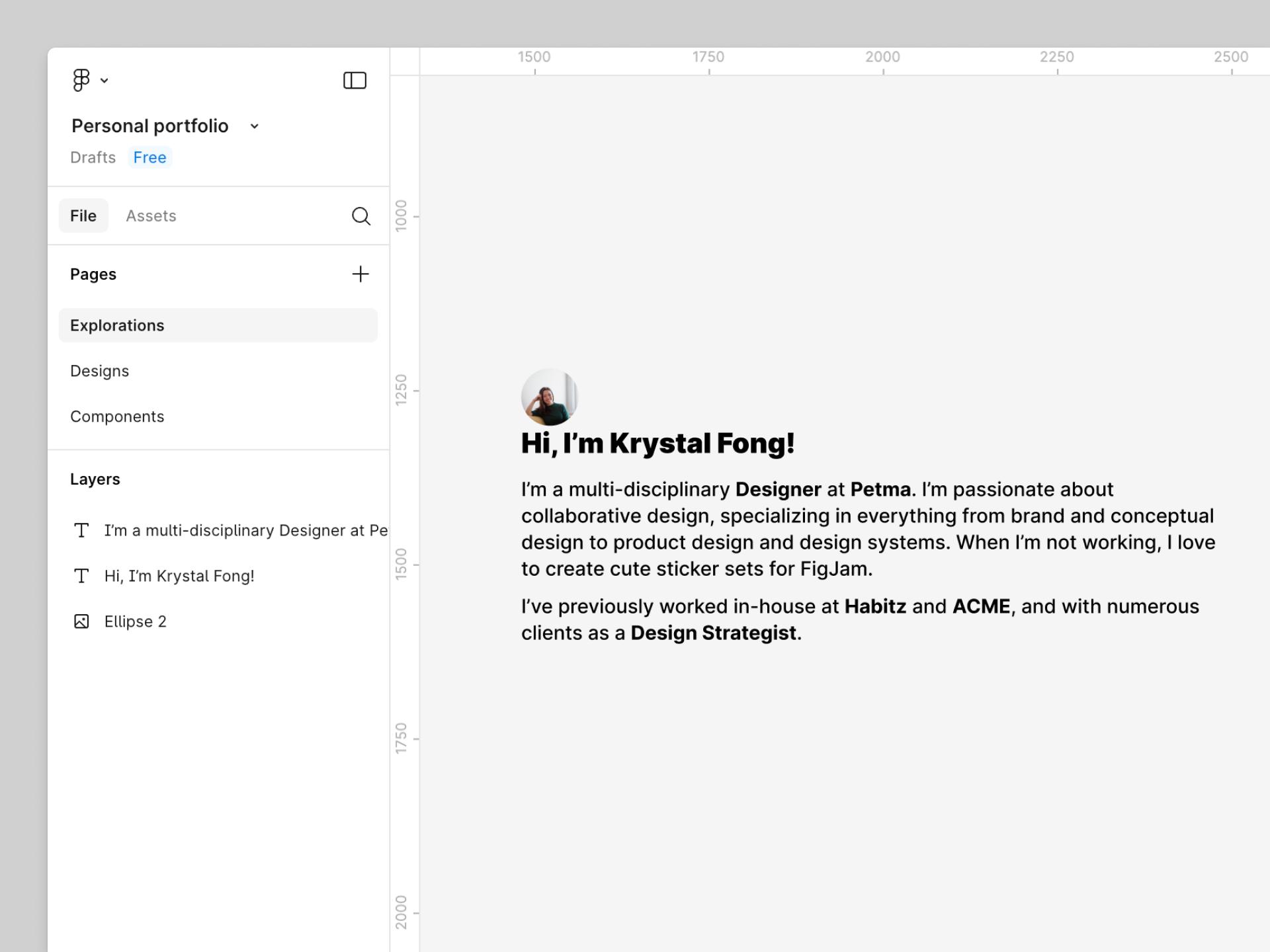

We'll update the bio text layer next:
- Select the text layer that contains your bio.
- Update the font weight to
Mediumand the size to28. - Change the text resizing to Auto height to prevent content from bleeding over the bottom edge of the bounding box.
- To give the content some room to breath, set the line height to
38and the paragraph spacing to16. - You can also use text formatting like bold or italics to draw attention to your career highlights or other achievements.
