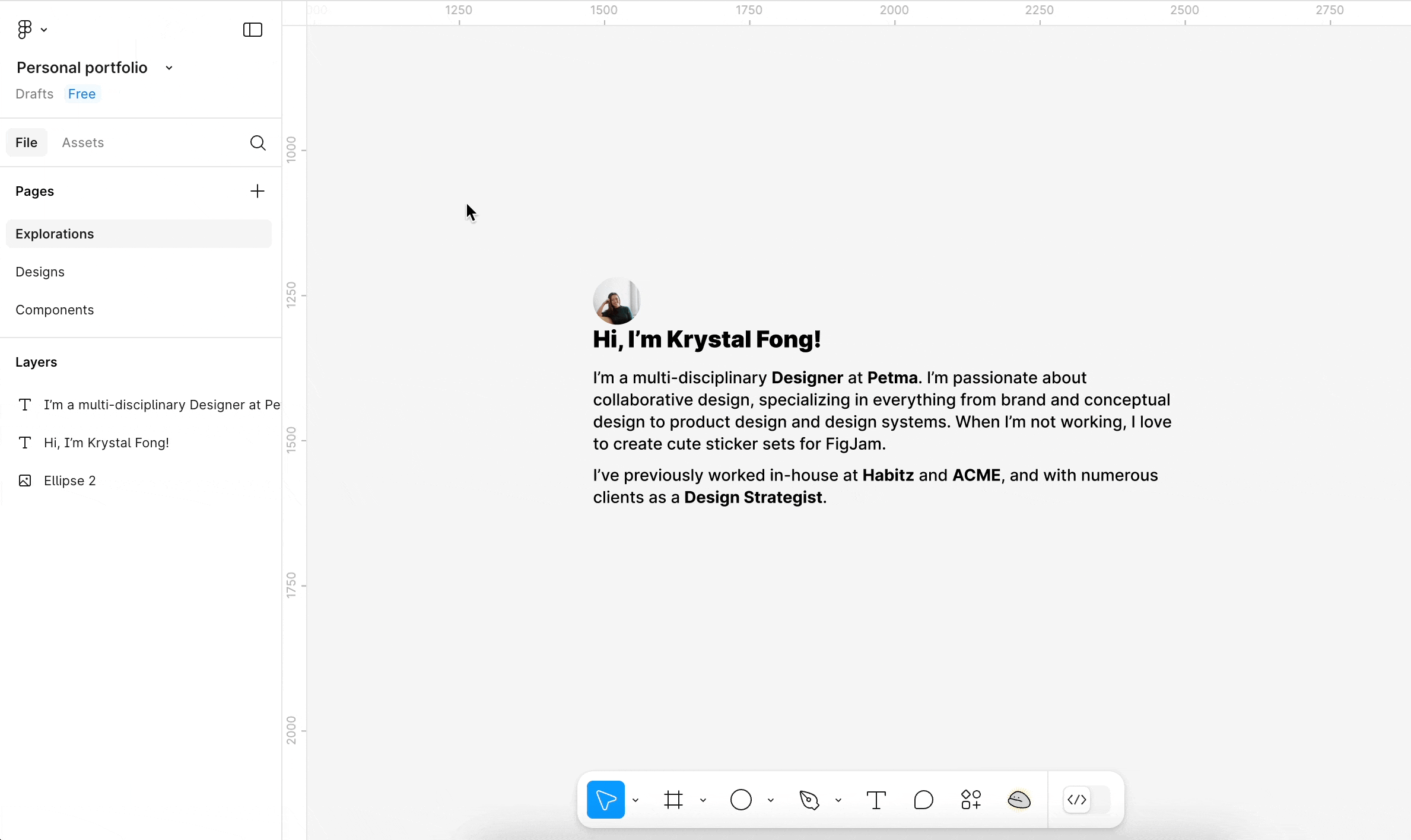

Now that the basic elements of our hero are done, we need a way to keep them together. Let's add them to a frame.
Add your layers to a frame
Frames are a core building block in Figma. They act as containers for other layers allowing you to organize them into cohesive designs. You can use frames to create individual assets like icons or buttons. Or various segments of your design—like a navigation bar, screen, or layout for a website or mobile app design.
To add layers to a frame:
- Select the Frame tool in the toolbar or press F.
- Click and drag your cursor around all of the layers.
- Double check the layers section in the left sidebar to make sure all elements are nested inside the frame. If they are, the elements will be indented directly below the frame and will be hidden on the canvas when you click visibility icon. If they’re not in the frame, you can click and drag the layers into the frame.
- To easily find the hero later, double-click the frame in the layers section and rename it to
Landing page hero
Set the Landing page hero frame aside for now. We’ll come back to it in a later lesson after we’ve created a few more elements for our portfolio.
