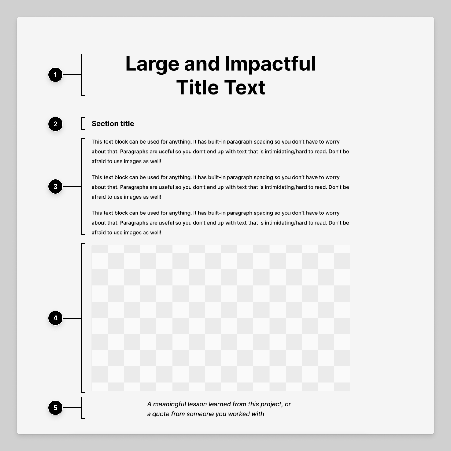

Your portfolio will likely have multiple case studies. Instead of building a single case study template, we'll create the following elements we can use to customize different case study page layouts:
- A hero with bold text and an image background to set the context for the page.
- A section heading to organize the page content.
- Paragraph text to describe different aspects of the project and how we contributed to its success.
- An image that allows us to showcase final assets, illustrate works in progress, or other visuals and resources.
- And a quote block, where we can include a quote, insight from a project, or testimonial from a client or collaborator.

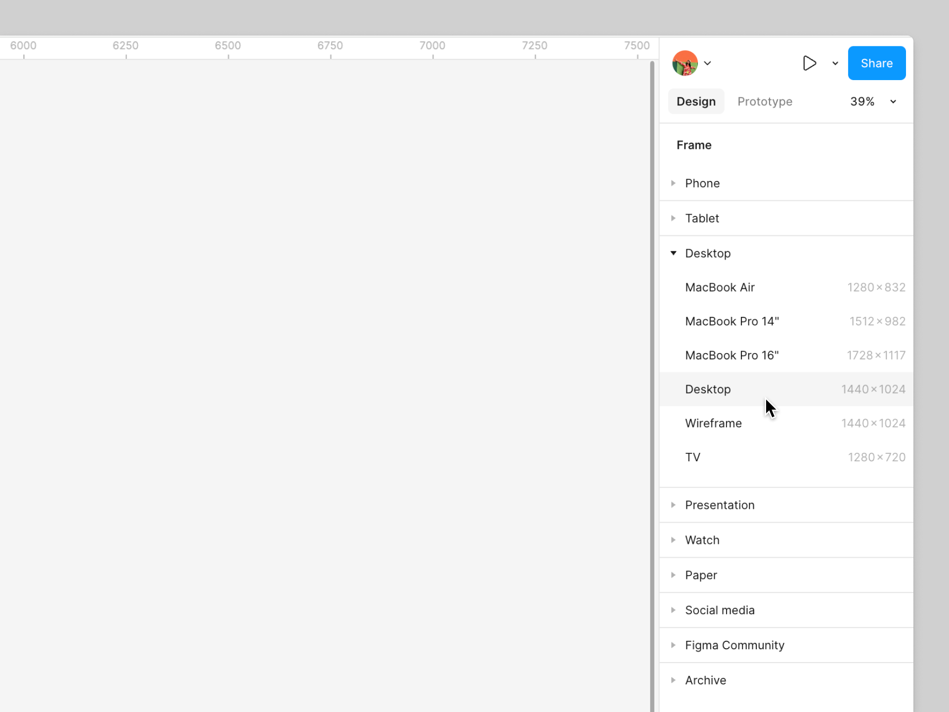

Frame presets are a collection of ready-made frame sizes. They allow you to quickly create frames for popular dimensions so that you don’t have to remember or guess what size your frames need to be. When you enable the Frame tool, you’ll find frame presets in the right sidebar for common desktop, mobile, and tablet devices. Click the arrow to expand the section and select a preset from the list. You can choose presets for popular device and asset templates. Learn more about frame presets.
Create a new frame using a frame preset
We'll create a frame using the Desktop frame preset.
- Enable the Frame tool, then open the Desktop section in the right sidebar.
- Select the Desktop frame preset to add a new frame to the canvas.
- Rename the new frame to
Case study exploration
