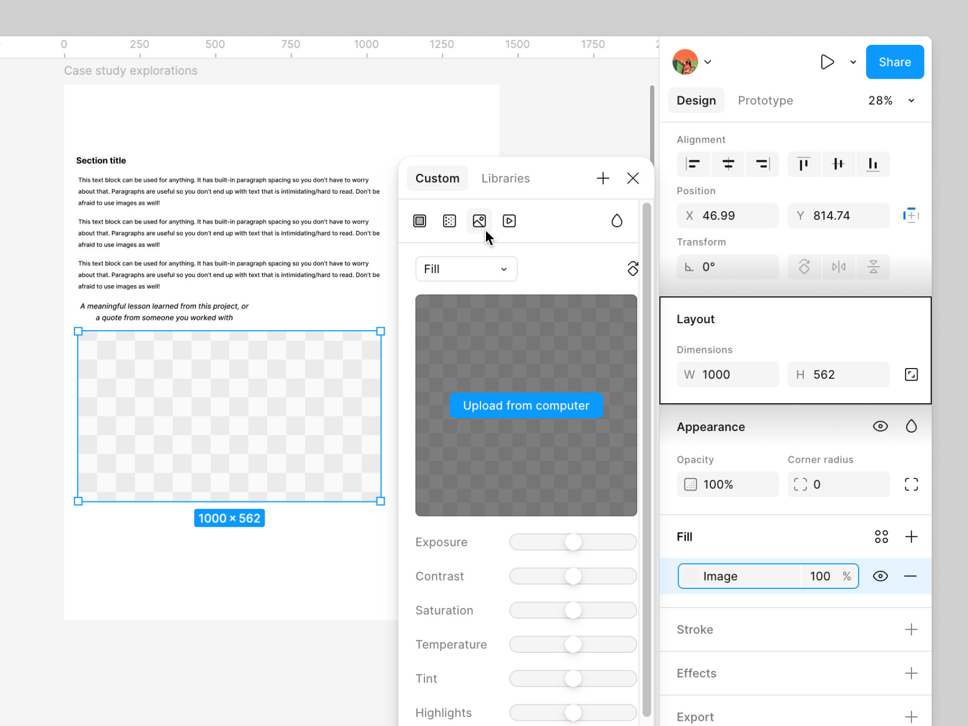

Create the image
We'll create an image block that we can use to visually showcase our work throughout the case study.
- Select the Rectangle tool or press
R
, and draw a rectangle inside the Case study explorations frame. - Set the layer's width to
1000
. This will match the width of our text layers, so they'll stay consistent with each other. -
Set the height to
562
. - Open the color picker in the Fill section of the right sidebar
- Select Image at the top. Figma will change the fill to a grey and white checkerboard pattern to indicate an image placeholder. We'll update these placeholders in a later lesson.
- Rename the layer to

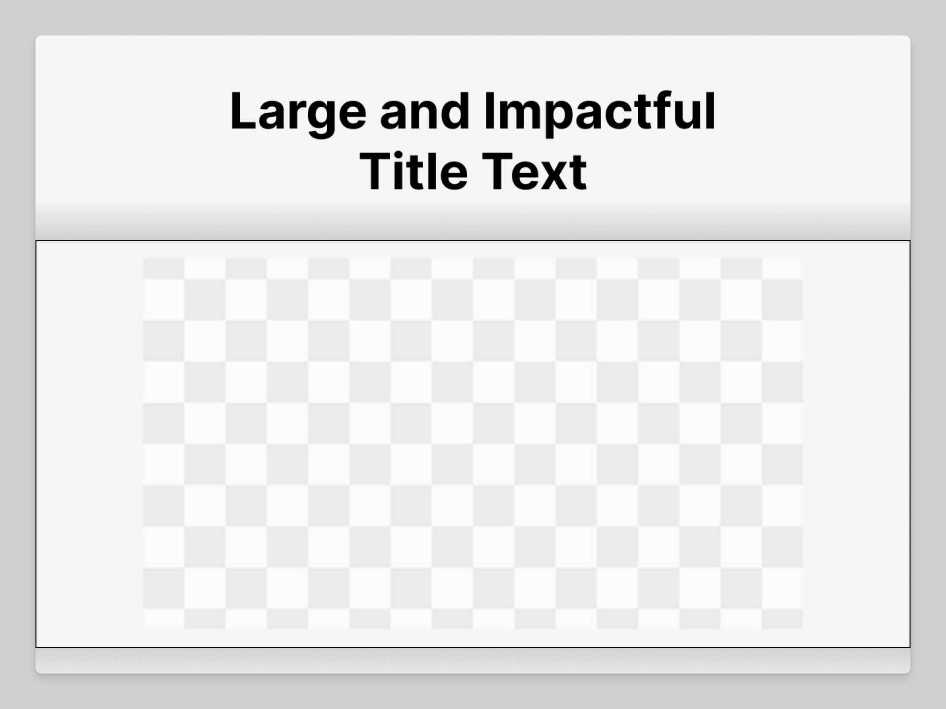

Before creating the hero, select all of the elements in the Case study explorations frame and move them down at least 400 pixels inside the frame.

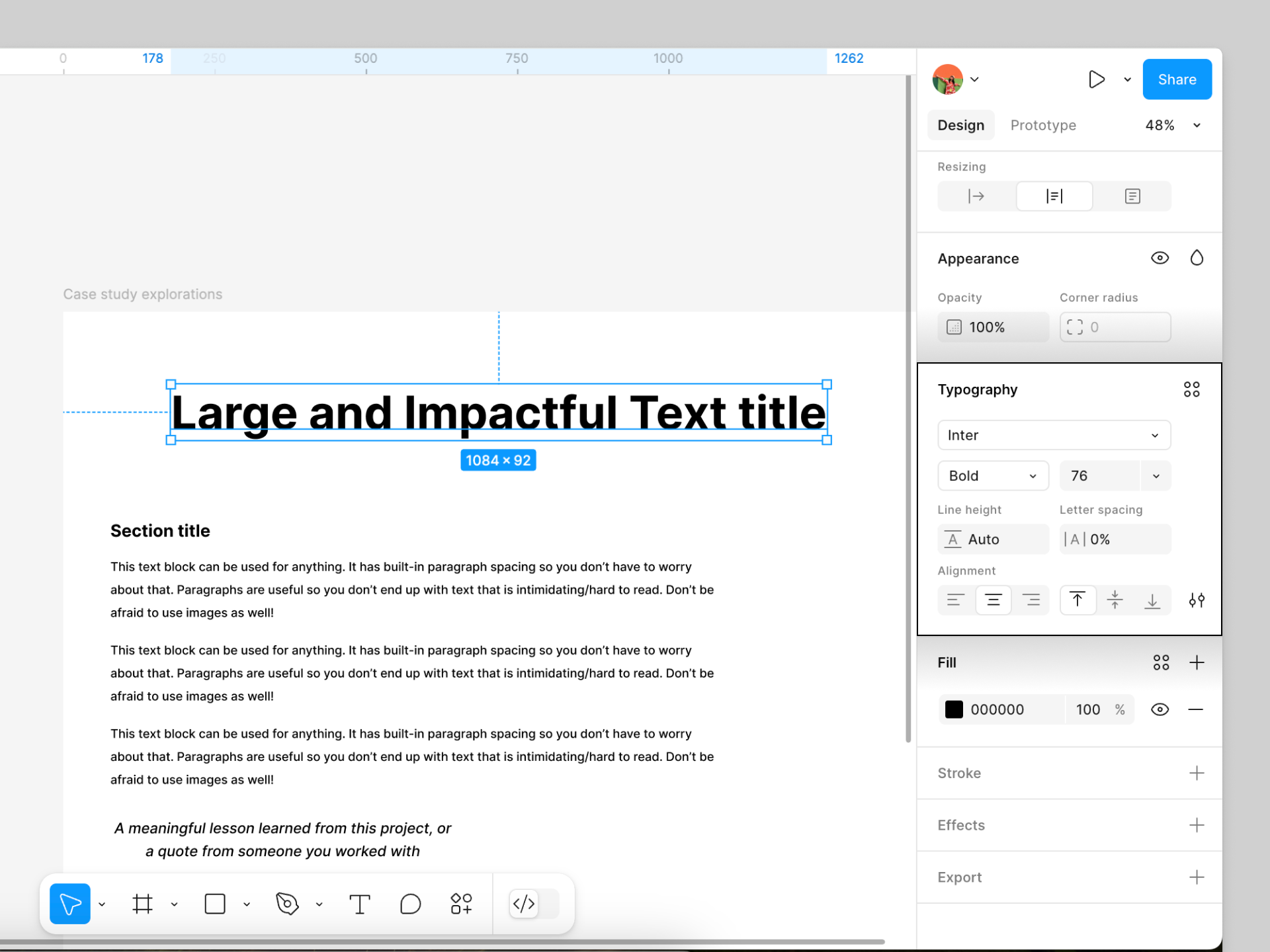

Add a text layer
Now that we have room to work, we'll create the hero element.
- Use the Text tool to create a text layer at the top of the Case study explorations frame.
- To help this element stand out, increase the font size to
76
, the font weight toBold
, and the line height to Auto. When you set line height to auto, Figma will use the default line height set by the font. This means line height will vary depending on the font you're using. - Set the text alignment to Align center.
- In the Alignment section, click Align horizontal centers to center the layer inside the frame.

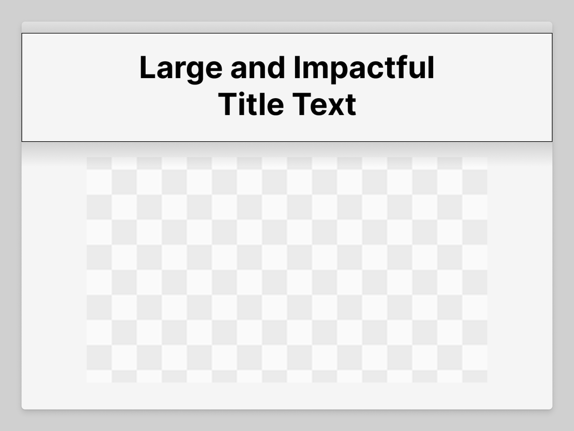

Add the text layer to a frame
It would be great to add a background to this hero, to help it stand out more. To achieve this, we'll add the text layer to a frame with an image fill.
In a previous lesson, we learned how to draw a frame around existing layers. This time, we'll use another method to add a new frame.
- Select the text layer.
- Right-click on the selection and choose Frame selection or use the keyboard shortcut:
Mac: ⌘ Command ⌥ Option G
Windows: Control Alt G

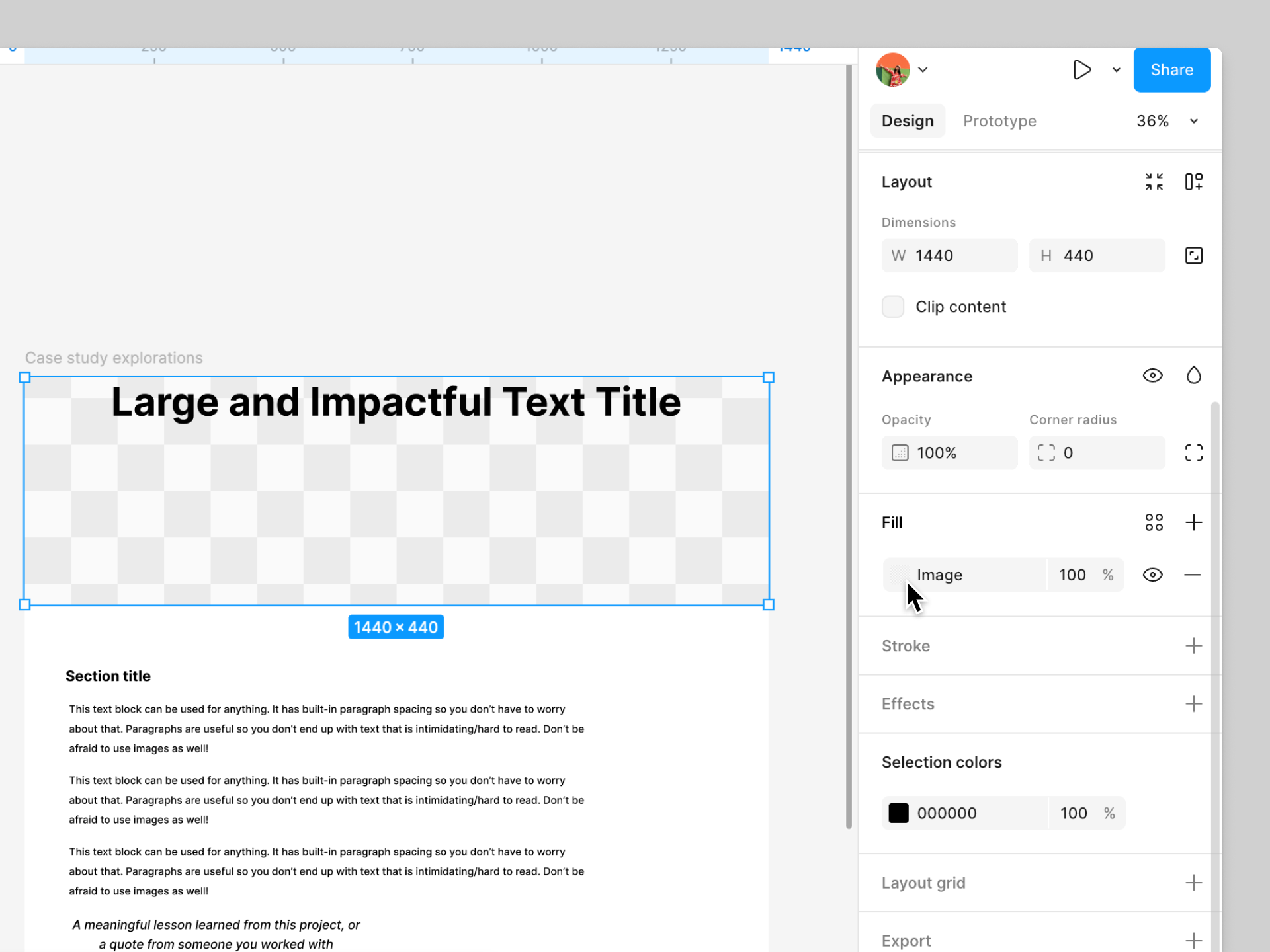

- Use the Fill section to change the fill to a placeholder image.
Then, make the frame bigger by clicking and dragging the left and right sides of the new frame’s bounding box. You can hold the modifier key to resize opposite sides in one go.
- Mac: Option
- Windows: Alt
Resize until the side snaps to the sides of the parent frame—indicated by the red X. To do this, you’ll need to have Snap to objects toggled on in your file preferences.
Then, set the height of the frame to
440
. - Rename the frame to
Impactful text

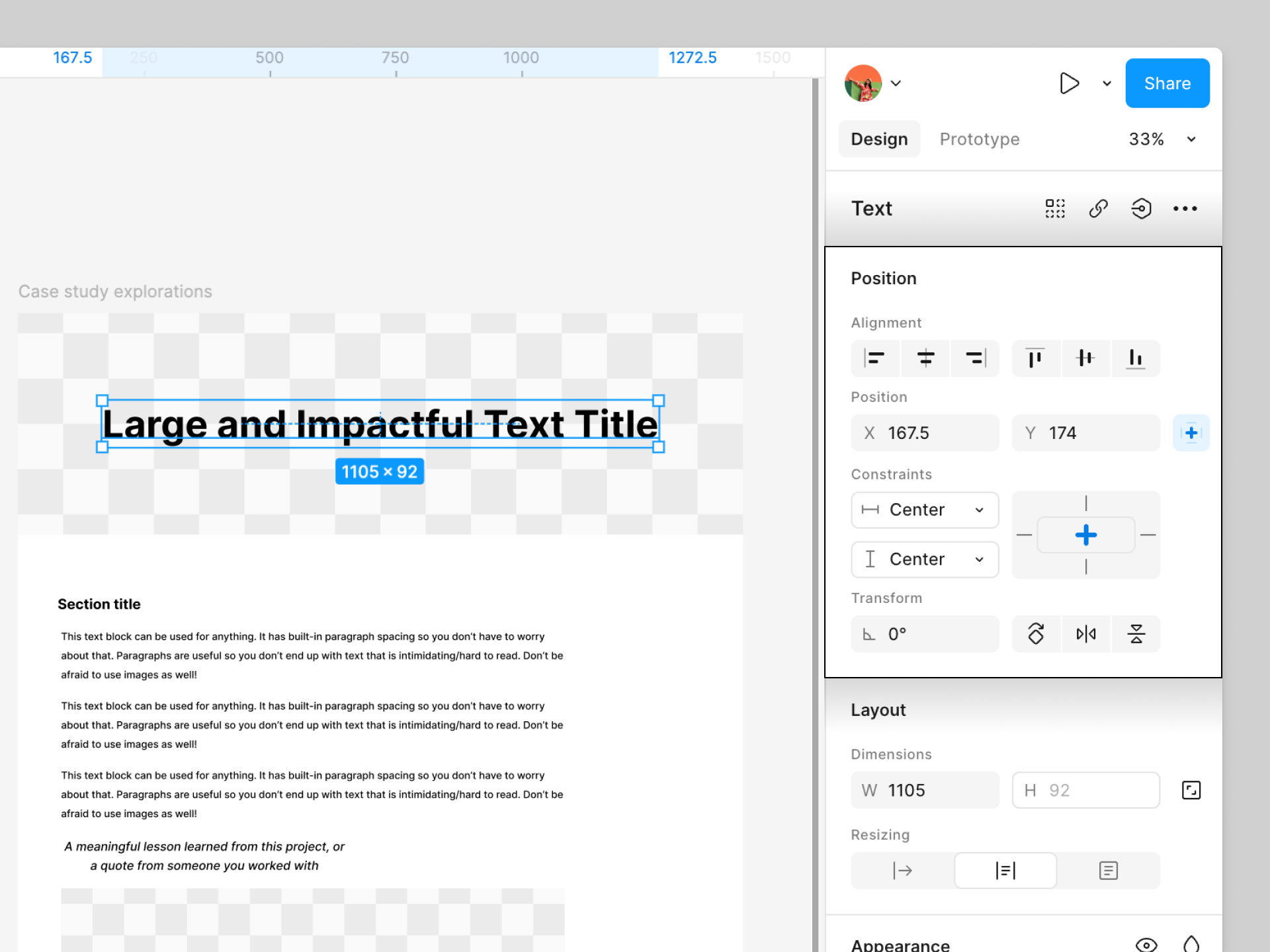

Set the text layer's constraints
When you resize this frame, the title text stays anchored to the top, but we want it to anchor to the center. We'll use constraints to change this behavior
- Select the text layer inside the Impactful text frame.
- Change the layers constraints to Center and Center.
- Click Align horizontal center and Align vertical center to center the text inside the frame.
Now when we resize the frame, the text layer stays centered.
