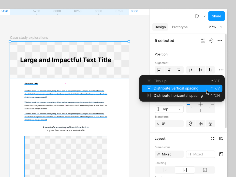

Before moving on, let's tidy things up inside the Case study explorations frame.
Align all of the elements inside the frame
- Select the Case study explorations frame and press Enter to select all of the child layers inside it.
- Click Align horizontal centers to center everything.
- Open the More actions menu in the Position section and select Distribute vertical spacing.
This distributes our elements evenly apart on the vertical axis, which allows us to use smart selection to quickly rearrange our elements.

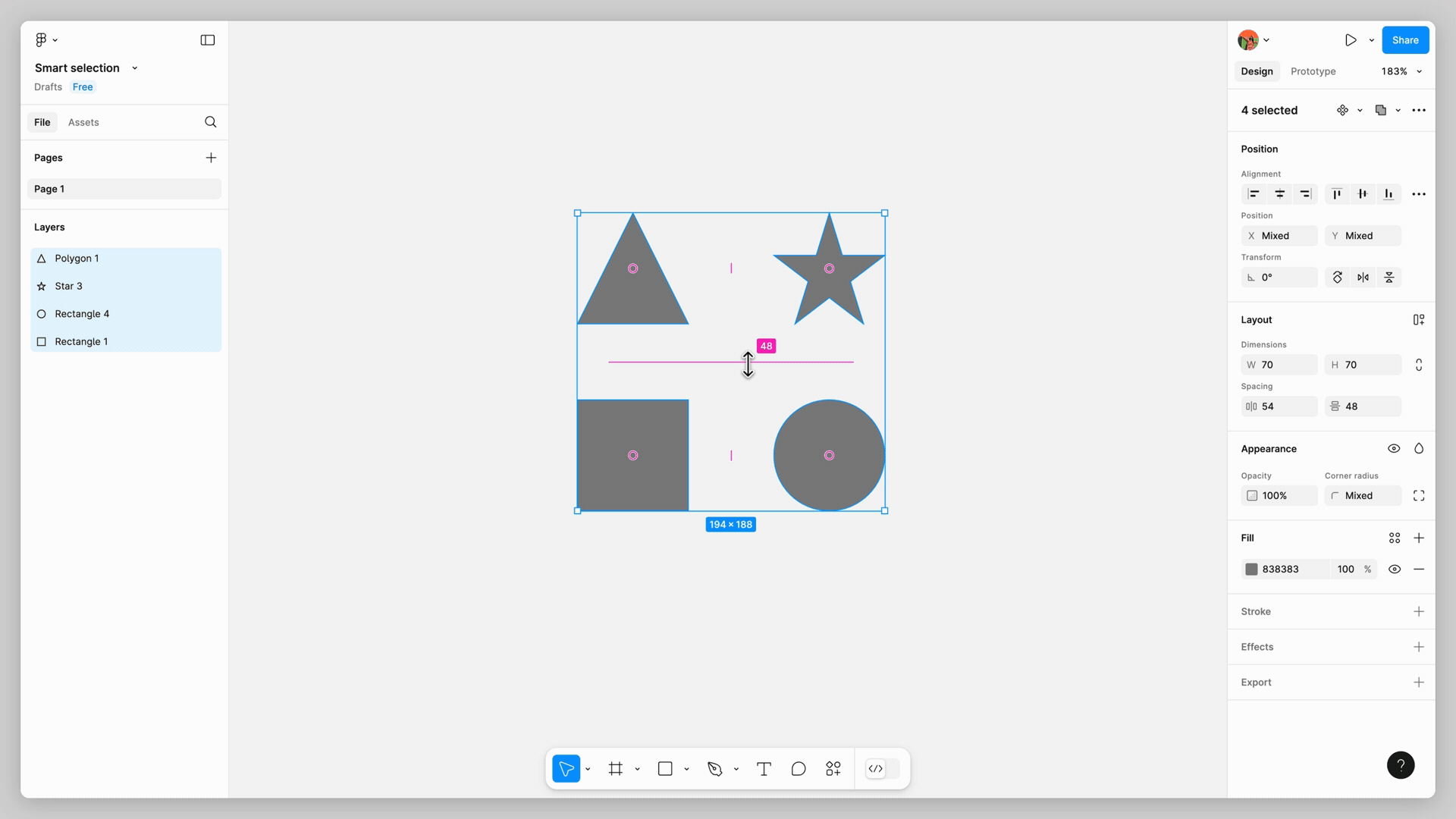

Use smart selection to rearrange layers
When a selection of objects are spaced evenly apart on both the horizontal and vertical axes, you get access to smart selection.
Smart selection lets you quickly rearrange and adjust spacing between two or more layers in a selection without having to go through the tedious task of adjusting it manually.
You’ll know when smart selection is available if you hover over the selected elements, and you see pink circles and pink handles. Learn more about smart selection.
Tip: Smart selection can be a great tool to help you experiment with different layouts throughout the early phases of the design process. Feel free to play around with smart selection using the elements on the case study page, but don't stress too much about perfecting the spacing and layout. We'll revisit these elements in an upcoming lesson when we learn about auto layout.
