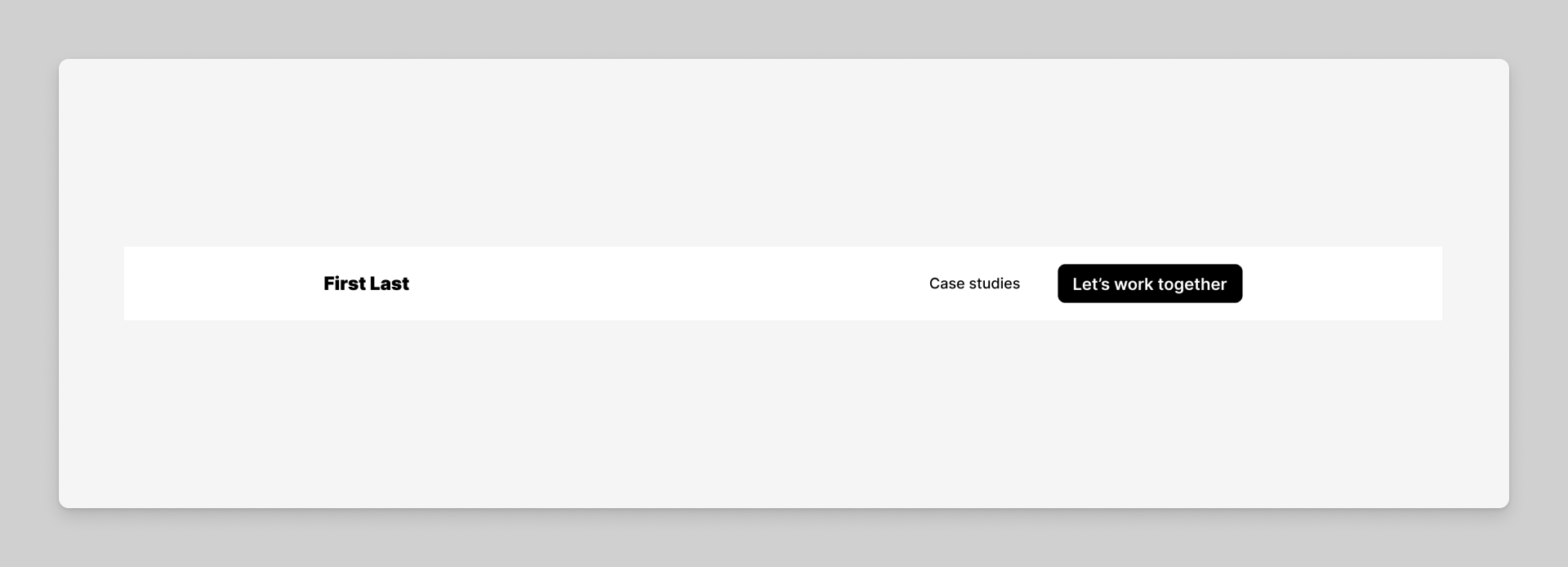

Create the navigation bar
First, we’ll build the navigation bar, which we’ll call the nav bar for short. The nav bar will be the primary navigation menu for people visiting our portfolio and will include space for a wordmark, menu items that link to pages in our site, and a button to open a contact page or email form.

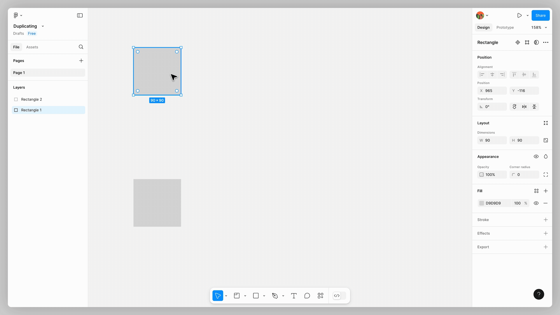

About duplicating objects
Duplicating an object streamlines the copy and paste process into a single step, making it a fast and easy way to replicate objects like layers, frames, sections, or instances.
There are two primary ways to duplicate an object: using the modifier key or the keyboard shortcut.
To duplicate an object using the modifier key, select the object and drag your cursor while holding the key:
- Mac: ⌥ Option
- Windows: Alt
You can then place the duplicated object anywhere on the canvas.
Tip: Once duplicated, you can use Tidy up and Smart selection to evenly space a selection of duplicated objects, adjust the horizontal or vertical spacing between objects, or rearrange objects into neat rows, columns, or grids.
To duplicate an object with the keyboard shortcut, select it and press:
- Mac: ⌘ Command D
- Windows: Control D
When using the shortcut method on shapes, text layers, components, and child frames, the duplicated object is placed directly on top of the original. You can then click and drag it to move it to its new position. For top-level frames and sections, the duplicated object appears to the right of the original where there is space on the canvas.
If you immediately use the keyboard shortcut on a duplicated object, Figma will maintain the same distance used between the first and second objects. Similarly, if you duplicate an object, rotate the duplicated object, then continue duplicating the object using the shortcut, the new objects will maintain the degree of rotation. These are great ways to create repeating patterns and custom shapes.

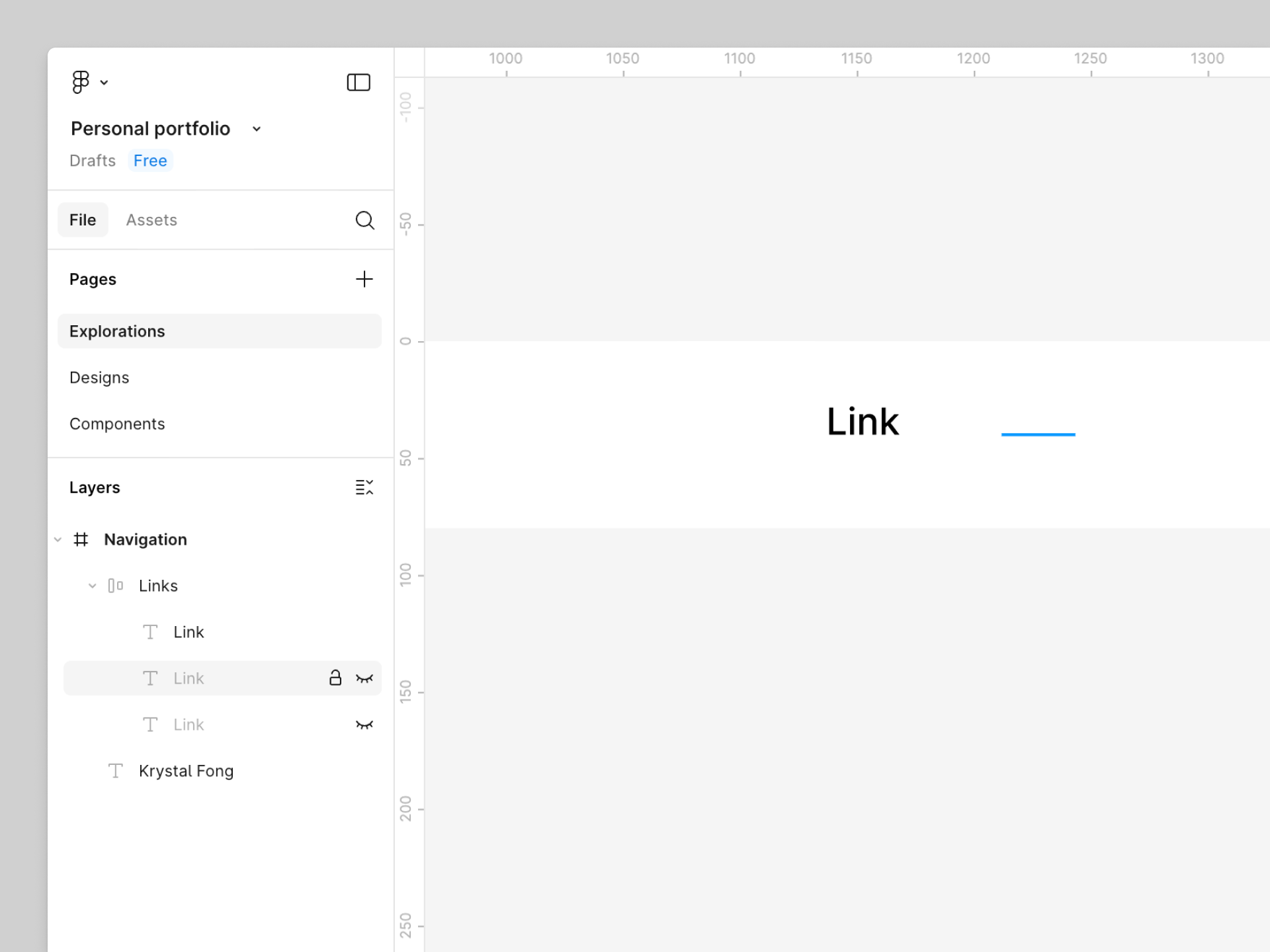

Hiding unused layers in an auto layout frame
Let’s pause for a moment and talk about the flexible nature of auto layout. Remember when we mentioned future-proofing our design elements? Well, by incorporating auto layout, we’re ensuring our designs can adapt to different configurations.
If we wanted to add more menu items, we could create another text layer and drag it into the Links frame. Or, we could select an existing text layer and duplicate it using the shortcut we just learned. Either way, the auto layout frame will automatically grow to accommodate these changes.
If we wanted to remove menu items, we could delete the extra layers. That method works but it is a permanent change. Later on, when we add instances of our navigation bar, we won’t be able to add additional menu items without changing the main component, which would impact every instance in the file.
Instead, we can hide layers we don’t immediately want to use. Hiding a layer toggles the visibility of that layer without removing it from the frame. Auto layout respects the hidden layer and adjusts the frame as if the layer were removed.
To hide a layer:
- Toggle the visibility icon in the layers panel. You can also click and drag down to toggle multiple layers at once.
- Or use the keyboard shortcut
- Mac: Command Shift H
- Windows: Control Shift H
Later on, you can unhide the layer on individual instances where its needed and auto layout will accommodate the newly visible layer. Learn more about toggling layer visibility.

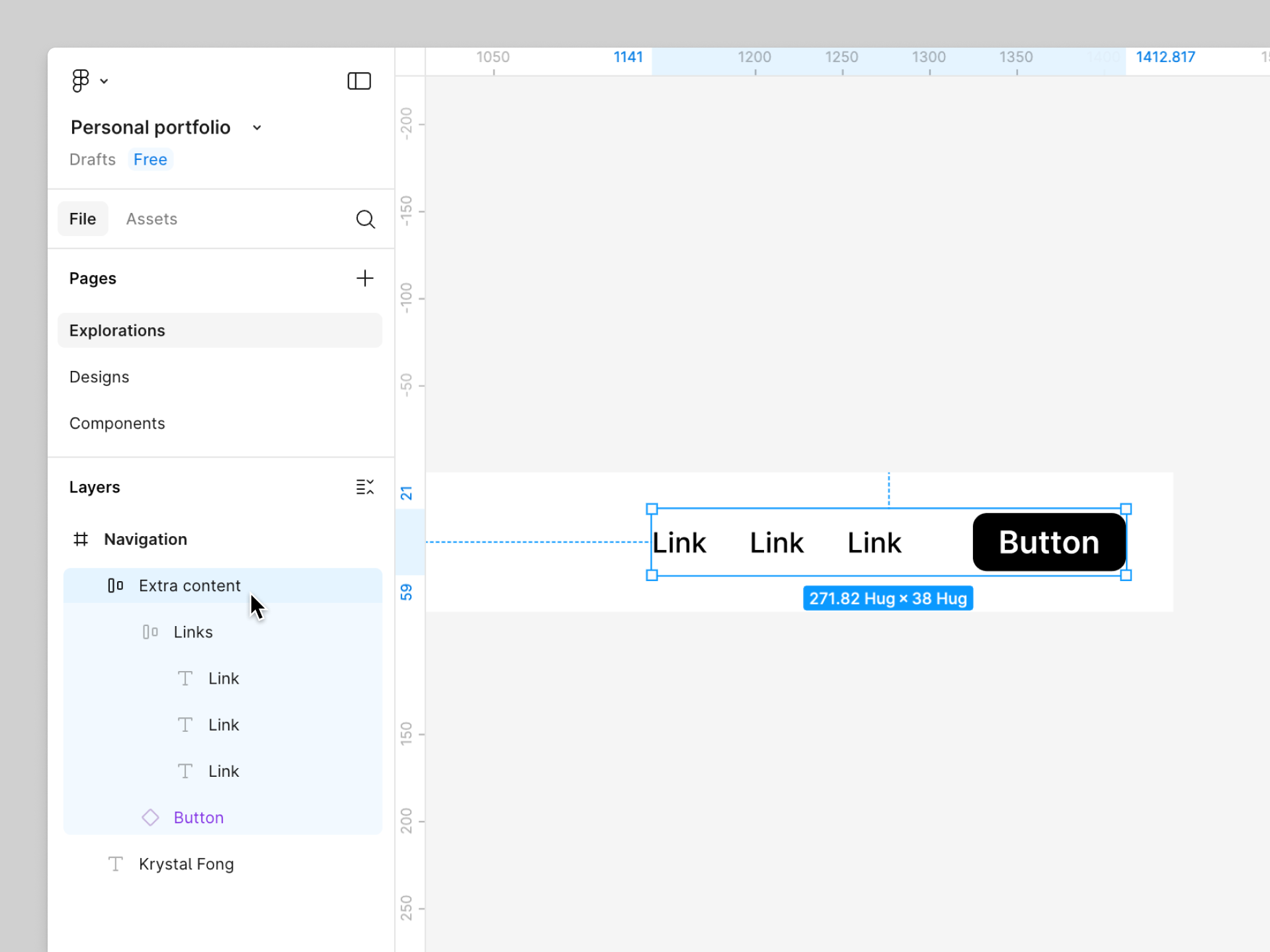

Add an instance of the button
The nav bar is starting to come together! Now, let’s add a button. Head over to the Assets tab in the left sidebar and select Local assets. Remember that button component we created earlier? Let's add an instance of it to the nav bar:
- Click and drag an instance of the button into the Navigation frame.
- Place it just to the right of the Links frame and use the guide to center it.
- Select both the button and the Links frame, and press Shift A. We’re making a new frame here, rather than adding the button to the Links frame, so we can independently control the spacing between the menu items and the button.
- Adjust the Horizontal gap to
40
. - Set both resizing properties to Hug contents.
- Rename the frame to Extra content.

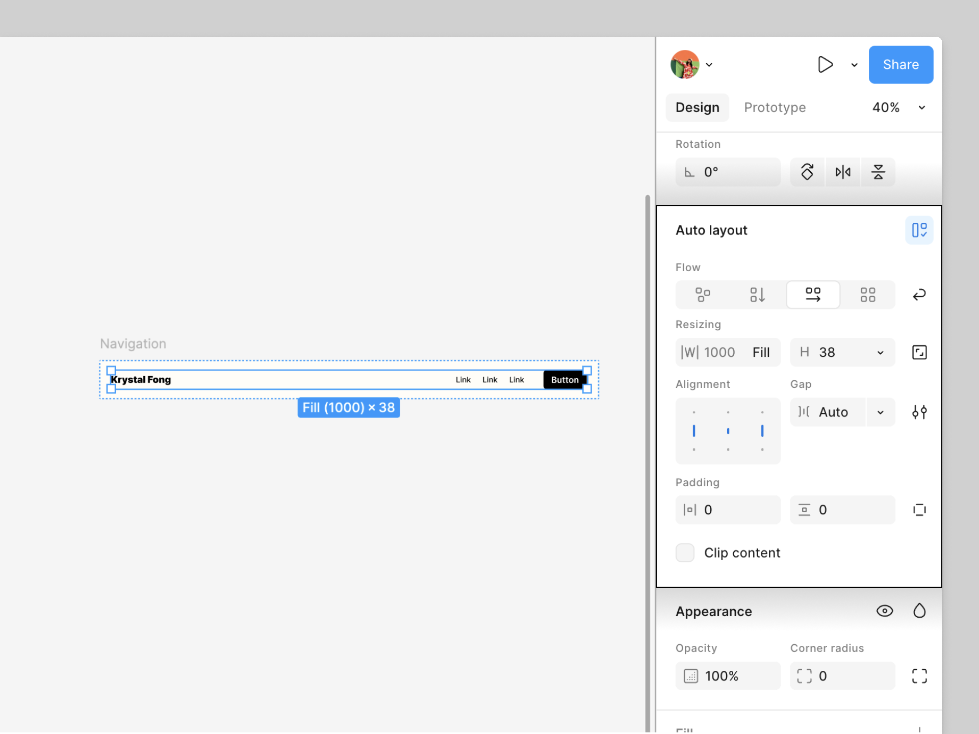

Add the final touches
Remember when we created the elements for our case study page? We set the Max width to 1000
, so they’ll all remain aligned on the page. We want the nav bar’s content—the wordmark, menu items, and button—to line up with the rest of those elements, while still allowing the Navigation frame to span the full width of the website. To do that, we need to connect the wordmark layer with the rest of the nav bar content.
- Select the wordmark layer and the Extra content layer.
- Add auto layout with Shift A.
- Rename the new frame to Content.

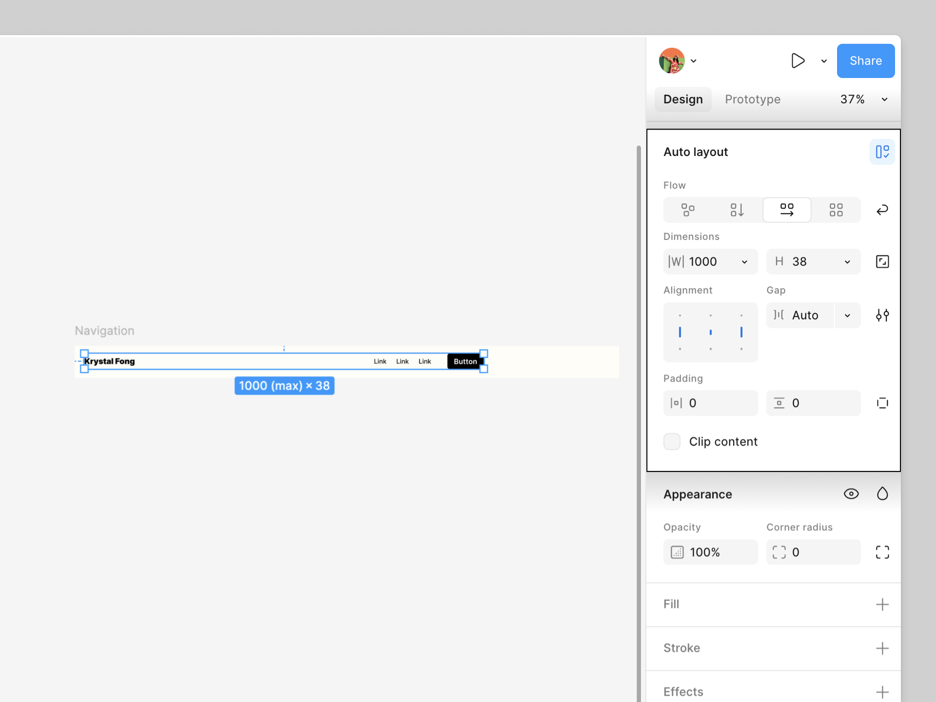

- Set the Max width for the frame to
1000
and leave the height resizing property set to Hug contents. - Set the horizontal gap to Auto.
Note: Setting a resizing property to Auto equally distributes the available distance within the parent frame between the child layers. Because we only have two sets of layers—our wordmark and the Extra content frame—Auto gap will push them to the edges of the frame, as far apart as possible.

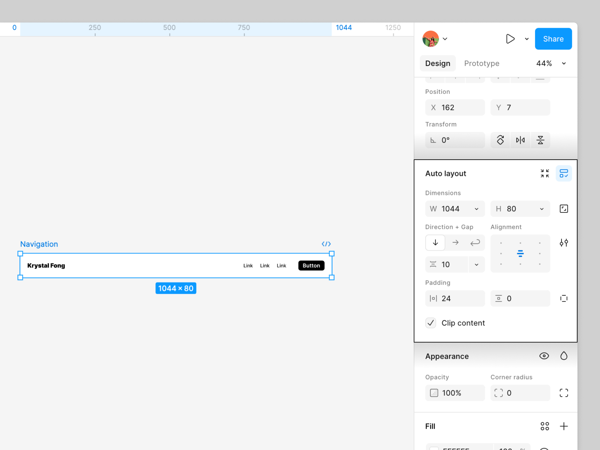

Add auto layout to the Navigation frame
Next, we'll apply auto layout to the Navigation frame.
- Select the Navigation frame and press Shift A.
- In the Auto layout section, set the height resizing to Fixed and make sure the value is set to
80
. - Set Horizontal padding to
24
and the Vertical padding to0
(zero) and the frame’s alignment to Center.
Now that the Content frame is inside a parent frame with auto layout applied, we can update its width resizing:
- Select the Content frame inside the Navigation frame.
- Make sure the Width resizing is set to Fill container.
- Finally, set the Content frame’s alignment to Center.

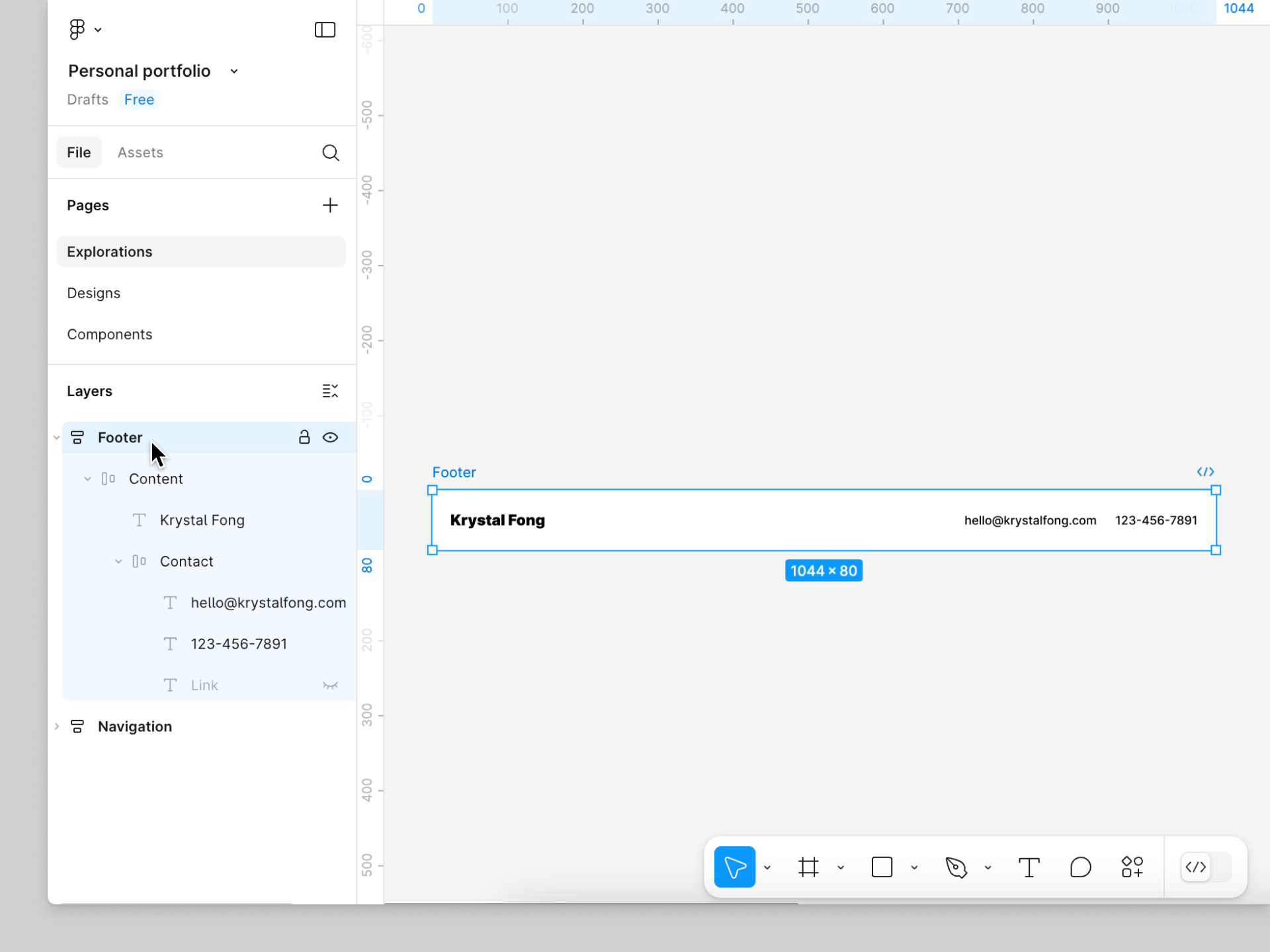

- Duplicate the Navigation frame.
- Rename the duplicated frame to Footer.
- Unlike the nav bar, we don’t need a button in the footer. Locate the Button layer in the Layers section and delete it.
- We want to keep the Links frame, but the Extra content frame is no longer doing anything so we can remove it. Select the Extra content frame, right-click, and select Ungroup. Ungrouping a frame removes it from the canvas and pushes its child layers up in the layer hierarchy.
- We’ll use this space for our contact info so let’s rename the Links frame to
Contact

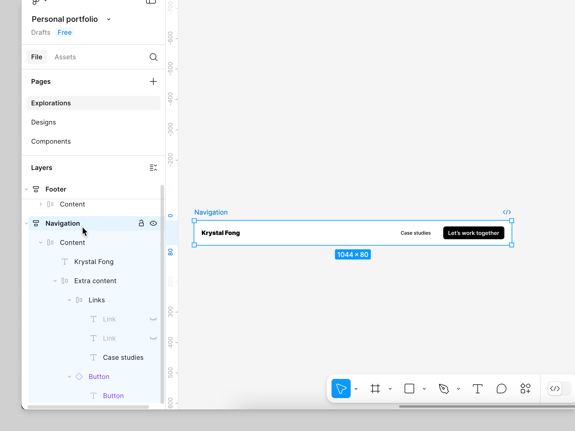

Customize the navigation bar
Because we want the content in the nav bar and footer to be the same on every page, let’s update the copy before turning them into components. That way, we won’t have to update the copy in every instance we add.
- In the Navigation frame, update one of the menu item labels to
Case studies
. - Since we only need one link at the moment, we'll hide the other two text layers for now.
- Update the button's label to give it a strong call to action like "Let's work together".
Customize the footer
- Update the text layers to include your email address, phone number, or other contact information.
- Hide the third text layer for now.
