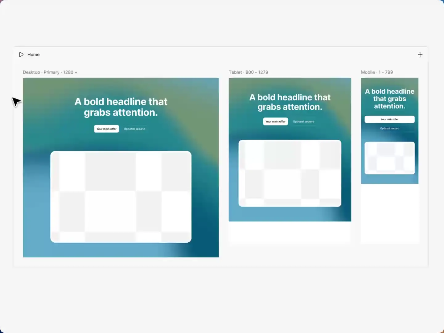

If your webpage uses more than one breakpoint, you can add, select, and edit objects across all breakpoints simultaneously.

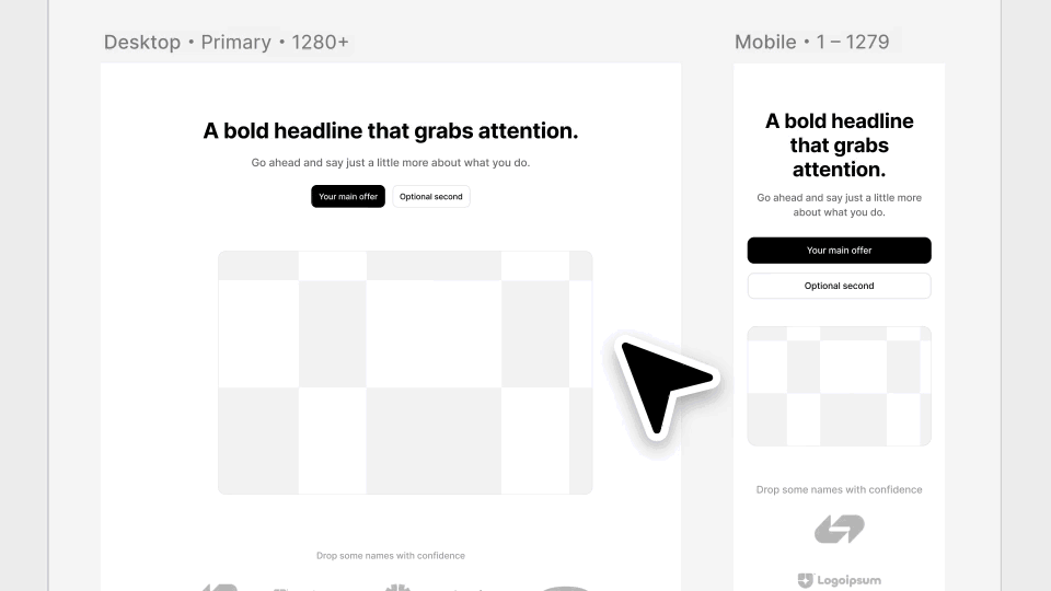

Understanding primary and secondary breakpoints
Every new webpage starts with a primary breakpoint—usually the desktop breakpoint.
When you add additional breakpoints, any changes made to objects in the primary breakpoint cascade to the other—secondary—breakpoints. In contrast, changes made in a secondary breakpoint apply only to that specific breakpoint.
For example, if you drag a hero section into a primary breakpoint, it will immediately appear in all secondary breakpoints. If you add the hero section to a secondary breakpoint, it will only appear on that breakpoint.
This behavior applies to adding, selecting, and editing objects.

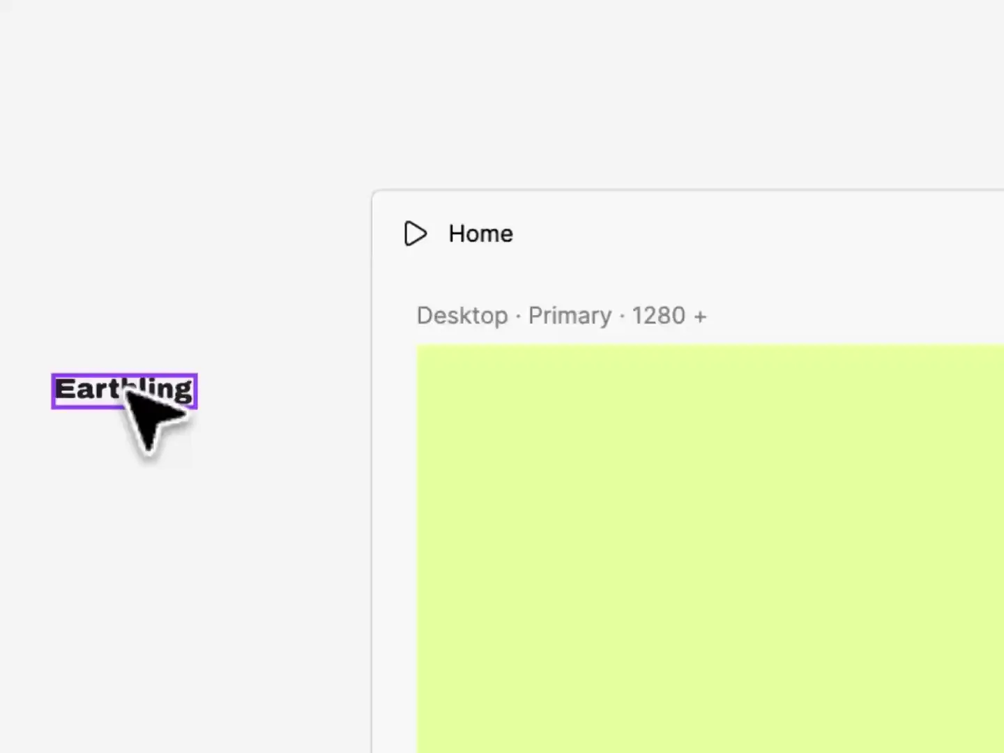

Add an object to multiple breakpoints
What happens when you add an object to a webpage with multiple breakpoints depends on whether you add it to a primary or secondary breakpoint.

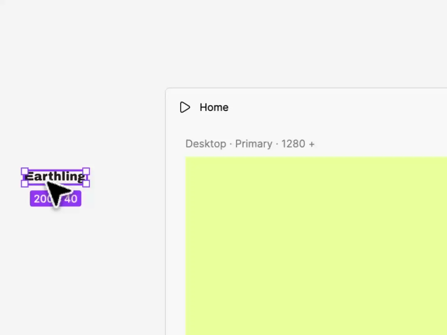

Add to the primary breakpoint
When you add an object to the primary breakpoint, it is automatically added to all secondary breakpoints.
Add to a secondary breakpoint
When you add an object to a secondary breakpoint, it is visible on that specific breakpoint and hidden in the other breakpoints. This helps maintain a shared hierarchy in the webpage.

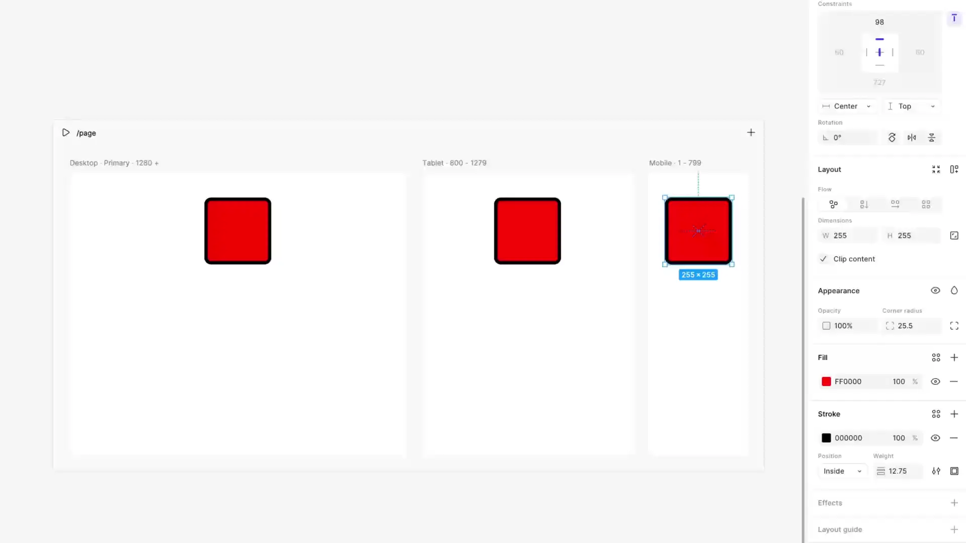

Edit an object across breakpoints
What happens when you edit an object across breakpoints will depend on whether the object has been previously edited on a secondary breakpoint.
When you edit an object in the primary breakpoint, Figma checks each of the object’s properties.
- If a specific property has been modified in a secondary breakpoint, an edit in the primary breakpoint will only apply in breakpoints where that property hasn’t been modified.
- If the property hasn’t been modified in a secondary breakpoint, the edit will apply across all breakpoints.
Example
Suppose you have a frame in desktop, tablet, and mobile breakpoints.
- Change the fill color of the frame in the mobile breakpoint.
- Then change the fill color in the primary (desktop) breakpoint.
Notice the updated fill color will only appear in the desktop and tablet breakpoints because the mobile breakpoint’s fill property was previously modified.
Other changes to the frame—like adjusting its height in the primary breakpoint—will apply across all breakpoints, because the height property has not been overridden in any secondary breakpoints.
Tip: If you’ve edited an object in a secondary breakpoint and want it to match the primary breakpoint version again, right-click on the object and select Reset all changes. The object will inherit edits on the primary breakpoint for all the reset properties once more.
