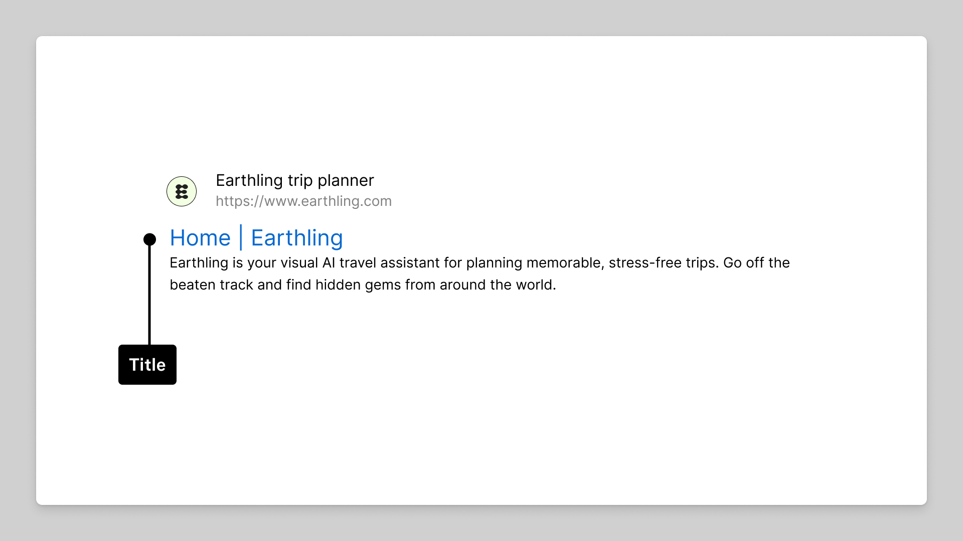

Add a title
The title appears in browser tabs, search engine results, and on social media. Adding a clear title helps people understand where they are in their browser, supports SEO, and improves accessibility.
If no page title is provided, Figma will display the site’s title instead. If neither is available, Figma will generate a title for the site.

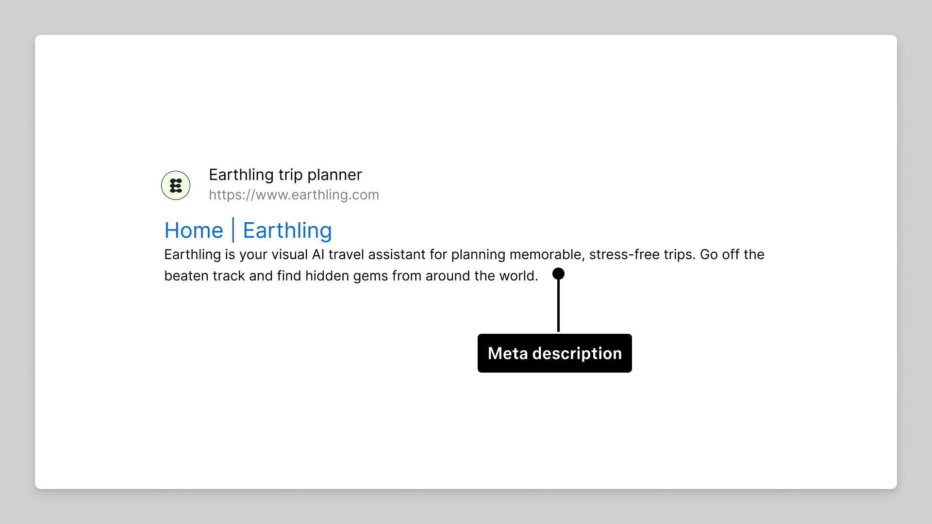

Add a meta description
A meta description is a short summary of the website or page content. It is designed to attract users and improve click-through rates from search engine results pages (SERPs).
For the entire website, the meta description ensures a consistent summary is available when specific pages do not have one.
On individual pages, you can provide a unique meta description tailored to that page; otherwise, the global meta description will be applied.

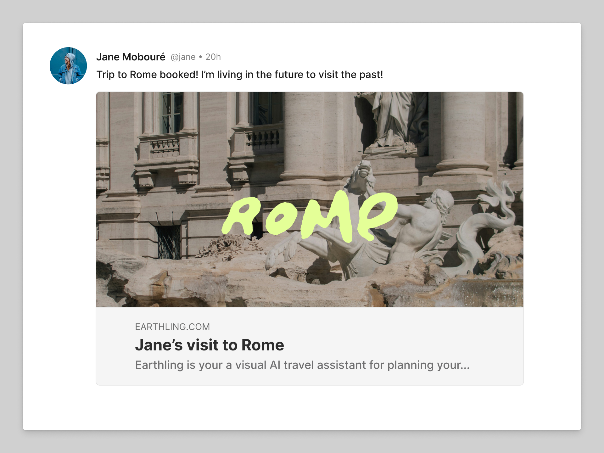

Add a social sharing image
The social sharing image appears when your website—or any of its pages—is shared on social media. The site-wide social sharing image will be used whenever a page-specific image isn’t provided. If neither is available, Figma will use an image snapshot of your site instead.
We recommend using an image that is 1200px wide by 630px tall.

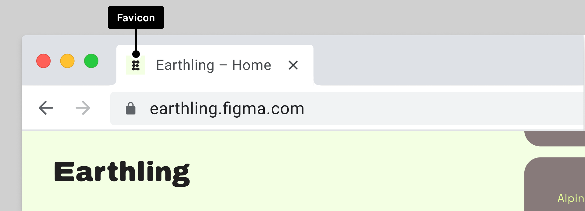

Add a favicon
A favicon provides a small visual representation of your website in browser tabs, search results, and bookmarks.
To add a favicon to your site, place an image or design on the canvas in your site file, then choose it in the settings modal.
Tip: For best results, we recommend using a 48px x 48px image or frame.

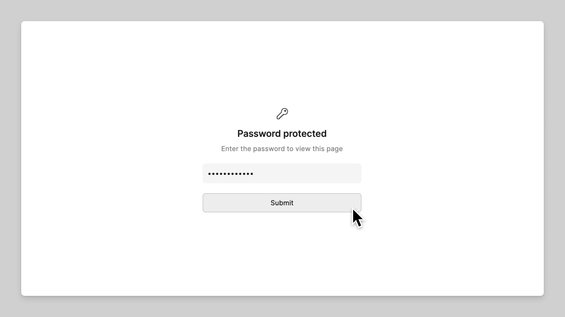

Add password protection to your site Paid plans
When password protection is enabled, visitors must enter a password to view your published site’s content, including metadata such as the page title and description.
You can apply a single password to the whole site or to individual pages. Keep the following in mind when applying a password to individual pages:
- Password protection remains in place even if the URL path changes—for example, if you rename
/portfolioto/clients. - When publishing a CMS page, all dynamic pages generated from that CMS path will share the same password protection. For example, if you password-protect your CMS page
/blog, any associated pages like/blog/article-1and/blog/article-nwill also be protected.
When setting a password, you can create your own or use one automatically generated by Figma:
- Custom passwords must be at least four characters long and may include any combination of characters
- Figma-generated passwords combine four random words, making them strong and unique
The password will automatically apply to your published site as soon as you save it. When making changes, you don’t need to republish—although the changes may take a minute or two to take effect.
Note: If you add a password to a published site which has not been excluded from search engine results, some metadata may continue to appear in search listings. Once password protection is enabled, search engines will no longer be able to index the site, and it will typically disappear from results over time. If you want to speed up the process, you can request removal through Google Search Central.
Once set, you can’t view a password again. If you forget to copy it, you’ll need to create a new one. When you change the password, anyone with prior access will need to enter the new password the next time they refresh or navigate to a different page within the site.

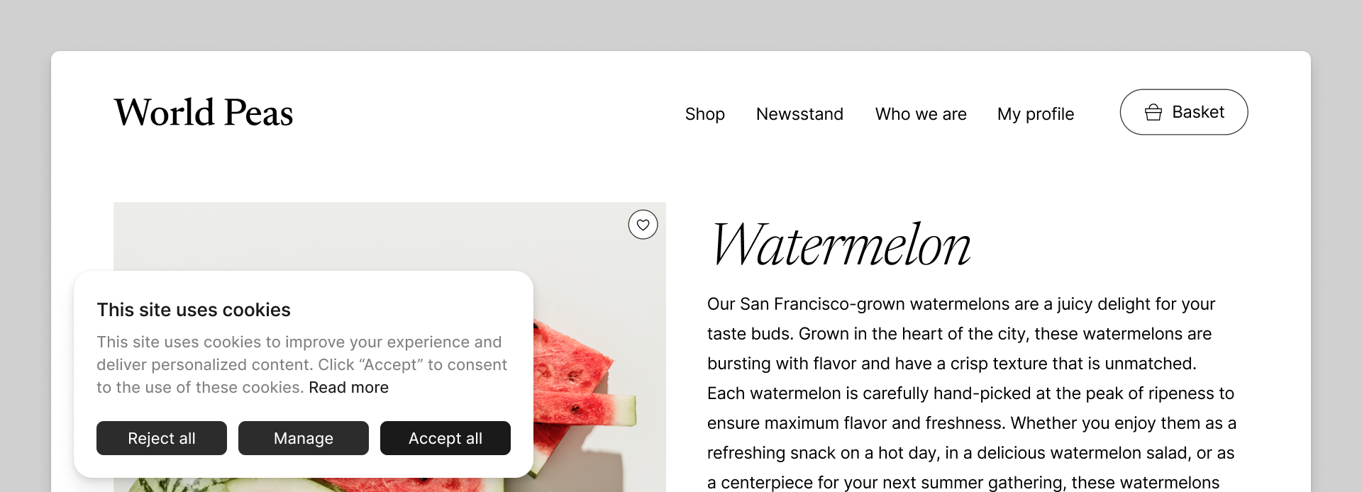

Add a cookie consent banner to your site Paid plans
Figma Sites includes a built‑in cookie consent banner that lets visitors approve, reject, or manage non‑essential cookies, like those used by analytics and third-party embeds.
Learn more about how the cookie banner works.
