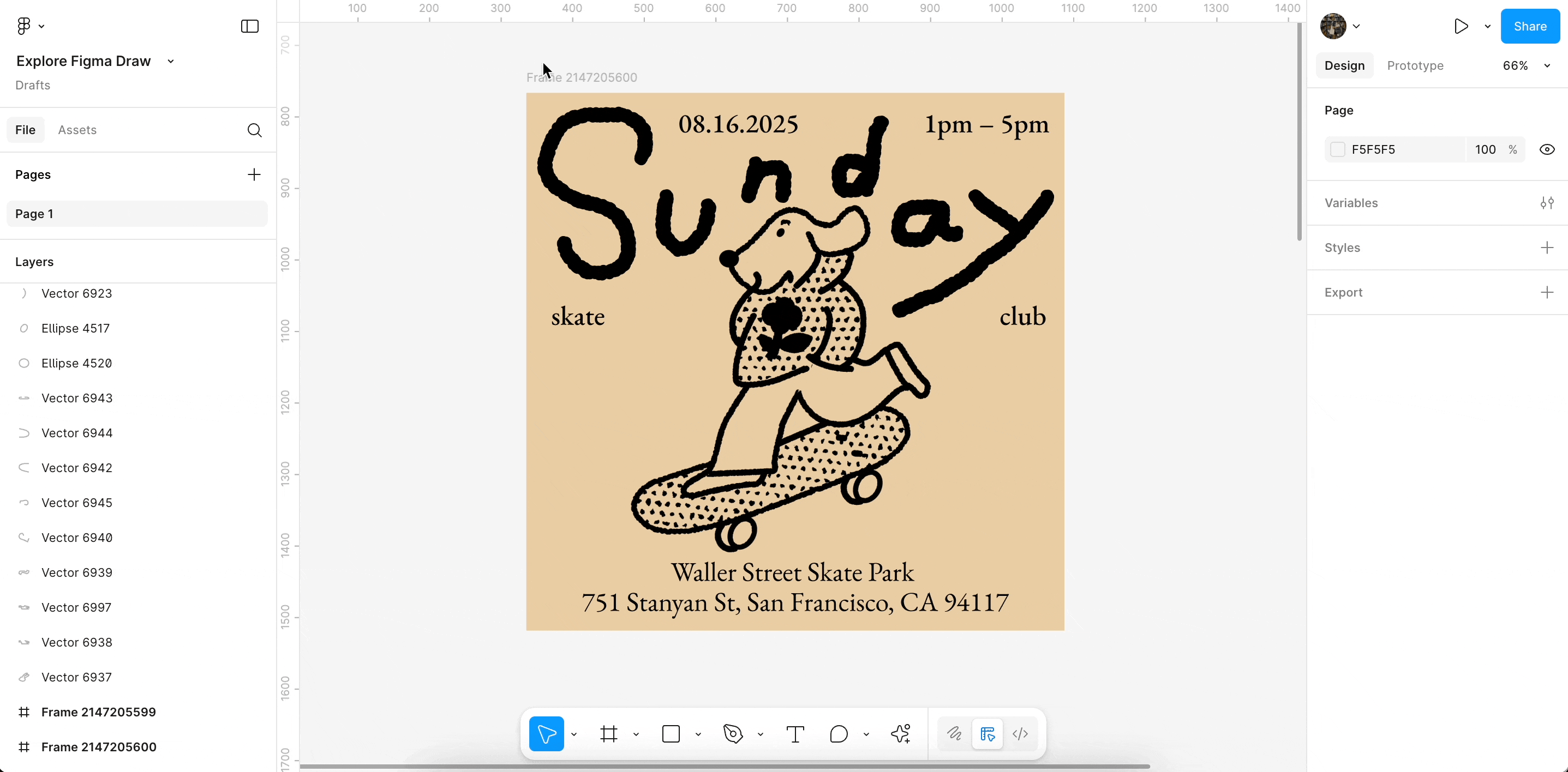

Enter Figma Draw
Figma Draw is a set of visual design tools within the Figma Design editor. To open Figma Draw, click Draw in the toolbar.
Note: Some Figma Design features are not available while in Figma Draw. Switch the toolbar toggle to Design to access all Figma Design features.

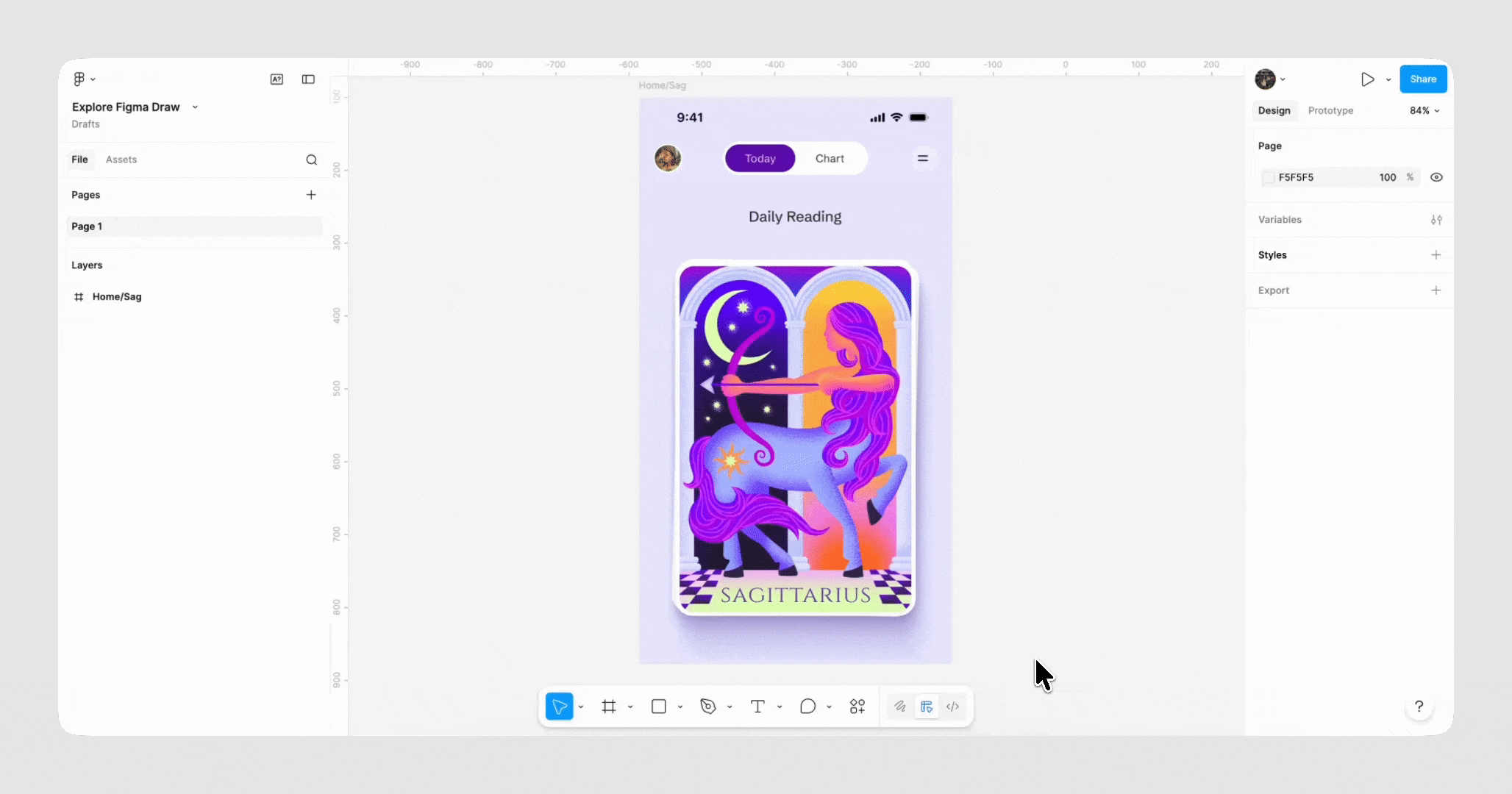

Navigate Figma Draw
While using Figma Draw, the toolbar and sidebars change to provide a set of illustration-focused tools and properties.

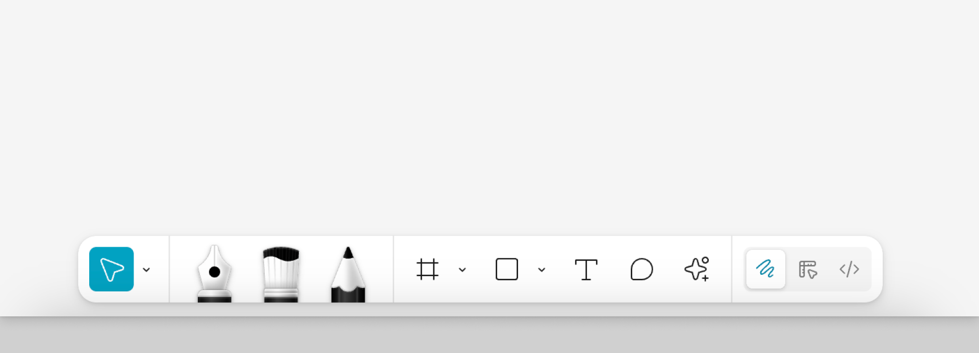

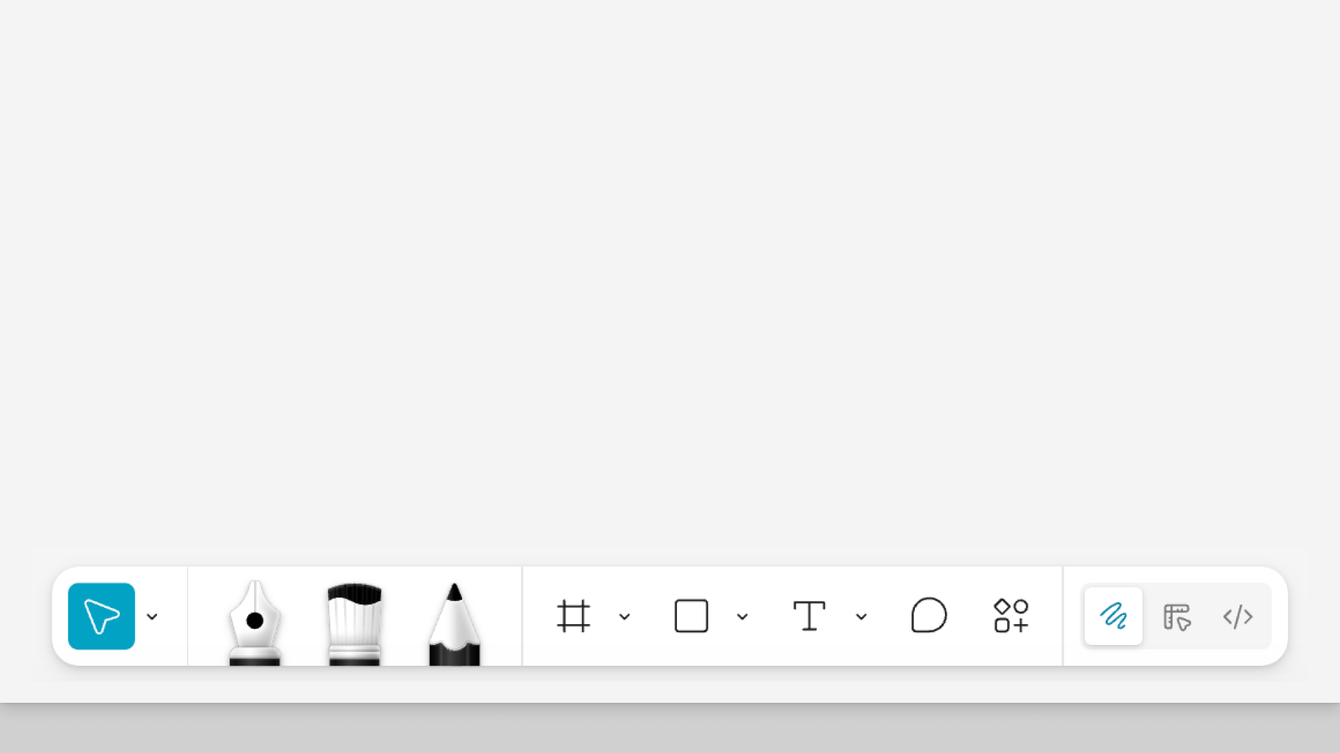

The toolbar
The toolbar changes to give you quick access to the Pen, Brush, and Pencil tools.

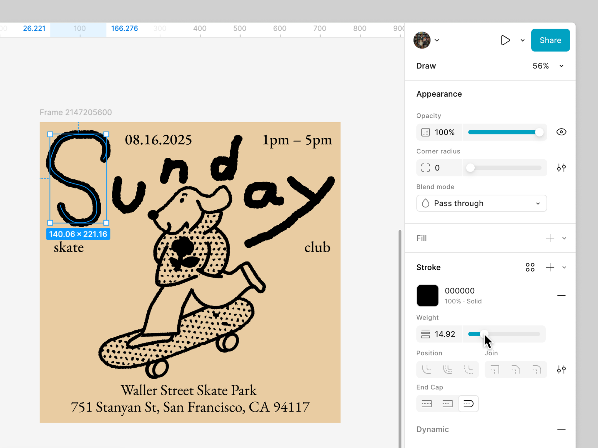

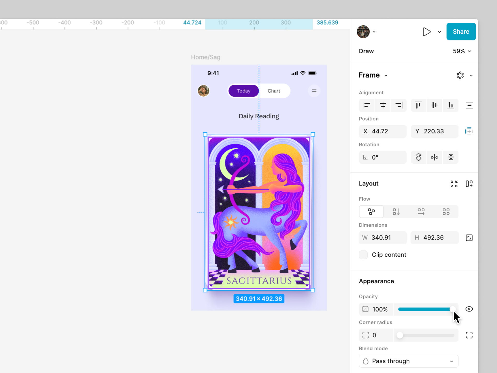

The right sidebar
The right sidebar changes to a more streamlined view of illustration-related properties, with slider controls that help you balance artistic feel with pixel-perfect adjustments. You can also access transforms from the right sidebar while in Figma Draw.

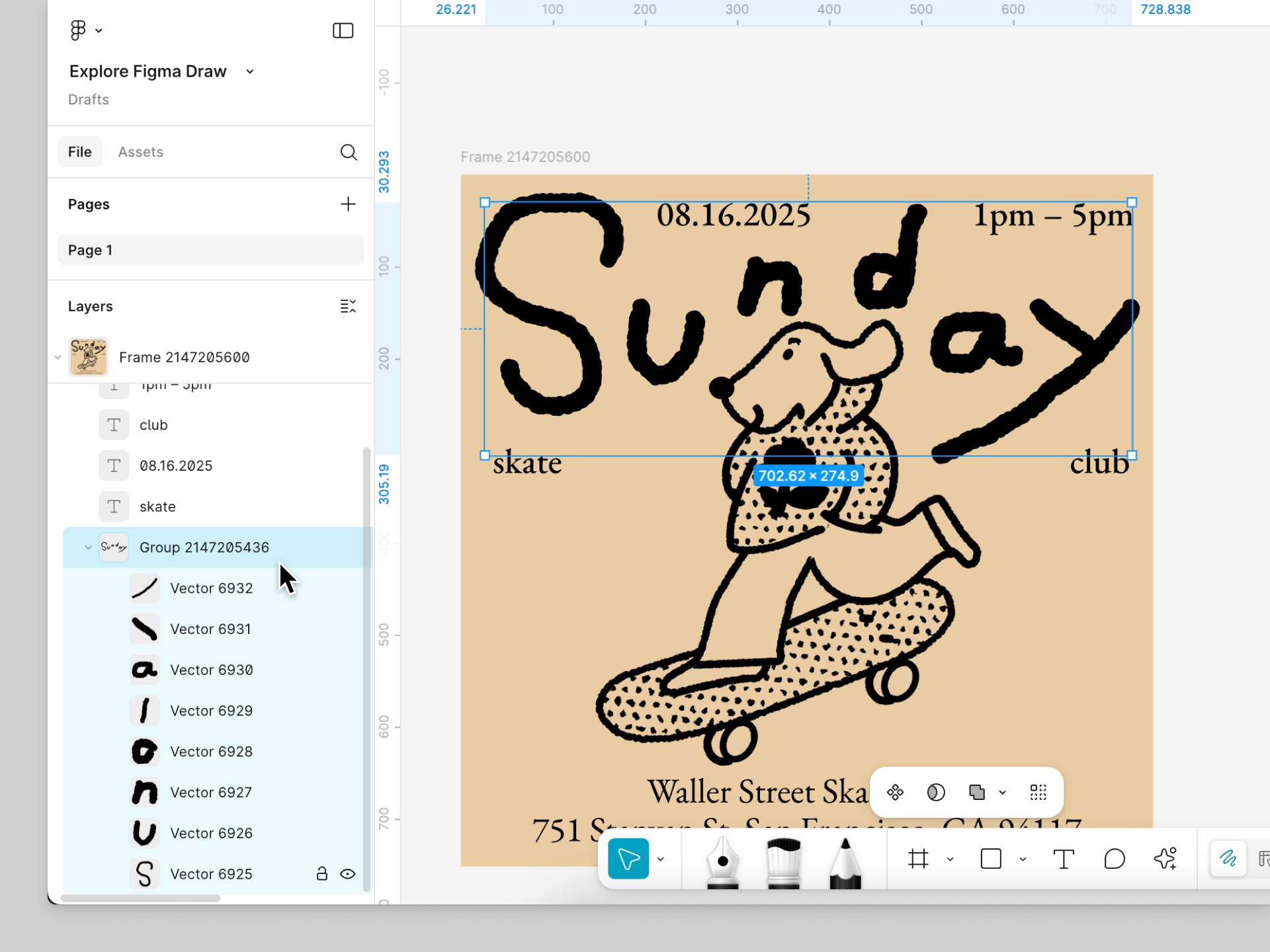

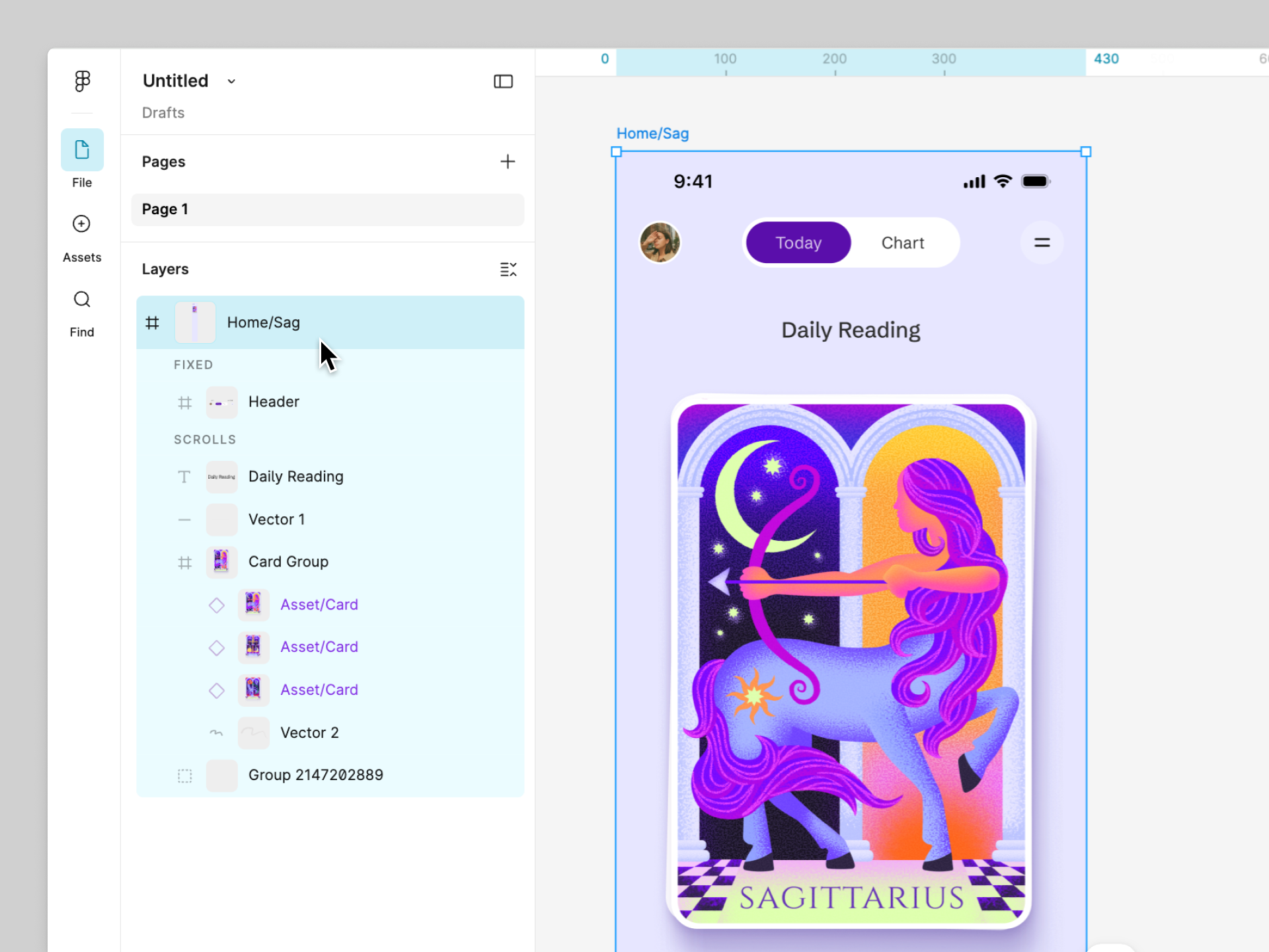

The left sidebar
The Layers section in the left sidebar displays an enlarged visual preview of the layer’s contents. Double-click on the layer preview to zoom directly to that layer on the canvas.
