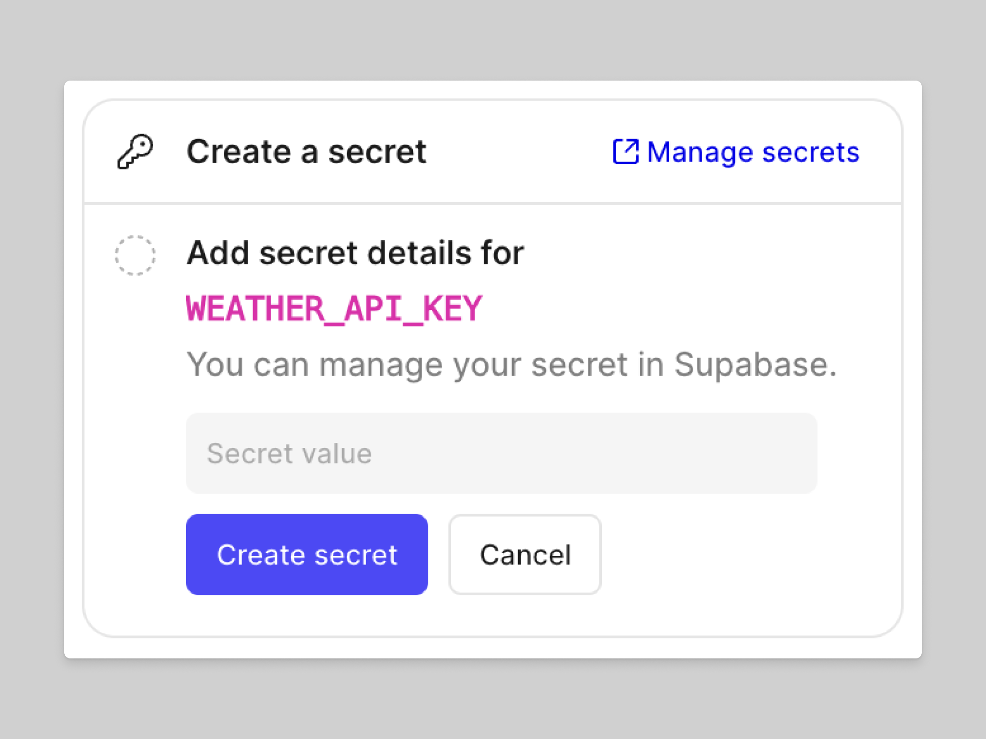

When you’re prompting in the AI chat to create your functional prototype or web app, Figma Make will ask you to set up a backend (if you haven’t done so already), and then provide an interface for you to enter your secret or API key.
Caution: You should only enter your secret or API key into the Create a secret box that Figma Make provides while you’re prompting. Do not provide your secret or API key in the actual text of your prompts.
To add a secret or API key:
- In the AI chat, tell the model that you want to add a secret for your functional prototype or web app. For example: "I want an app that lets me view stock prices. Create a secret to store my API key."
- In the Create a secret box, under Add secret details, enter your secret or API key.
- Click Create secret.
When you click Create secret, Figma Make will use Supabase to securely store the secret or API key. Then, you can continue to prompt Figma Make to add more features to your functional prototype or web app that take advantage of added secret or API key.

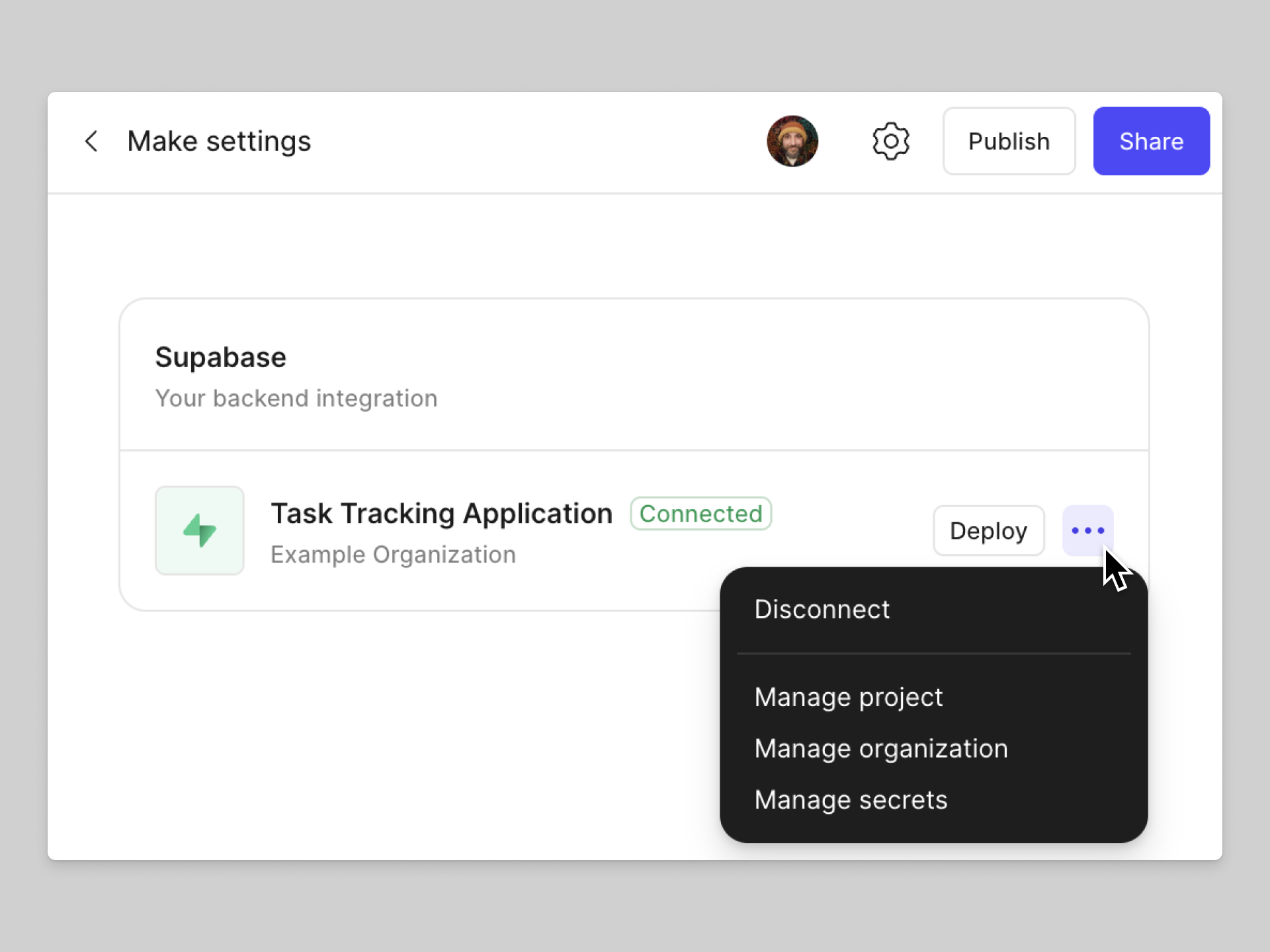

- In the upper-right corner of your Figma Make file, click Make settings.
- In the left sidebar, under Integrations, click Supabase.
- In the row for the project connected to your Figma Make file, click the ellipsis icon. Then:
- Click Manage project to go to that project’s Supabase dashboard.
- Click Manage organization to go to your Supabase organization’s settings page.
- Click Manage secrets to go to the Edge Functions database for your Supabase project.
