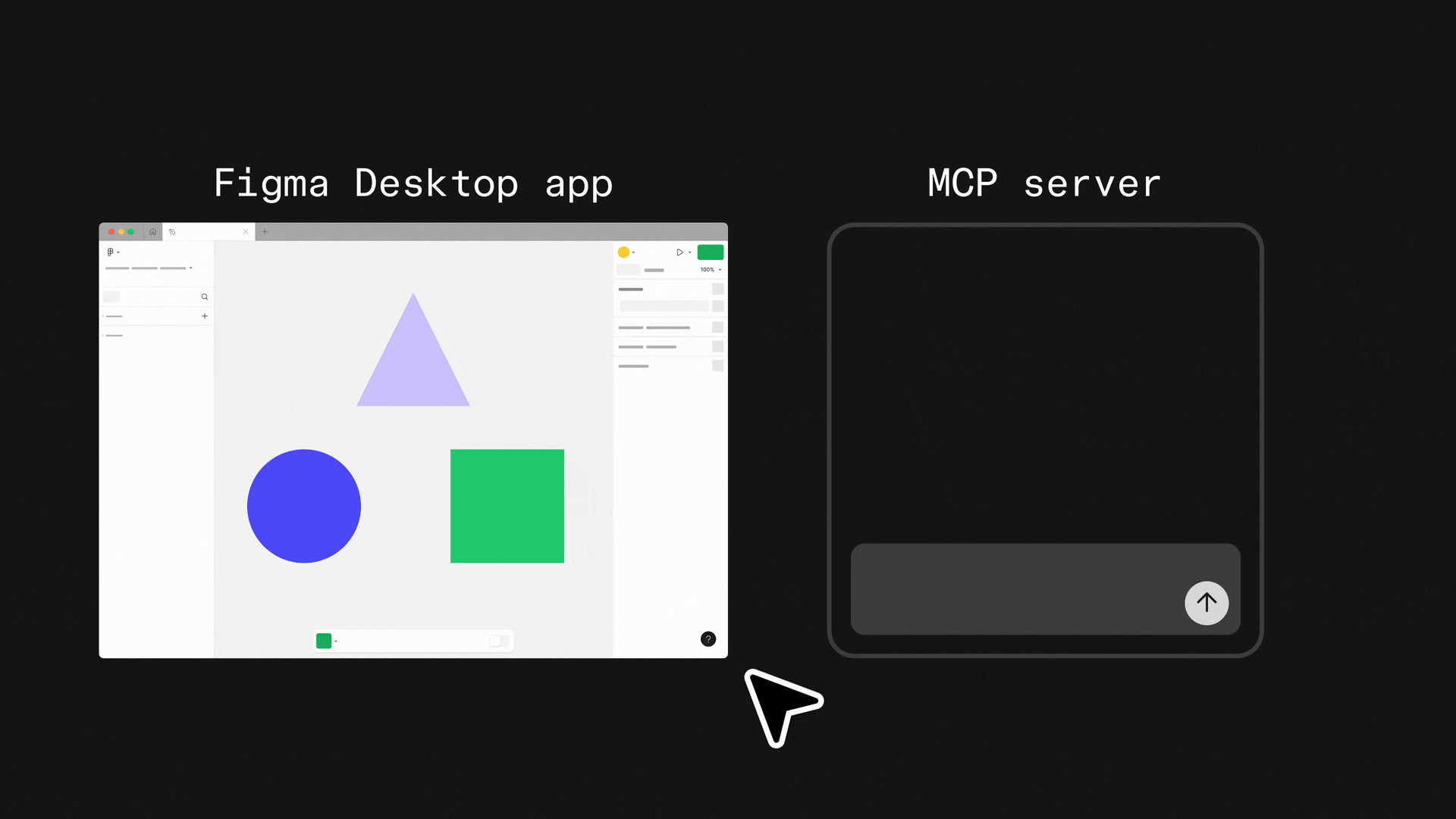

Figma's MCP server brings context from your Figma files and your design into your favorite agentic development tools—like VS Code, Claude Code, and Cursor—to keep your code aligned to your design specifications.
In this lesson, we’ll walk you through the steps to set up the Figma desktop MCP server.
In order to use the Figma desktop MCP server, you’ll need the Figma Desktop app. So go ahead and download the desktop app if you haven’t already. And if you already have it, make sure you’re on the latest version.
Figma also has a remote MCP server if you prefer to use Figma in the browser. Either way, you’ll have the tools you need to align your code with your designs.
Now let’s learn how to set up the MCP server!

Using the desktop MCP server
Now that you’ve got the desktop MCP server set up, here are a few tips on how it works.
The MCP server is selection based. This means that it can understand which layers you have selected inside of a Figma file.
Try selecting a layer in your design file from the desktop app, and enter a prompt to ask the tool to generate a react component based on the selection. The agentic development tool will read your selection in the Figma file and generate code based on the design.
