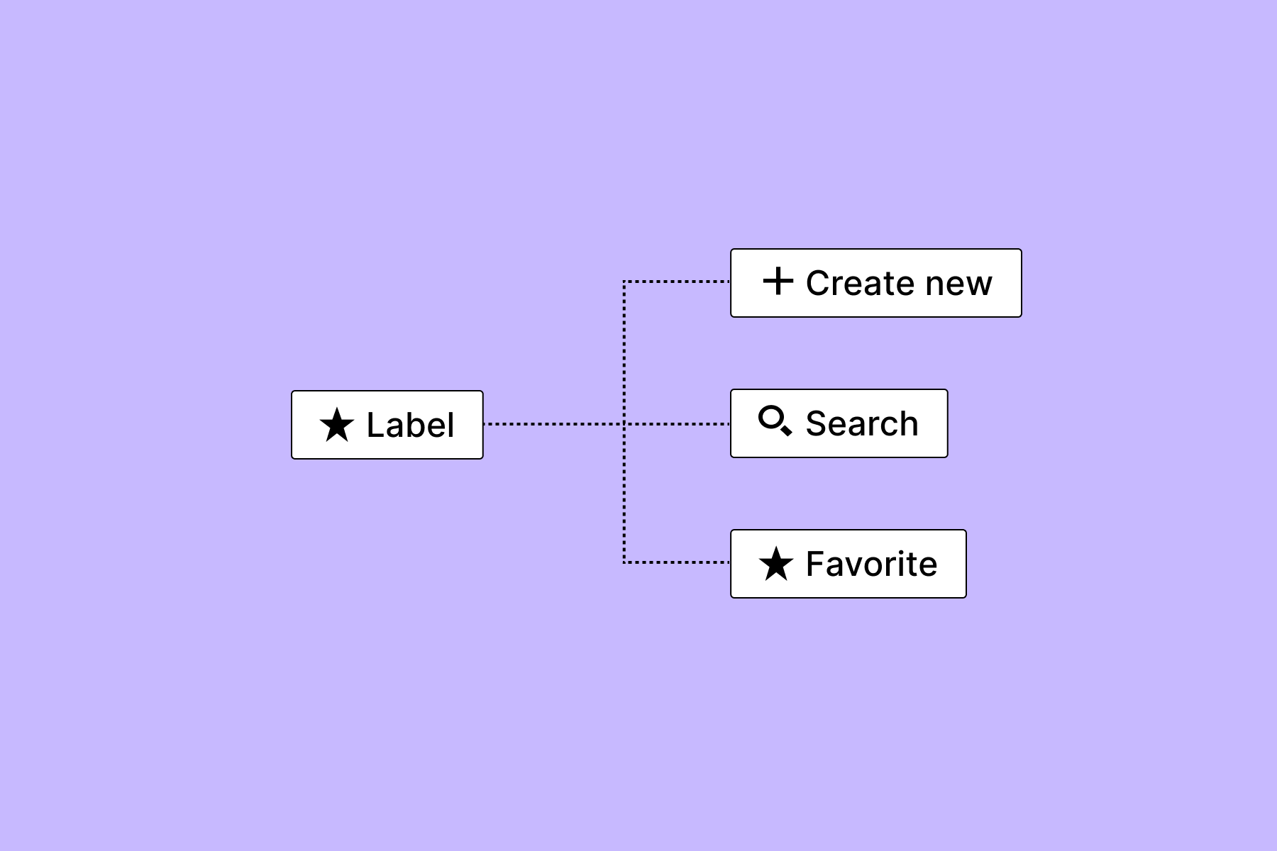

- Swap nested instances of other components, like icons

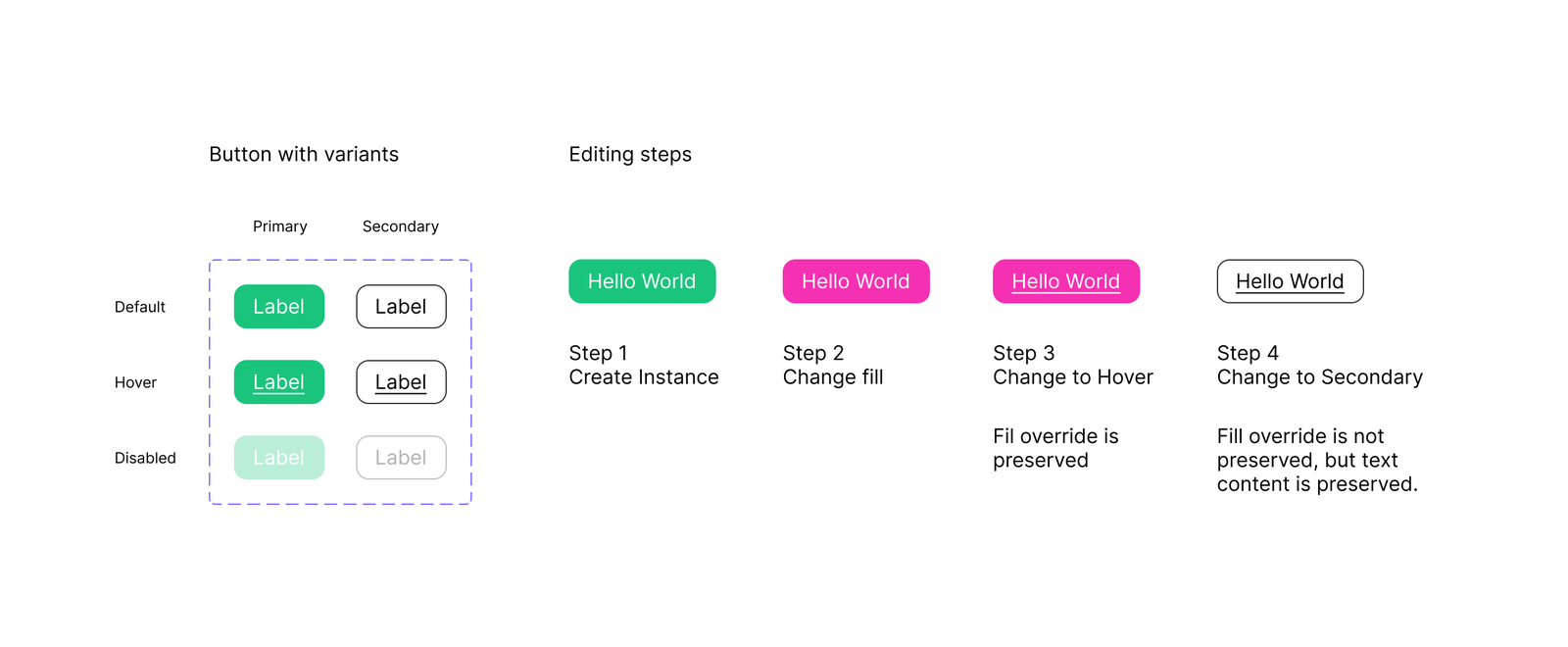

Figma attempts to preserve your changes when you select a different variant or swap between instances.
Figma uses the following criteria to determine whether to preserve a change on an instance:
- The layer names of the current instance and the variant or instance you’re selecting must match. This applies both when swapping instances and selecting variants.
- When selecting variants, Figma also checks if the layer properties you’ve changed originally matched between variants. If so, Figma will preserve your changes.
In our example below, Figma preserves the fill change on Step 3, but not on Step 4. This is because the default primary
button and hover
primary
button both started with the same fill of #1BC47D
. Our change was to change the hex code from #1BC47D
to #F531B3
Figma doesn’t preserve our change in Step 4 as the hover secondary
variant has a fill of #FFFFFF
, which is different to the fill we applied our original change to (#1BC47D
The criteria is less strict for preserving text changes. Figma keeps any changes you’ve made to text layers if the name of the text layer is the same between components. Figma will also check if the text layer’s hierarchy is similar.

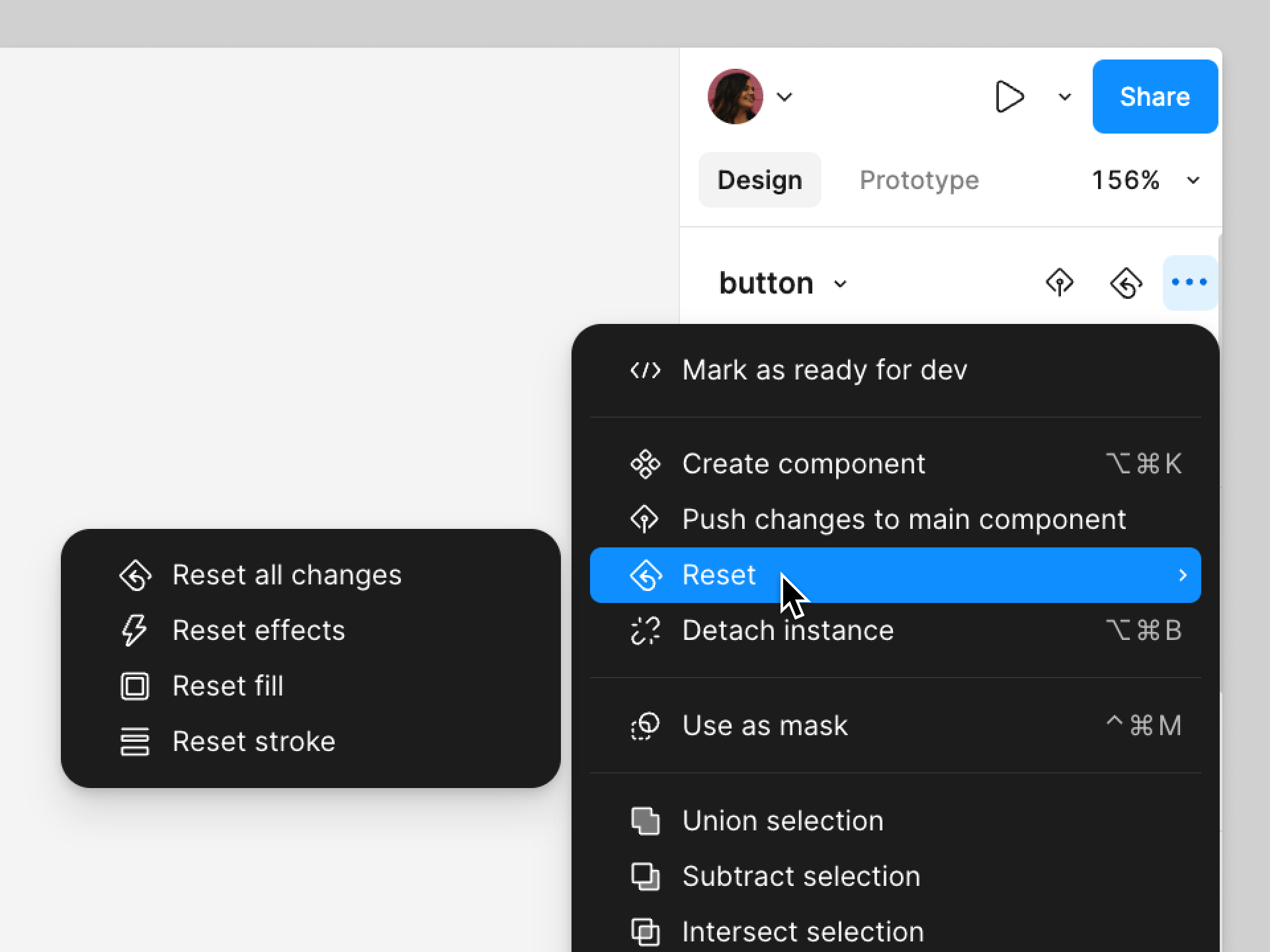

Reset changes
Reset the instance to restore the properties of the main component. You can choose to reset the entire instance, or just a specific property.
- Select the instance to view changes for the entire instance, or a specific layer to view changes for that layer only.
- Click More actions next to the component name in the right panel.
- Figma opens a menu that lets you view any changes for your selection. Figma only lists properties that have changes applied.
- Select Reset > Reset [property] to reset a specific property.
- Select Reset > Reset all changes to reset all properties for that layer.
- Figma resets the property to match the main component.
