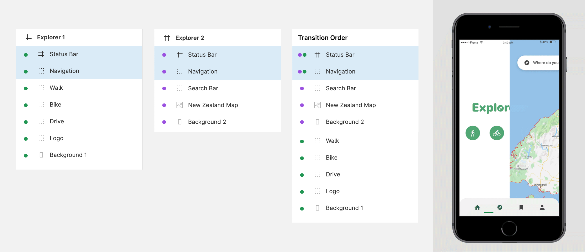

Layer order and hierarchy
Smart animate and Smart animate matching layers take into account the layer order, or hierarchy of your layers.
Normally, Move in or Slide in will transition the entire destination frame above the original frame. With smart animate matching layers, Figma will move or slide in layers based on their hierarchy, which can cause some confusing or unexpected results.
In our screenshot below, we have two matching objects between our frames ( Explorer 1
and Explorer 2
). These are the Status Bar and the Navigation.
If we have layers above any matching layers, Figma will animate them above the destination frame. In our screenshot below, we can see layers from Explorer 1
appear above the destination frame.
By moving our matching layers to the top of the hierarchy instead, we can make sure the entire destination frames slide above the original frame.
