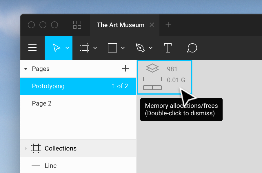

Reduce memory usage
There are a number of factors that contribute to memory usage. It's not as straightforward as a specific number of layers, data, or resources in the file.
Note: We're using the term memory very generally here, but the memory usage banners are only triggered by WASM memory (WebAssembly.Memory) usage. Figma uses this memory to render layers and objects on the canvas, as well as deliver the collaborative multiplayer experience.
