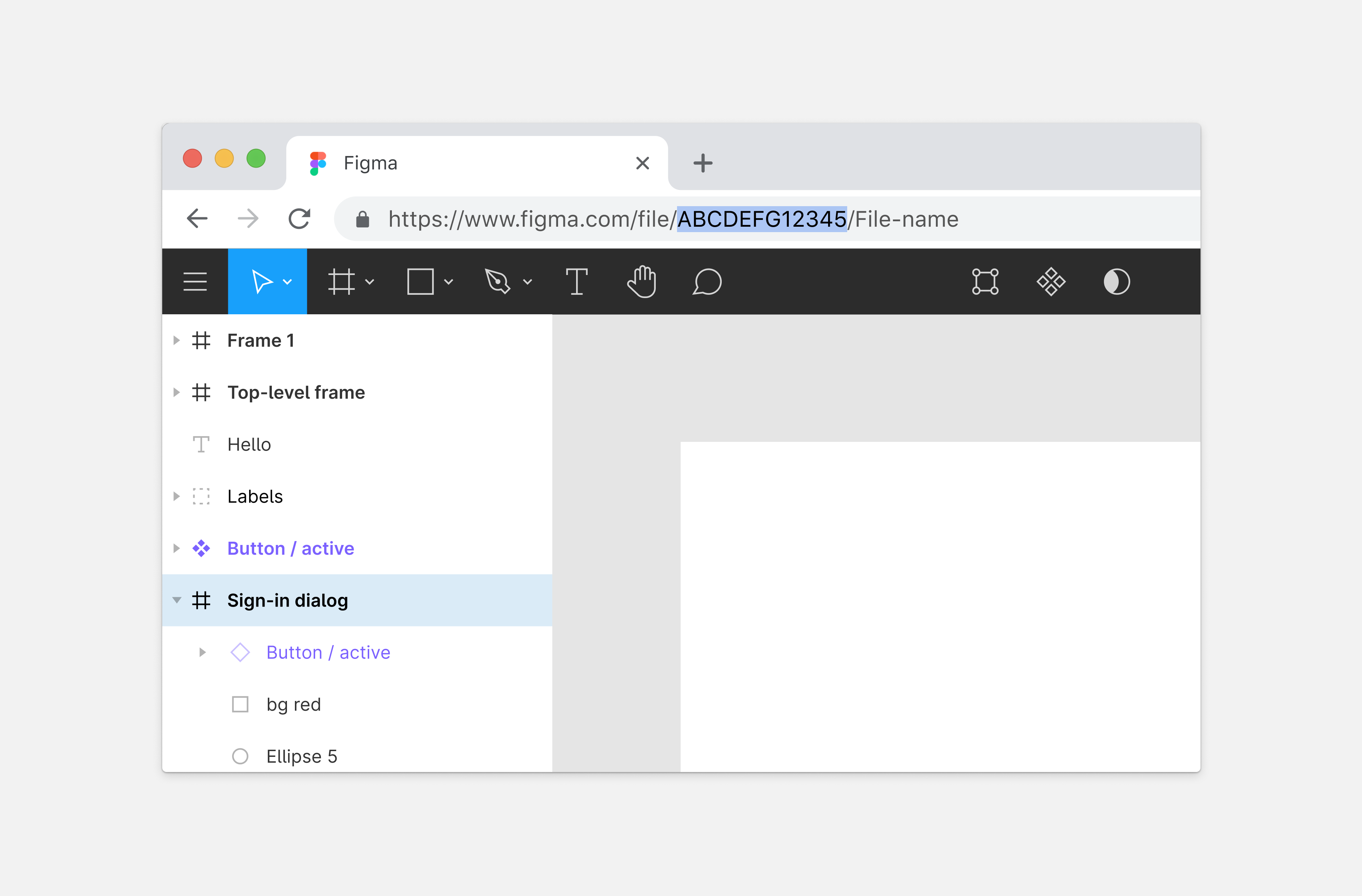

Each Figma file has a unique URL containing its ID. The file ID is the string of random alphanumeric characters found in the section of the URL after figma.com/file/.
To find and copy the ID of the Figma file you want to import:
- Open the Figma file you want to import.
- Copy the file's ID from your browser's address bar. If you're in the Figma Desktop App, right-click the file's tab to Copy link and paste it in a browser's address bar to view and copy the file ID.
