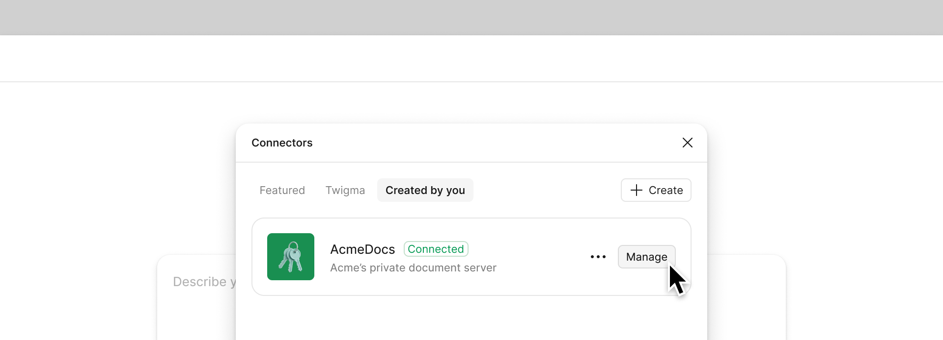

- From the chat box in a Figma Make file, click Add context. Hover over Connectors, then select Manage.
- Navigate to the Created by you tab and click Create.

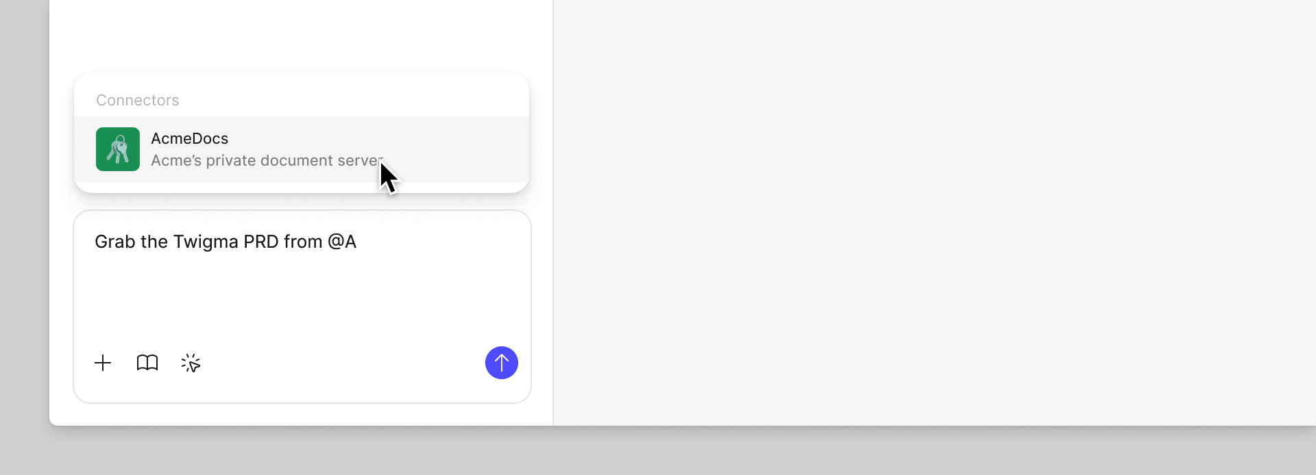

- To explicitly reference a connector, type @ in the chat to see a list of connected connectors. Select the one you want to use and it will appear as a pill above your message. This ensures Figma AI only uses the specified connectors for the current task.

- From the chat box, click Add context. Hover over Connectors, then select Manage.
- Navigate to the Created by you tab and click More on the connector.

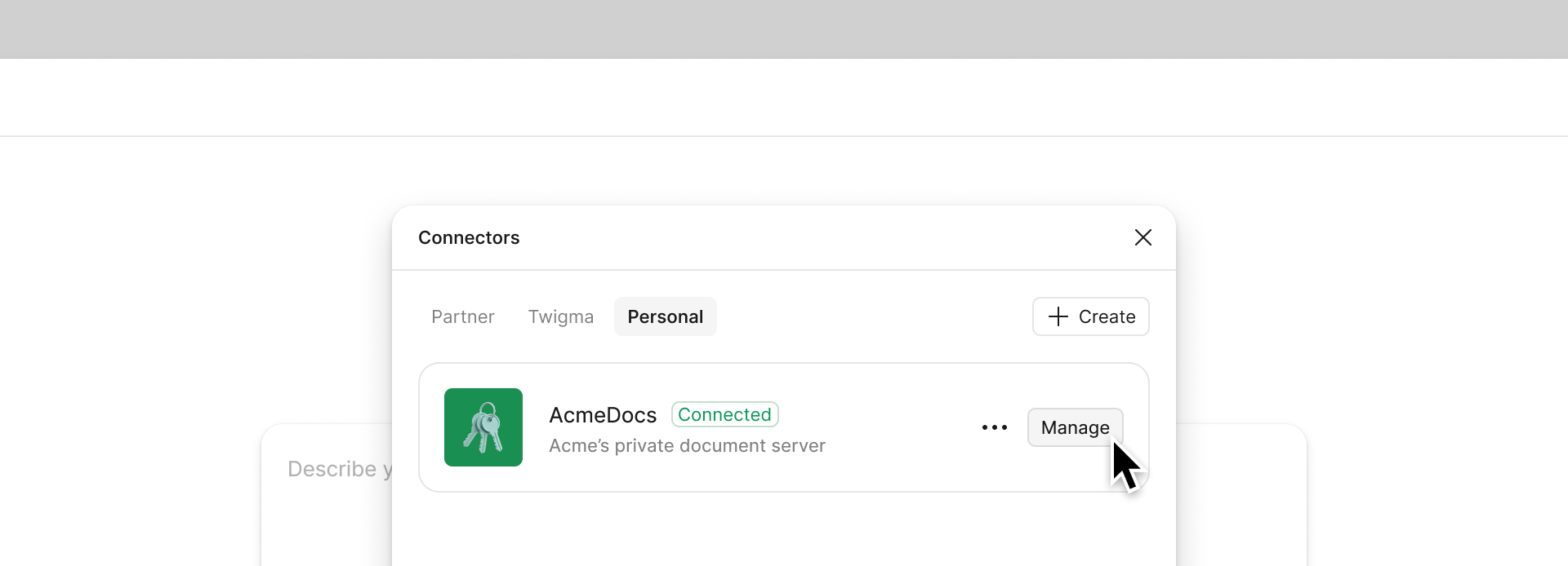

- Navigate to the Created by you tab and click Manage on the connector.
- Enable or disable the Read or Write tools, or set permissions for individual tools within that connector.
