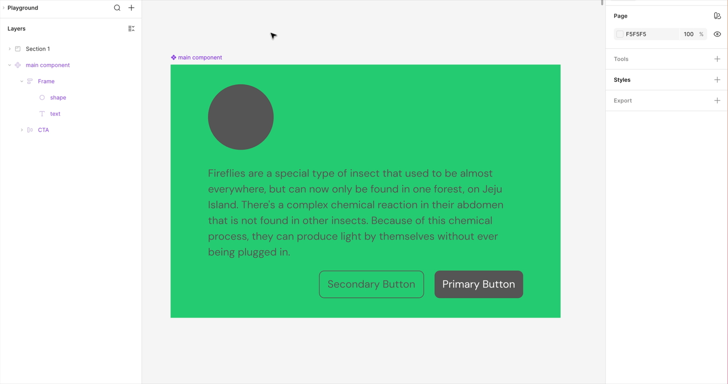

Create a slot in a main component
Slot can be used on nested layers in main components or in variants of the same component set. You convert a frame to a slot, wrap layers in a slot, or apply an existing slot property to a frame.
You cannot bind a slot property to the top level layer of a component.
Use slots on variants: You can apply a slot property across variants within the same component set. To do this, use multi-edit to select multiple similar layers, then create and add the slot property to layers in bulk.

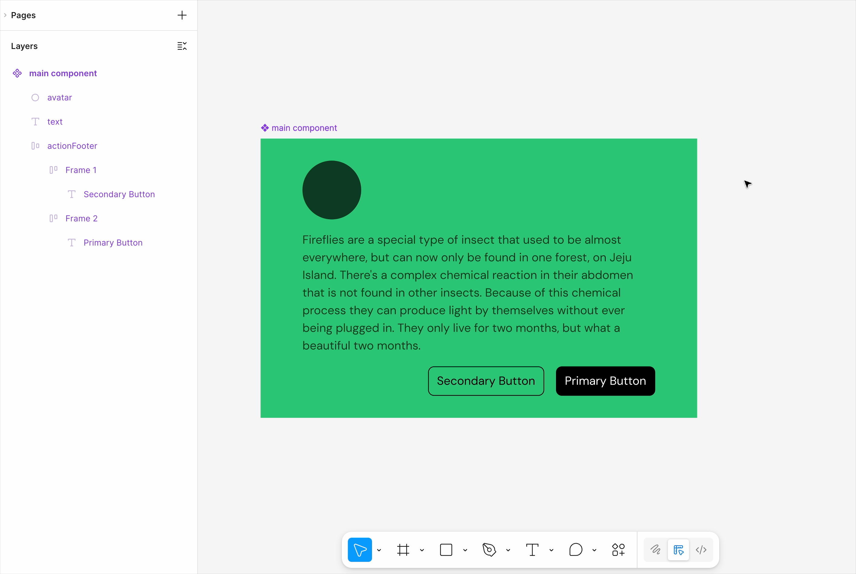

Convert a frame to a slot
Any frame in a main component can be converted to a slot. This is handy for when you’ve already pre-defined the area you wish to be a slot with a frame.
- Select a nested frame inside a main component.
- Choose from the following options:
- Right-click and select Convert to slot.
- Use the keyboard shortcut ⌘ Command ⇧ ShiftS (Mac) or ⌃ Control ⇧ ShiftS (Windows).
- From the right sidebar, click Convert to slot. Select an existing slot property from the dropdown or choose to create a new one.
The frame will be converted to a slot, and a new slot component property will be created. From the Properties section of the right sidebar, click Edit slot property to update the slot name, add a description, and set preferred instances. Learn more about editing a slot property.

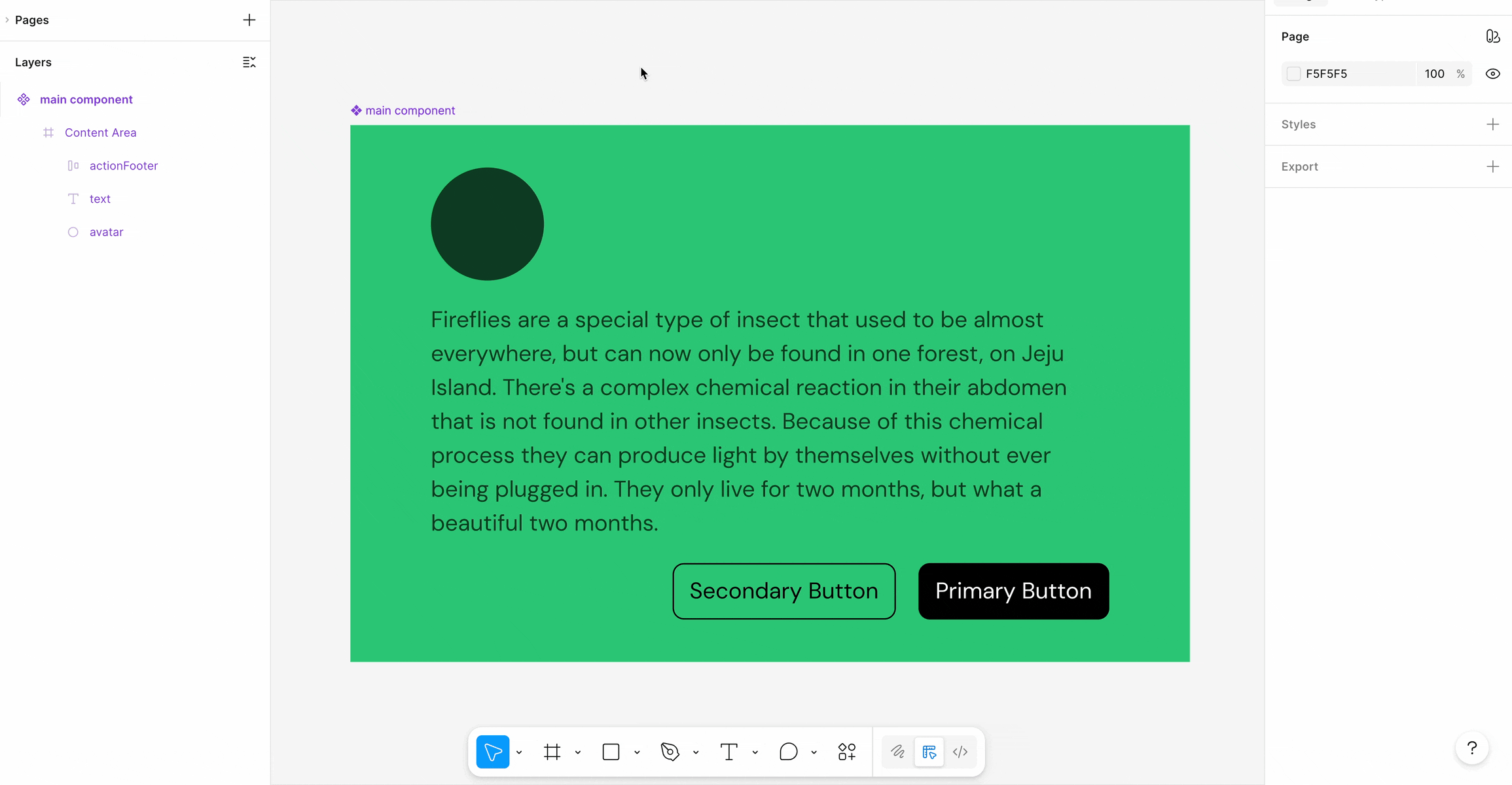

Wrap objects in a new slot
If you’re working with objects that are not frames—such as text layers, groups, instance components, or a selection of multiple objects—you can wrap them in a new slot.
- From any main component, select a non-frame object or multiple layers.
- Right-click, and select Wrap in new slot.
This will create a new slot and place your selection into it, and a new slot property will be created. From the Properties section of the right sidebar, click Edit slot property to update the slot name, add a description, and set preferred instances. Learn more about editing a slot property.

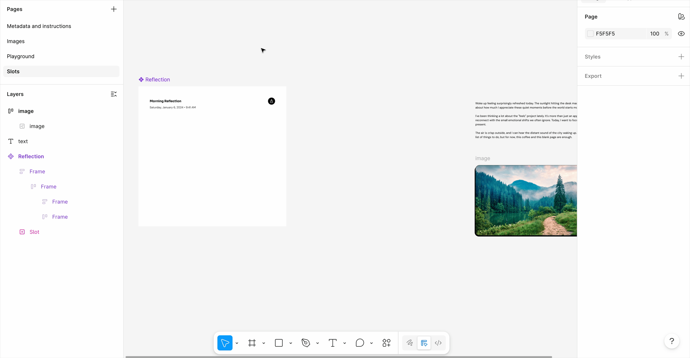

Create a slot property, then apply it to a layer
You can also create a slot property from the right sidebar.
- Select a main component on the canvas.
- Click Create property and choose Slot from the right sidebar.
- A settings modal will appear, where you can update the slot name, add documentation, and edit other slot settings.
- This will create a slot property, but it will not define a slot area on your layers until you assign it to a frame. When you are ready to assign this slot property to a frame, select the frame click Convert to slot in the right sidebar, then select the existing slot property from the dropdown.

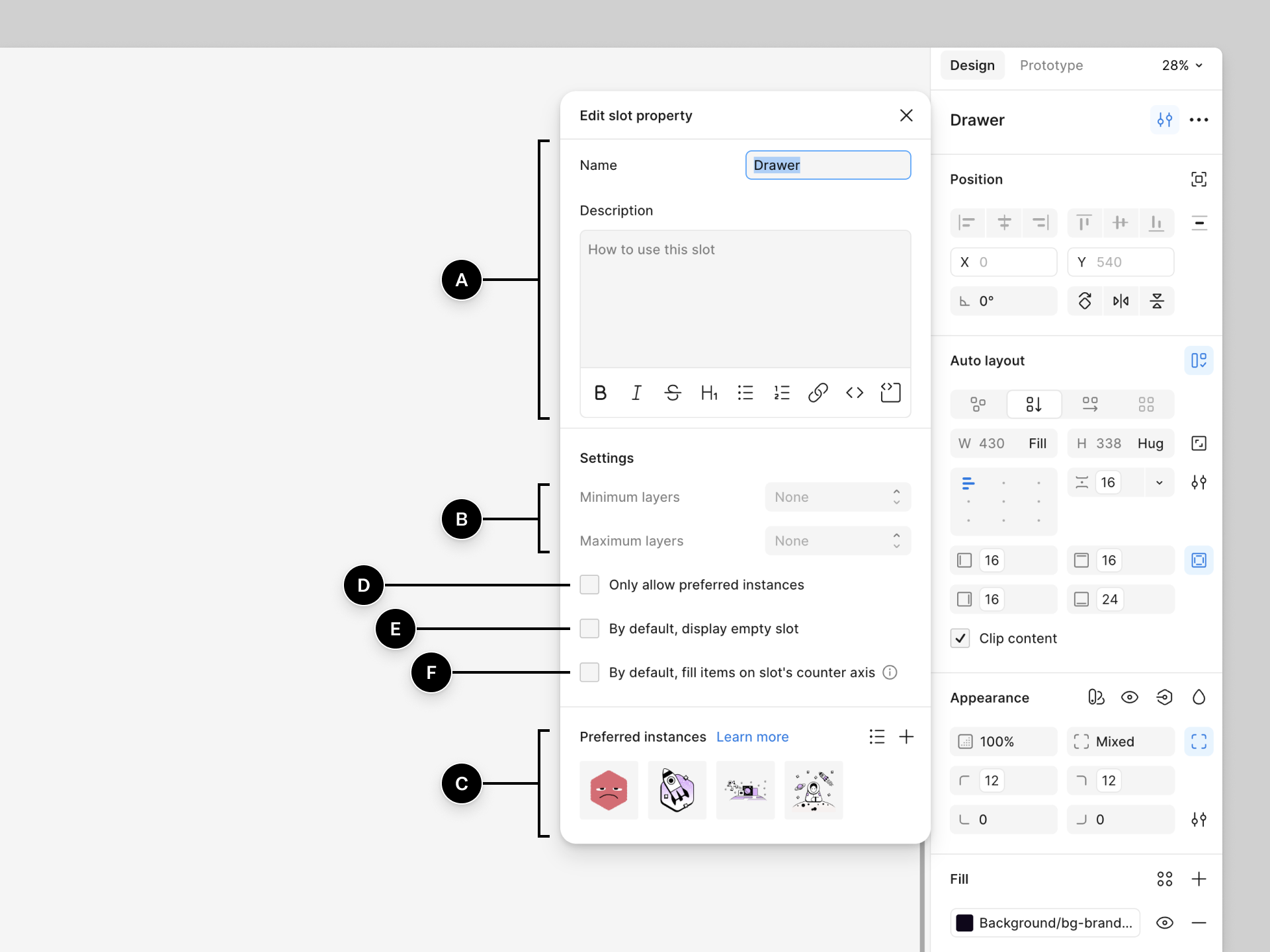

Edit slot settings
You can leave a slot empty or add layers to it as default content. A slot can take on most of the same properties as a frame. For example, you can apply horizontal and vertical auto layout, minimum and maximum dimensions, color fills, effects, and variables, to name a few.
Components with slots can be published empty or with pre-populated, default content inside.
To adjust the settings and default options on a slot, select the main component and find the slot in the right panel. Then, hover over the slot property and click Edit property. From there you can:
- Update the slot property’s name and description
- Set minimum and maximum layer counts
- Set preferred instances
- Only allow preferred instances
- Display empty slots by default
- Set items to fill container by default

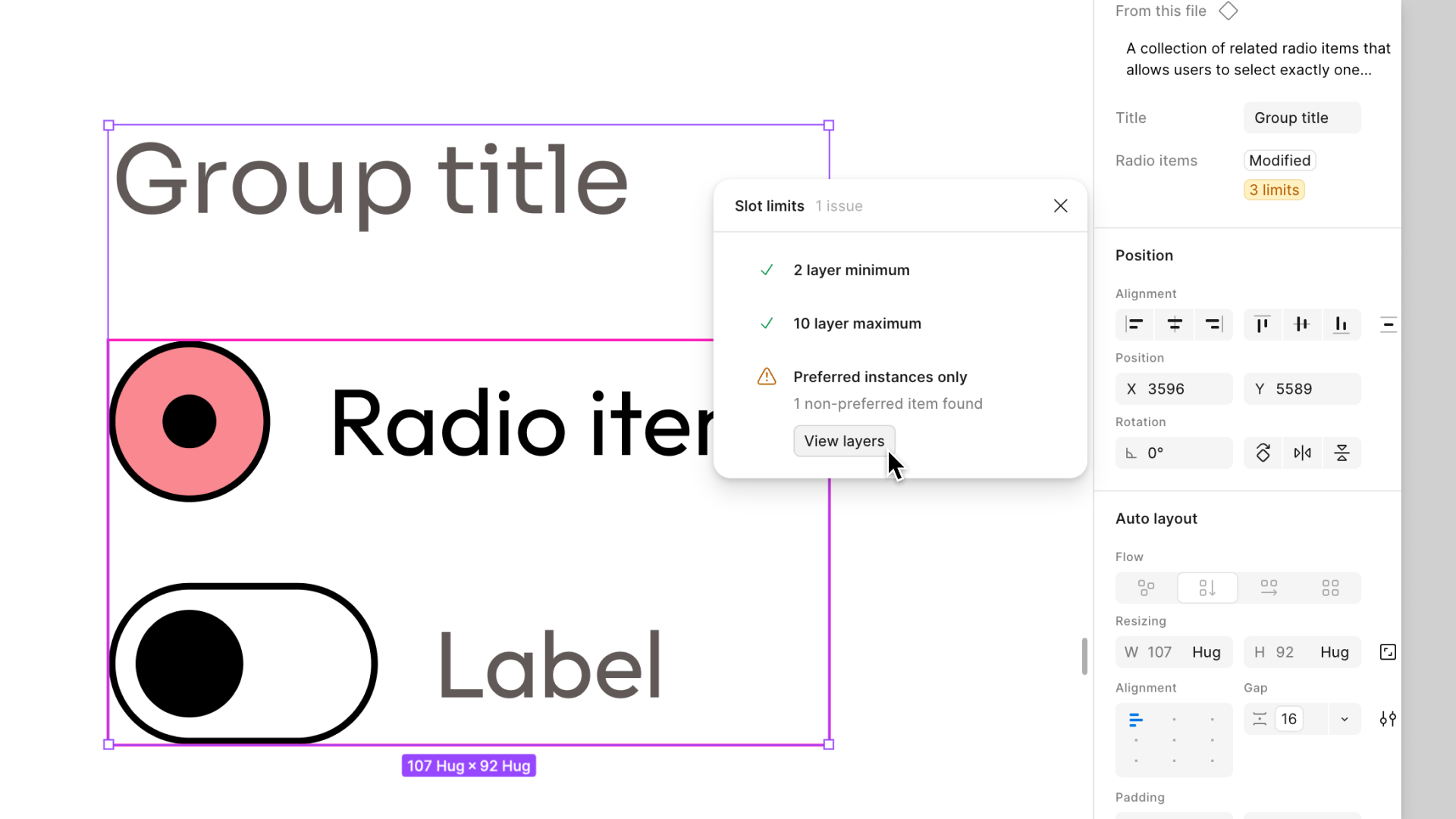

To set a limit on layer count on a slot, use the Minimum layers and Maximum layers fields to define it. You can use both fields to define a range, or use just one of the fields.
Once a limit is defined, anyone using an instance of the slot can see the limits from the right sidebar when the slot or its component. They can click the Limits label to view details about the limits and whether they’ve been met.
Note: Layer count limits are designed to guide your team, not restrict them. If a designer goes past a limit, a warning will appear at the bottom of the screen and the limit label will turn orange as a friendly nudge to keep designs on track, but they can continue working beyond the set limit.
Learn how limits appear when consuming a slot.

View limits
If there are any limits set on the slot—such as using only preferred instances, minimum layer count, or maximum layer count—they will be displayed in the right sidebar when the slot or its parent instance component is selected. Click on the label to view details about the slot’s limits.
A green checkmark will be displayed next to limit guidelines that have been met successfully, and an orange warning icon next to limits that have not been met. If the preferred instances only setting is enabled, you can click the View layers button to see them on the canvas.
Note: Layer count limits are designed to guide rather than restrict. If you go past a limit, a warning will appear at the bottom of the screen and the limit label will turn orange as a friendly nudge to keep designs on track, but you can continue working beyond the set limit.

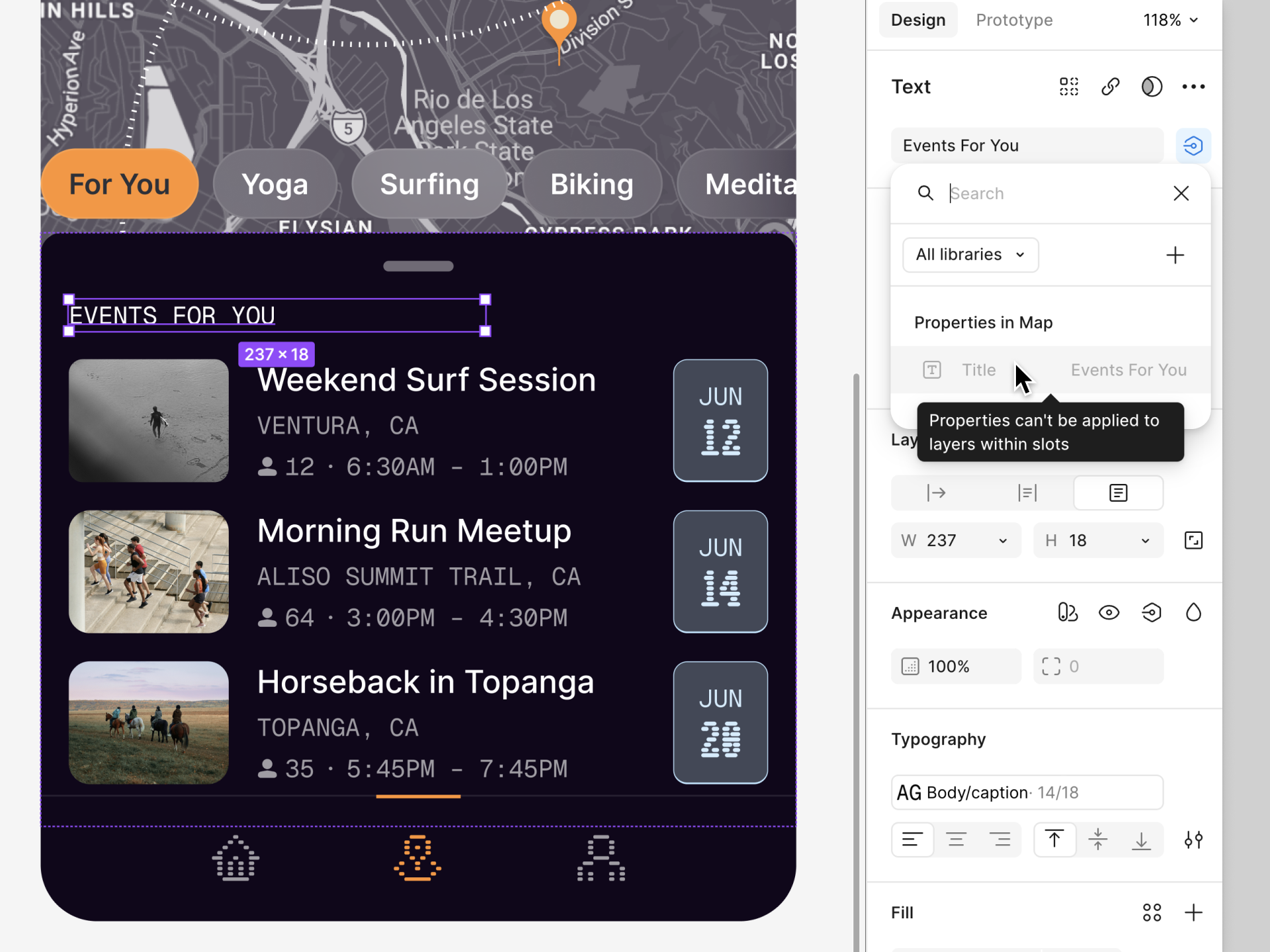

Using component properties in slots
Component properties cannot be applied to layers from inside a slot.
However, you can apply component properties to main components, and then insert an instance into a slot. The component properties applied to it will persist and remain available.
For example, say we have a slot within a main component, and we want to add a frame and a text layer to the slot. We won’t be able to apply component properties to that frame and text layer.
Similarly, if you grab a layer containing a component property from a main component and move it to a slot in a different main component, the component property will be removed.
To maintain flexibility for layers in a slot of a main component, you can explore binding variables instead. Depending on your setup, it may also help to keep component property bindings outside the slot boundary. By binding variables to variants and colors, you can achieve the intended effect by changing modes rather than variant swapping.
