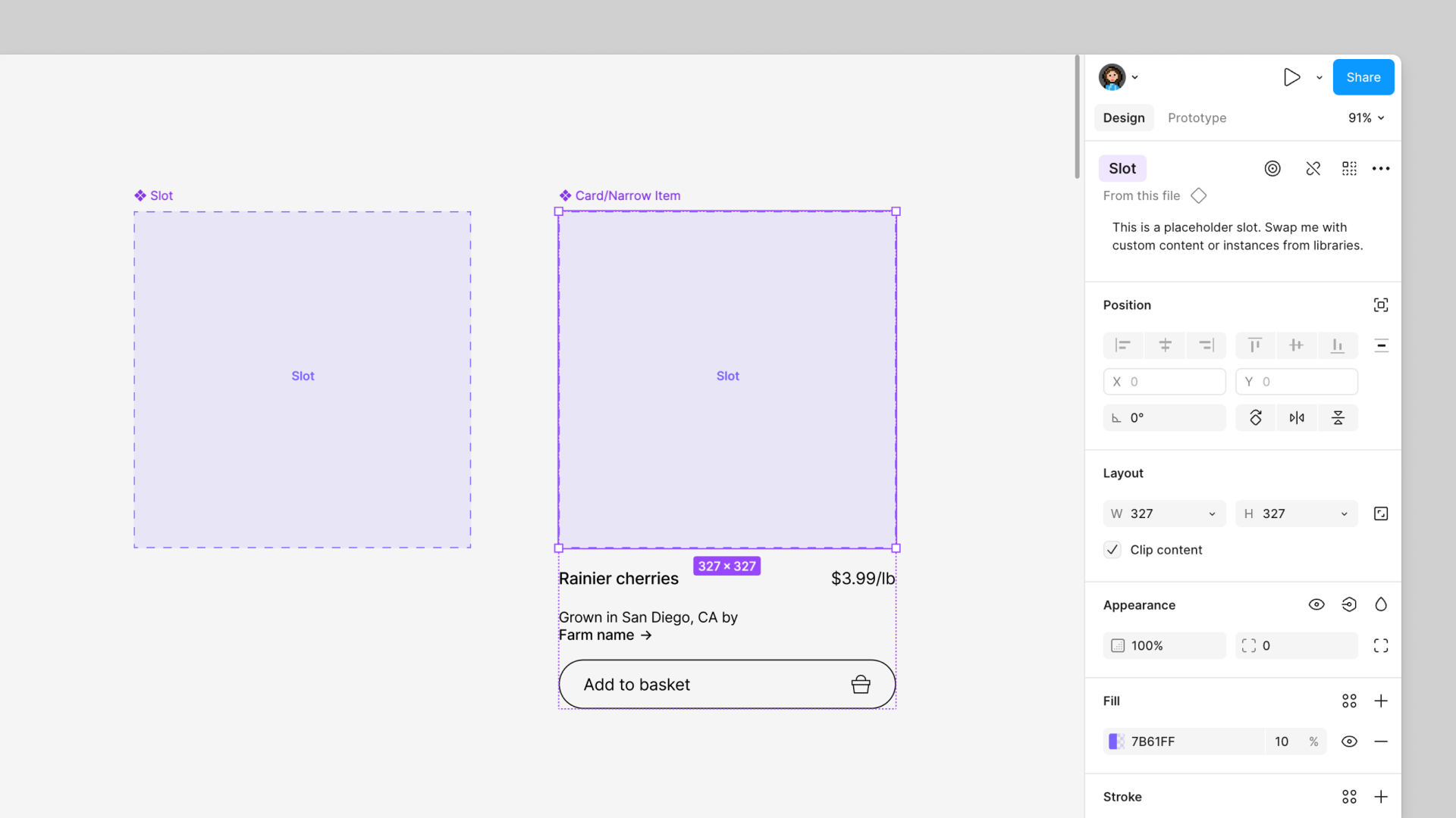

Migration path 1: If using a âslot placeholderâ component across multiple components
Does your set up look something like this? Youâve created a dedicated main component called âSlotâ or something similar that contains a placeholder inside. You then nest instances of this âSlotâ component inside other main components, along with instructions for designers to swap it with a local component using the instance swapper.
In practice, it looks something like this:
- The âslotâ is built as its own main component and acts as a reusable placeholder
- Other components include the âslotâ it as a nested instance to indicate the area where content can go
- Designers replace the placeholder by manually swapping the nested instance
- If there is no instance swap property configured, swapping happens by using local components

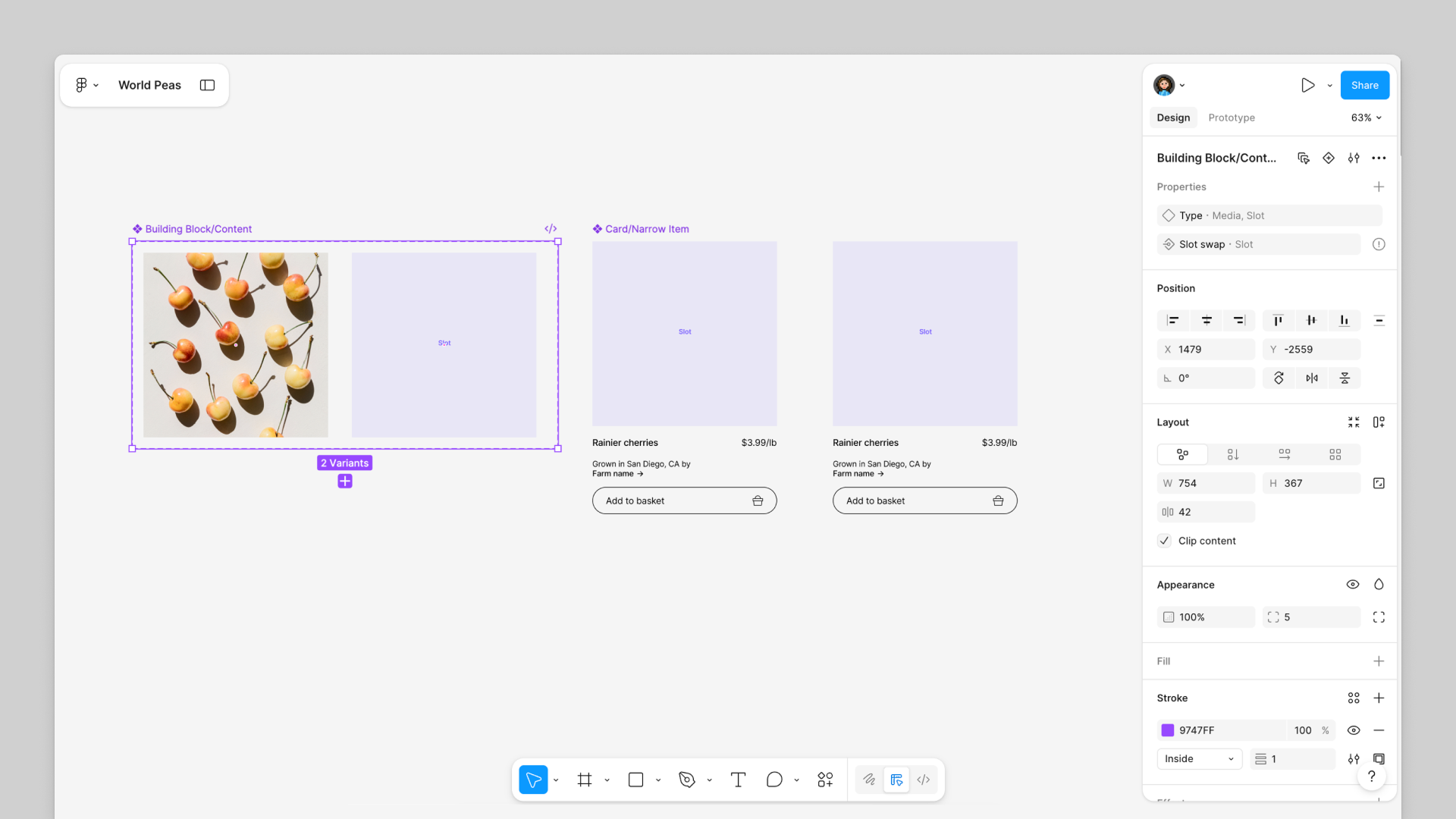

Migration path 2: If using a variant-based slot placeholder
Does your set up look something like this? You have a component set called âBuilding Block/Content,â or something similar, and it contains at least two variantsâone variant with existing content and one âslotâ variant. The slot variant may contain a visual placeholder along with instructional text.
This component set also contains an instance swap property called something like âSlot swapâ where the value is set to the âslotâ variant. This lets authors âswap inâ that slot variant wherever they need a freeform container.
In other main componentsâsuch as in cards, modals, and listsâan instance of the âBuilding Block/Contentâ component is added. This exposes the âSlot swapâ instance swap property, which allows designers to swap the âslotâ variant with other instances.
Structurally:
- The component set acts as a âslot containerâ
- The slot variant acts as a placeholder visual for guidance.
- The instance swap property controls which variant is shown.
