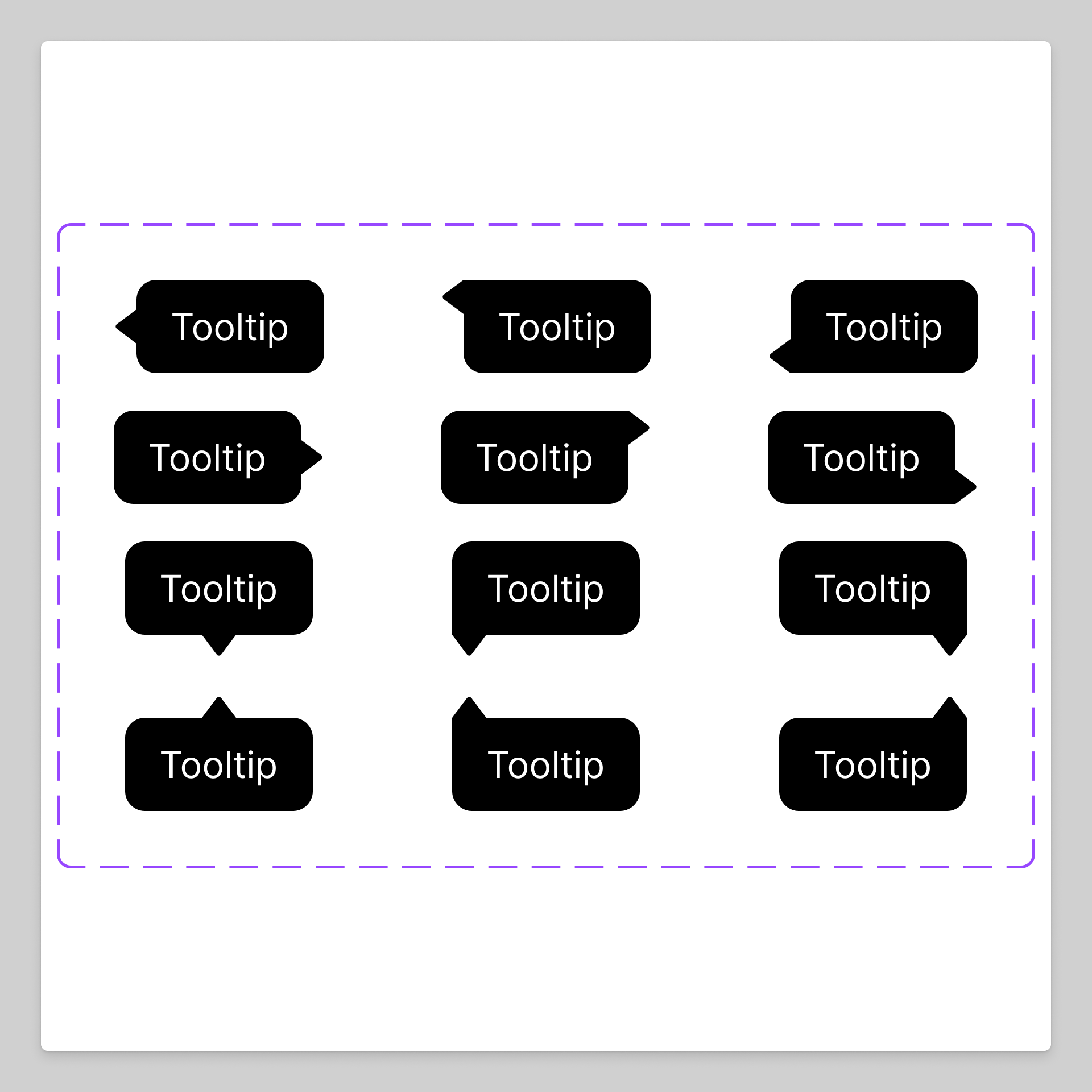

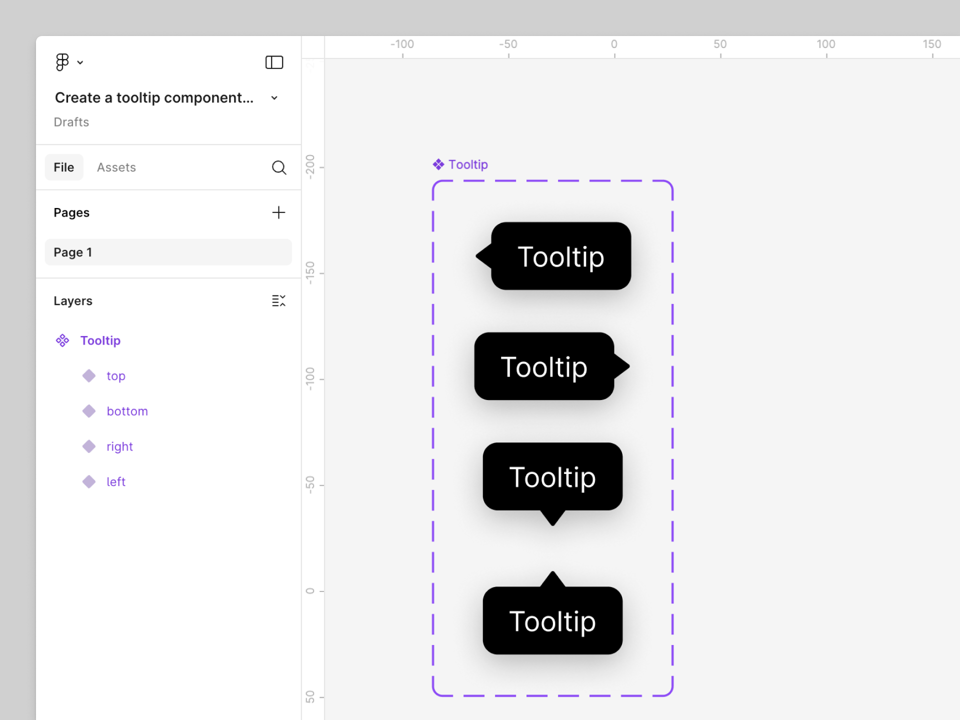

Once you’ve completed this project, you’ll have a tooltip component set that covers the four major positions (top, right, bottom, left), as well as the eight minor positions, such as top-right and bottom-left. The tooltip will also grow or shrink in size depending on the length of content inside. Your final component set will have 12 variants and will look similar to the following:

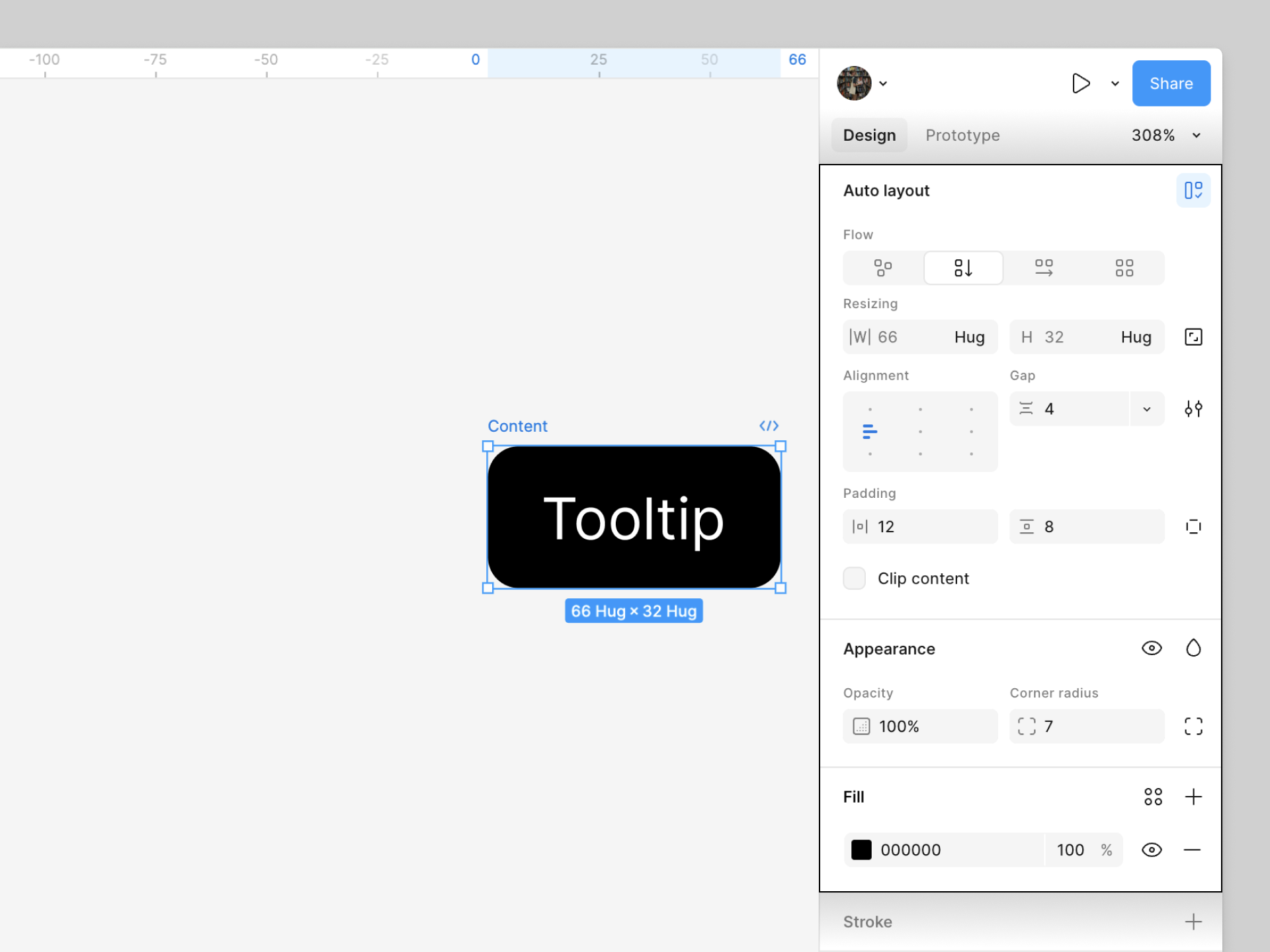

- With the Content layer still selected, set the auto layout properties to the following:
- Set the Horizontal resizing and Vertical resizing to
Hug contents - Change the Flow to
Vertical - Change the Alignment to
Align left - Change the Vertical gap between items to
4 - Change the Horizontal padding to
12 - Change the Vertical padding to
8
- Style the frame by adjusting the following settings:
- Click the plus in the Fill section to add a fill
- Change the fill color to
#000000 - Change the corner radius to
7
Before moving on, check to make sure your frame looks similar to the following:

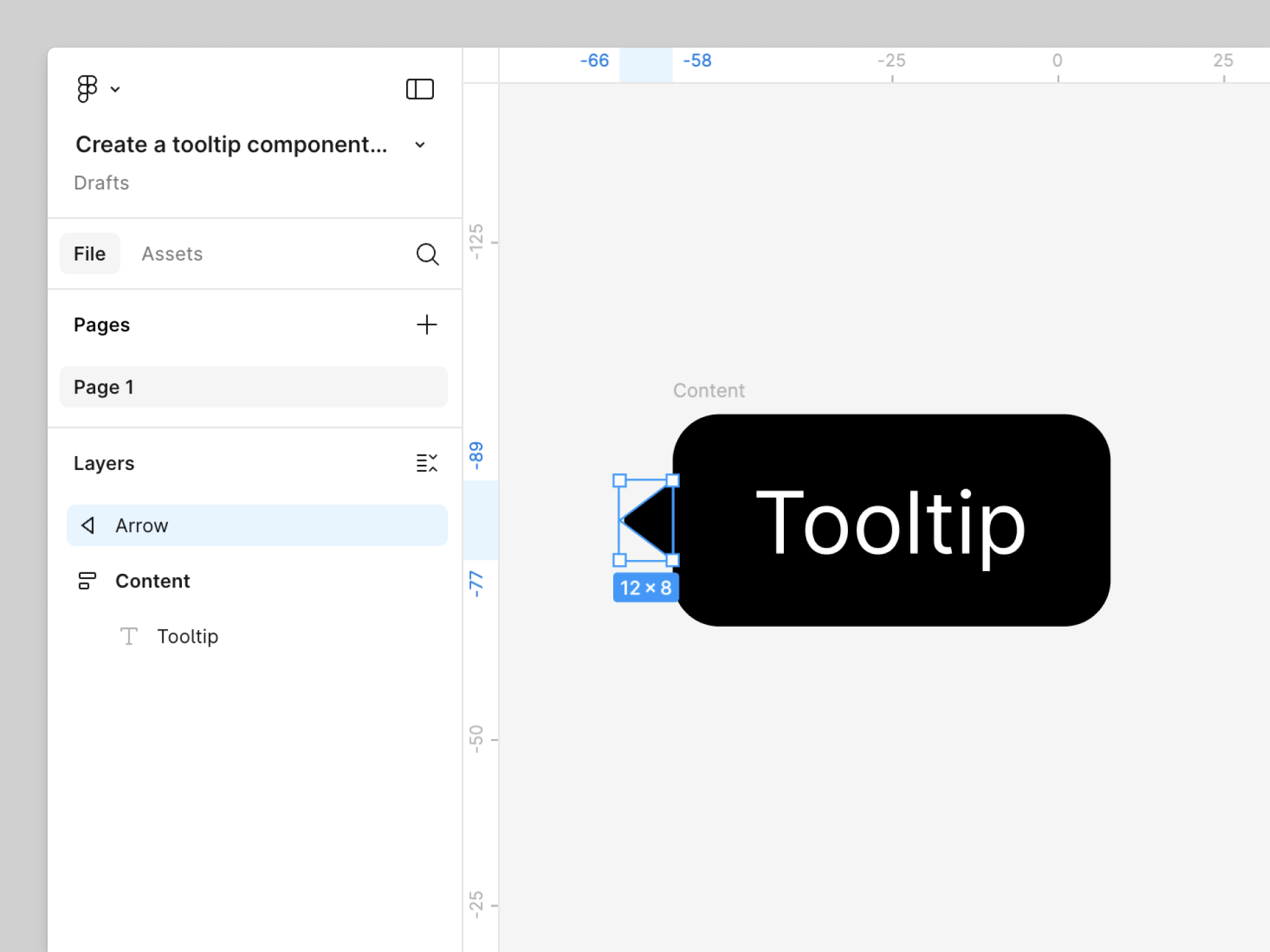

Create the arrow
- From the Shape tools dropdown in the toolbar, select Polygon.
- Click on the canvas to add a polygon.
- Select the polygon and press Enter to open vector edit mode.
- Select the top point of the triangle and change the corner radius to
1. - Press Enter again to exit vector edit mode.
- Change the triangle’s width to
12and height to8. - Change the triangle’s fill color to
#000000. - Rename the layer to
Arrow. - Hold Shift and rotate the arrow 90 degrees.
- Center the arrow on the left side of the Content layer.

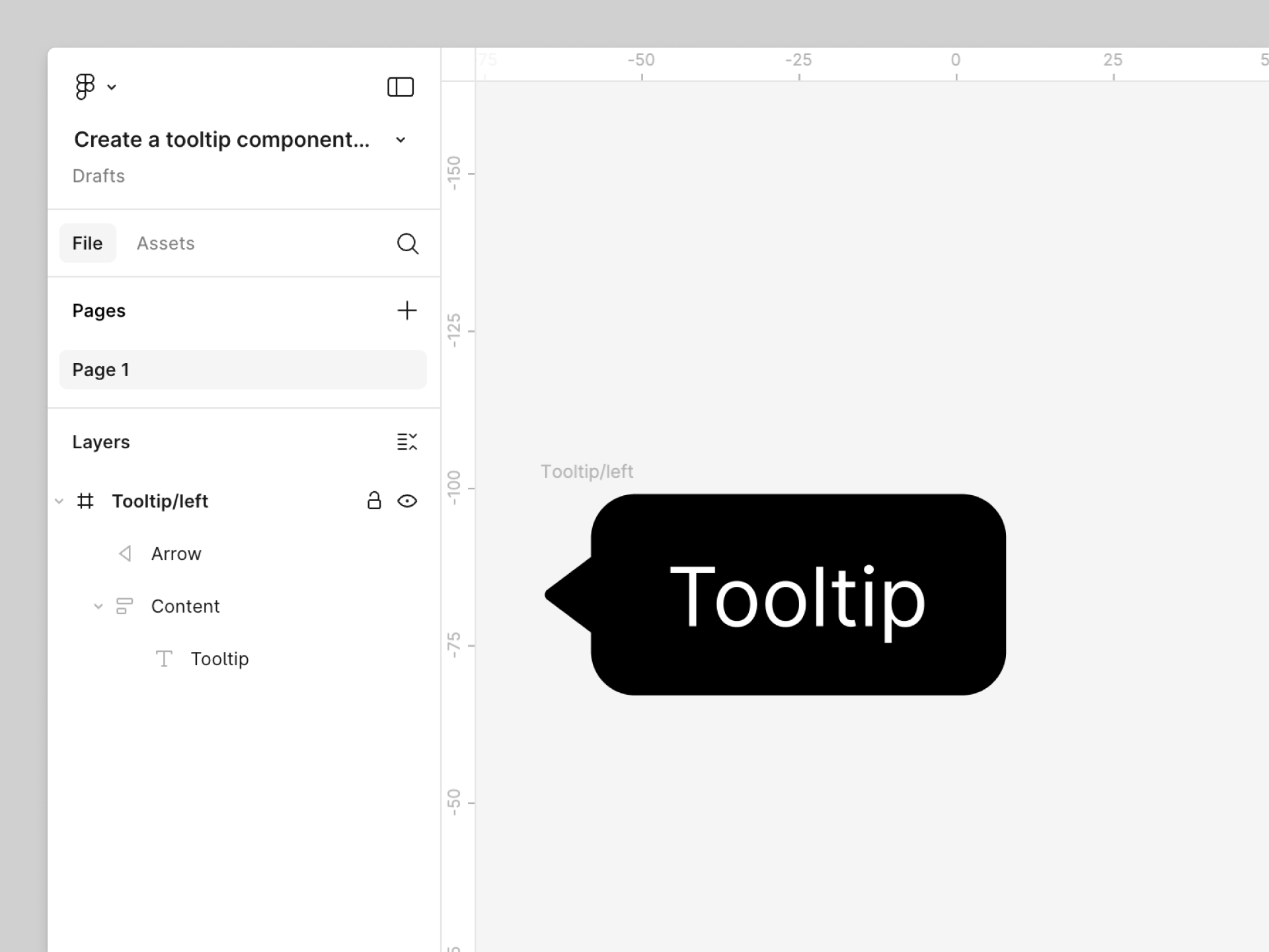

You’ll notice that the Arrow and Content layers are not grouped. If we turned these layers into components now, each layer would become an individual component. To connect the layers, we will add the layers to a frame:
- Select both layers, then right-click on the selection and choose Frame selection.
- Rename the frame to
Tooltip/left.
Before moving on, check the left sidebar to make sure the Arrow and Content layers are nested under the new Tooltip/left layer.

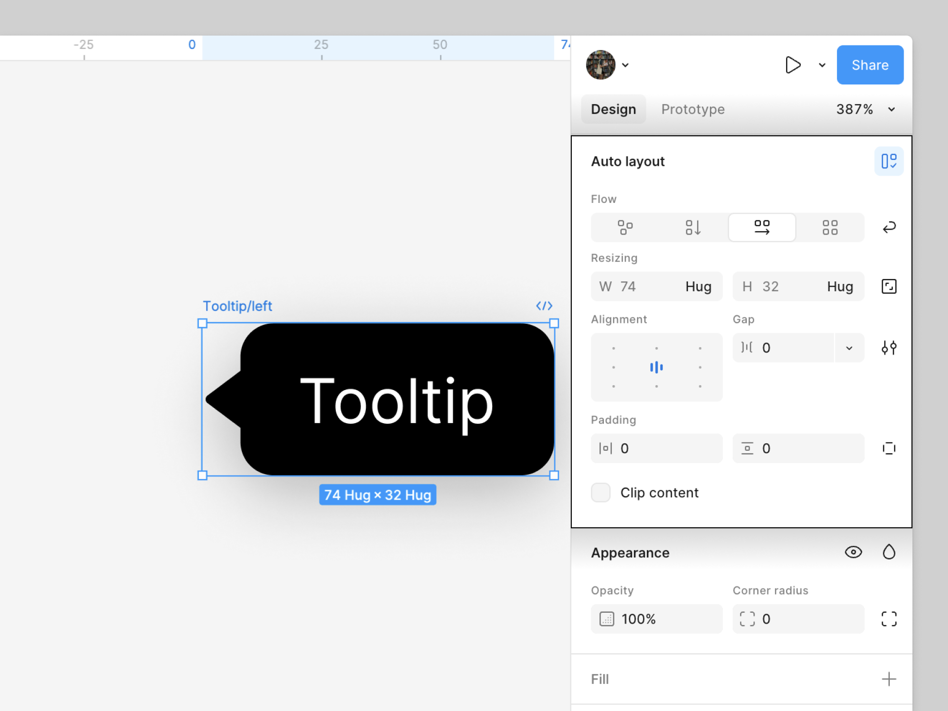

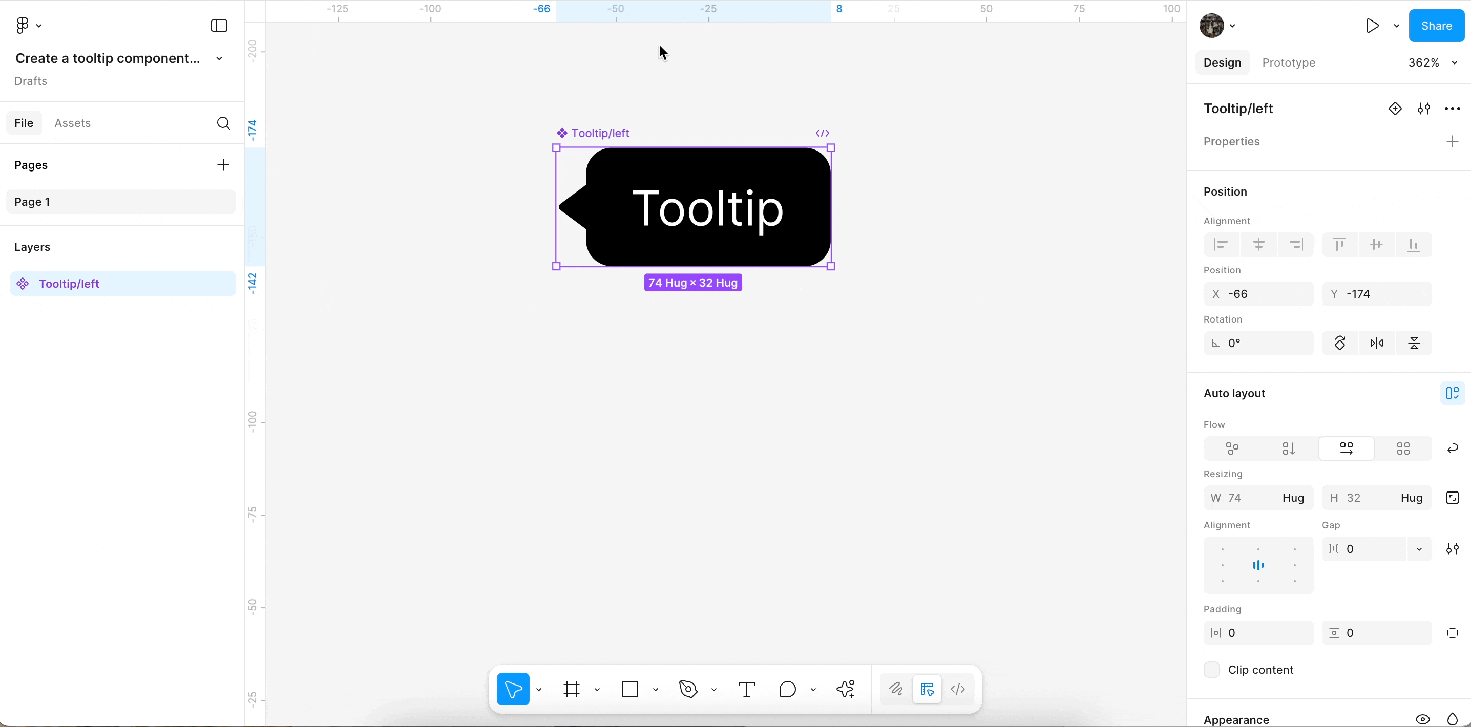

Now we need to apply auto layout to the Tooltip/left frame.
- Select the Tooltip/left frame and press Shift A to apply auto layout.
- Make sure the Clip content checkbox is deselected in the right sidebar.
- Set the following auto layout properties:
Hug - Change the Flow to
Horizontal - Change the Alignment to
Align center - Change the Horizontal gap between items to
0 - Change the Horizontal padding to
0 - Change the Vertical padding to
0
- Style the frame:
- Click the plus in the Effects section to add a drop shadow
- Select the drop shadow and change the blur to
16
- With the frame still selected, click Create component to turn the tooltip into a main component.

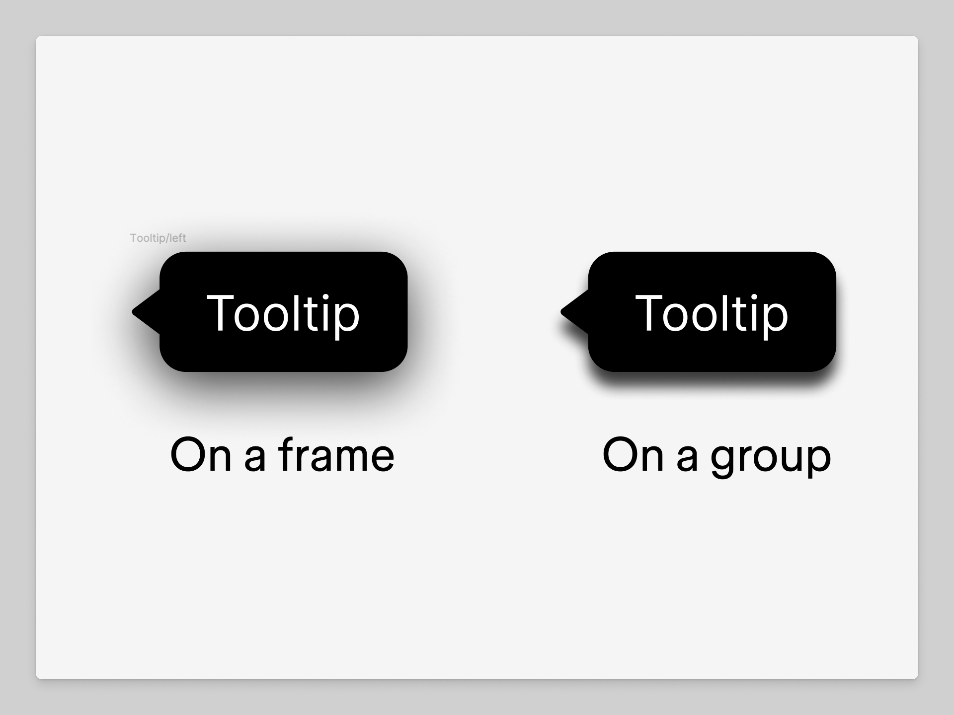

Why add a drop shadow?
Applied correctly, drop shadows create a sense of depth and hierarchy on the screen. They can help gently guide the user’s eye to interactive or important elements.
You might be wondering why we applied the drop shadow to the parent frame, rather than to the Arrow and Content child layers. Drop shadows on parent-level frames are applied evenly to the child layers inside the frame, making it appear as if the layers are a single object. If we were to apply a drop shadow to each child layer, or to a group of layers, the effect would be much less seamless.
Before moving on, check to make sure your tooltip looks similar to the following:
Create the major direction tooltip variants
Now that we have our main component, we can use it to add the top, bottom, and right tooltip variants to our component set.
First, we’ll configure the right variant:
- Select the component you just created.
- Click Add variant in the toolbar to add a variant.
- In the new variant, select the Arrow layer.
- Drag the arrow to the right of the Content layer or press the right arrow key on your keyboard.
- Right-click on the arrow and select Flip horizontal or use the keyboard shortcut Shift H.
- Select the new variant again. In the Current variant section in the right sidebar, type
arrowDirectionin the Property field andrightin the Value field. Now, all variants added to this component set will have thearrowDirectionproperty.
Now we need to create the top and bottom variants.
- Select the component set and click the purple plus to add another variant.
- Select the new variant.
- In the Auto layout section in the right sidebar, change the layout flow to
Vertical layout. - Select the arrow and hold Shift while rotating it until it points down.
- Select the variant and change the
arrowDirectionproperty value tobottom. - Repeat the process for the
topvariant.
Before moving on, make sure your component set has four variants.

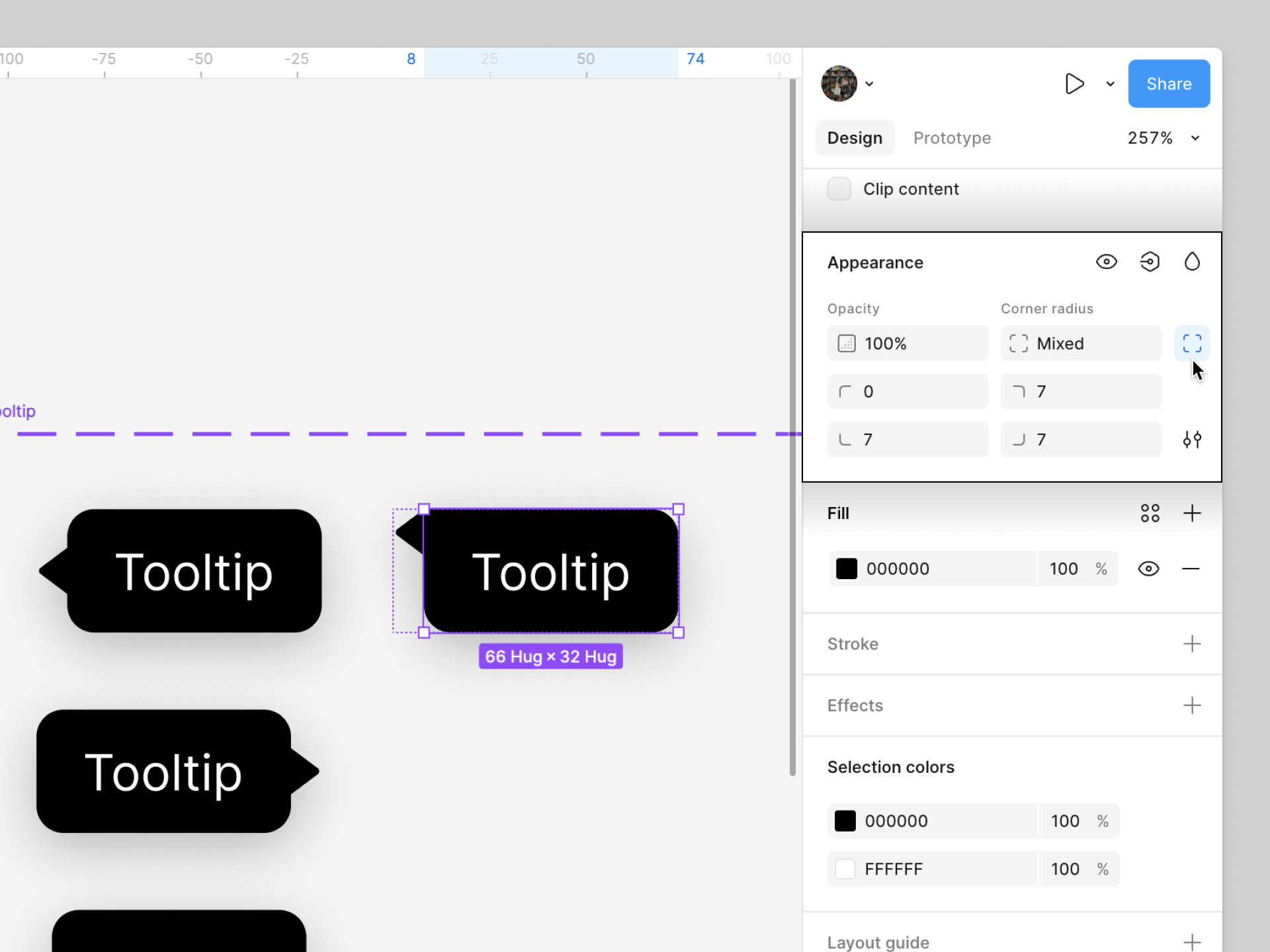

Now, we need to modify the corner radius in the top-left corner so that the arrow blends in with the Content layer.
- Select the Content layer in the new variant.
- Select Independent corners in the right sidebar.
- Change the top-left corner’s radius to
0.
The variant looks much better without that rounded corner.

Your final component set should look similar to the following:
