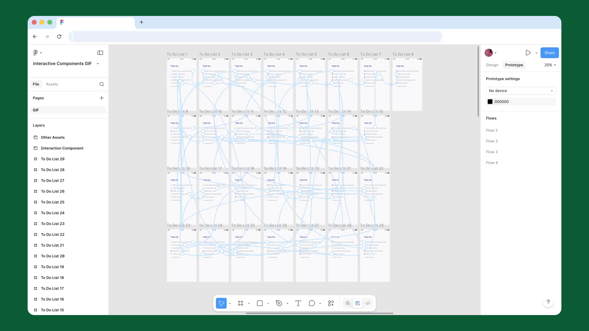

Without interactive components, prototyping even simple interactions requires creating numerous frames and manually adding prototype connections to account for every possible state combination. For example, think about an interactive checklist with five checkboxes. To create this, you would need to duplicate the original frame 32 times and create 160 prototype connections to cover every possible combination of checked and unchecked states!

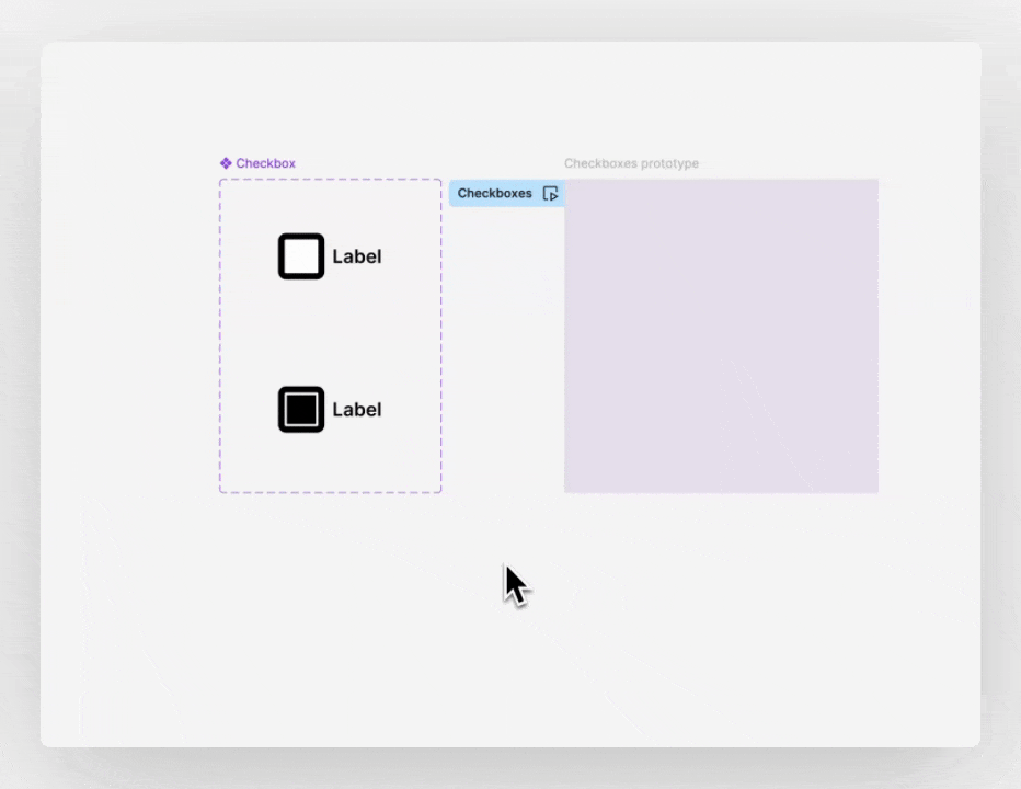

With interactive components, achieving the same outcome only requires creating a component set with two variants (Checked, Unchecked) and two prototype connections. Instances automatically inherit these interactions, so you can simply duplicate the checkbox as many times as needed.
