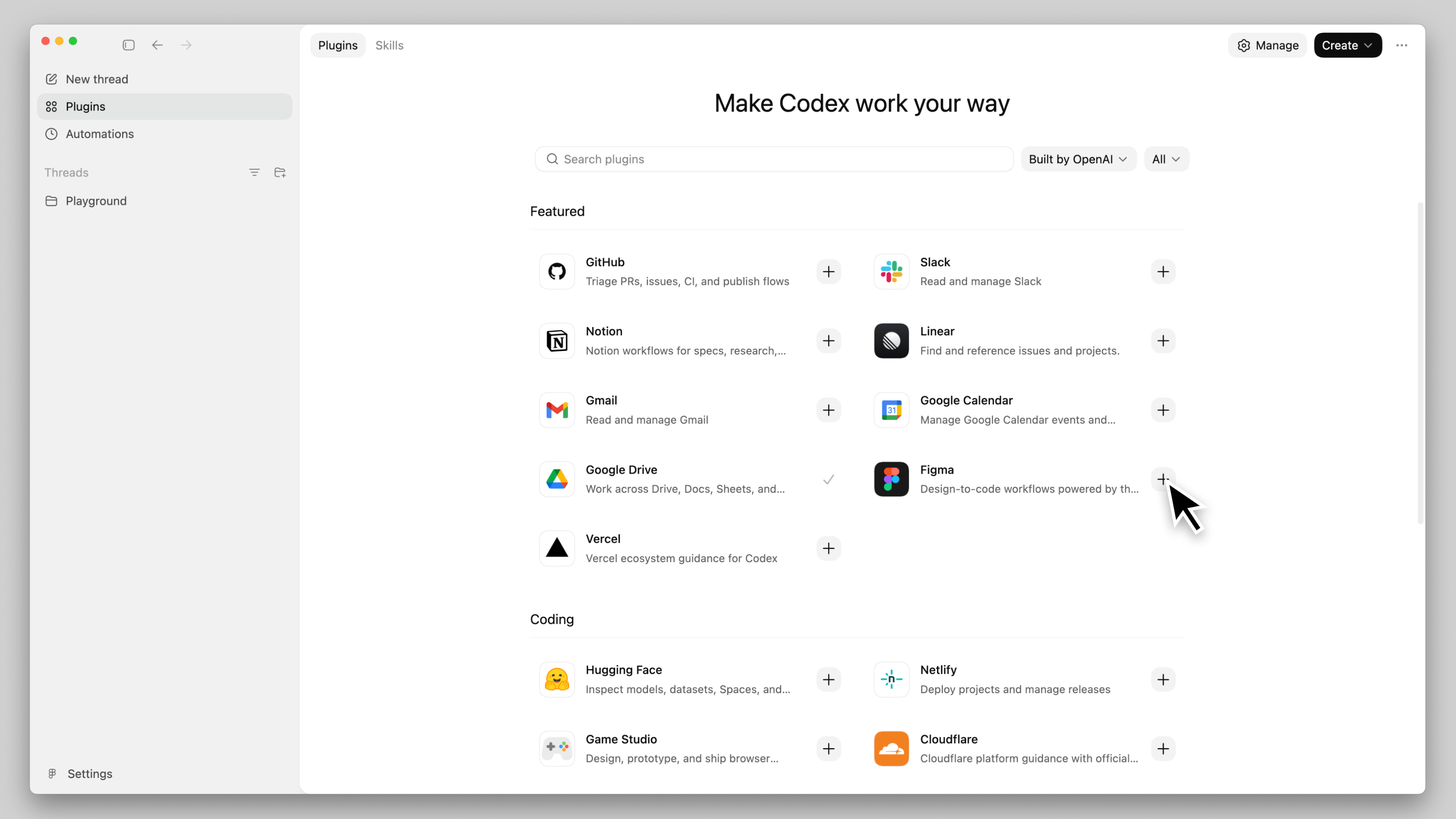

- Install the Codex app if you haven't already.
- In the upper-left corner of the Codex app, click Plugins.
- Click + next to Figma.
- Click Install Figma.
- When prompted, click Allow access to let ChatGPT access your Figma account.
Go back to Codex. The Figma plugin shows as connected, and you’re ready to start prompting. To see what you can do, check out Tools and example prompts.
