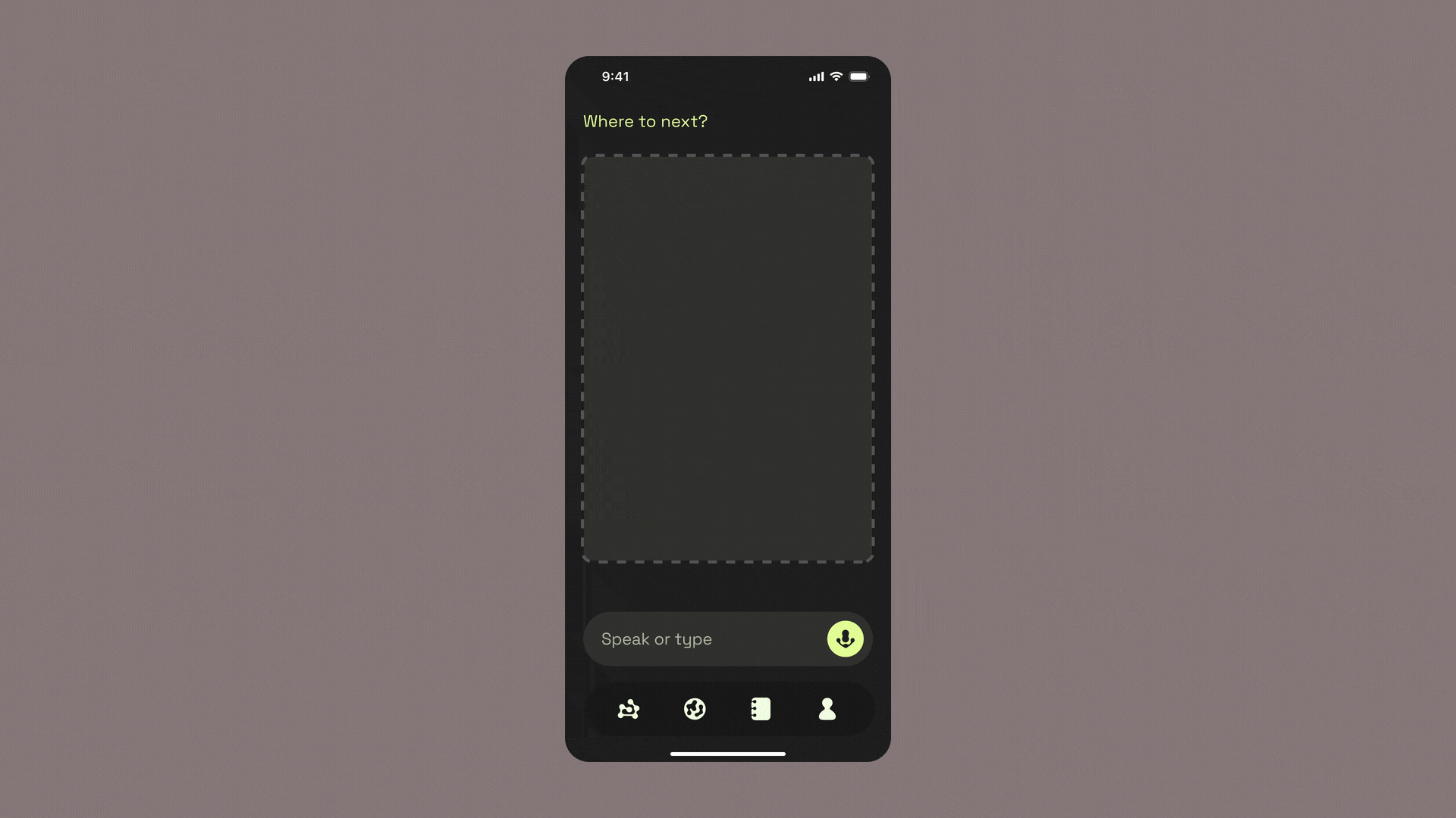

Generate design from a prompt
Rather than starting from scratch in Figma Design, Amy can prompt the agent to generate a design as a starting point.

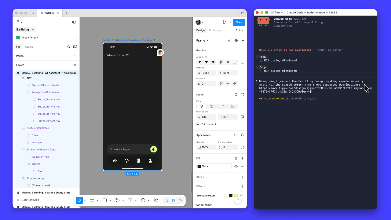

- Select the current search screen design in Figma.
- Right-click and select Copy/Paste as -> Copy link to selection.
Switch to the terminal and enter the following prompt:
"Using the Earthling design system, create an empty state for the search screen that shows suggested destinations with destination thumbnails and a heading. This will be the new empty state of this screen. [Insert Figma link]"

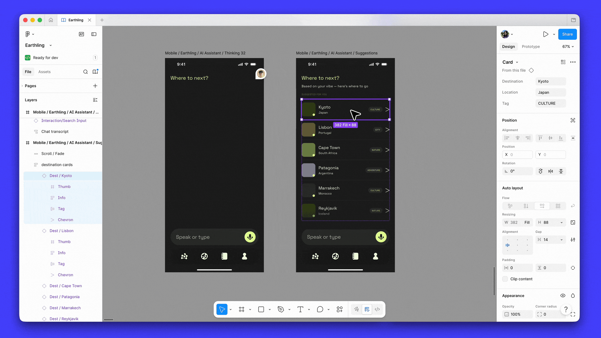

Iterate in Figma
Make edits to generated design
Now that the agent has created a design for the new search screen, Amy is ready to make some new iterations based on the design. The design generated is native, editable Figma content, so Amy is able to use it as a starting point to iterate on it further.

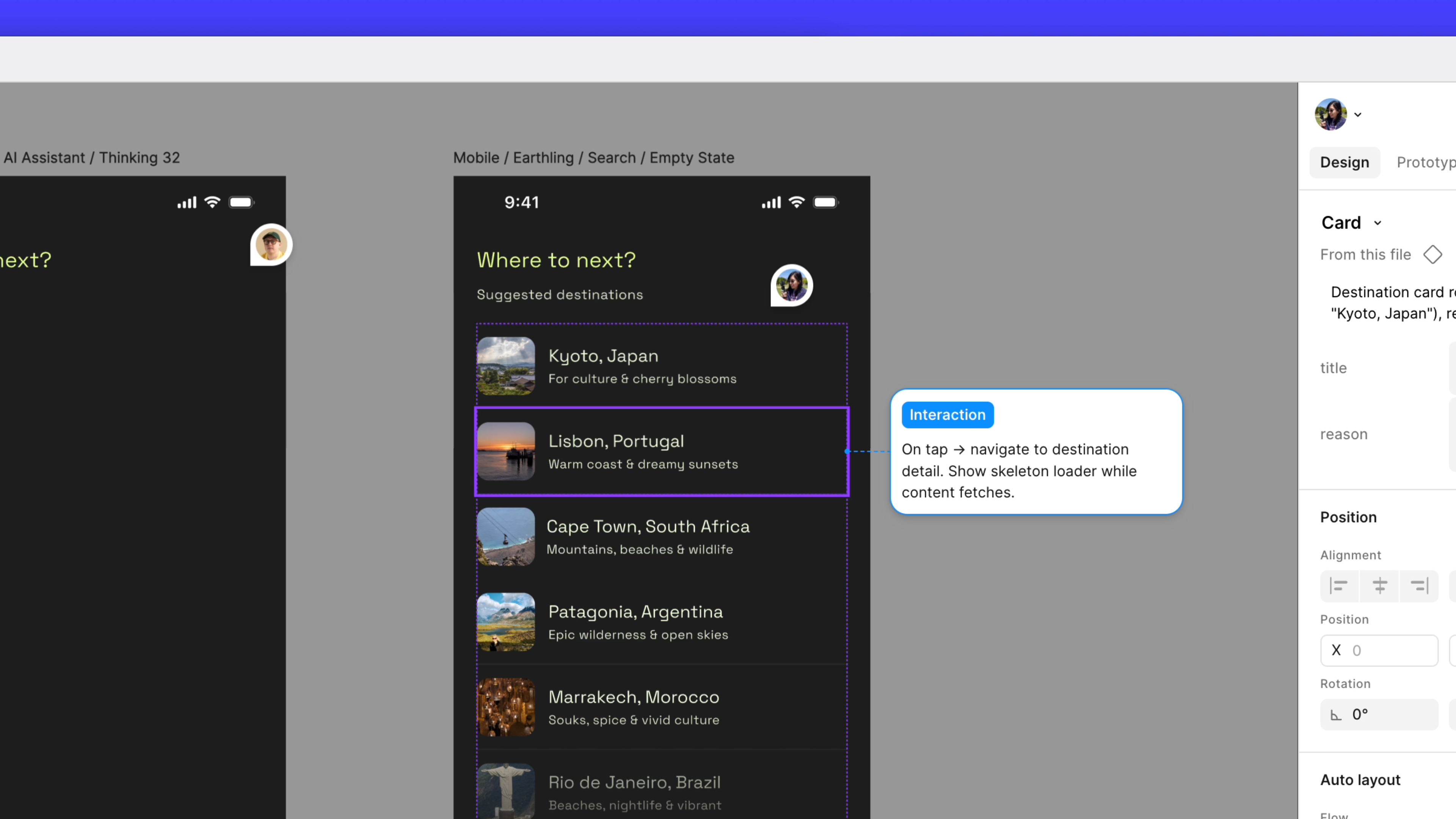

Add annotation
She can also add annotations directly on the frame to communicate the interaction logic — what happens when a user taps on a destination card, and what the loading state should look like. Because annotations live right on the design, the AI agents can pull important design context right from the source.
To add an annotation:
- Click Annotation in the toolbar or use the keyboard shortcut
Shift T. - Click on the layer you’d like to annotate.
- Write a note in the text field, or click + Property to select a property from the list. You can include both plain text and properties in an annotation.

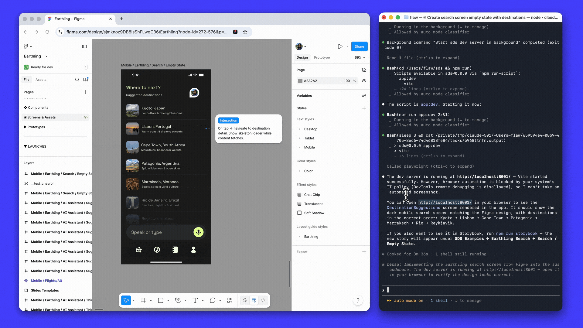

Now that the design is ready to implement, Amy grabs the frame link and heads back to the terminal.
In the terminal, she prompts the agent to implement the changes:
Implement the search screen design from this Figma frame into our codebase. Use our existing components and follow our project's code conventions. [Insert Figma link]The agent reads the design context, and generates code using the actual component library. And just like that, the codebase is updated, and design and code are in sync.
