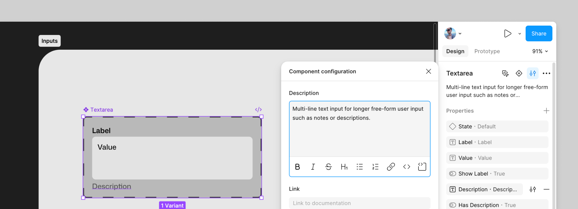

Tip: You can write documentation on the canvas, edit it, then ask the agent to update the description of each component to match. Component descriptions are important because they provide critical context for both designers and agents when they’re building from the library.

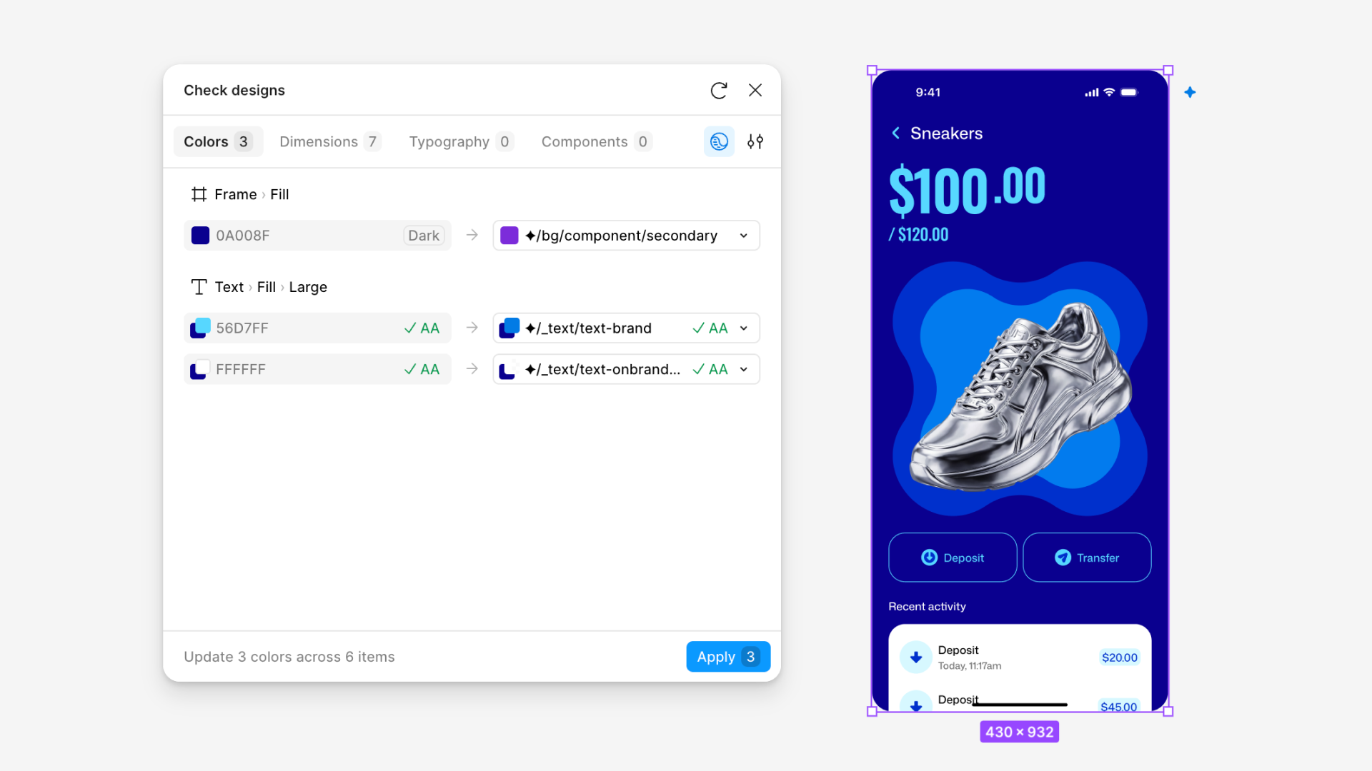

Tip: Before publishing an update, you can also use Check designs—available on the Organization and Enterprise plans—to scan your design file for inconsistencies with your design system.
Check designs helps you identify:
- Incorrect colors
- Components, variables, and styles from incorrect libraries
- Hardcoded values that should be variables
