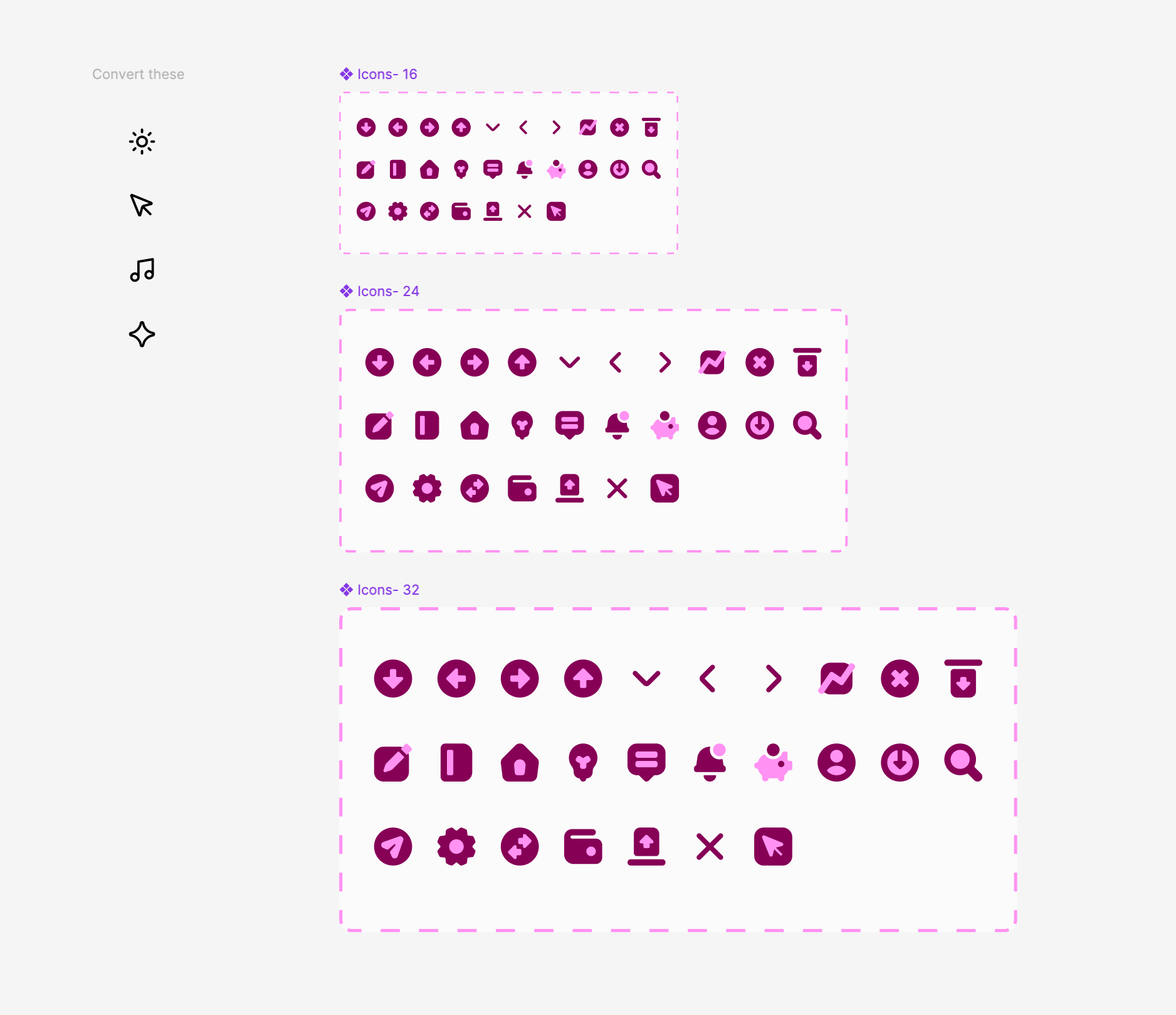

1. Copy the icons into a file
First, click Copy frame on the image below and paste the icon layers from your clipboard into a new Figma Design file.

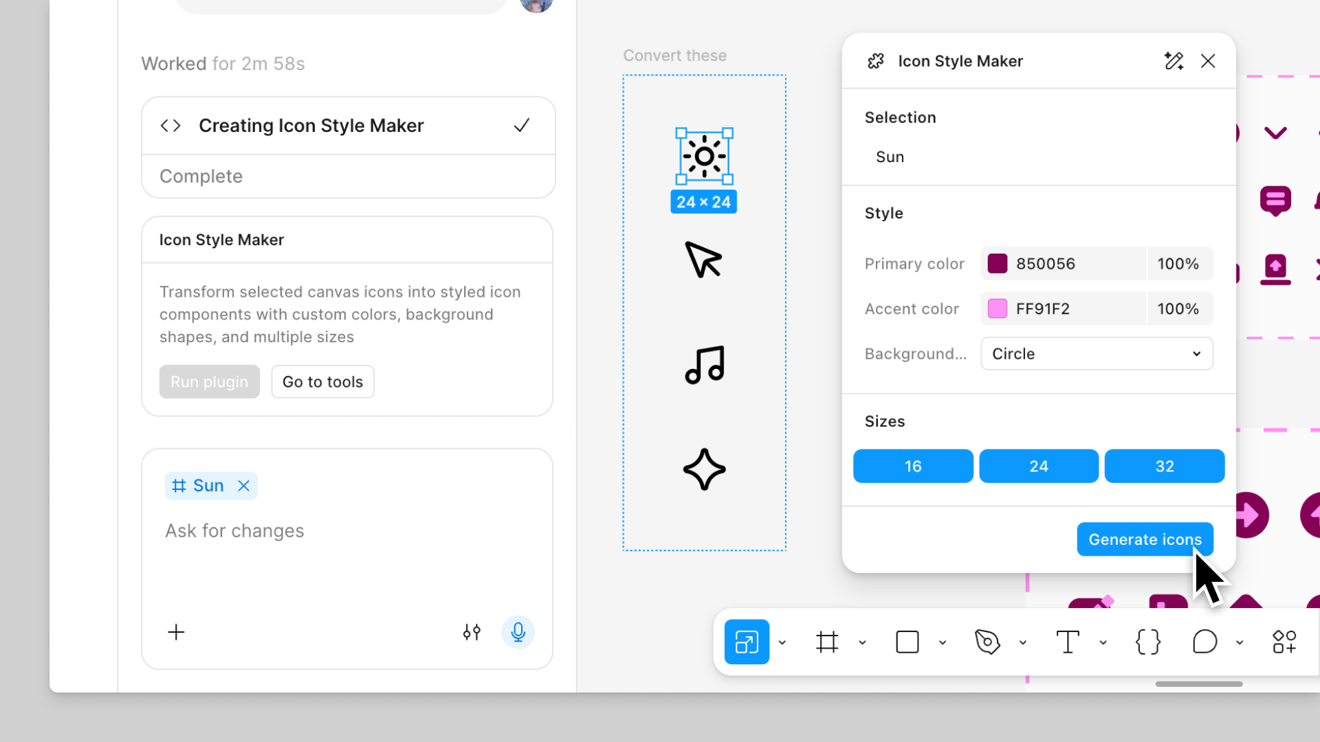

2. Run the prompt with the agent
Click Agents in the left navigation bar of your file, then paste the prompt below into the chat and set the agent to work.
Create a Figma plugin that turns the currently selected canvas icon into styled icon components matching the existing icon component sets.
Plugin UI:
- Selection section: show the selected icon name or preview.
- Style section: primary color, accent color, and background shape.
- Primary default: #850056
- Accent default: #FF91F2
- Background options: circle or rounded square
- Sizes section: selectable buttons for 16, 24, and 32.
Transformation rules:
- Create one icon for each selected size.
- The output frame should be exactly the selected size.
- The background shape fills the full frame and uses the primary color.
- The selected icon vectors are scaled to 70% of the frame and centered directly inside the background.
- Do not wrap the icon vectors in an extra frame.
- Apply the accent color as both fill and stroke to every icon vector.
- Scale stroke weights proportionally for each output size.
Tip: A simpler prompt, like “Make a plugin that styles icons”, would likely take more back and forth with the agent to get to the same outcome.
In general, we recommend starting with the strongest prompt you can to ground the agent in what you want. Even with a detailed prompt, it might take a couple of tries for the agent to get it exactly right.
3. Run the plugin
When the agent has finished, click Run plugin from the chat. Then select one of the unstyled icons as input for the plugin to work from and run it.
