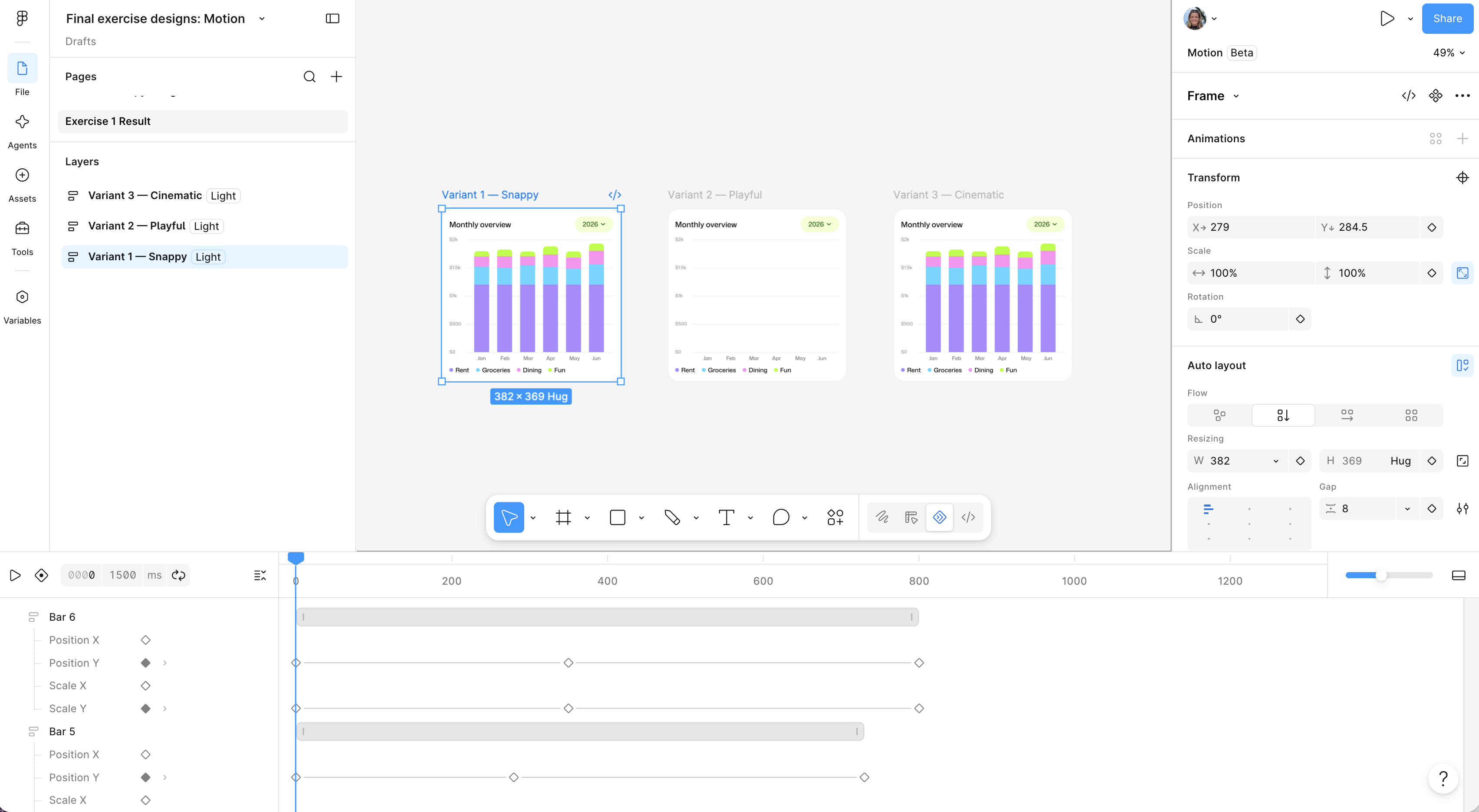

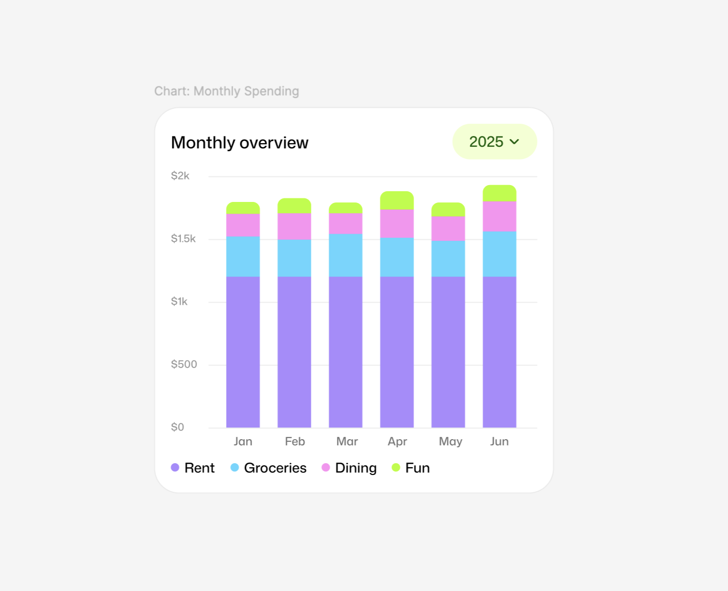

1. Copy the chart component into a file
First, click Copy frame on the image below and paste the monthly spending chart design from your clipboard into a new Figma Design file.
2. Run the prompt with the agent
Click Agents in the left navigation bar of your file, then paste the prompt below into the chat and set the agent to work.
Create 3 motion variants for this stacked bar chart. Animate the groups of colored bars as one shape, not the axes, gridlines, labels, or container. Each variant should have a distinct feel: one snappy and data-driven, one playful with a bounce, one cinematic and deliberate. Vary the easing and stagger between variants but keep the total duration consistent across all three.Then, switch the toolbar toggle to Motion, select each chart frame, and press play to view the results.
Narrowing from three options to one is usually faster than getting the first one right. From here, you might pick the variant that feels closest to right and dial in the timing, easing, and choreography until it feels exactly right.

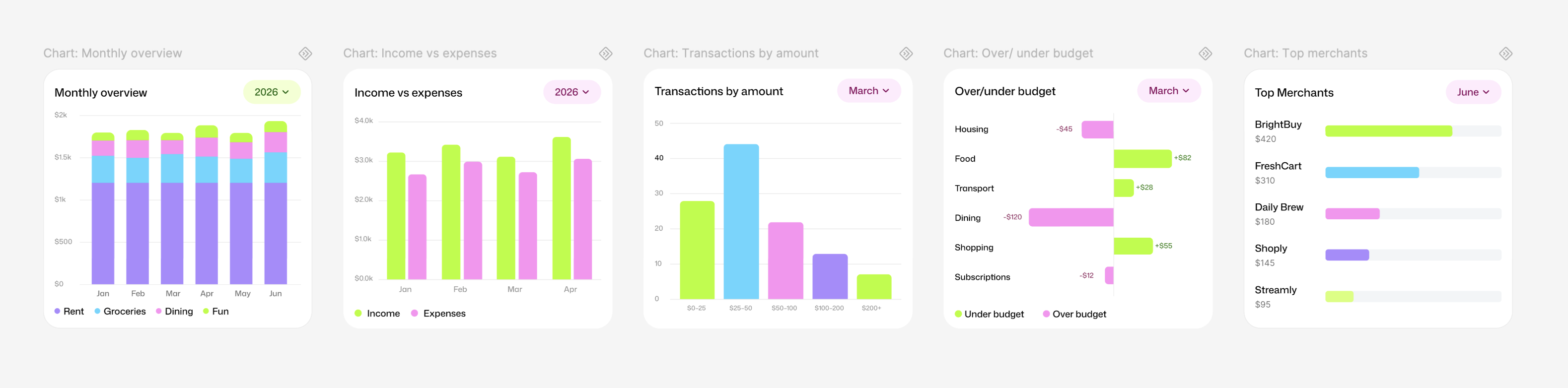

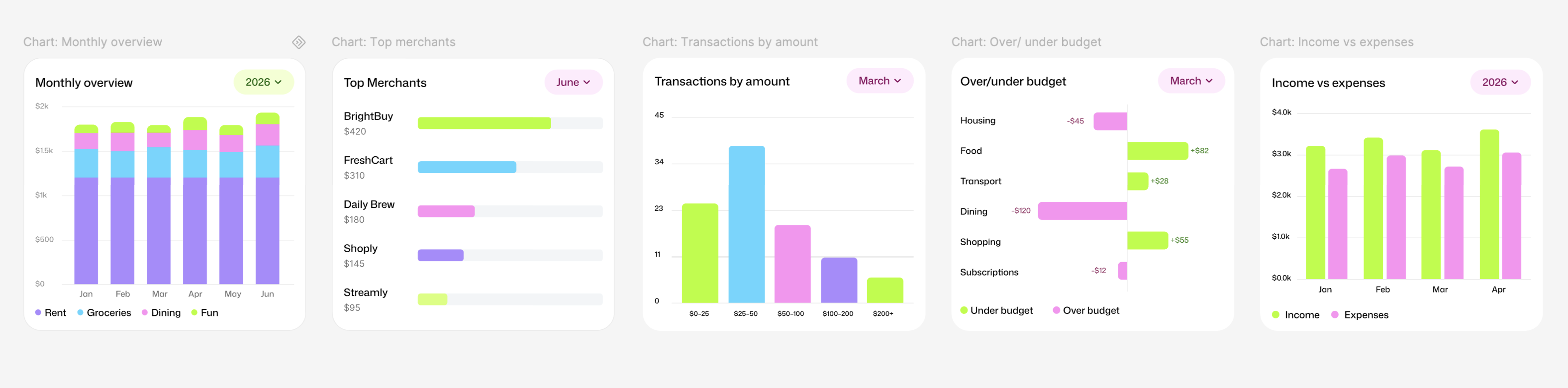

We’ll build on the chart component from the previous example. Here, we want to apply the motion style we added to the first chart to other components in the set.
First, click Copy frame on the image below and paste the chart designs from your clipboard into your design file. The first chart has motion already applied, and the other charts don't have any keyframes.
Tip: Frames with motion applied have a Motion icon on the canvas.
Click Agents in the left navigation bar of your file, select all of the chart frames, then paste the prompt below into the chat and set the agent to work.
Apply the same animation style as the monthly spending chart to the other chart designs. For each chart, reveal the data in the direction it flows: vertical bars grow up from the baseline and horizontal bars grow left to right. Ensure that these all animate together on the same duration.Then, switch the toolbar toggle to Motion, select each chart frame, and press play to view the results.

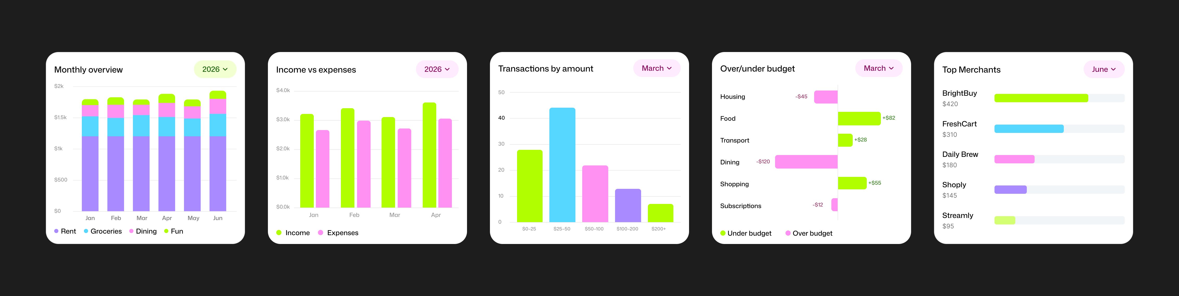

1. Copy the designs into a file
First, click Copy frame on the image below and paste the chart designs from your clipboard into your file. Each of the charts has motion applied.
Change the easing on every keyframe across all selected frames to a custom spring with a bounce of 0.35. Keep all keyframe values and timing positions exactly as they are.With this prompt, notice how the agent updates over 100 keyframes across multiple designs at once. Instead of manually adjusting each keyframe, you can describe the change once, and the agent takes care of the changes.
