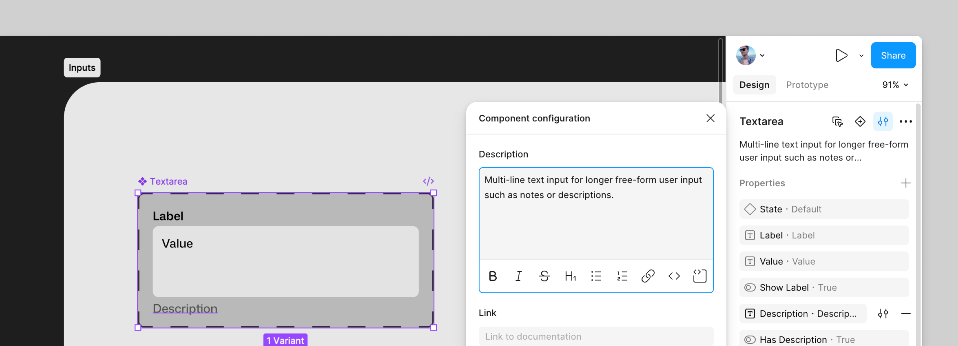

Add descriptions to components and variables
To give agents explicit context about each asset, make sure its description field is filled out.
A description provides documentation for an asset as plain text. These descriptions appear in search results, helping people and agents find the right resource.
Once you’ve reviewed the documentation on the canvas, ask the agent to update each component’s description to match. You can add descriptions to components, styles, and variables directly in Figma.
Try a prompt like: "Use the documentation on the canvas to update each component, style, and variable description. Add related keywords so people can more easily find this asset when searching."
