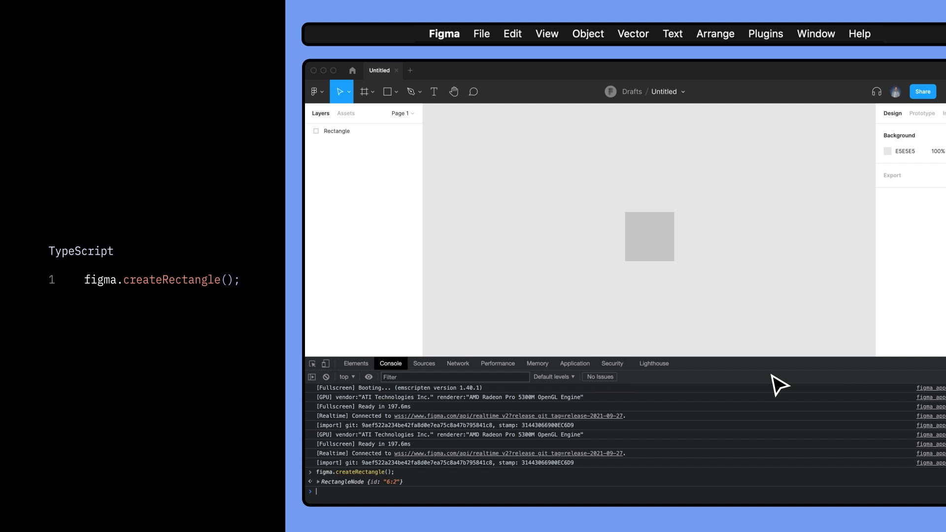

For example, we can create a rectangle on the canvas by writing this statement:
figma.createRectangle();

If you want to try writing your first statement and running it, you can open Figma's Developer Tools in the desktop app by going to the Plugins menu and hovering over Development. Click on Open console, and in the Console tab type in figma.createRectangle(); then hit Enter. You'll see that Figma has created a rectangle, just like if we had used the R shortcut and clicked on the canvas.
