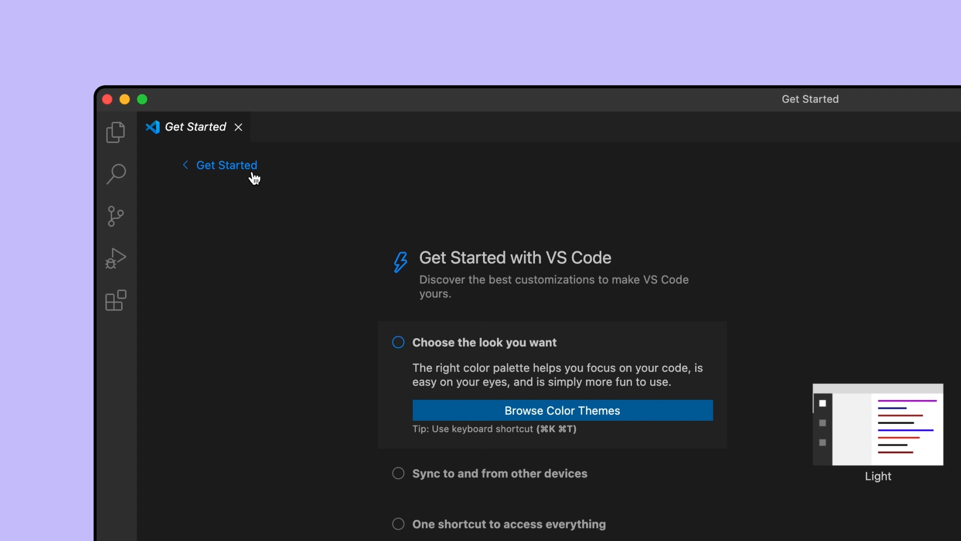

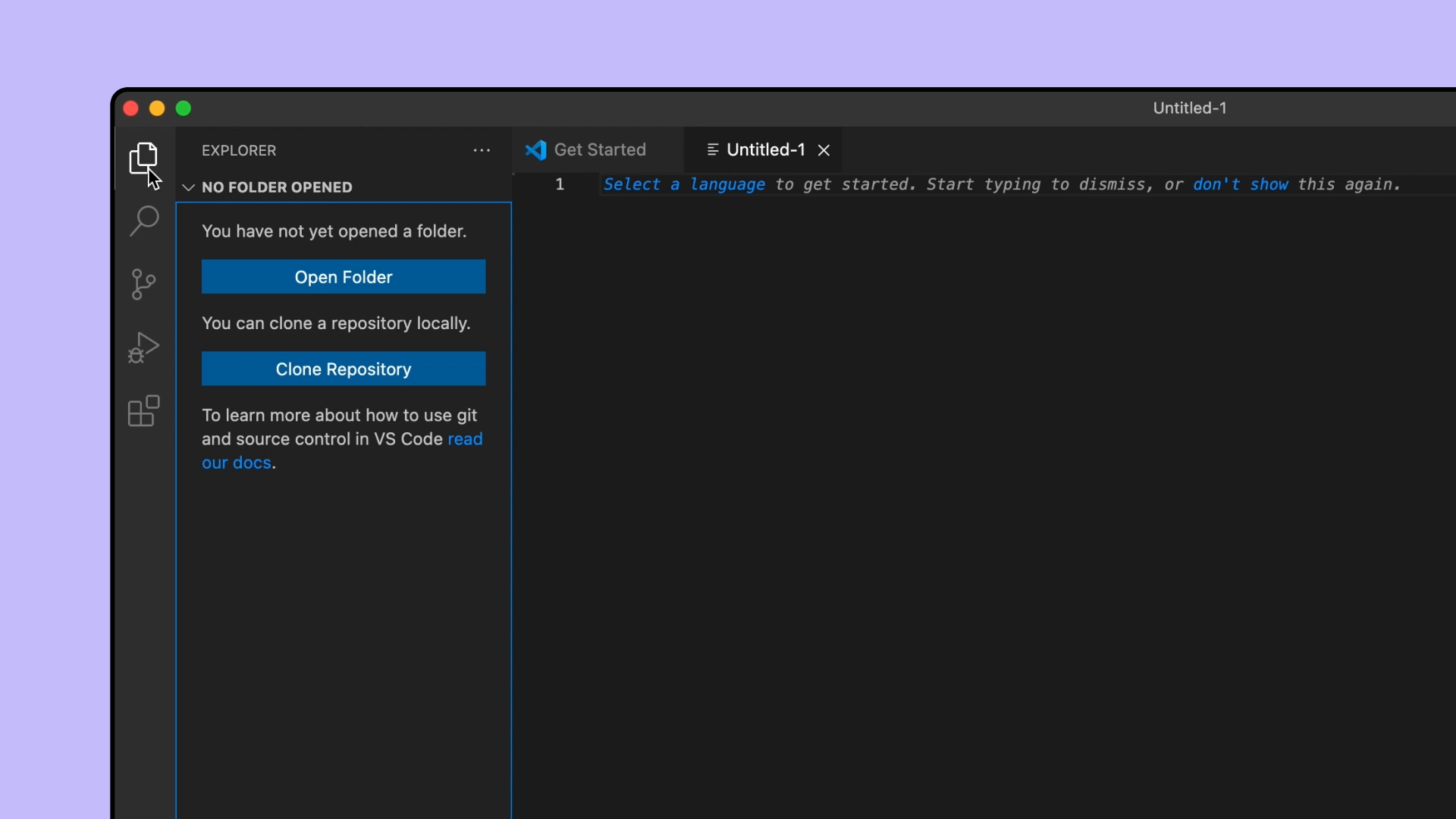

Once your download is complete, let's launch Visual Studio Code and take a look. VS Code may ask you for a few additional setup steps like choosing a theme and browsing language extensions. We don't need to worry about this for now, so you can click on Get Started in the top left corner to go to the welcome screen.

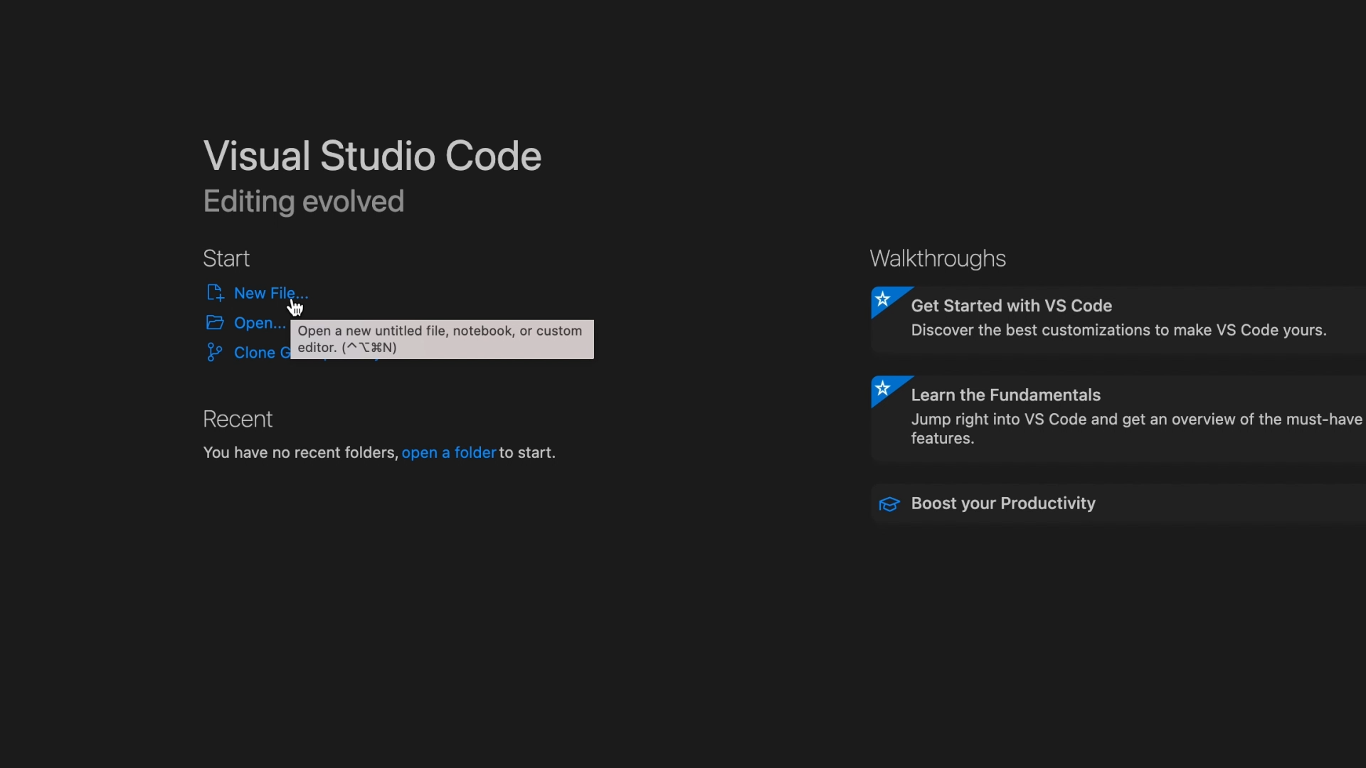

On the welcome screen, you'll see a Start menu where we can create a new file, open an existing file or run a specific command. Let's create a new file to get a better look at our editor.
VS Code will open a new tab. This is the text editor where we'll do a majority of our work when we start writing code.
To the left, you'll see a sidebar with a few different icons.
Let's click on the first icon - it looks like two pieces of paper on top of each other. This is our Explorer. From here we can open code folders and view the structure of those projects.
Visual Studio is an Integrated Development Environment, meaning it combines several commonly used developer tools into one convenient interface.
Underneath the Explorer are icons for Search, Source Control, Run and Debug, and Extensions. We won't be using these IDE features, but feel free to explore if you want to continue familiarizing yourself with Visual Studio.

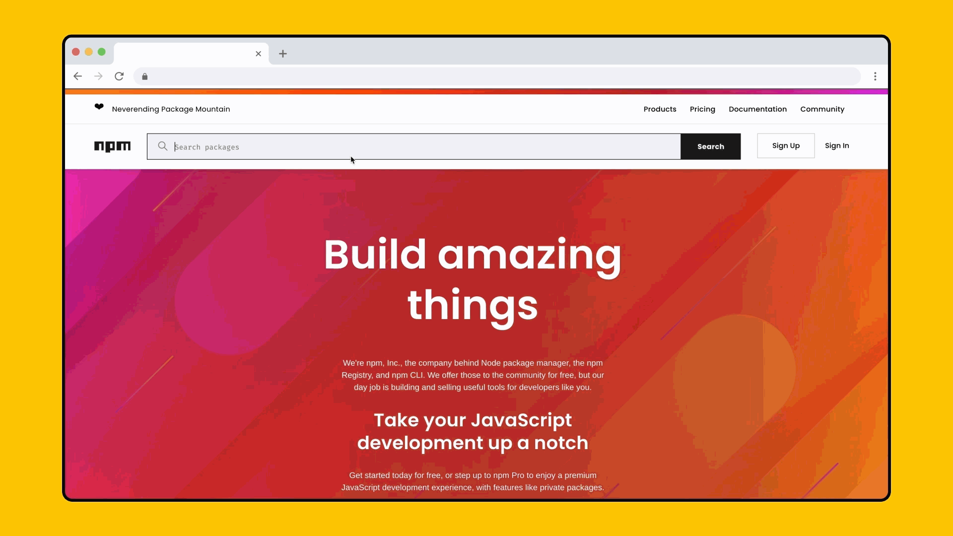

One way to manage these dependencies is through the use of a tool called 'npm' or Node Package Manager.
Originally, JavaScript was a language designed for web and could not run outside of a web browser. Node.js is an environment that allows us to do this.
Npm is the default package manager for Node.js. Npm is both a command-line tool and an online repository of open source Node.js projects. Instead of manually including dependencies into our project, npm makes it easy to install these dependencies using scripts.
For example, a library like TypeScript has hundreds of files and dependencies. If we were to include these dependencies manually, it would take us forever and it's likely that we'll make a mistake along the way. Instead, we can use a single npm script to install the entirety of TypeScript which saves us time and leaves less room for error.
In order to use npm, we first need to download Node.js. Go to nodejs.org and click on "Downloads."

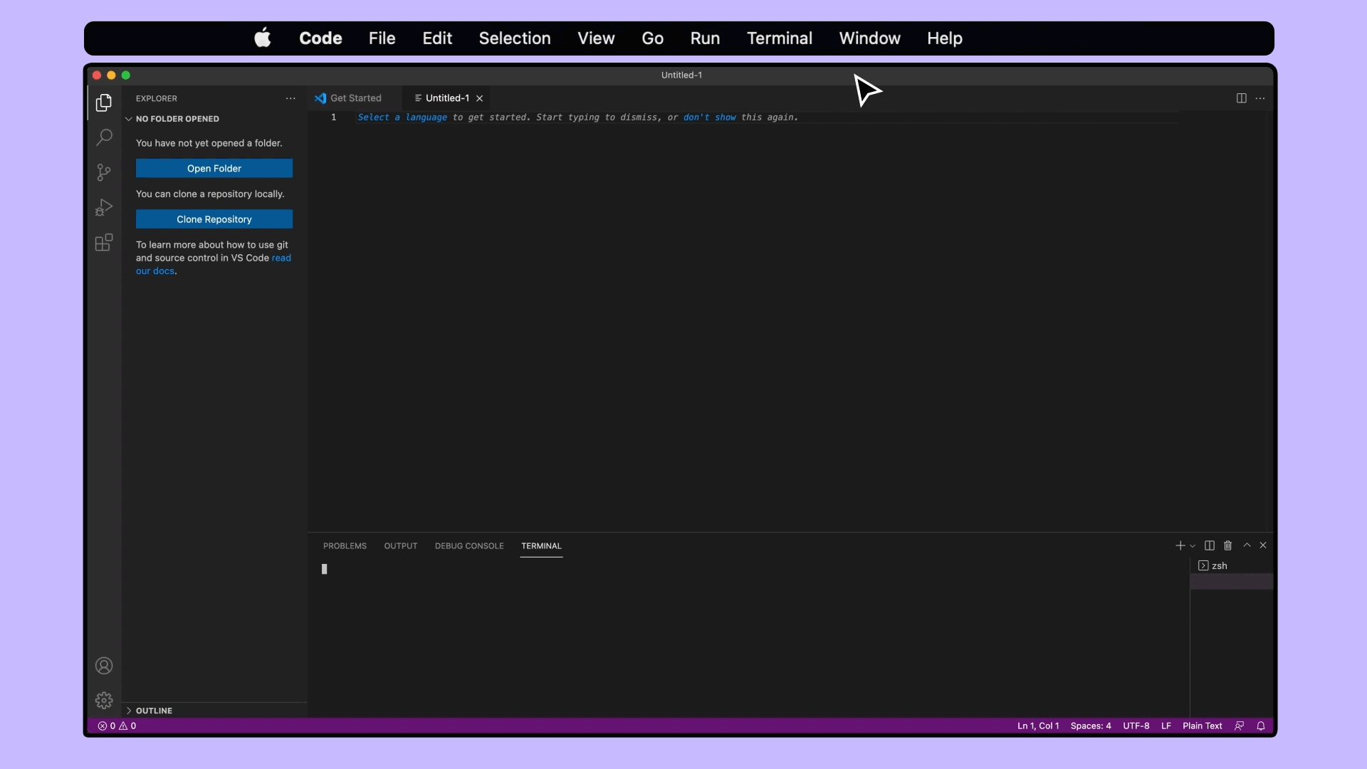

We can verify that node was properly installed by checking it in Visual Studio's built in terminal. A terminal is a text-based interface where we can do things like execute programs or type in commands to tell our computer to perform certain actions. Open up a new terminal window by clicking Terminal in the top menu and selecting New Terminal. Then, type node and hit enter. You'll see a line that will tell you which version of Node.js you've installed.
If you are not seeing this message, try restarting Visual Studio and running this command again.
Hit Ctrl-C twice to exit Node.

To use npm, we'll need to open up a new terminal window.
Find Terminal in the top level menu, then select New Terminal.

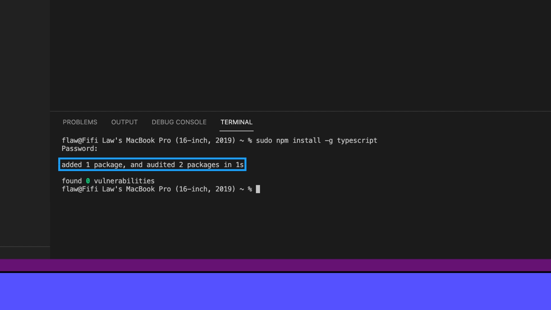

From here, we can install TypeScript using npm by typing this line of code in the command line and hitting Enter:
Windows:
npm install -g typescript -
Mac:
sudo npm install -g typescript
You may be asked for a password once you run this script. Typically, this is the same password you use to log in to your computer. Keep in mind that once you start typing in your password, you may not see anything being typed out. Don't worry, the terminal is still reading your input.
If the installation is successful, you'll see something like this:

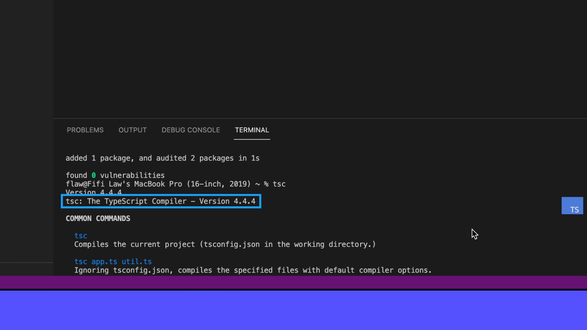

Verify TypeScript installation
To check that everything works, you can run this command to see the version of TypeScript you just installed:
tscInstall the Figma desktop app

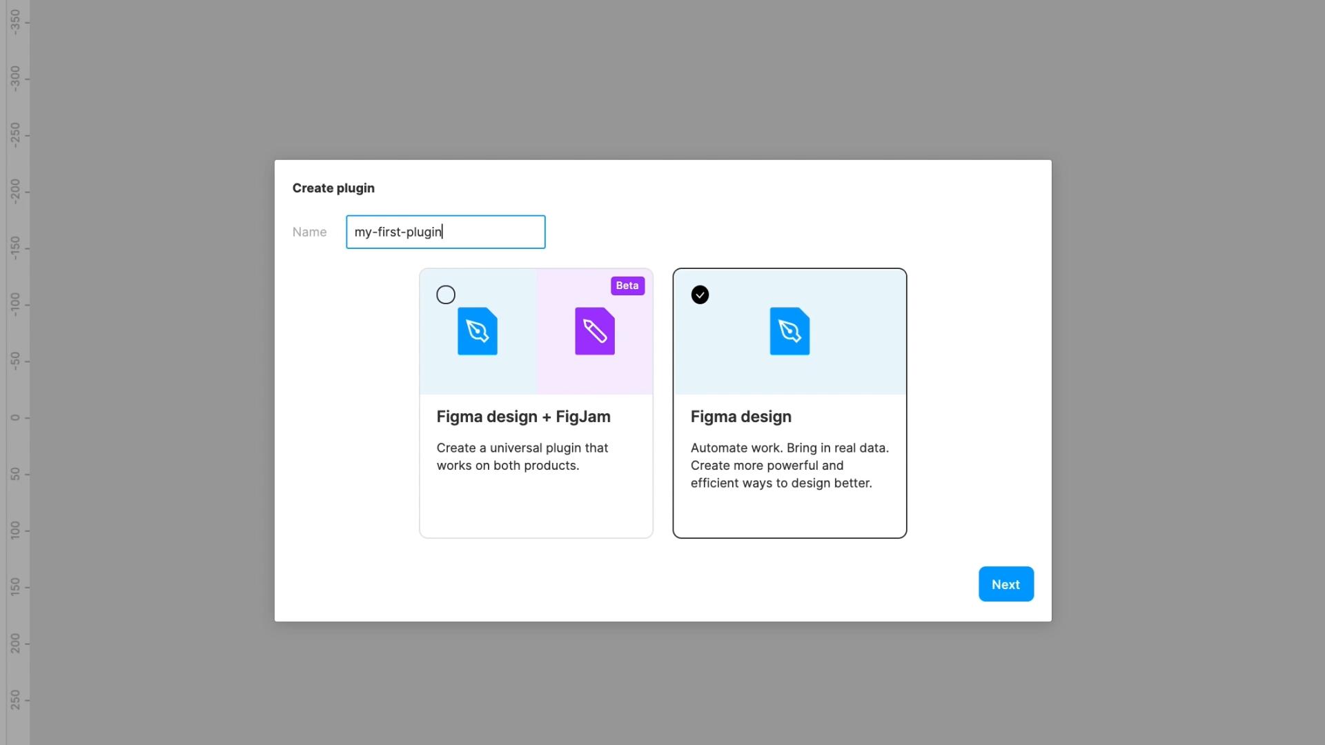

Now, select Plugins from the menu, then under Development select New plugin.
This will bring up the Create plugin modal. Since we're building this plugin for Figma only, we'll select Figma Design. Let's name this "my-first-plugin", and hit Next.
You'll see three options for creating a new plugin - 'Empty', 'Run once' and 'With UI & browser APIs.' The sample plugin we're using requires an interface, so we'll create it with a UI & browser APIs. Hit Save as to save it anywhere on your disk. Moving forward, it might be helpful to create a dedicated folder for your plugins to make them easy to find later.

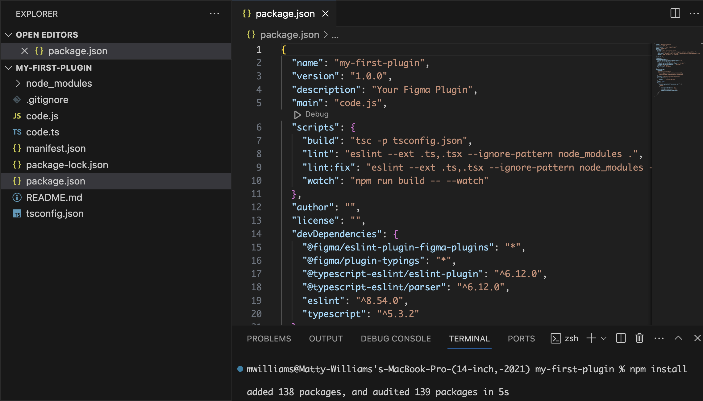

Install dependencies
What's changed? Since we first created the Build Your First Plugin course, we’ve introduced some changes to Figma to make it easier to set up a new plugin. In the video, we previously described how to install the Figma typings file. Now, the Figma typings are automatically included as a dependency when you create a plugin. We’ve updated this section (previously “Install typings”) to reflect the changes.
You might notice that there are a few errors in our code highlighted by Visual Studio.
To fix this, we need to install Figma's typings file and the plugin linter into our project.
Think of the typings file and plugin linter (software that automatically tests your code for issues) as assistants while you use the Figma API. While the API documentation is there for you to reference as you build your plugin, the typings file contains annotations that can assist you while writing code by providing API suggestions and letting you know when you've missed an edge case. The plugin linter uses ESLint with a set of rules for the Plugin API and lets you know if you try to do things like use deprecated API methods.
To install the dependencies, open up a new Terminal and run this script in new plugin directory:
npm installWhen you run npm install, npm reads the package.json file in your plugin directory and installs the dependencies that are defined there, such as the typings and linter. package.json also includes the default configuration for the plugin linter.
If the installation was successful, you'll see something like this:
That should've fixed the errors in our TypeScript file. If we take a look at our Explorer again, you'll see a new directory called 'node_modules.' This is where the typings library is saved. In the index file are the annotations we mentioned earlier for the Figma Plugin API. Feel free to take a look if you're interested in how the types are defined, but make sure not to change anything here!

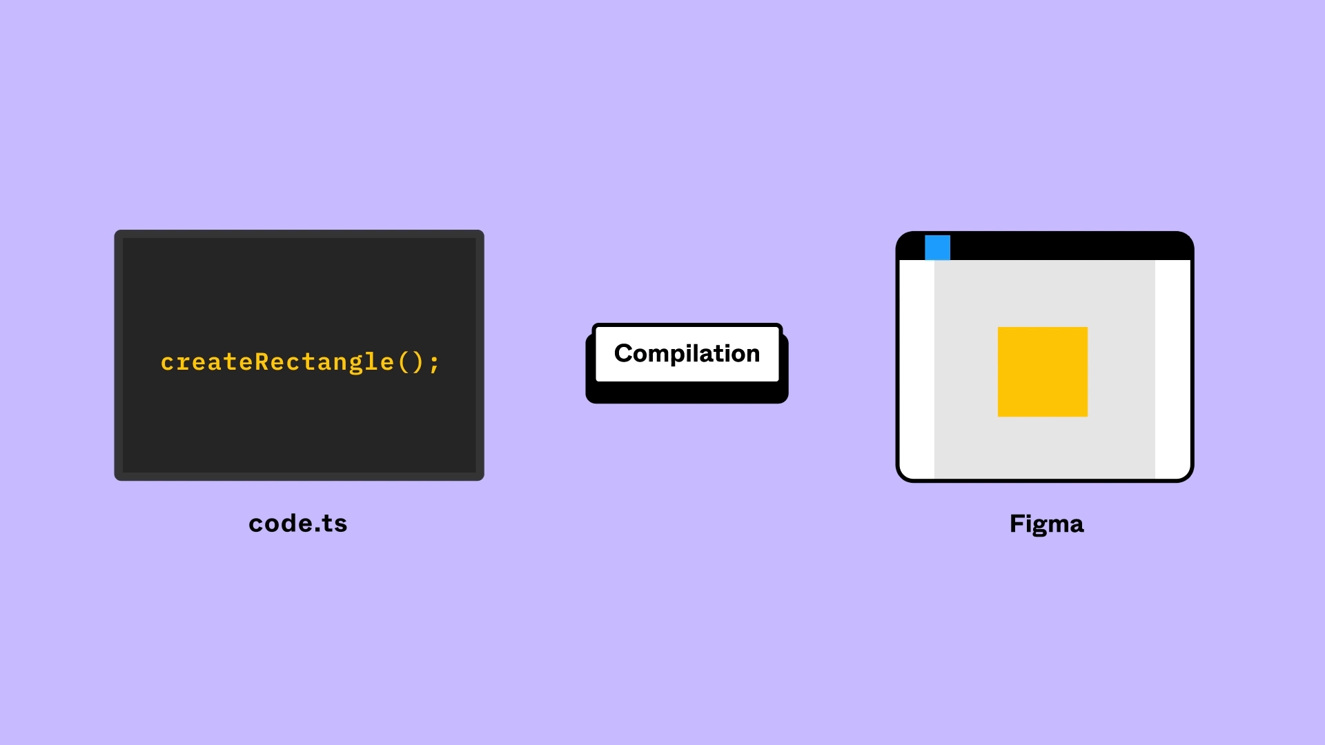

With our dependencies set up, all that's left for us to do is to make sure that our TypeScript compiles to JavaScript in order for our plugin to run.
You might have noticed in the manifest.json file that the main field references a JavaScript file instead of the TypeScript file we looked at earlier.
Since Figma plugins run in the browser, and browsers only support JavaScript, the main field in our manifest will always point to a JavaScript file. Compilation is the process responsible for making sure that our TypeScript gets turned into usable JavaScript that allows our plugin to run.
Our plugin code will continuously change and evolve as we build it. Having to go through the compilation process every time that we save a new change to our file can become tedious. Instead, we should set up our project to watch for changes in code.ts then automatically compile into code.js by hitting CtrlShiftB in Windows, or CommandShiftB for Mac then selecting 'tsc:watch-tsconfig.json.'

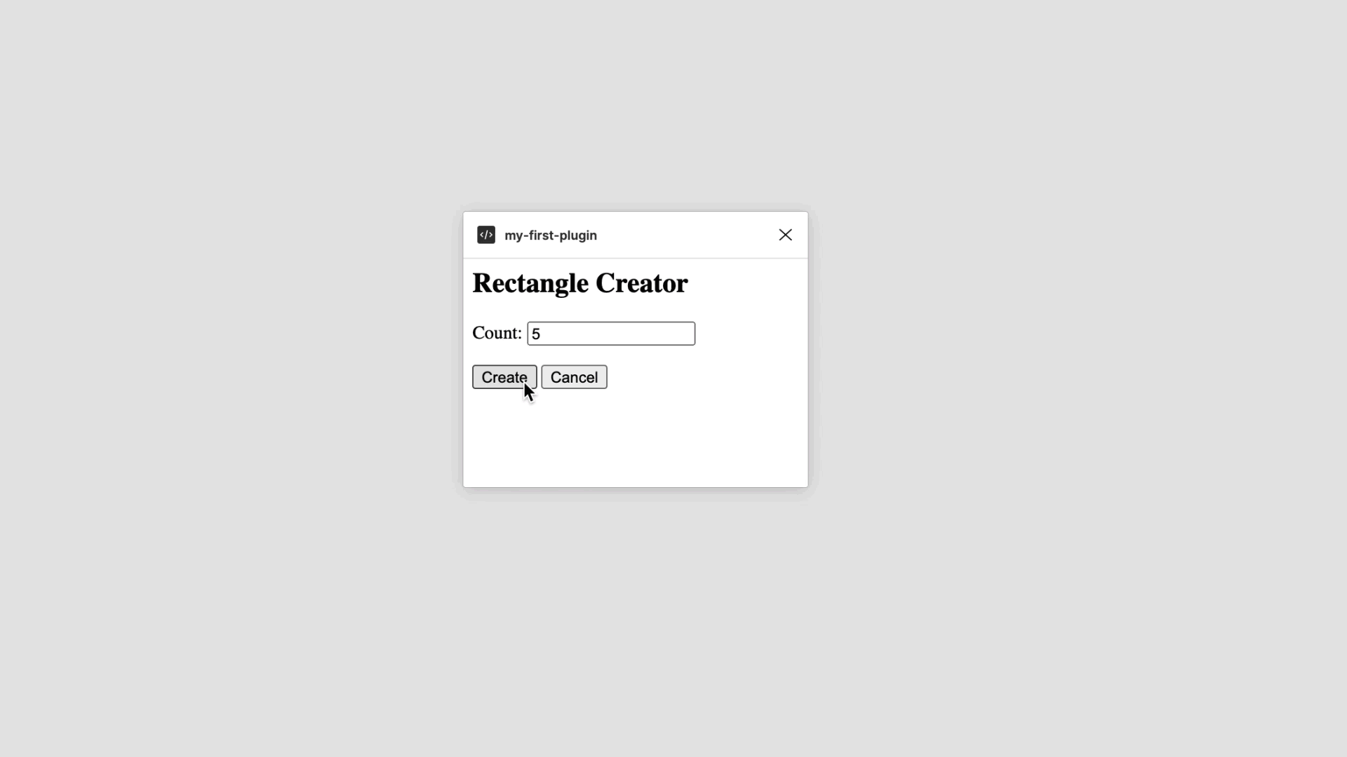

Now, we're ready to run the sample plugin! Go back to the design file we created in the Figma desktop app, navigate to Plugins and under Development, select the name of your sample plugin.
A modal will pop up with an input for the number of rectangles you want to create. For now, we can stick with the default of five rectangles and hit Create to run the plugin.
You should see that five orange rectangles have been created in the canvas.

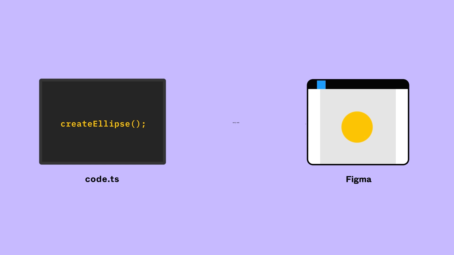

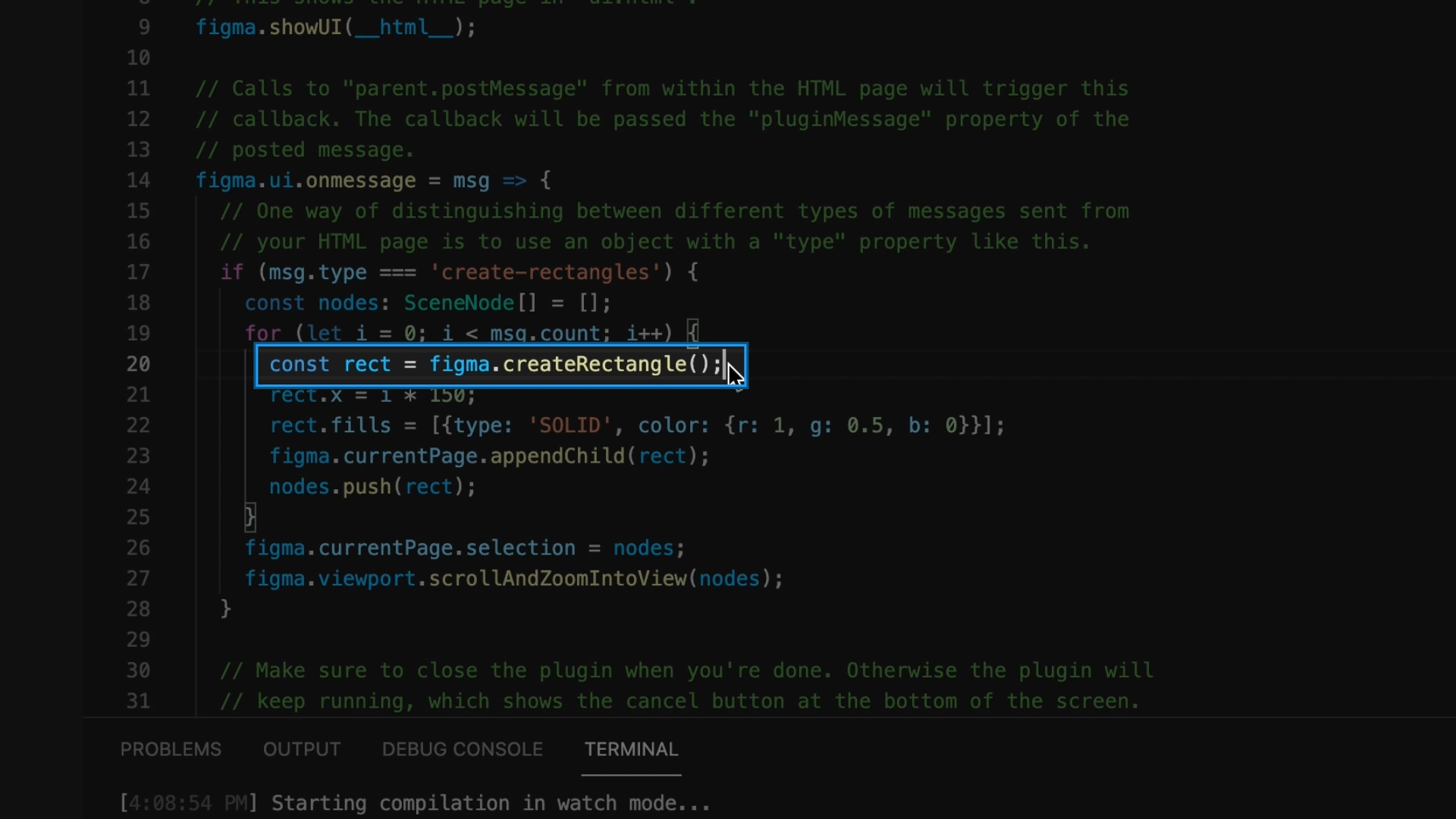

Great! Your environment is setup and ready for building plugins. Let's make a few test changes in code.ts and re-run our plugin.
In code.ts, on line 20 we'll find the code that creates a rectangle.
Let's modify this by replacing figma.createRectangle() with figma.createEllipse(). Save your changes, then go back to Figma and re-run the plugin. What do you notice? Has anything changed?
Now, on line 22 in code.ts you'll see something that says rect.fills with type and color values passed in. Let's change the rgb values to 0, 0 and 0. Don't forget to save your work! How are our shapes different?
As you can see, changing the code in our TypeScript file also changes the way that our plugin behaves. Using the Plugin API, we are able to interact with objects that exist on the canvas, or create new ones entirely!
