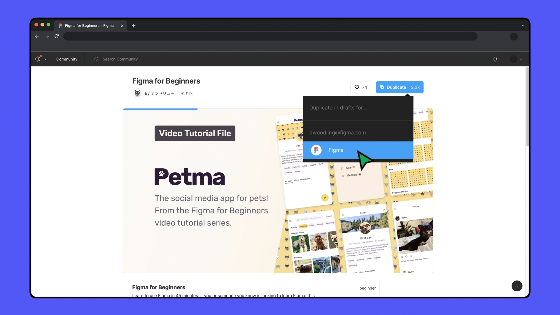

Copy the design file
You can get a copy of the design file with pre-made components by searching Figma for Beginners in the Community from the desktop app.
With the Community page open, create your own copy of the file.

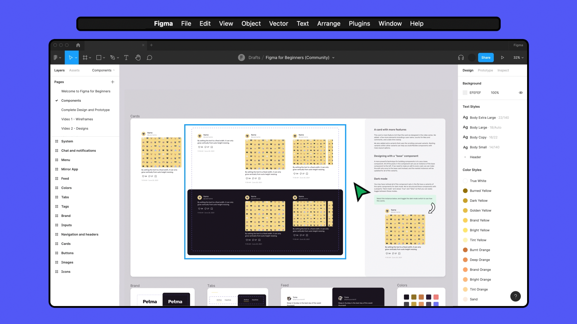

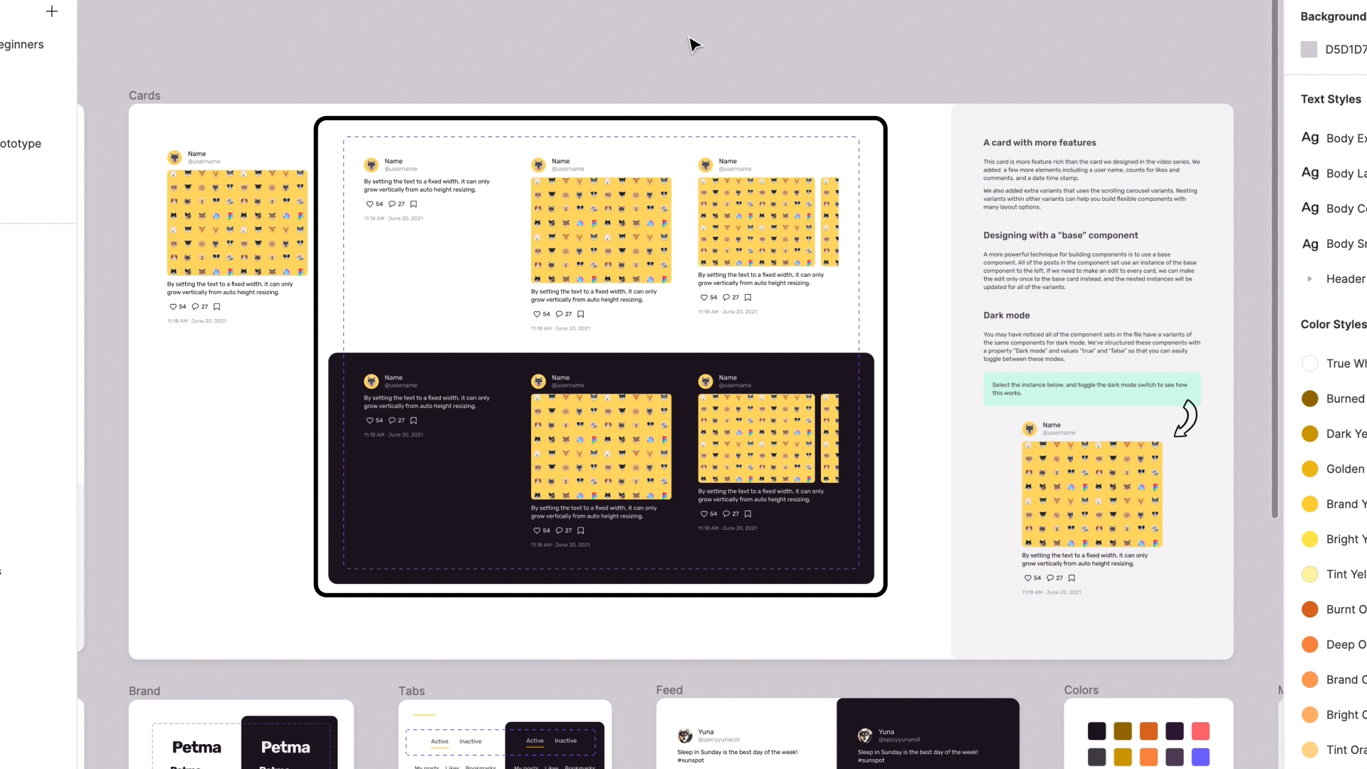

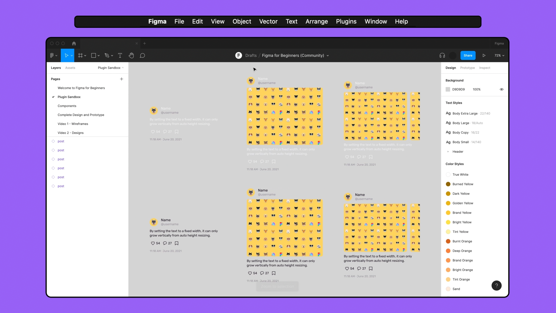

With the Figma for Beginners file open in the desktop app, go to the Components page and take a look at the Cards.
Here, you'll see a few variants of a Petma post component. Our plugin will be responsible for creating an instance of one of these post components. To do this, we'll need:

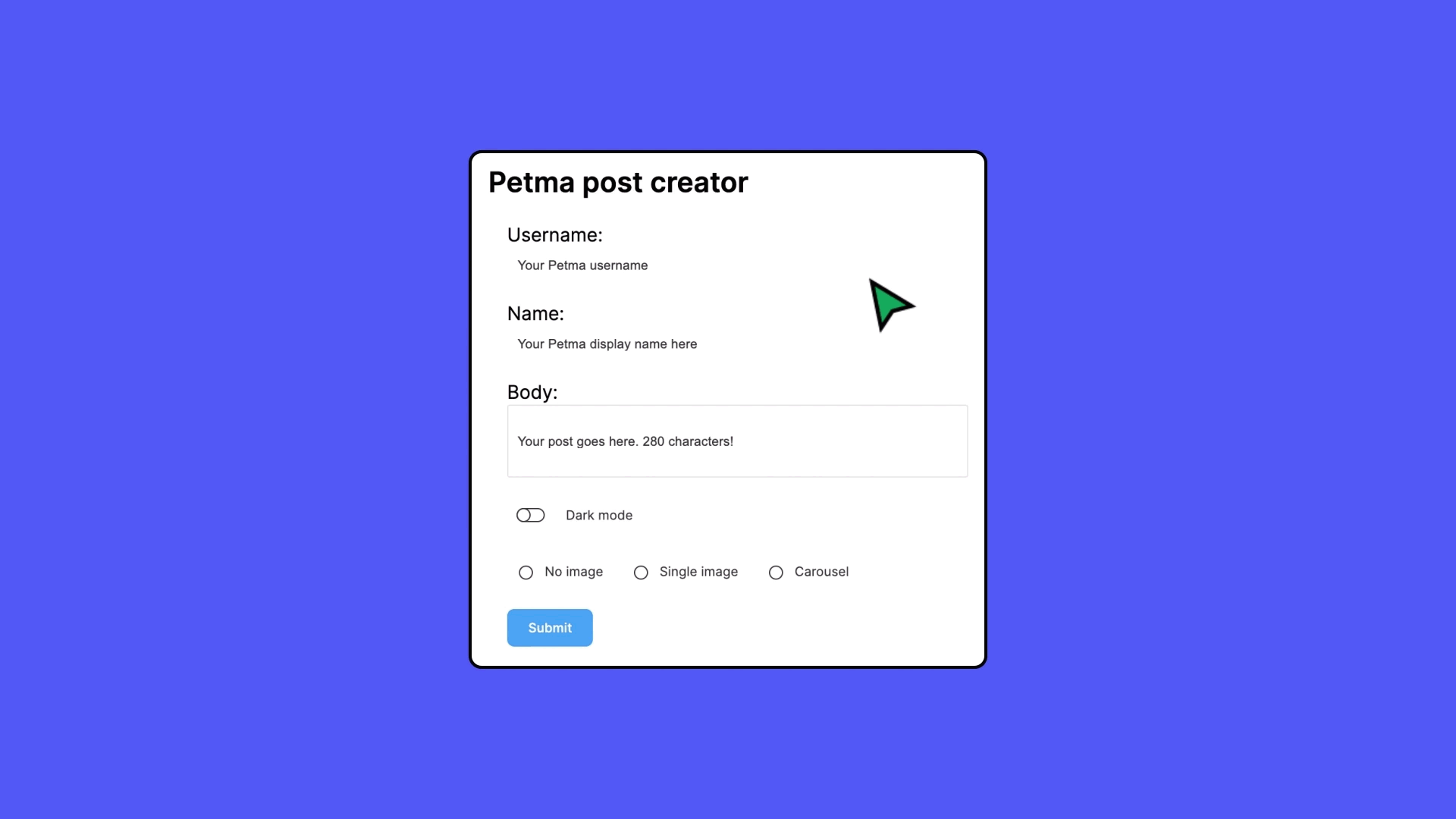

- A window with a form for the user to fill out
- A plugin name. We can do this by adding a heading to the form.
- Input fields and labels for Username and Name
- A text area and label for the Description of the post
Remember that an input field is generally a one-line field, so for multiple line entries we want to use text area. We could limit our Petma posts to a specific character count, or have no limit at all. Either way, we want to make sure we use an input type like text area that can handle large text entries.

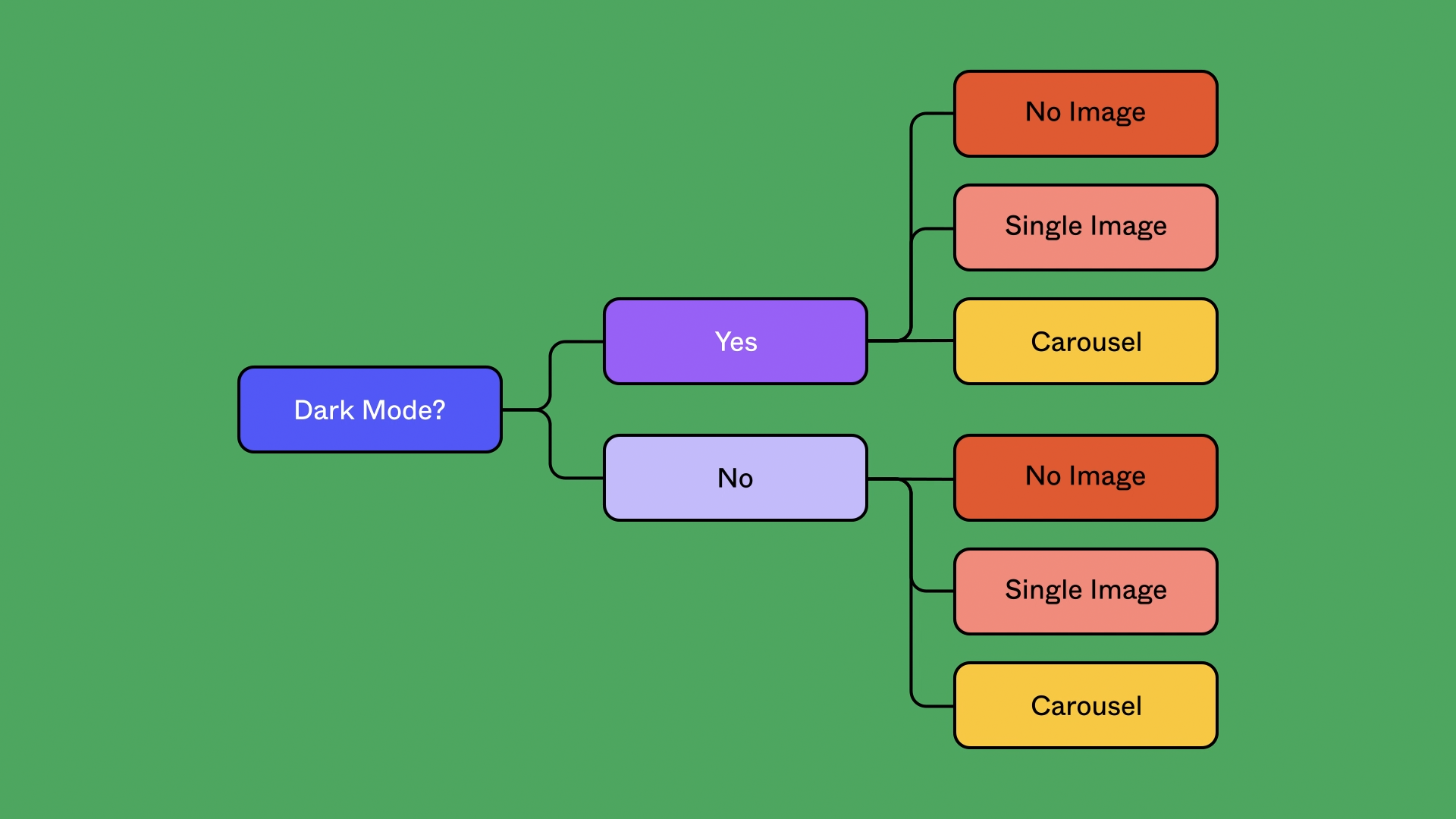

You'll notice that there are several variants of the post component. We also want to provide our user with ways to:
- Choose between light mode and dark mode
- Specify whether they want no image, a single image or multiple images on their post
These features could be implemented a number of ways - with components like dropdowns, radio buttons or input fields.
Tom Lowry's lightweight UI library provides useful pre-built components we can add to our plugin. For example, the Switch component can be used to toggle between light mode and dark mode, and the Radio buttons would allow a user to select an option for the number of images in a post.
To save us time with creating these components, we are going to include Tom’s UI library in our project later.
Finally, we'll add a button to submit all of the information from the form.

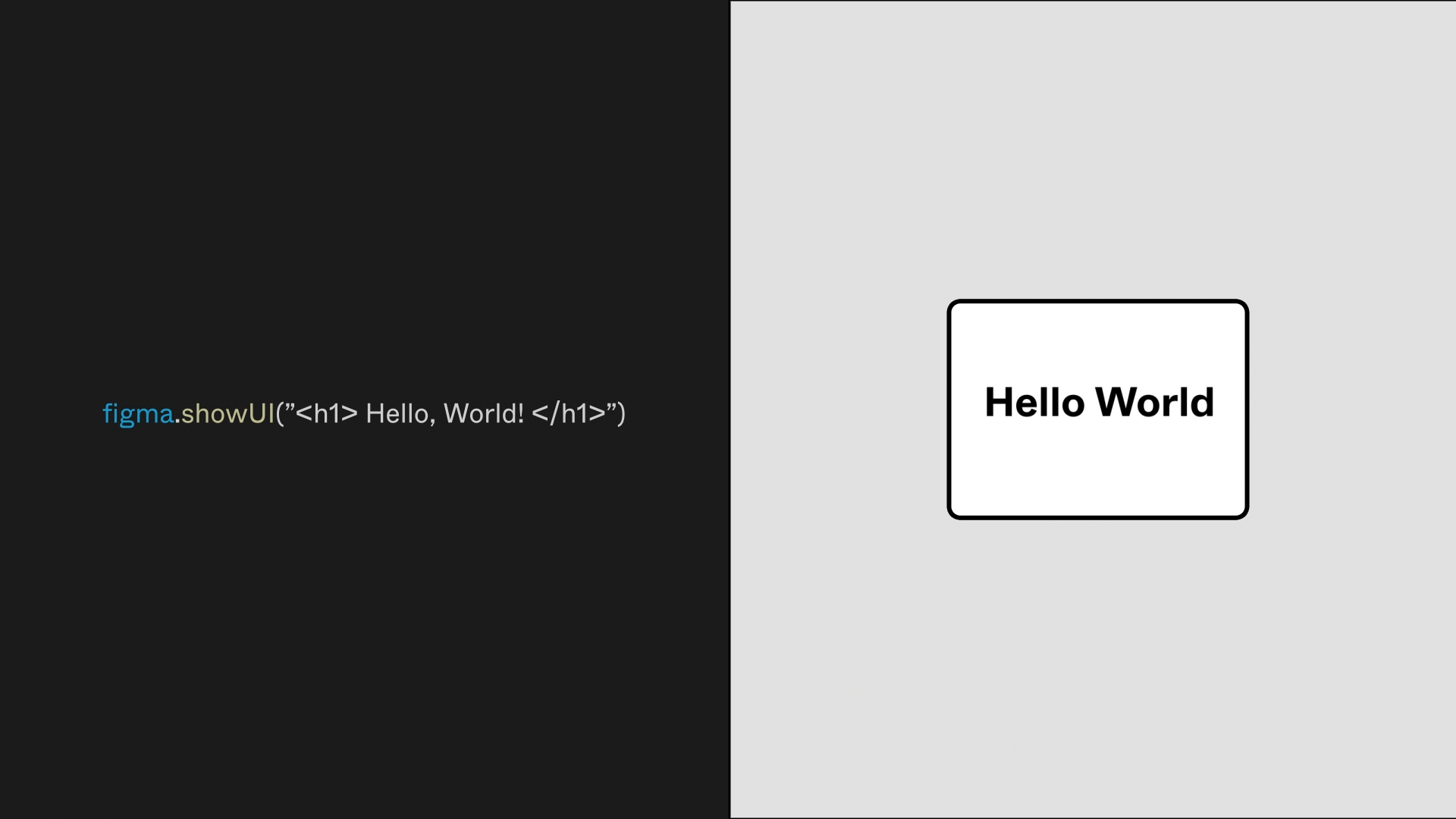

Taking a look at our checklist, we want a modal to pop up when we run our plugin.
In ui.html, let's give our plugin a title. We can use an <h1> heading tag for this. This is the message that will display in the modal once it pops up.
The Figma API has a showUI function that displays a plugin’s interface. This function creates a modal that contains the html markup we pass into it. For example, figma.showUI(”<h1>Hello, world!</h1>”) would result in something like this:
Now, replace that line of code with figma.showUI(__html__). By passing in __html__ , the modal is able to display the contents of your HTML file.
In your manifest.json file, you’ll see that the 'ui' property is set to 'ui.html.' This is how we specify which file the __html__ variable is referring to.

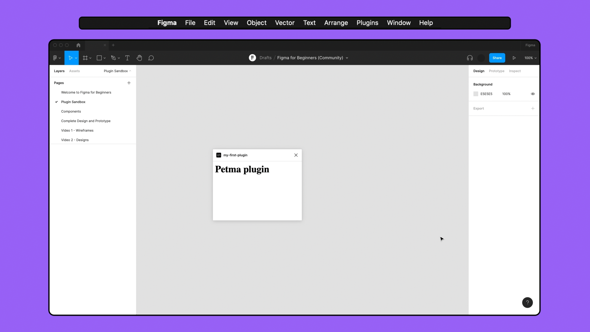

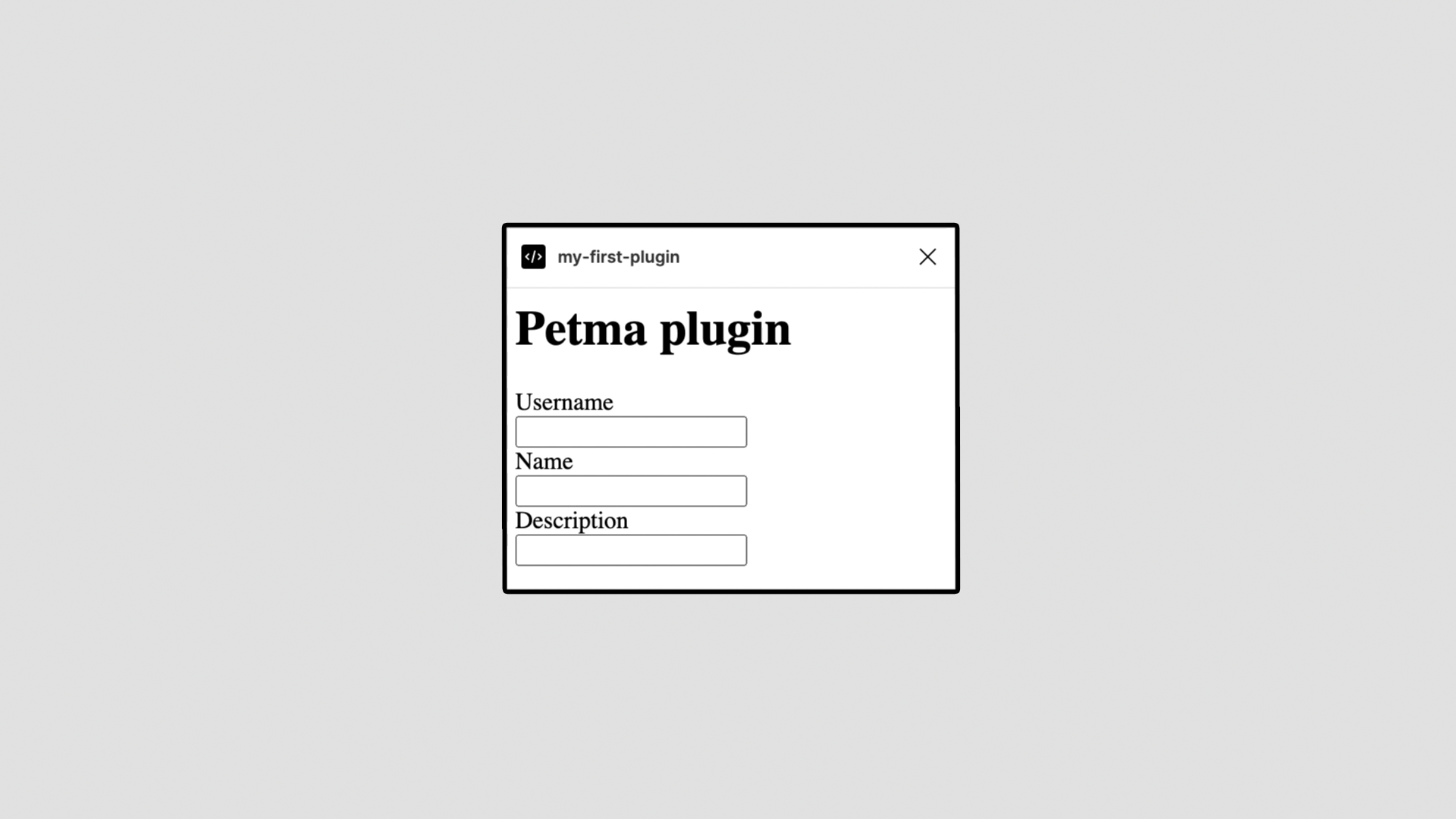

First run of the plugin
So far, we’ve added a heading to our html file, added the showUI function to code.ts and confirmed that our manifest is pointing to the right file. This gives us enough code to run our plugin for the first time.
Remember, we can use the command CommandShiftB then select the ‘watch’ script.
Since the file is now watching for changes, we don’t need to worry about updating the build manually while the project is open in Visual Studio.
Going back to the Figma for Beginners file in the desktop app, we can select our plugin to run it. If the build was successful, you should see a modal pop up with the message we wrote in our html file.
Awesome! Now that you see how changes in our code affect the plugin in the Desktop app, we can continue constructing our UI.

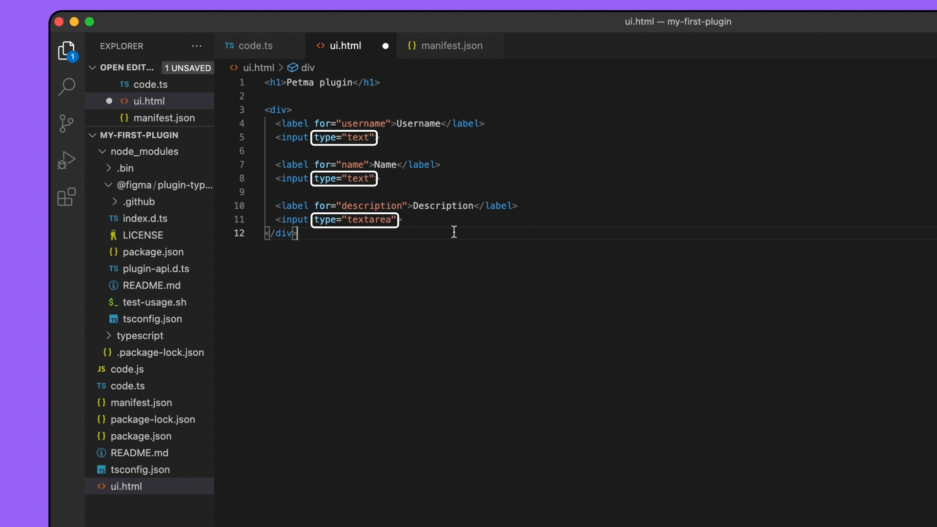

Back in ui.html, let’s add a <div> tag to create a section for our text inputs.
<div> tags are a great way to divide up content in a page. We can use it to group other HTML tags in a way that is easier to visualize. In this div section, we’re going to use the <input> tag to create inputs for the username, name and description. Don’t forget to add a corresponding label to each input!
While the input types for username and name are “text”, remember that description will be a “textarea”, because it needs to hold a larger amount of characters. Since we’re still in watch mode in Visual Studio, we should be able to save our file and view the form when we run the plugin again!

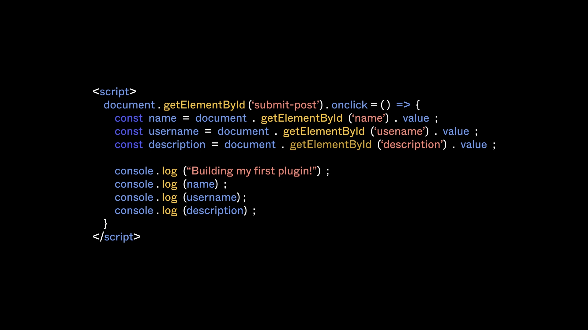

document.getElementById('submit-post').onclick = () => {}Let’s go ahead and add this code to our plugin. We can do this by using <script> tags at the bottom of ui.html and putting our Javascript code in between them. <script> tags allow us to embed JavaScript directly into our HTML file and are typically used to work with dynamic content on a page.

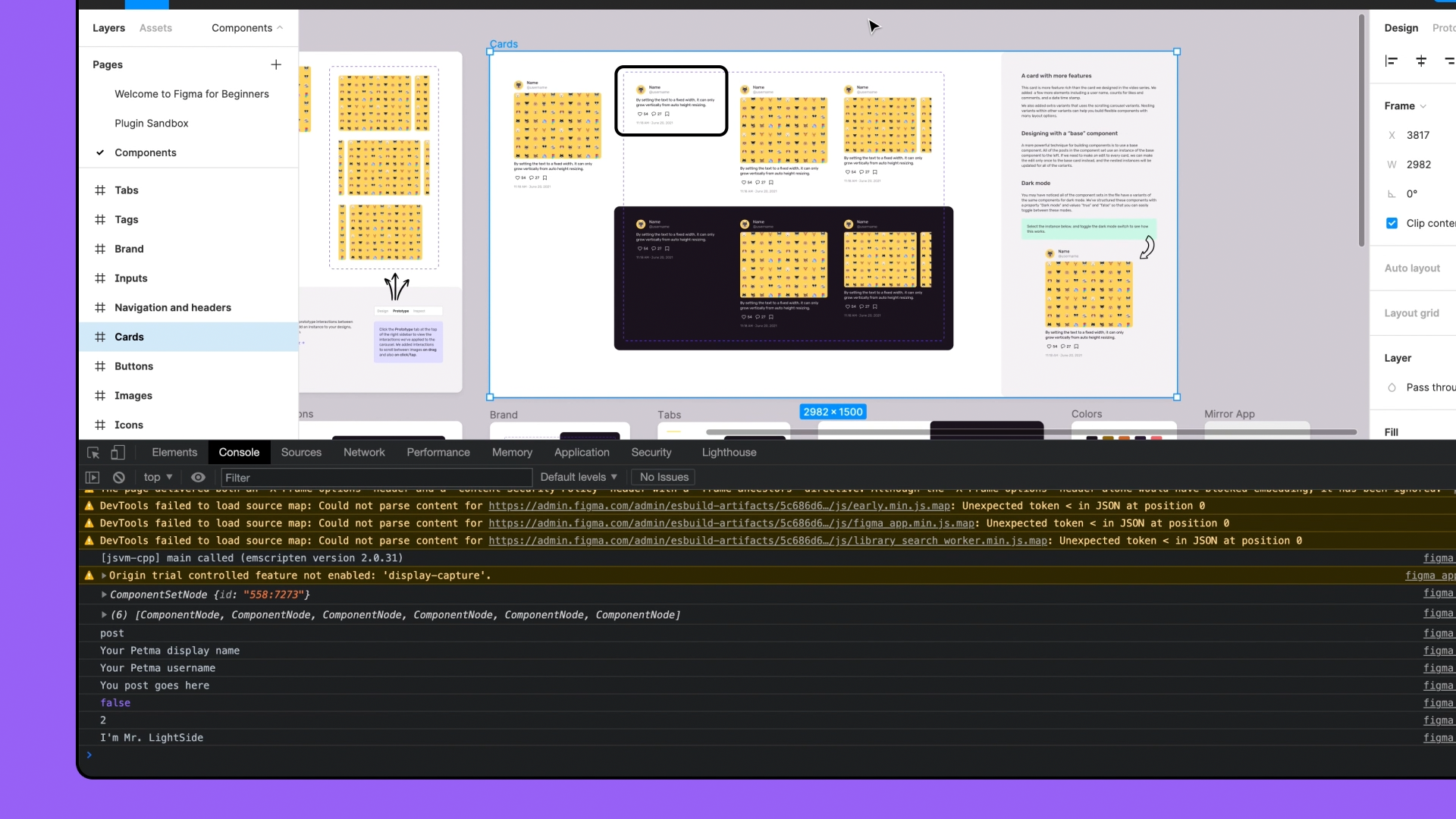

We still haven’t decided what happens when someone clicks the Submit button. For now, let’s add the line:
console.log("Building my first plugin!")Save your file and make sure that Visual Studio is watching for changes. If you’re no longer in ‘watch’ mode, just hit COMMANDShiftB again. Run the plugin, then open the console by hovering over Development in the Plugin menu, and selecting Open console. In the plugin form, click Submit. If we take a look at our console, we should see the message “Building my first plugin!”
Great job! Our event listener noticed the click on the submit button, then handled it by printing out a message to the console.
Now, how do we send the form information to the rest of the plugin code that will live in our Typescript file? First, we need to pull the values from each form input when the click event happens.
Let’s start by creating a constant called name within our event listener. A constant in JavaScript is a type of variable with a value that can’t be changed once it is assigned. In this constant, we’ll store the current value of the name input by assigning document.getElementById('name').value
Why don’t you try doing the same thing with the username and description?

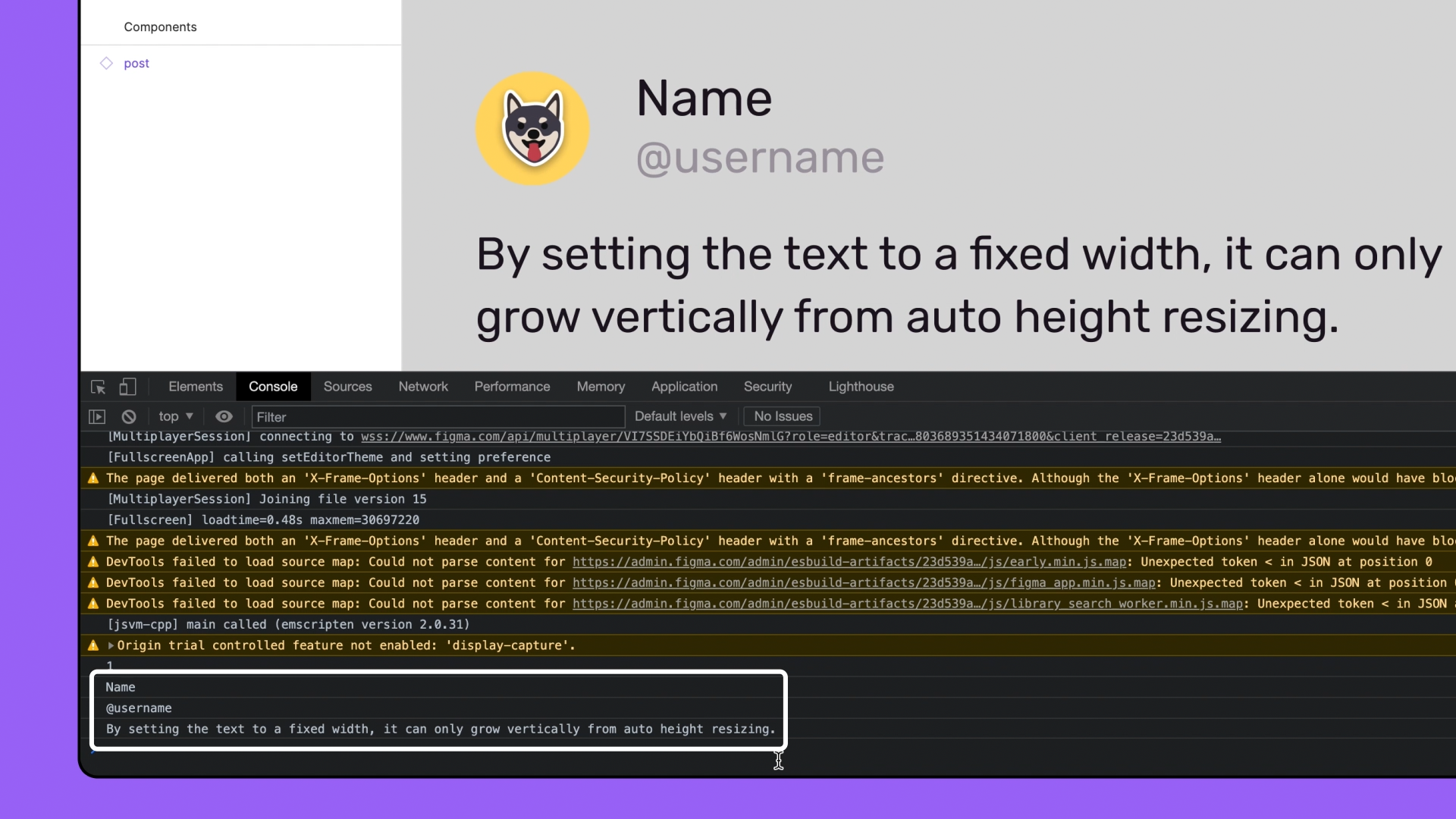

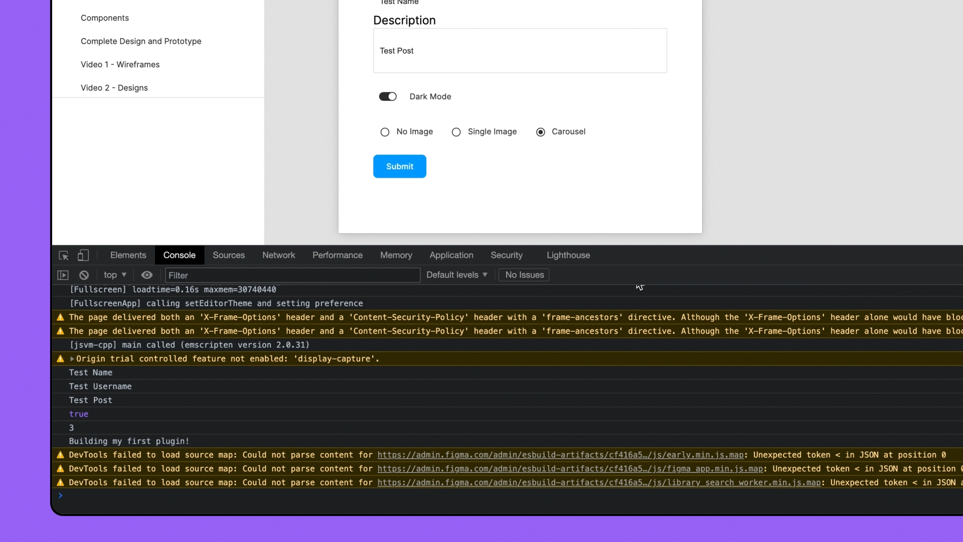

We can check these values by logging each variable to the console. Save your changes and run the plugin. Remember to open your console! Type in some random text for name, username and description then click Submit. Are you able to see the logs for the values you entered?
If not, try double-checking that your syntax is correct by comparing it to what we have below:
For the dark mode switch, since it is a checkbox input type, we need to determine whether or not it is in a checked state. Similar to our text inputs, we’re going to create a constant to store this information. Rather than storing the value of the dark mode element, we’ll use the ‘checked’ method that returns either ‘true’ or ‘false’ depending on whether or not the switch is toggled.
const darkModeState = document.getElementById('dark-mode-on').checked;If the variable stores ‘true’ then we know that dark mode is selected and vice versa.
Now, let’s add some value attributes to each one of our radio inputs. We’ll use string values 1, 2, and 3. For radio buttons, we need to use a querySelector to target the group of buttons by their shared name, rather than selecting a single element by its id. Then, we’ll find the checked radio button and grab its value. This will either be 1, 2, or 3 depending on the option that the user submits.
const imageVariant = document.querySelector('input[name="variantGroup"]:checked').value;We won’t be diving into query selectors in this series, so if you’d like to learn more, check out this additional resource.
Write a couple of console logs for the two new variables you’ve created, then run the plugin.
Like our last test, type in some text for name, username and description. Toggle the switch to turn Dark mode on, and select Carousel from the list of options. Submit the form and check the console. After the text inputs for name, username and description, you should see a log that prints ‘true’ and another that prints out ‘3’.
Awesome! We are successfully pulling all the values from our form inputs.

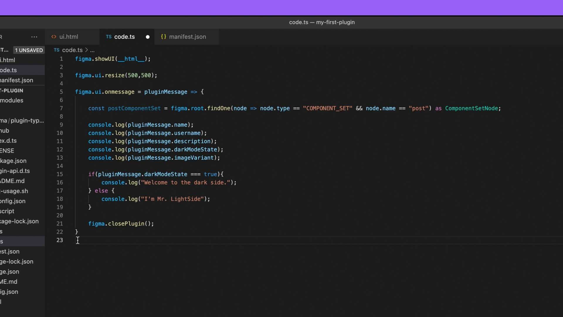

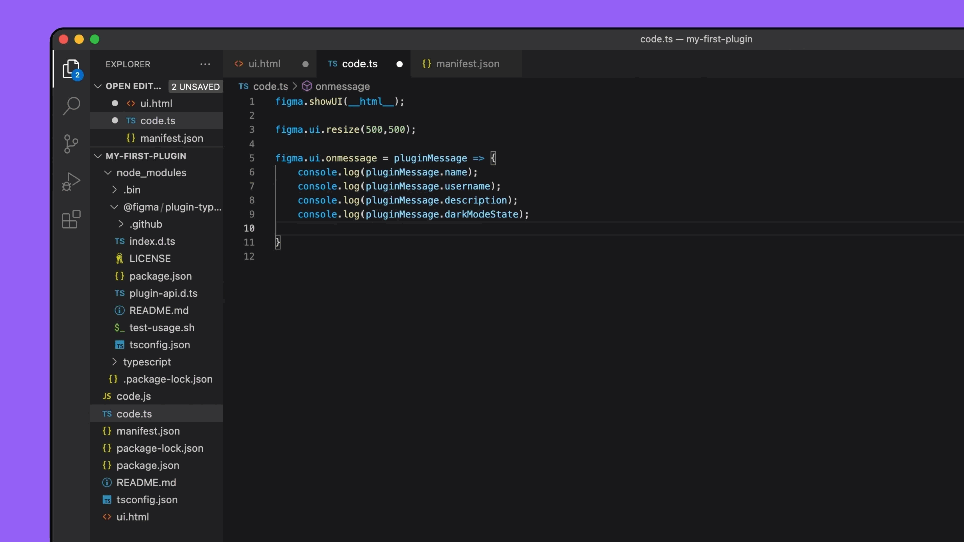

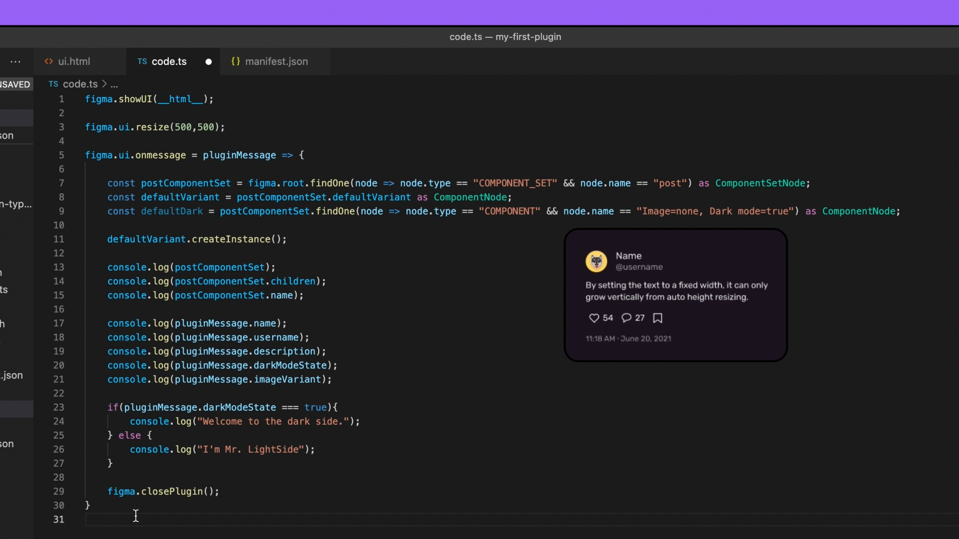

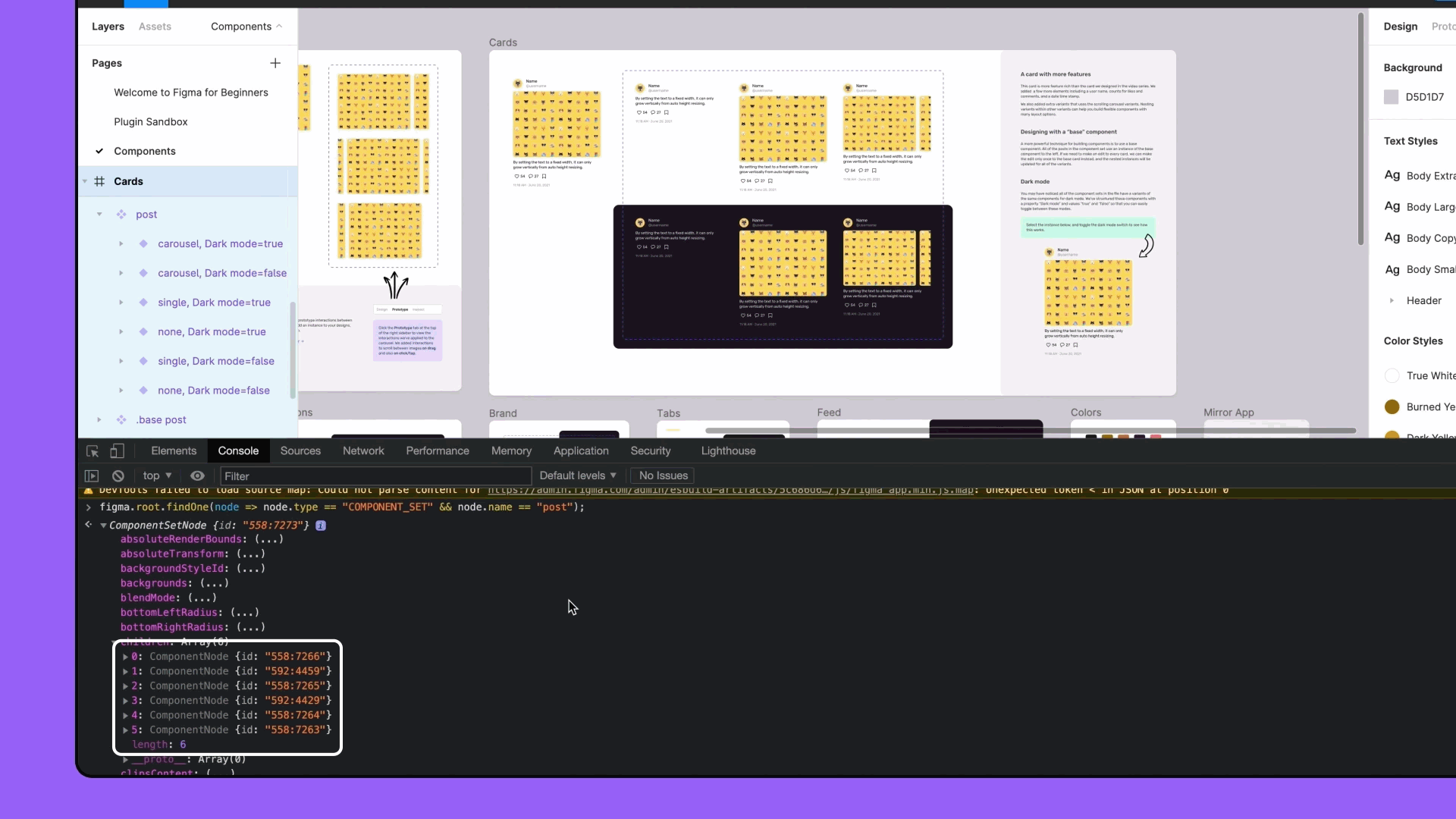

figma.ui.onmessage = pluginMessage => {}This receives the same object that we send over from the postMessage in our event listener. Since pluginMessage is an object, we need to use dot notation to access its different properties. For example, to access the name property, we would write pluginMessage.name or to check for the dark mode state we would write pluginMessage.darkModeState.

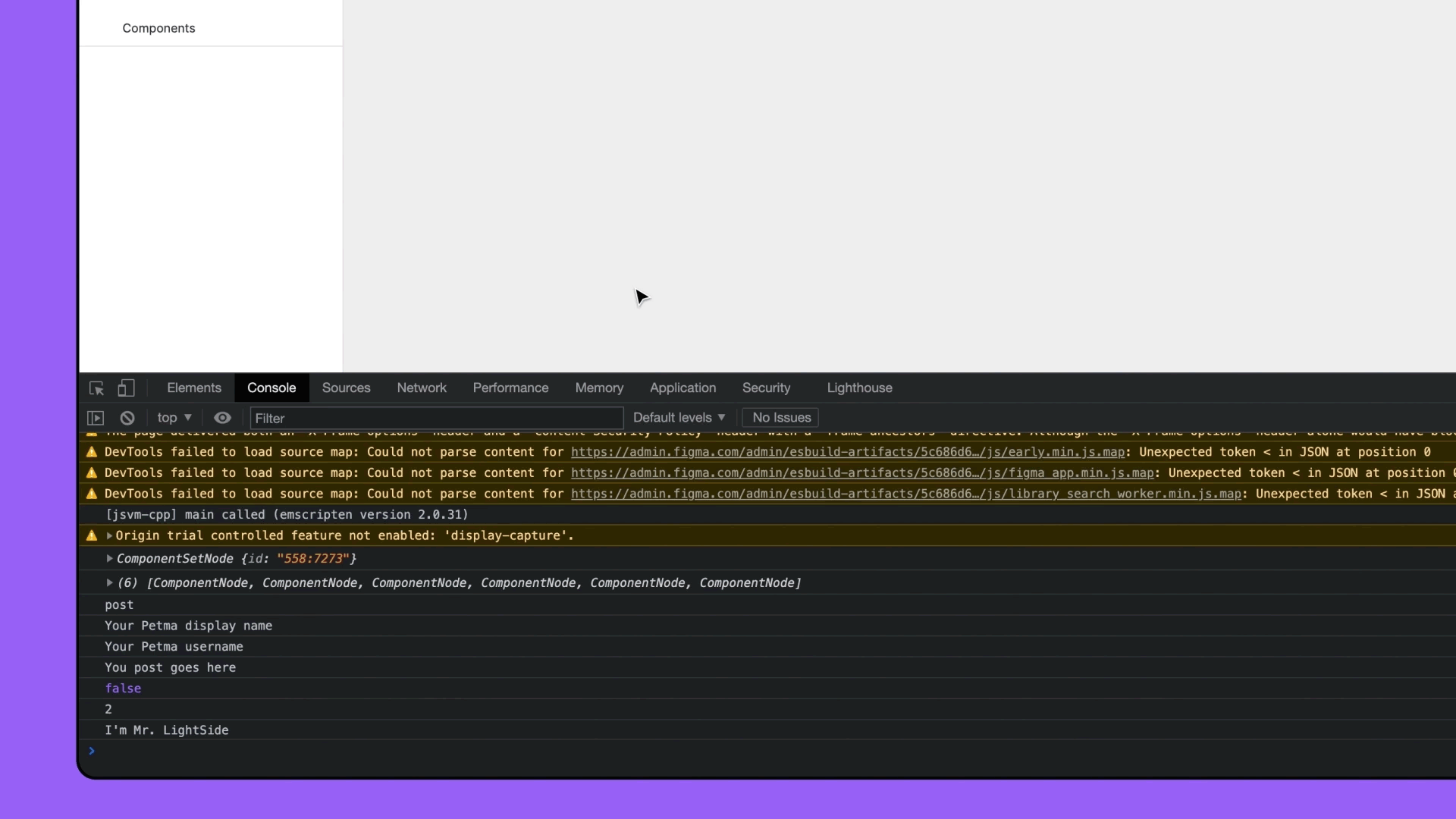

Let’s validate that the pluginMessage from ui.html is successfully received by our Typescript file.
In our on message method, console log all of the variables from the pluginMessage object. Once you’ve done this, go ahead and delete the console logs from your event listener.
Save your changes and re-run the plugin. When you check your console, you should see logs for all of your form variables. These console logs are now coming from your Typescript file! You’ve successfully sent information from the plugin form back into your program logic. Amazing job!
An important thing to keep in mind as you build plugins: we should always close our plugin once it’s done running. To do this, we’ll add the line figma.closePlugin() at the end of our on message method.
This method ensures that the plugin UI is closed once we are done using it and that access to the currentPage is disabled. This way, we can avoid getting any unexpected behavior from our plugin.

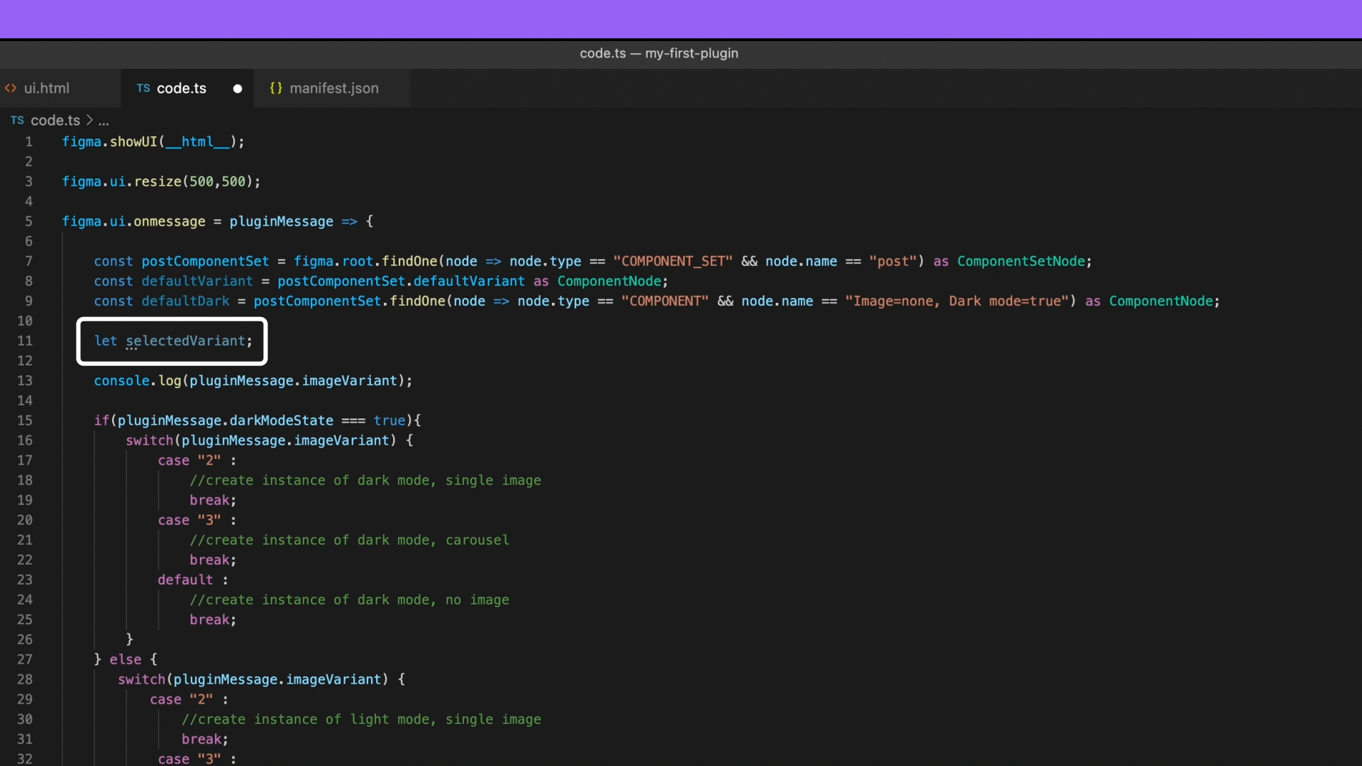

Conditional logic
Now that we are returning information from the form, we can use these variables in our plugin logic. For example, if the user selects Dark mode, let’s print out a message that says “Welcome to the dark side.” Otherwise, we’ll print out a message saying “I’m Mr.LightSide”
if(pluginMessage.darkModeState === true) {
	console.log("Welcome to the dark side.");
} else {
	console.log("I'm Mr.LightSide");
This block of code is called a conditional. A conditional is a statement that tells our program what action to take depending on whether a condition is true or false. In this case, we are telling our program that IF the darkModeState from the form is set to ‘true’, print out “Welcome to the dark side.” Otherwise, print out the other message.
The else statement in a conditional acts as a default path in case the ‘if’ condition isn’t met. This concept is something that we’ll return to as we develop our plugin.

Let’s continue exploring nodes. Go back to the Figma for Beginners file and open up the Components page. This group of Post components can be referred to as a component set.
You guessed it, there is a matching COMPONENT_SET node type that we can use to reference component sets on the canvas.

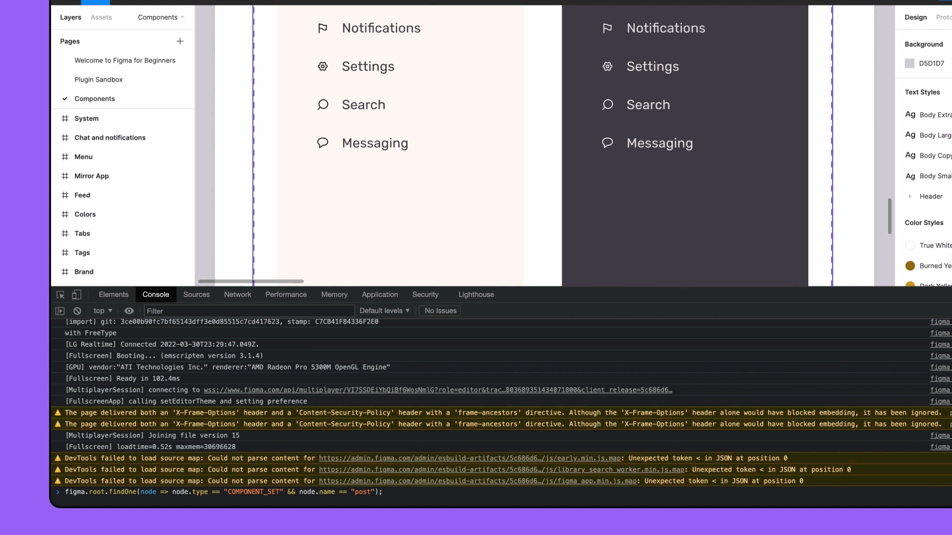

To get information from this particular component set, there is a findOne method that will return a single matching node from the canvas. For example, we can write:
figma.root.findOne(node => node.type == "COMPONENT_SET" && [node.name](<http://node.name/>) == "post")figma.root tells the method where to look for the node. Root here refers to the entire Figma document. We want to use this method as opposed to figma.currentPage because we want to be able to find this node no matter what page we’re currently on in the document.
Here we are telling the findOne method to locate a node whose node type is component set and has the name “post”. Let’s take this line of code and test it out in the console to see what it returns.
You should see a similar ComponentSetNode returned with an id. Click on the arrow to the left to expand the object. What do you notice? These are all the properties of our selected ComponentSet. Let’s take a look at the name property to make sure that we have the right node.
There it is! This component set is named “post” so we know that our findOne method found the correct node successfully.
Go ahead and explore some of the other properties. What do you see when you expand the children property? It looks like this component set has six child components. Where do you think those are coming from? Exactly! Those six components are the six variants of our Post component.
Let’s move this line of code over to our Typescript file and store the component set in a variable named ‘postComponentSet’.
We’ll add ‘as ComponentSetNode’ to the end of this line to make sure that when our TypeScript is compiled, the variable will still be seen as a Component Set, just in case JavaScript interprets it as a different node type.
Test the new variable by logging ‘postComponentSet’. While we’re here, we may as well log some of the component set’s properties like ‘postComponentSet.children’ and ‘postComponentSet.name’. We’ll re-run the plugin and open up the console. You should see that we’re getting the same object as we were earlier! We can verify this with the type Component Set and the object name, which is “post.”

Using the findOne method
Although we are successfully able to find and create an instance of the defaultVariant, we can’t forget about the others! The great news is we can use the same findOne method to select the other variants from the component set!
Create a new variable called ‘defaultDark’ and using findOne, we’ll store the variant with the name “Image none, Dark mode true”, which should be this component here.
Note that the name we put in our findOne method needs to exactly match the name of the component on the canvas.
const defaultDark = postComponentSet.findOne(node => node.type == "COMPONENT" && node.name == "Image=none, Dark mode=true") as ComponentNode;
Remember the conditional we wrote earlier that checks whether or not the user selected dark mode? Let’s put it to use! Delete the console logs within the if-else blocks and instead, if dark mode is selected, create an instance of the dark mode component by writing defaultDark.createInstance(). Otherwise, if dark mode isn’t selected, write defaultVariant.createInstance().
    if (pluginMessage.imageVariant === true) {
    } else {
We’ll run the plugin a couple of times to see if our conditional logic is working. Let’s add some text to our inputs, and for this round we won’t select Dark mode. Right now, we can choose any of the image options since we haven’t written code to handle that yet. Once you submit the form, it should still create the defaultVariant from earlier. Then, we’ll fill out the form again, this time with Dark mode selected and hit submit. If we wrote our conditional correctly, the plugin should have created a dark mode variant with no image. Awesome job!

Back to our implementation. We have an additional layer of decision making to consider.
First, we ask the question do we want dark mode? Yes or no? If yes, then which dark mode variant do we want - 1, 2 or 3? If no, then which light mode variant do we want - 1, 2, or 3?
There are a couple of ways we can represent this in our plugin logic. One way is by creating nested if-else statements. For example, if dark mode is true, we can nest if else statements that will then check for the imageVariant.

To do this, we’ll create a variable outside of our conditional logic called ‘selectedVariant.’
Notice that instead of a constant variable, we are creating a let variable here. Unlike a constant that can’t be changed, a let variable allows us to reassign the value depending on which variant we create an instance of. For example, if the user doesn’t select dark mode and selects the no image option, we would want to create an instance of the default variant. In the case, we’ll assign ‘selectedVariant’ the defaultVariant from the postComponentSet.
else...
switch(pluginMessage.imageVariant)
default:
  selectedVariant = postComponentSet.defaultVariant;
	break;

Write a few logs to view the characters in the text variables we just created.
console.log(templateName.characters);
console.log(templateUsername.characters);
console.log(templateDescription.characters);
Once you’ve written out these logs, run the plugin and take a look at the console.
If you are seeing the default text printed out, it means you were able to find the correct TextNodes. Great job!

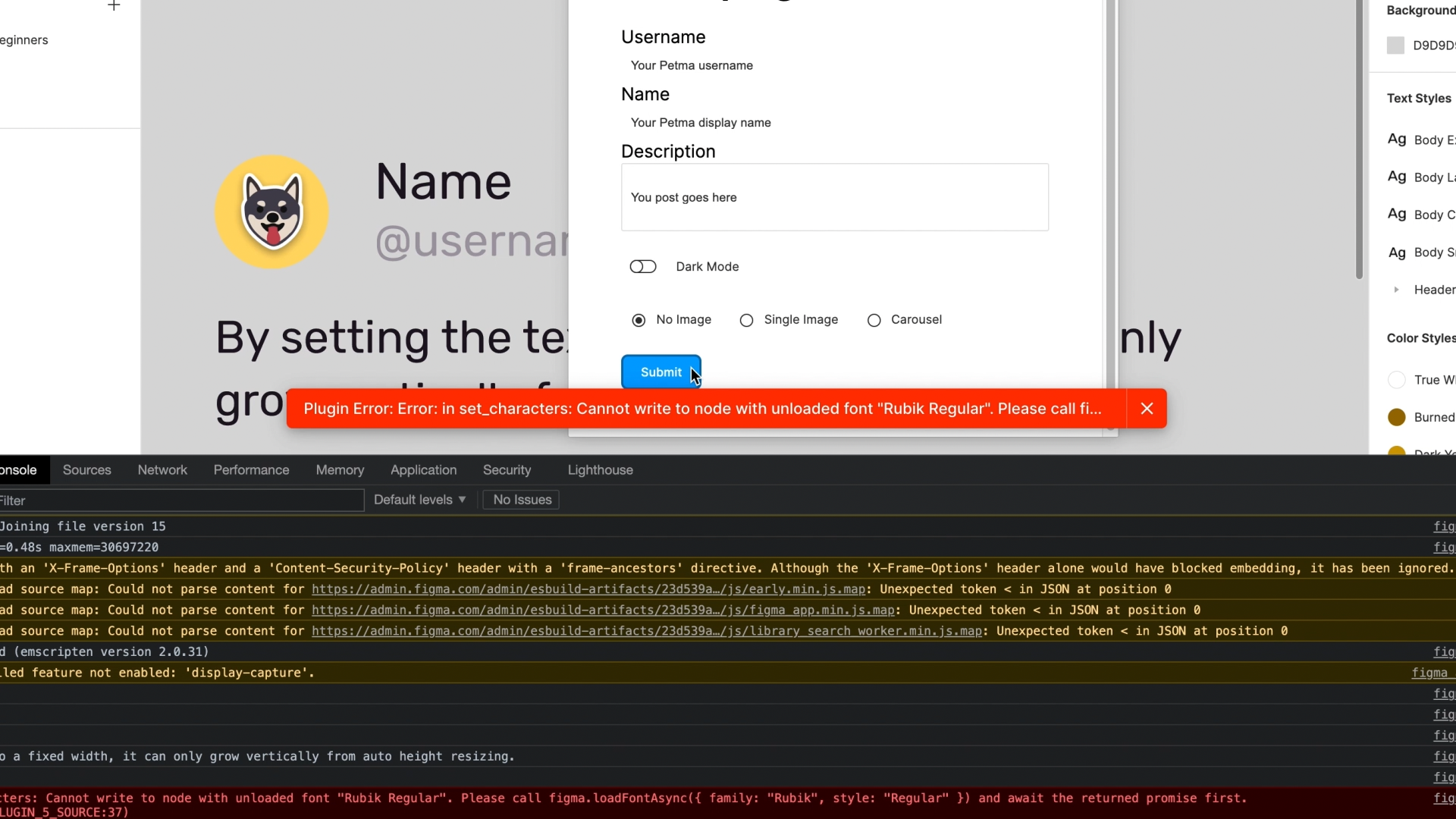

Loading fonts
With the characters reassigned, ideally we should be overwriting the text nodes. However, when we run the plugin, you’ll likely encounter a Plugin Error that looks like this:
This is telling us that we can’t overwrite the TextNode due to an unloaded font. Don’t worry! We can fix it. It’s important to know that anytime we are changing the contents of a TextNode, we first need to load the font that the text node is using.
It looks like the font used in our Post component is Rubik, Regular. We’ll load this font in at the top of our onMessage method by using the Figma loadFontAsync function.
await figma.loadFontAsync({ family: "Rubik", style: "Regular" });
Notice the ‘await’ keyword at the beginning of this line. That’s because this function is asynchronous and returns something called a ‘Promise’. Since the loadFont function only works to load fonts already accessible in the Figma editor, the ‘Promise’ will either resolve, meaning the font was found and loaded successfully, or reject and give us an error.
We won’t be diving into asynchronous methods or Promises in this course, so check out the link in the description below if you want to learn more!
Once we’ve done that, we’ll have to do a small refactor of our code and test it again.
figma.ui.onmessage = async(pluginMessage) => {
All we’ve done is add the async keyword and put the pluginMessage parameter in parentheses.
Once you’re done adding these changes, run the plugin again. If it’s successful, you should see the text in the new component being overwritten with your form inputs. Wonderful! Take a moment to give yourself a huuuuuge pat on the back because you’ve just built your very first Figma plugin!
