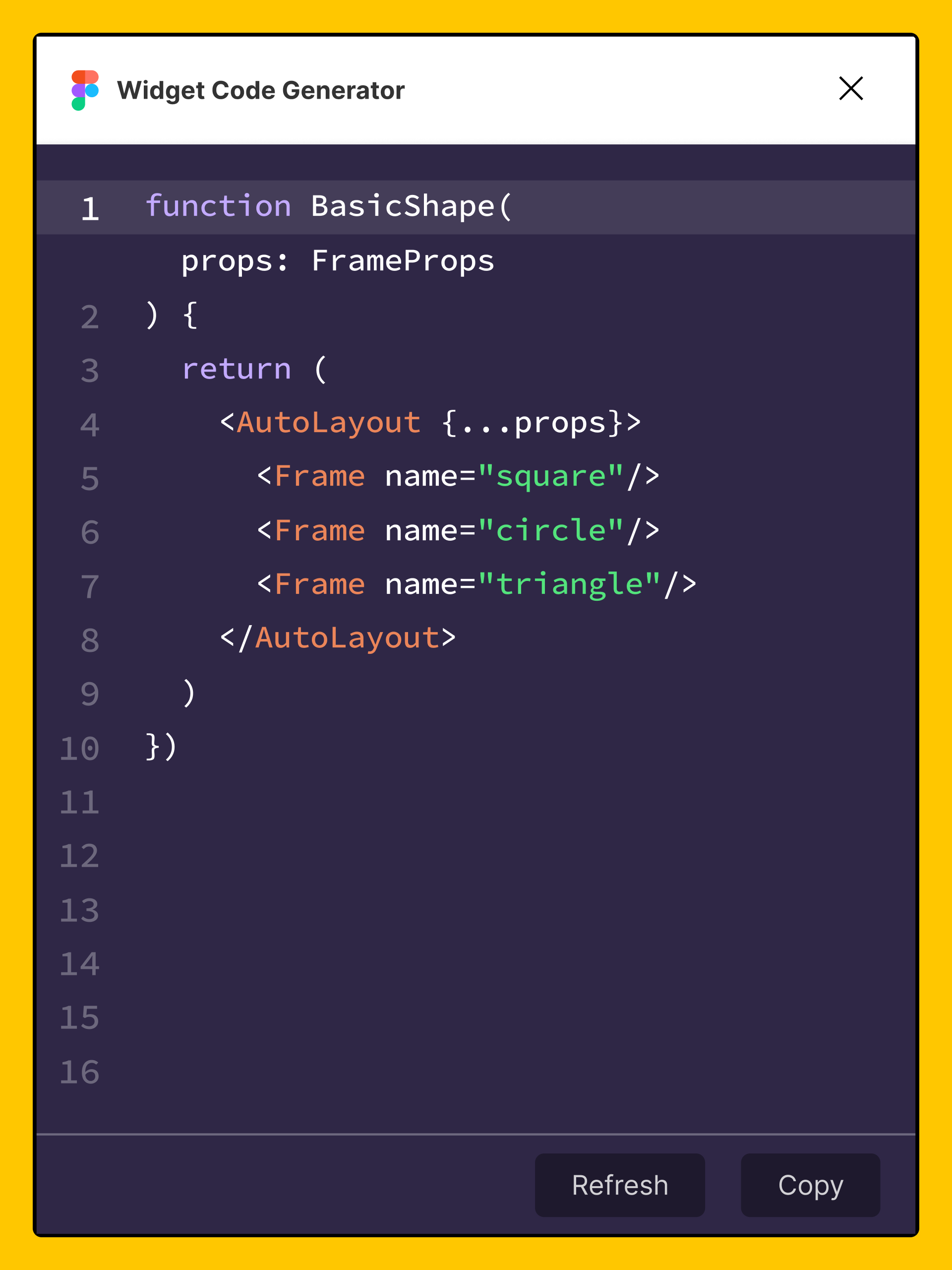

After selecting the plugin, the Widget Code Generator modal will pop up.

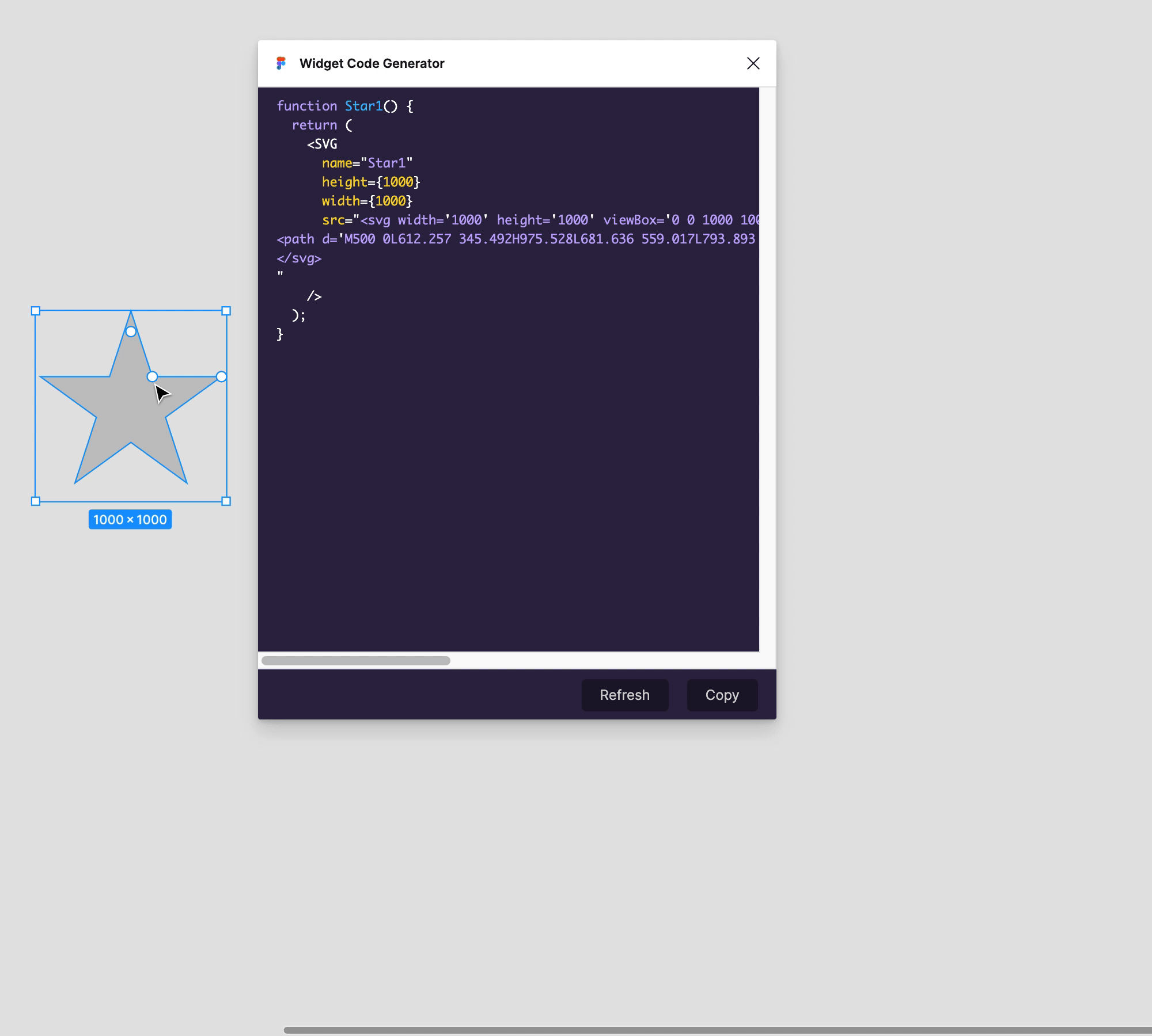

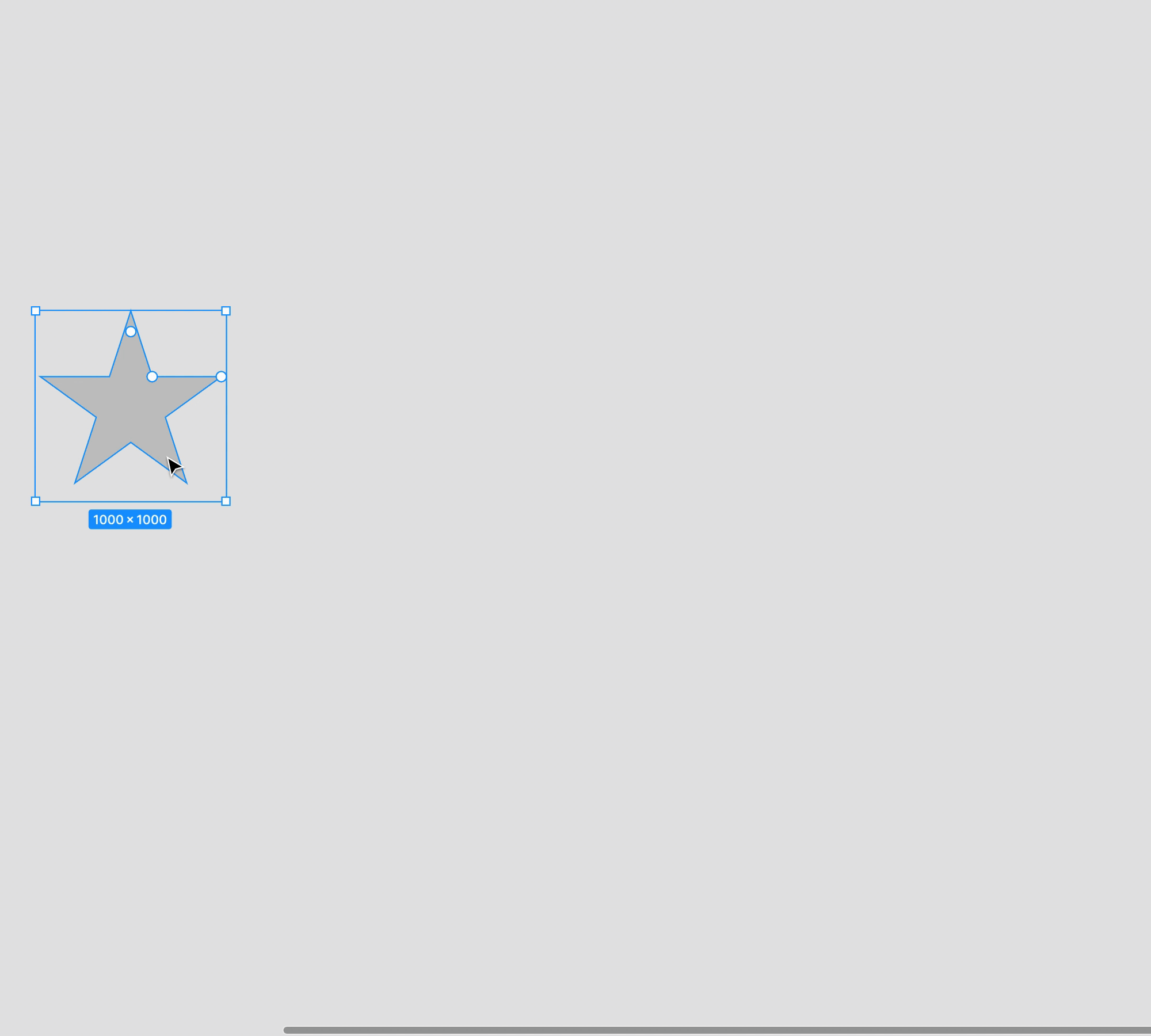

Generate code
The Widget Code Generator can only generate code one layer at a time, including all of the children in the layer tree. Select an individual layer while the plugin is running to see the generated code in the modal.
If changes are being made to a layer, the generated code won’t automatically update. After making changes to a layer, hit the ‘Refresh’ button to get the most updated code for your component.

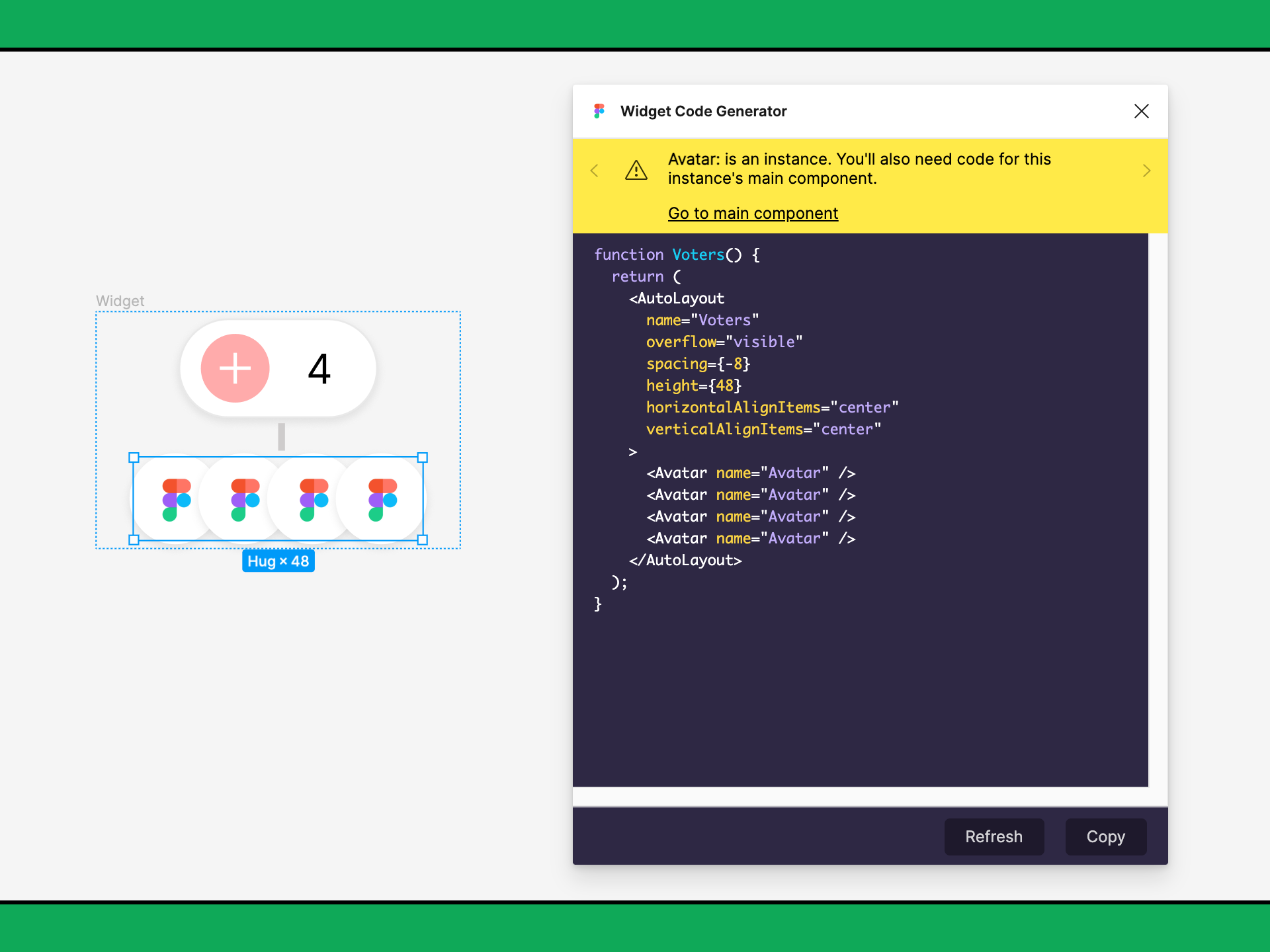

Instance nodes
When you generate code for a design containing an Instance node, the code for all layers of that instance will not be included. Instead, a tag representing the instance will be shown. This reduces duplication when you use several instances of the same component, and makes your generated code more readable. If your design includes several instances of a component named MyComponent
, the generated code will look like this:
export function MyDesign() {
return <Frame>
<MyComponent/>
<MyComponent/>
<MyComponent/>
</Frame>
If you copy-paste this into your editor and try to run it, it will not compile because MyComponent
will be undefined.
To fix this, select MyComponent
in Figma and generate code for that instance. To go to the main component, right-click on the individual layer then select Go to main component. You can also click on the Go to main component link that appears in the warning message at the top of the modal.Â
