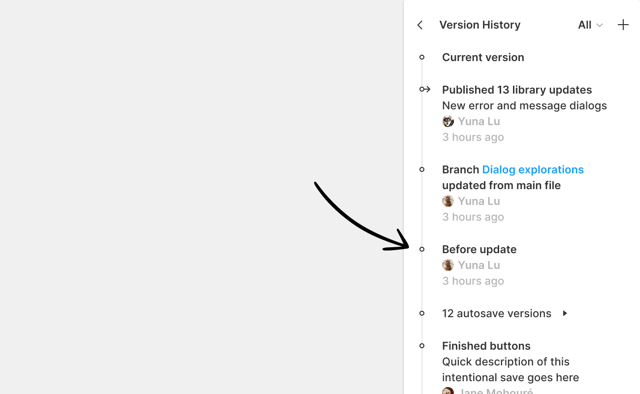

Restore an earlier version of the main file
Caution: Restoring a previous version applies to everyone with access to the main file. This won’t preserve any other changes made to the main file, including other branch merges.
Note: Reversing or undoing a merge won’t restore an archived branch. You’ll need to restore the branch before trying to merge the branch again.
- From the main file, click next to the file name in the left sidebar.
- Select Show version history to open version history in the right sidebar.
- You can identify a merged branch with the Branch merge icon.
- Select a version before the merged branch. This could be the “Before merge” checkpoint or any other checkpoint.
- Click next to the version and select Restore this version.
- Click Done in the toolbar to exit version history.
