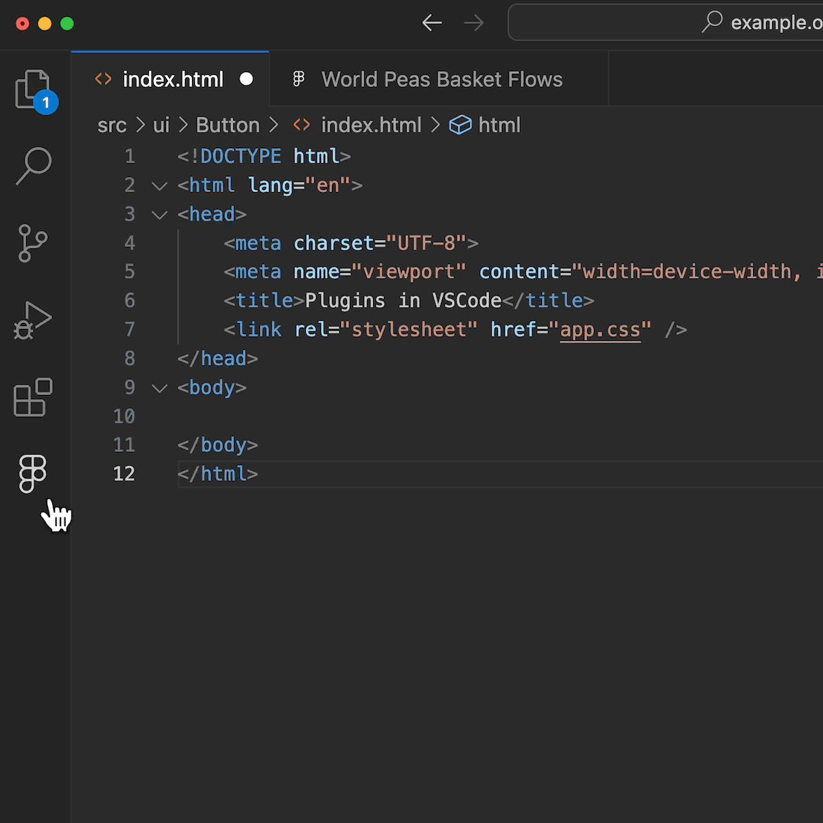

From VS Code
- Open VS Code.
- Click Figma in the activity bar, or find Figma for VS Code from your list of extensions.
- In the primary sidebar under Files, click on the design you want to open.

Auto-complete code suggestions
The Figma for VS Code extension provides auto-complete suggestions based on the selected layer. This is helpful if you’re building components that don’t have an existing implementation in your codebase.
