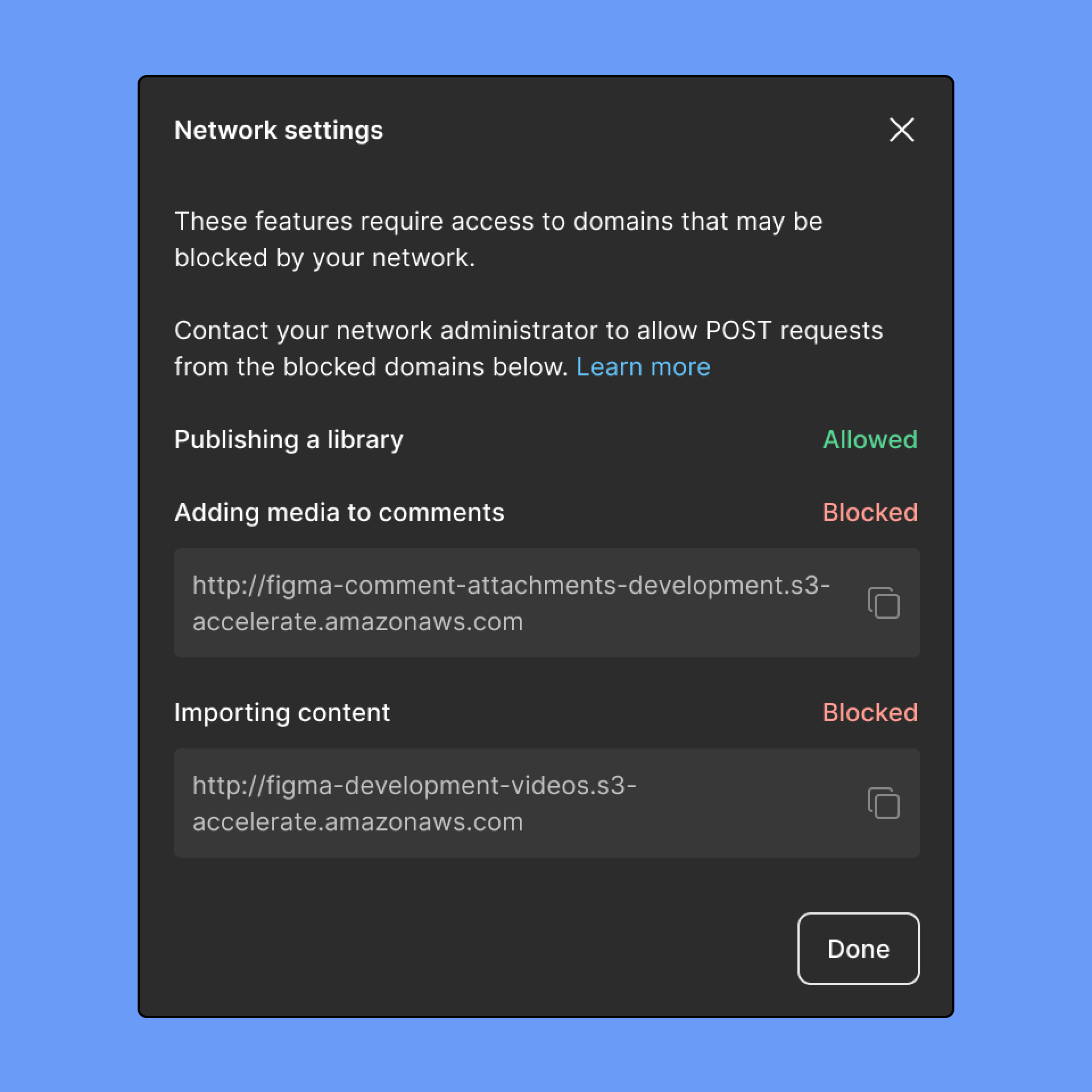

Check your network settings
You can open the Network settings modal in two ways to check your settings and see any blocked actions or issues:

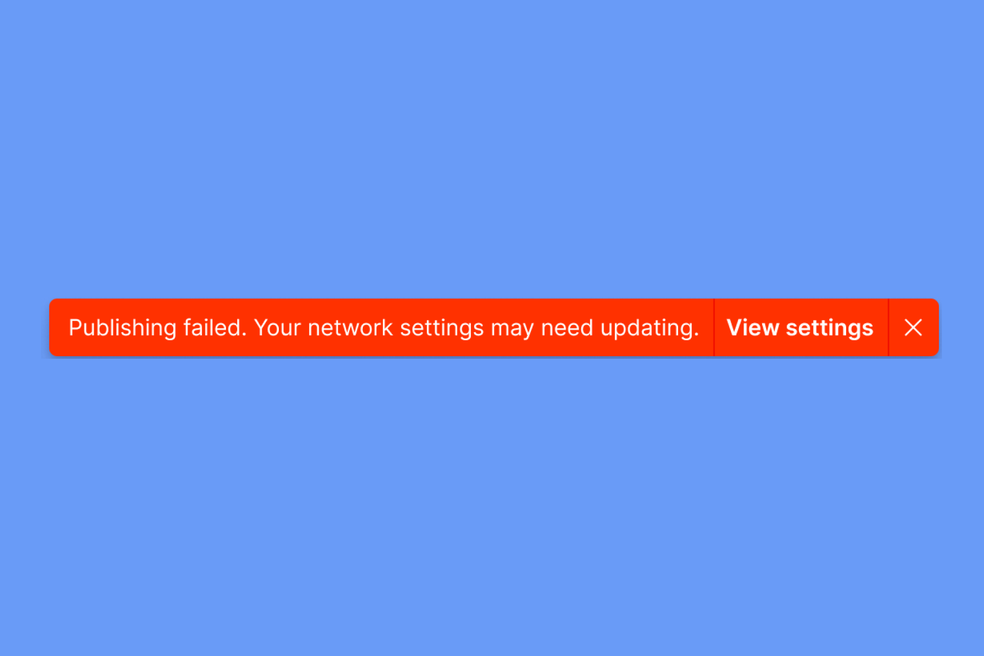

From an error message
If you see an error while performing an action in Figma, select View settings in the message to open the Network settings modal and see which actions are blocked.

Once you’re in a Design or FigJam file:
- Use the keyboard shortcut to access the quick action bar:
- Mac: ⌘ Command or ⌘ Command P
- Windows: Control / or Control P
- Type "Check network settings" in the quick action bar.
- Press Return or Enter to perform the quick action.
If network issues are found, the Network settings modal will display them.
