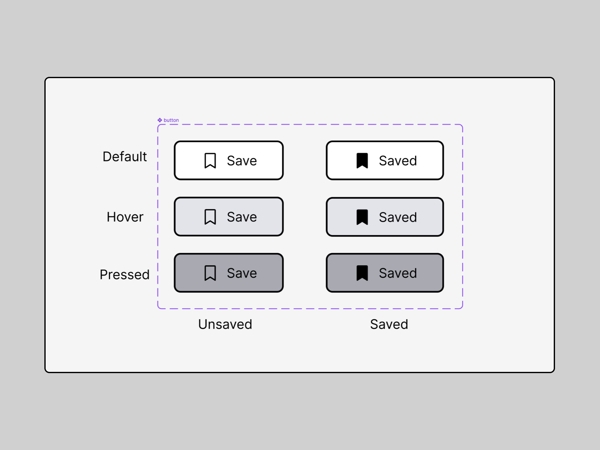

Before moving on, check to make sure your component set looks like this:
Configure saved variants
Our component set is looking great. Now we need to add the saved variants and create their different states.
- Click the purple plus to another variant.
- With the new variant selected, double-click on the text layer and type
Saved
. - Select the filled BookmarkSimple icon you added to the canvas earlier and copy it.
- Select the unfilled icon version in the variant you just created, right-click and select Paste to replace.
- Select the top variant. Leave the state property as-is and add a new status property value called
saved
. - With the new saved variant still selected, click the purple plus to add two more variants.
- Select the middle variant and change the state property value to
hover
and the fill to#E3E4EB
. - Select the bottom variant and change the state property value to
pressed
and the fill color to#A8A9B2
When you’re done, your component set should look similar to the following:

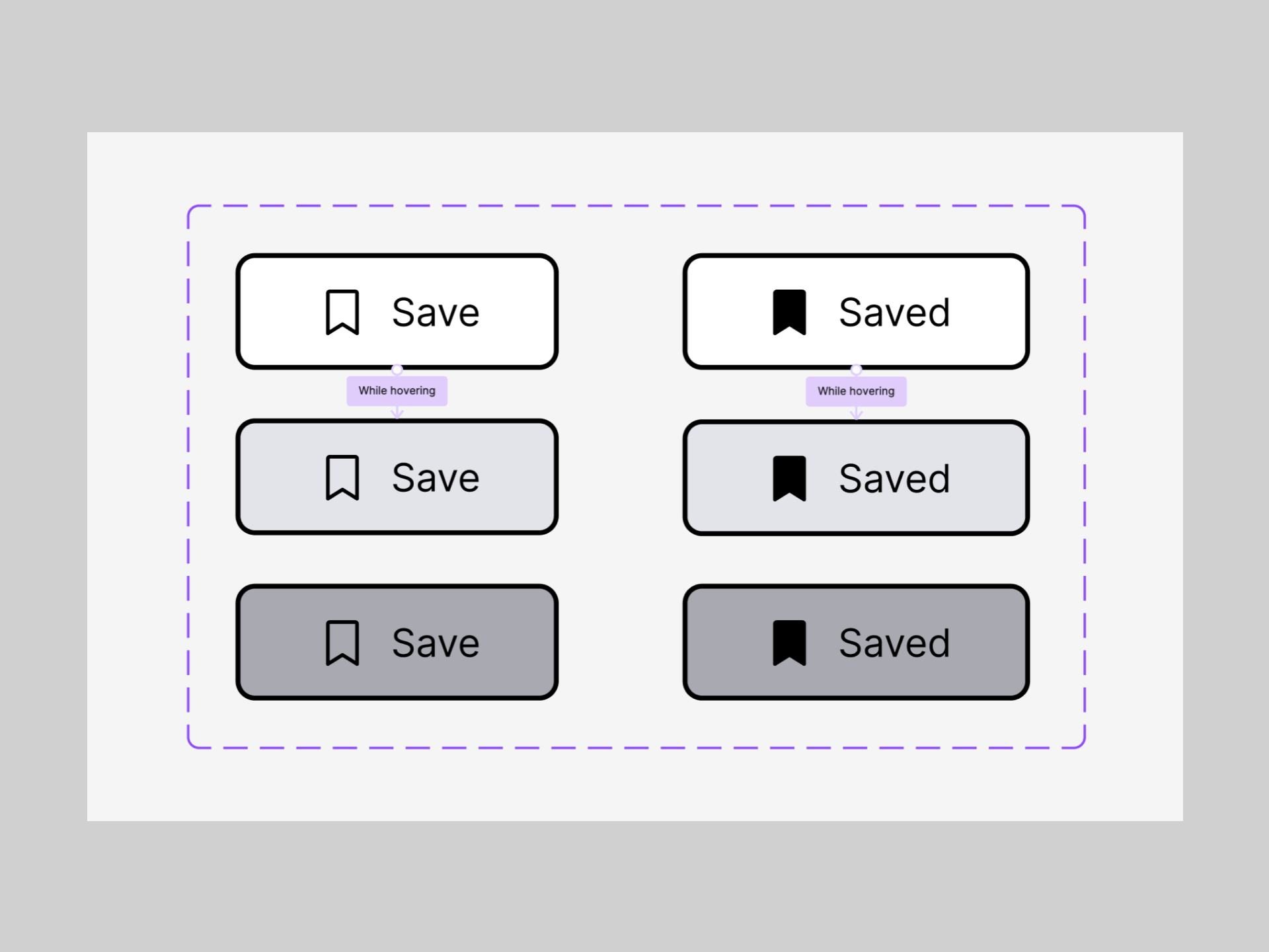

- Select the default, unsaved variant and click and drag the blue plus to the hover, unsaved variant.
- Apply the following interaction settings:
- Change the trigger to While hovering
- Set the action to Change to
- Set the animation to Smart animate
- Change the transition to Ease in and out
- Enter
150ms
in the Duration field.
- Apply an identical prototype connection between the default, saved and hover, saved variants.

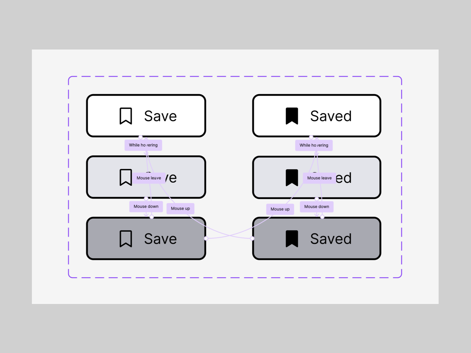

Add the mouse down trigger
- Select the hover, unsaved variant and click and drag the blue plus to the pressed, unsaved variant.
- Leave the rest of the connection settings as they are but change the trigger to Mouse down.
- Apply an identical prototype connection between the hover, saved and pressed, saved variants.
Your connections should like this:
Add the mouse leave trigger
- Select the pressed, unsaved variant and click and drag the blue plus to the default, unsaved variant.
- Leave the rest of the connection settings as they are but change the trigger to Mouse leave.
- Apply an identical prototype connection between the pressed, saved and default, saved variants.
Add the mouse up trigger
We need to add two final connections so that the unsaved button can become the saved button when pressed, and vice versa.
- Select the unsaved, pressed variant click and drag the blue plus to the default, saved variant.
- Leave the rest of the connection settings as they are but change the trigger to Mouse up.
- Apply an identical prototype connection between the pressed, saved and default, unsaved variants.
You final connections should look like this:
