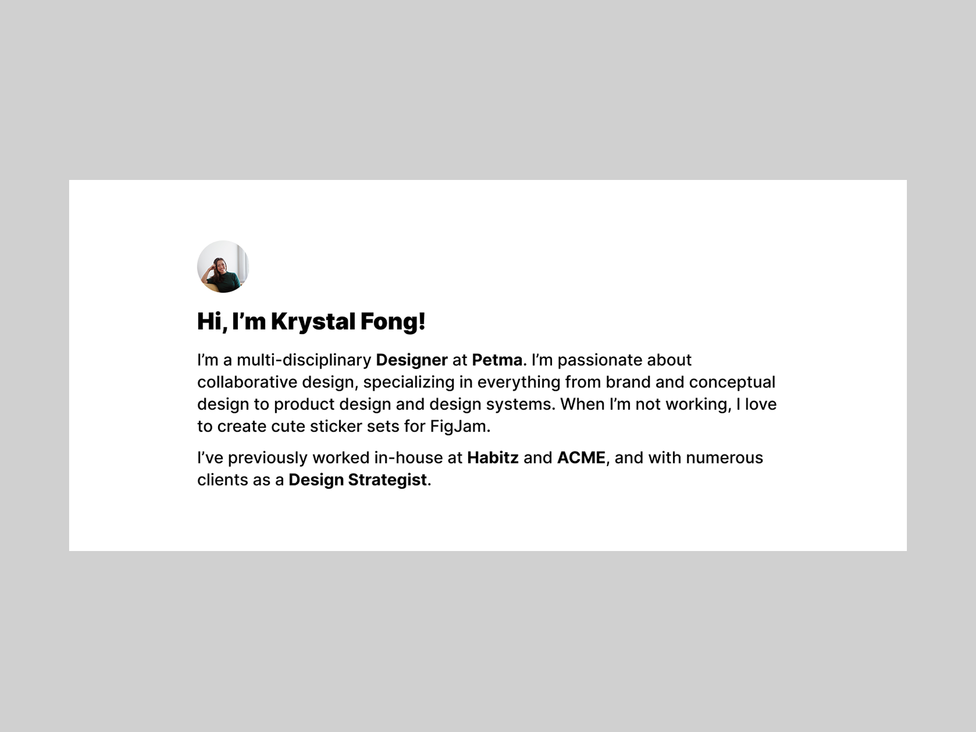

In this lesson, we’ll learn about a few fundamental layer types in Figma Design and use them to build the hero for the landing page of our portfolio website. A hero is a large section at the top of a webpage, typically used to draw attention, convey a message, or prompt an action.
We’ll start by building an avatar using a shape with an image fill, then use text layers to add our name and a brief description to welcome visitors to our portfolio. You’ll need a photo for the avatar, so make sure you have one ready to go on your computer before moving on.

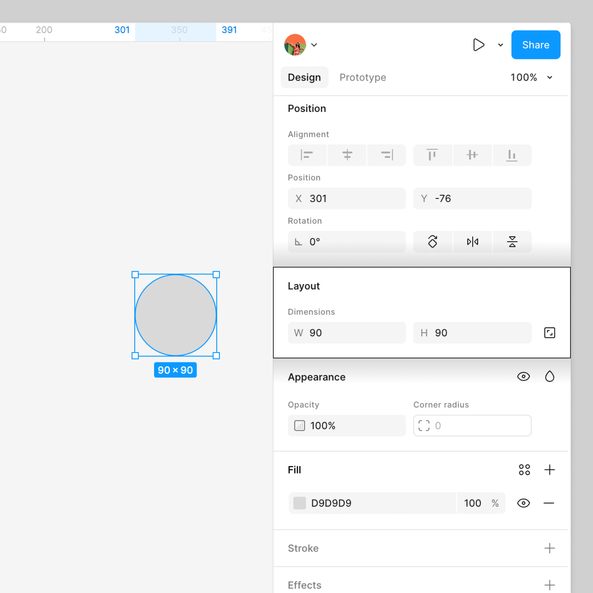

- Select the Ellipse tool from the toolbar or press O on your keyboard.
- Click anywhere on the canvas to place an ellipse. Notice how the right sidebar changed and now has some properties for us to edit.
- In the Layout section, you can see that the ellipse's dimensions are set to
100
X100
. Let's resize it by typing90
in the Width and Height fields and pressing Enter to apply the change.

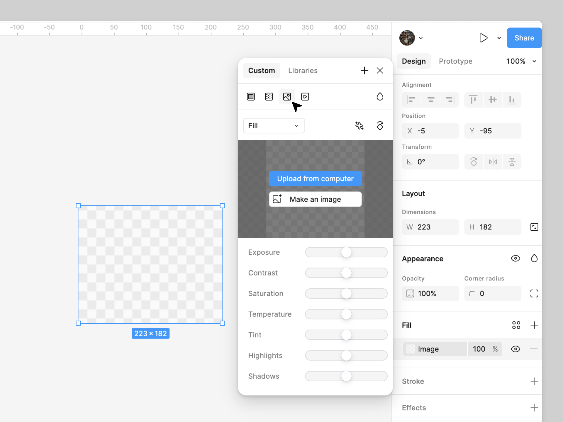

Since we want to include a profile picture for our avatar, we'll change the ellipses fill to an image.
- Select the ellipse.
- In the Fill section, click on the swatch to open the color picker.
- Select Image.
- Click Upload from computer.
- Choose an image from your computer.
- Click Open.
The image will replace ellipse's default grey fill. You can then use the image settings to adjust attributes like exposure, contrast, and temperature.
