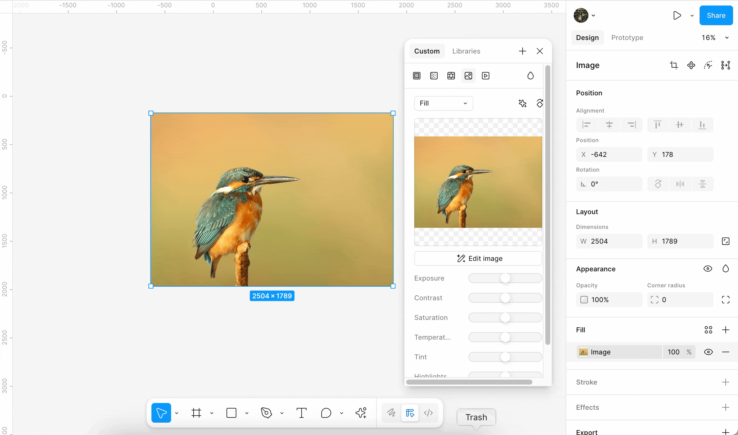

Fill mode
The Fill mode determines how Figma will apply the image fill. This takes into account the dimensions of the image and the layer you’re adding it to. Figma retains your Fill mode setting when you scale or manipulate the layer.
There are four Fill modes:
- Fill: Positions and scales the image so that it takes up the entire layer it’s applied to. If the image and layer are different shapes, Figma may clip the image to ensure the shape is completely filled.
- Fit: Ensures the entire image is visible within the layer. This ensures that no part of the image is hidden, even if you resize the layer. Depending on the shape of the layer, the image may not completely fill the object.

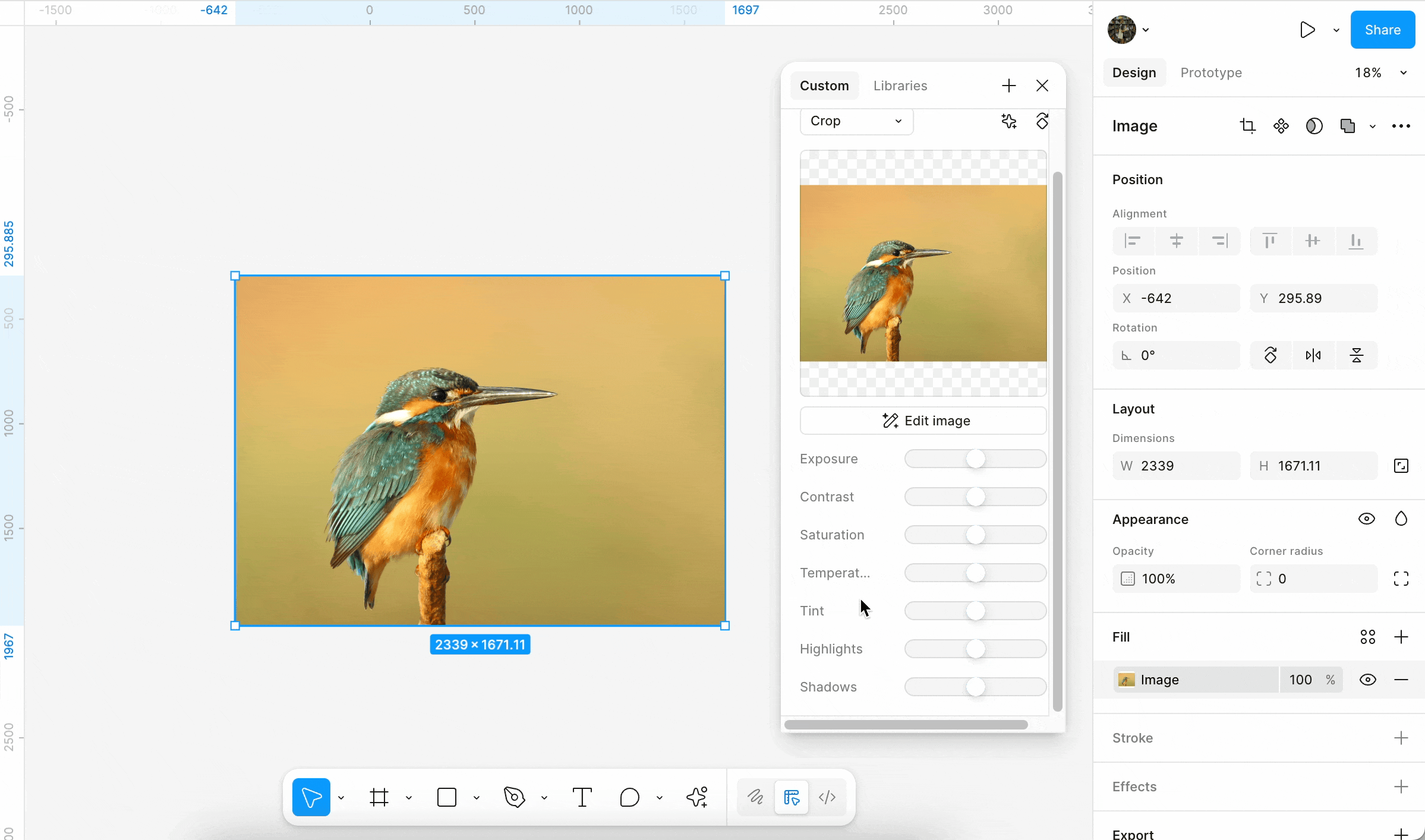

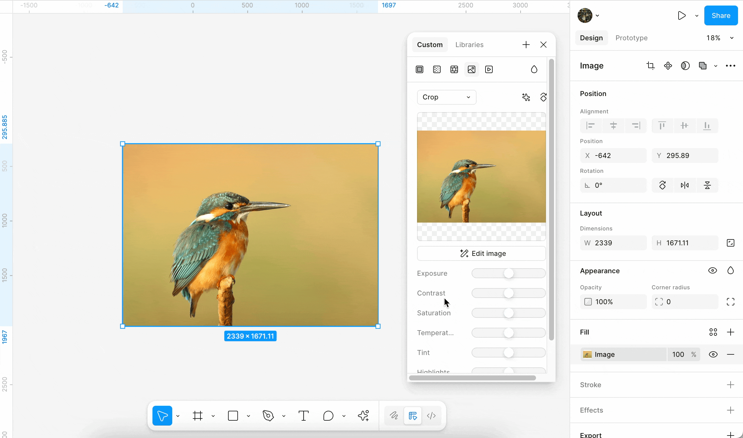

- Crop: Allows you to adjust the boundary lines of your image. This lets you control which part of the image you can see. Cropping is a non-destructive action that works similarly to using a mask. Learn more about cropping images.

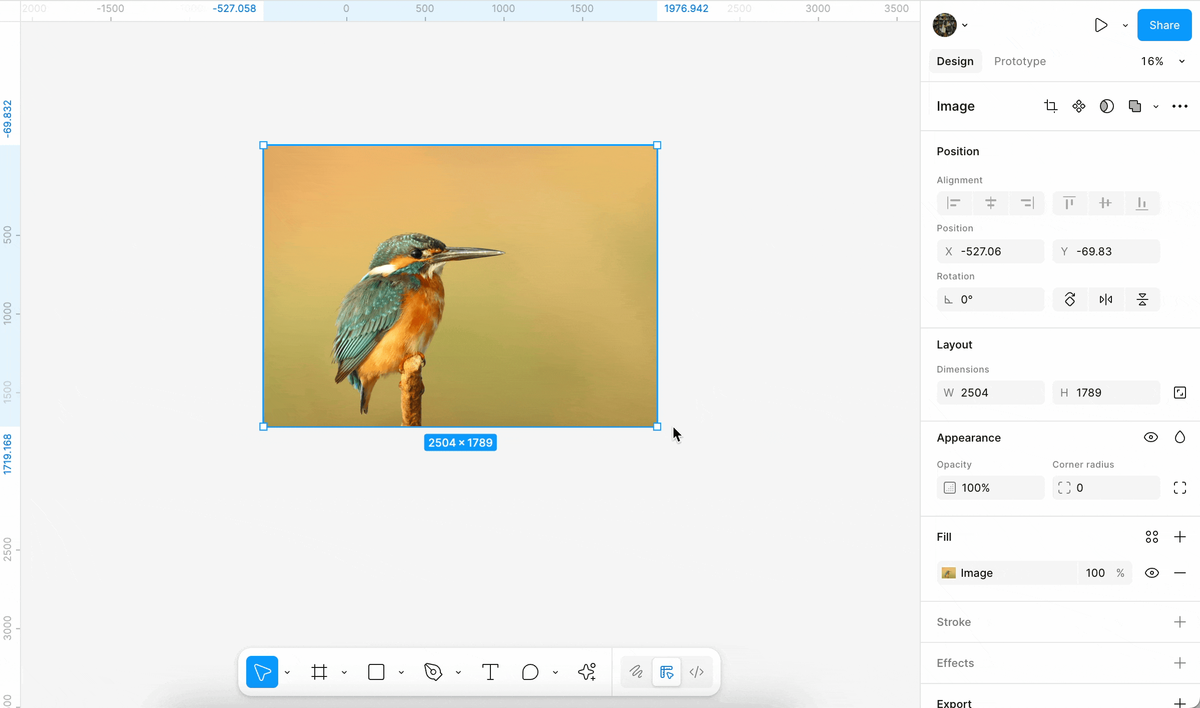

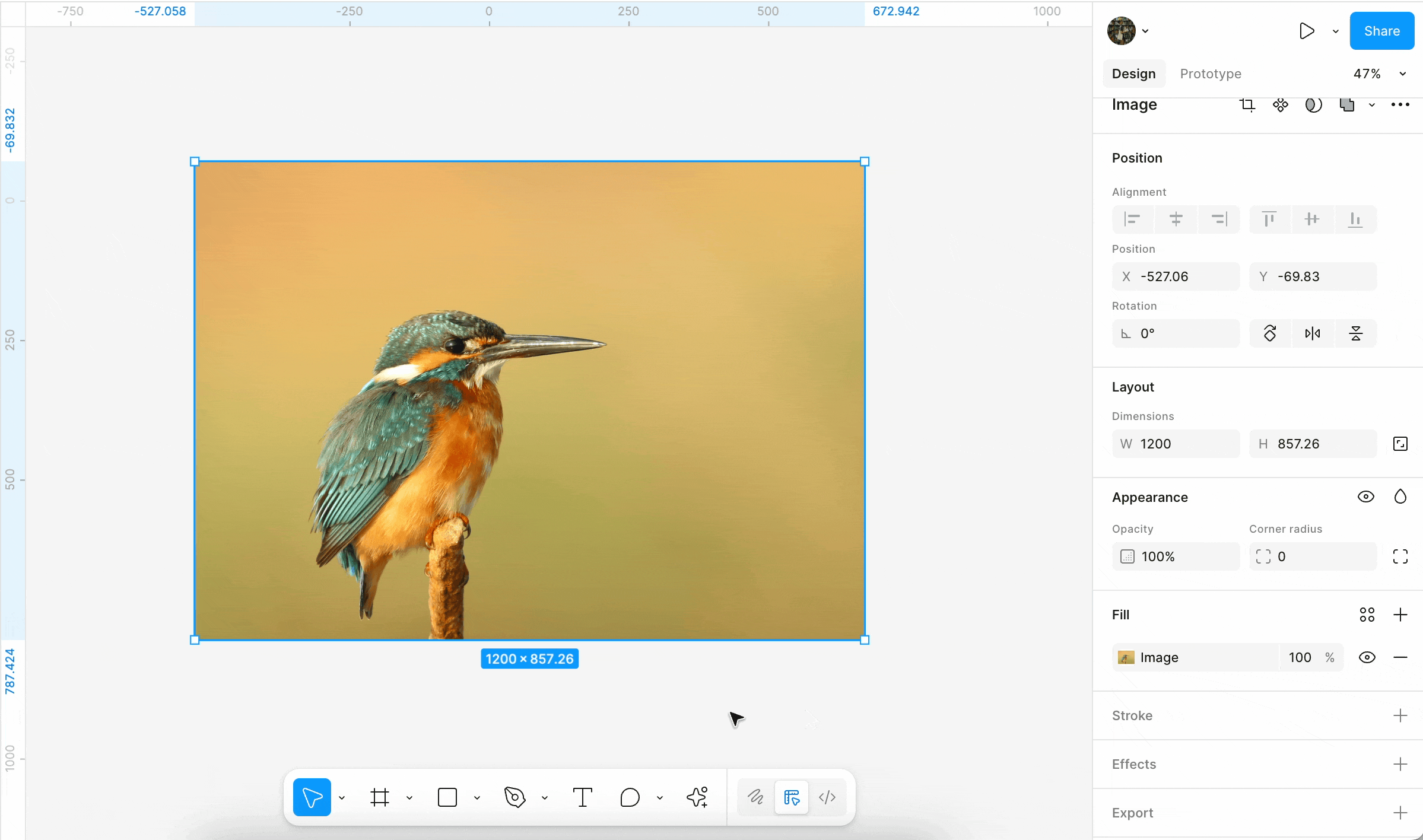

Images that scale
Because Figma applies images as fills, it’s not possible to adjust the scale or dimensions of the image itself. However, you can scale the object the image fills. Figma will scale and position the image based on the fill mode you selected.
The example below demonstrates how an image set to Fill will scale when the object it’s applied to is resized.

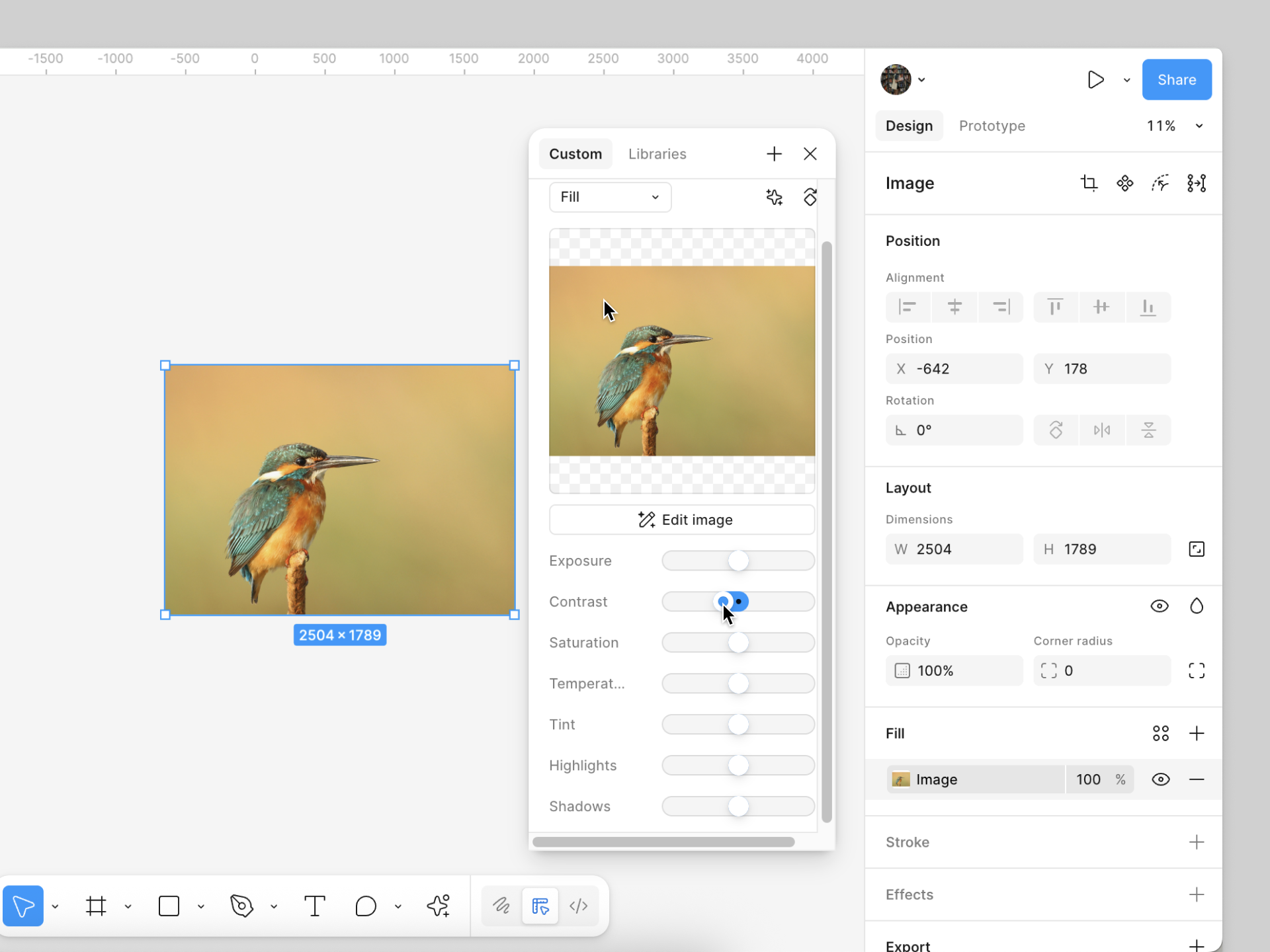

Image adjustments
You can use the adjustment sliders to modify how an image appears. These work similarly to filters you would see in photo editing software. Drag the handle to the left to apply a negative adjustment, or to the right to apply a positive adjustment.
Adjustments do not permanently alter the image and you can reverse or update these settings at any time.
Exposure
Traditionally, exposure indicates how much light reaches the sensor within a camera. Decrease the exposure to create a darker image, or increase it to add more light.
Contrast
Contrast refers to the difference between light and dark pixels within an image. Decrease the contrast to narrow the range of colors and create a muted image, or increase it to create a more vivid image with brighter highlights and shadows.
Saturation
Saturation allows you to adjust the intensity of colors within an image. Decrease the saturation completely to create a black and white image, or increase it to create an image with more intense, saturated colors.
Temperature
Temperature refers to the tone of an image. Decrease the temperature to create “cooler” images with blue undertones, or increase it to create “warmer” images with amber undertones.
Tint
Tint allows you to tint the colors within an image. Decrease the tint to make the image appear more green, or increase it to make the image appear more magenta.
Note: You can use Temperature and Tint together to adjust the white balance of the image.
Highlights
This allows you to isolate and adjust only the lighter areas of an image. You can use this to create more distinction between an image’s highlights and shadows. Decrease this setting to reduce the amount of light in the highlights, or increase it to create even brighter highlights.
Shadows
This allows you to isolate and adjust only the darker areas of an image. You can use this to create more distinction between an image’s highlights and shadows. Decrease this setting to reduce the level of light and create deeper shadows, or increase it to add more light and create brighter shadows.
