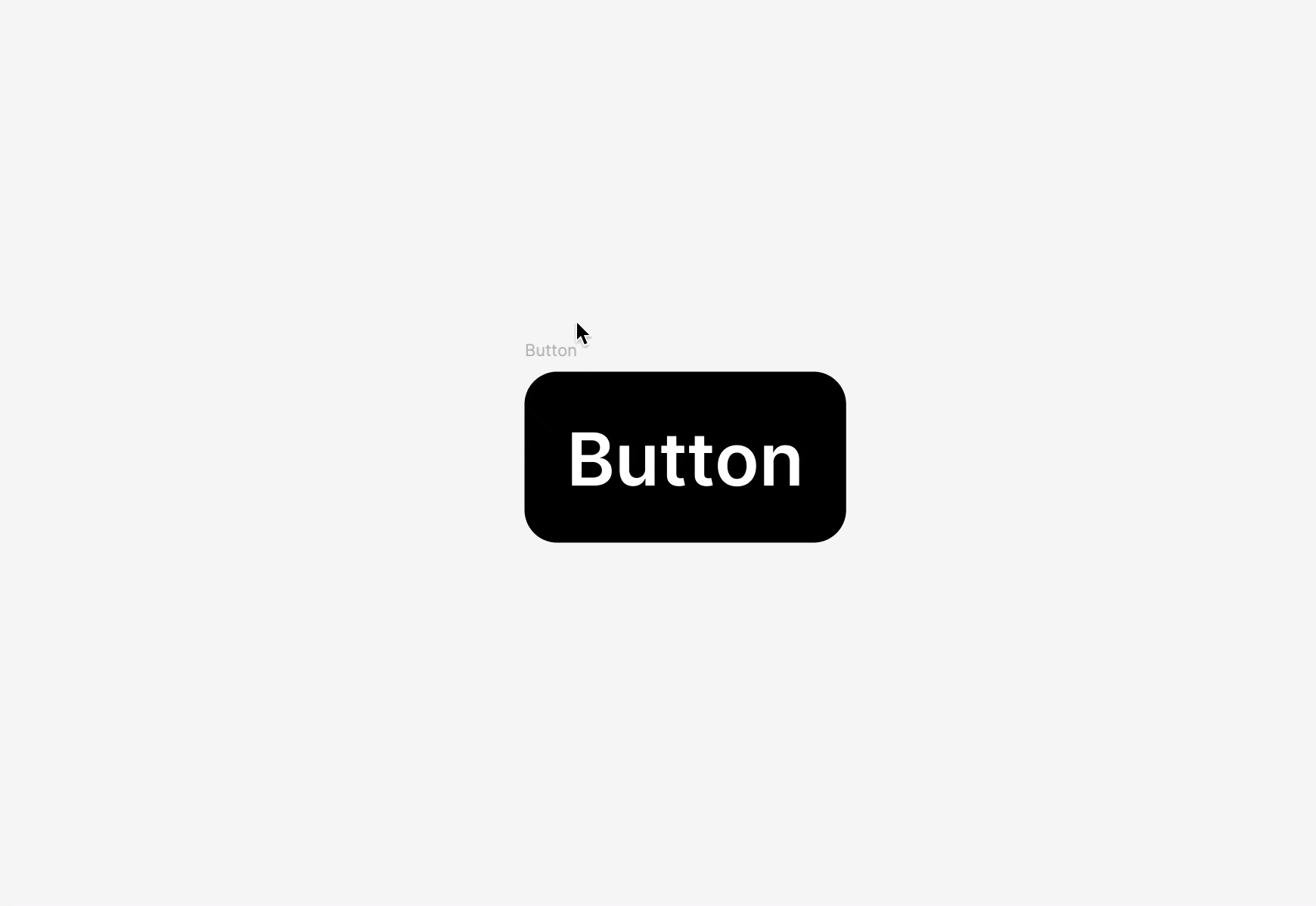

Now that we know more about auto layout, let's use it to create a button.

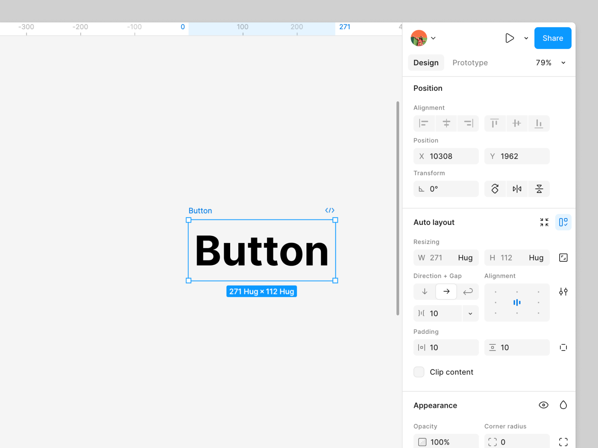

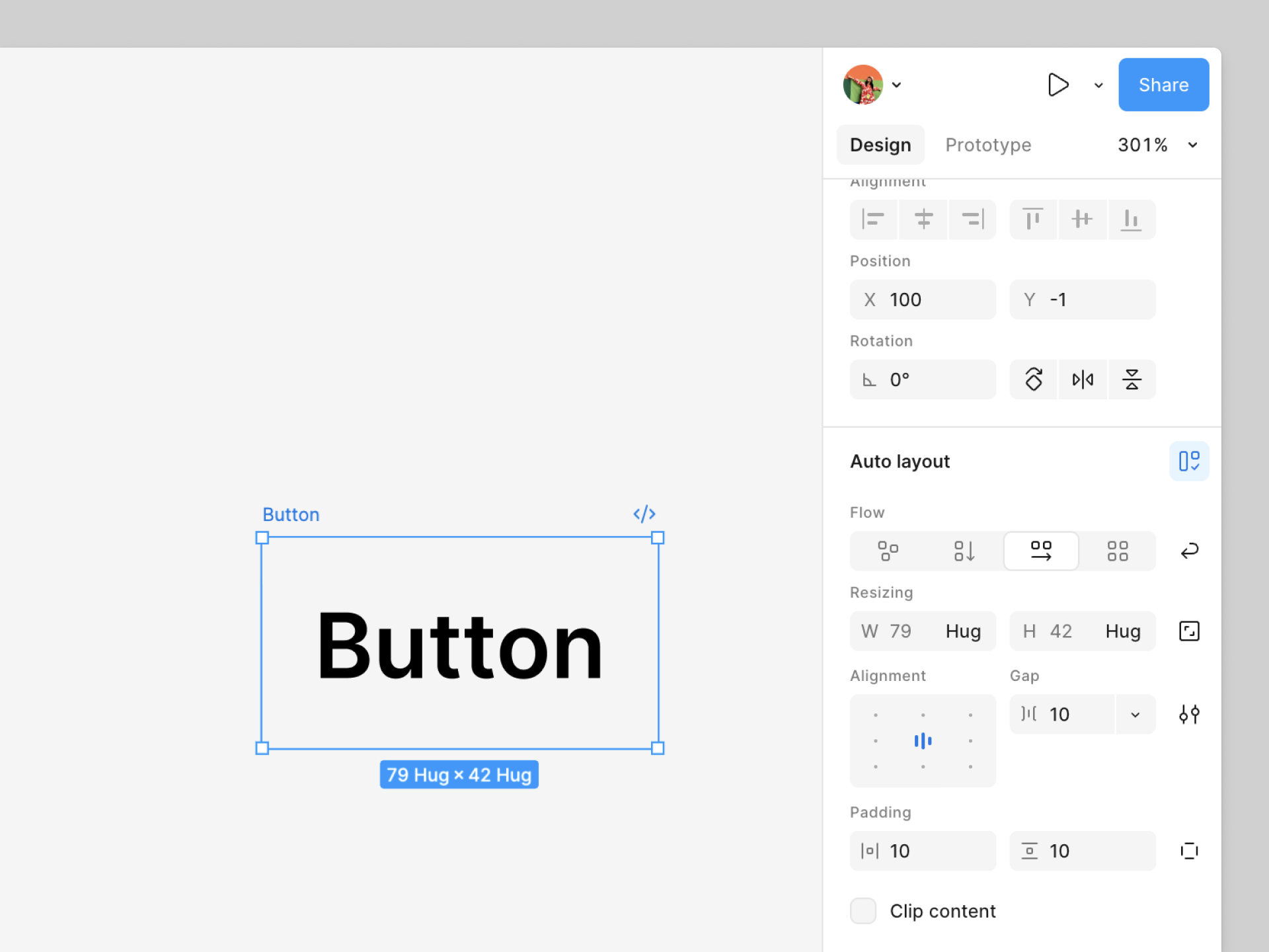

Add auto layout
Now we're ready to apply auto layout.
- Select the text layer.
 - Press Shift A. Figma will automatically create a new frame around the text layer with auto layout applied.
 - Double-click on the frame name and rename it to Button.

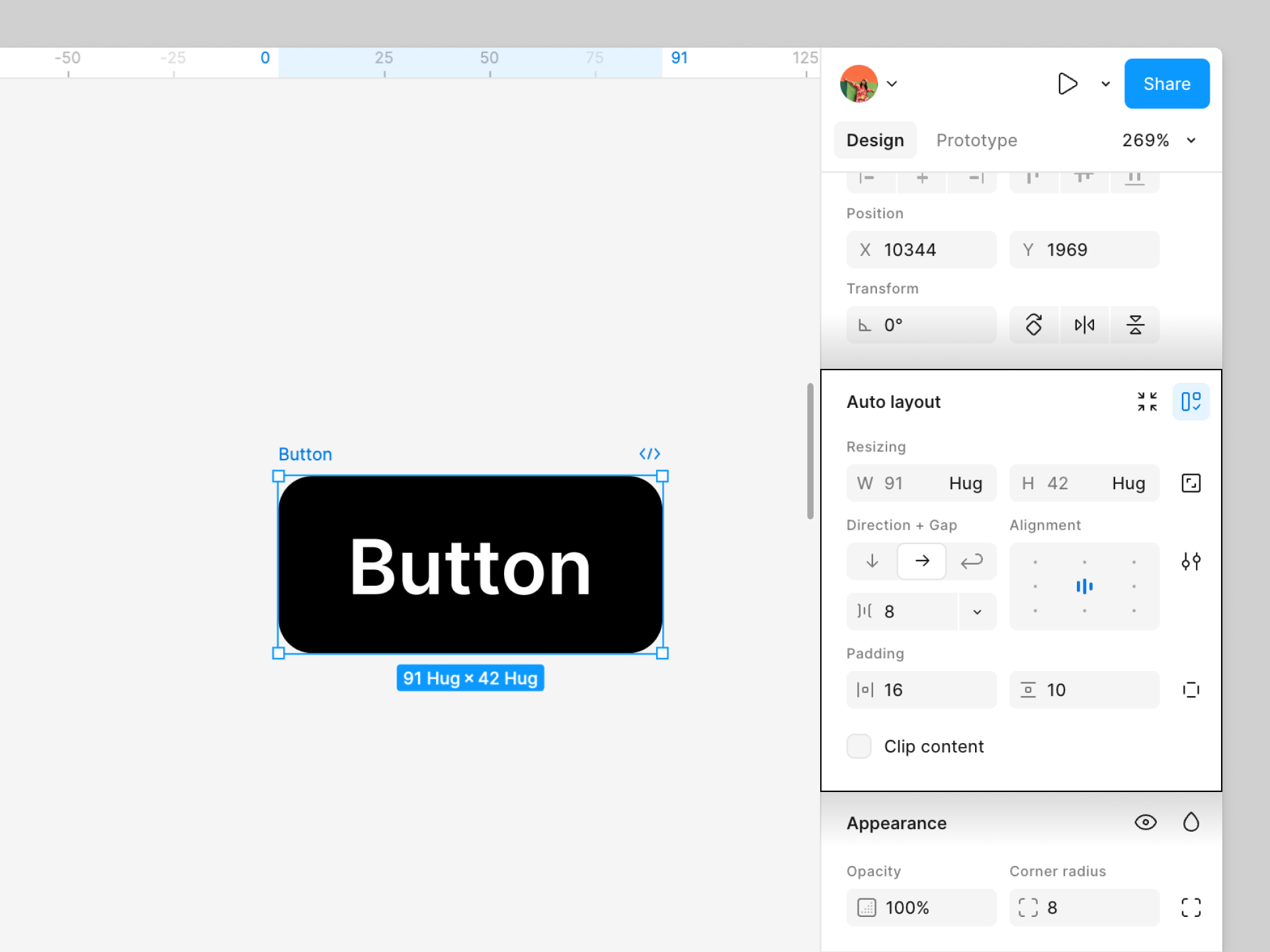

Adjust the auto layout properties
When you select the Button frame, you may notice that the section in the right sidebar changed to Auto layout and includes some additional properties. The Dimensions fields also changed and are now Resizing fields.
In addition to being able to set a fixed width and height for the frame, we now have the option to set the parent frame to Hug contents, which means that it will automatically resize as the button label grows or shrinks. Because we’ll use this button element again in different contexts, we’ll leave the resizing properties set to Hug contents for maximum flexibility. That way, if we need to change the button’s label, or translate it into a different language, we wont have to worry about manually resizing it.
Test it! See what happens when you change the button label to “Continue” or “Next”.
We'll adjust some of the other auto layout properties to customize how our button looks:
- Set the Horizontal gap between objects to
10. - Set the Horizontal padding to
16and the Vertical padding to10.
You may be wondering why Figma set the padding to 10 when we added auto layout. Figma automatically used our Big nudge preference, which is set to 10. If we had an existing frame around the text layer before applying auto layout, Figma would maintain the distance we had between the text layer and frame instead. Learn more about nudge settings.

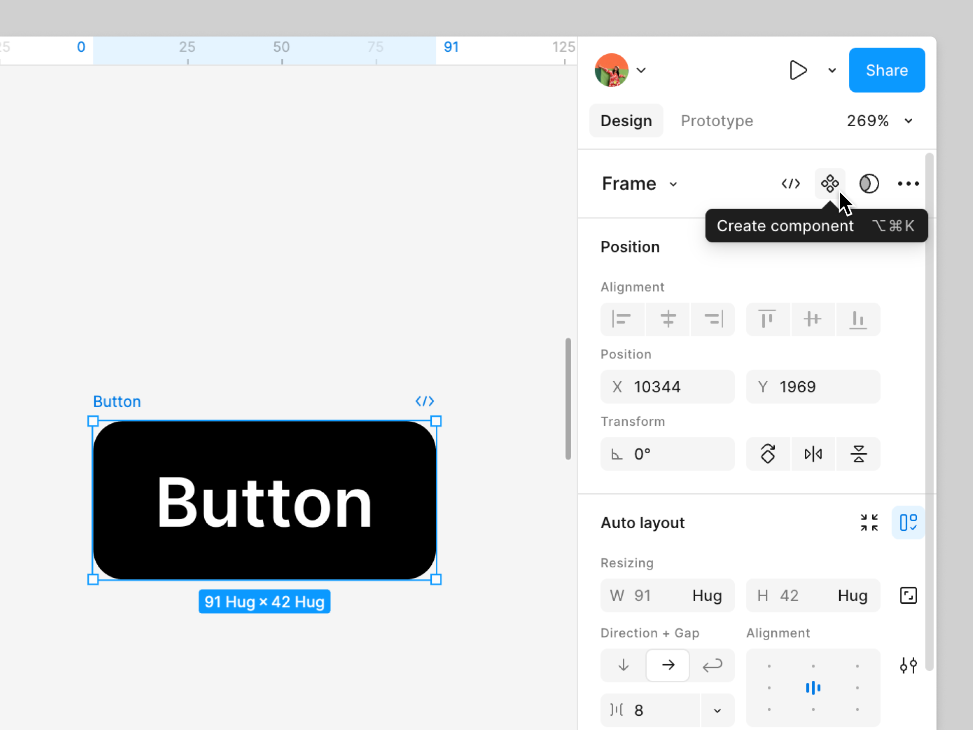

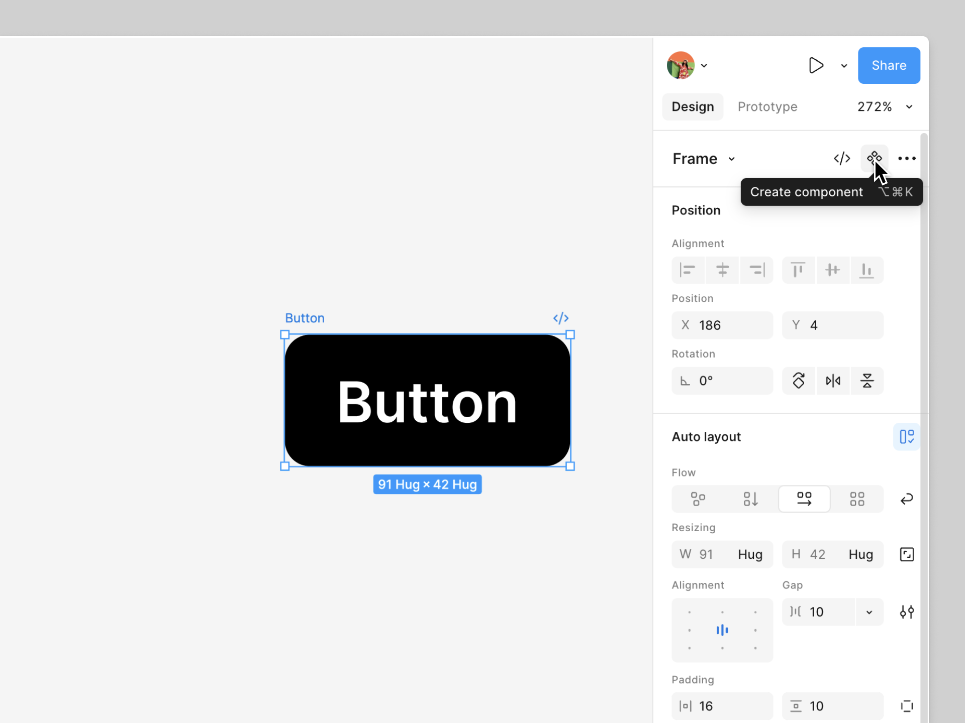

Turn the button into a main component
Since our final design will include several buttons, we'll turn this button into a main component.
- Select the Button frame.
 - Click Create component in the right sidebar.
You’ll notice the button is now inside a purple bounding box and the icon in the Layers section has also changed to a four diamonds icon. This indicates the layer is a main component. In the next chapter, we'll learn more about components and how we can use them to speed up our design workflows.
