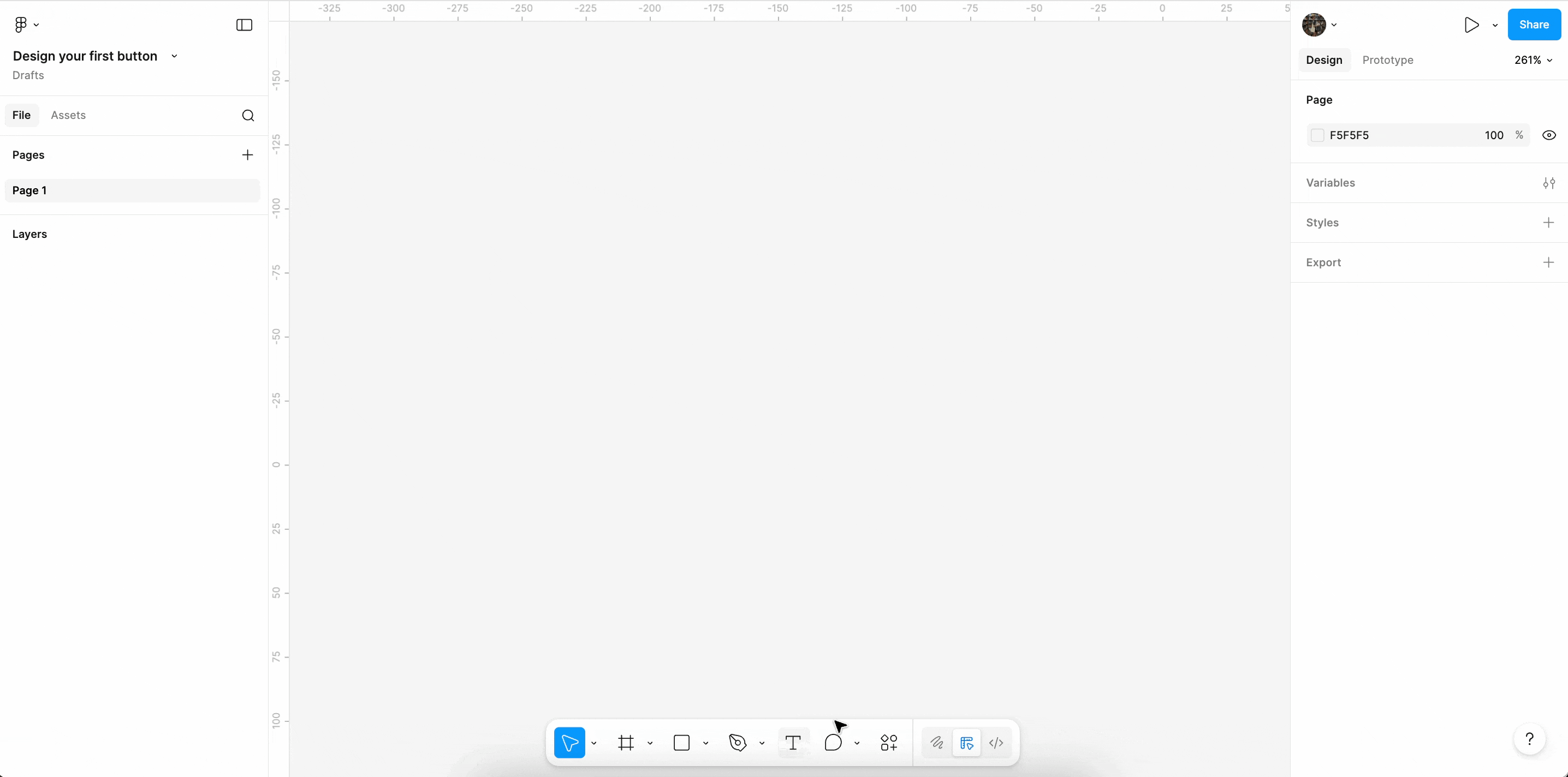

Add a text layer
We’ll begin by adding a text layer.
- Enable the Text tool from the toolbar or press T on your keyboard.
- Click anywhere on the canvas and type
Buttonto create a new text layer.
In the left sidebar, you’ll notice the Layers panel now has a new text layer called Button. Double-click on the layer and rename it to Label.

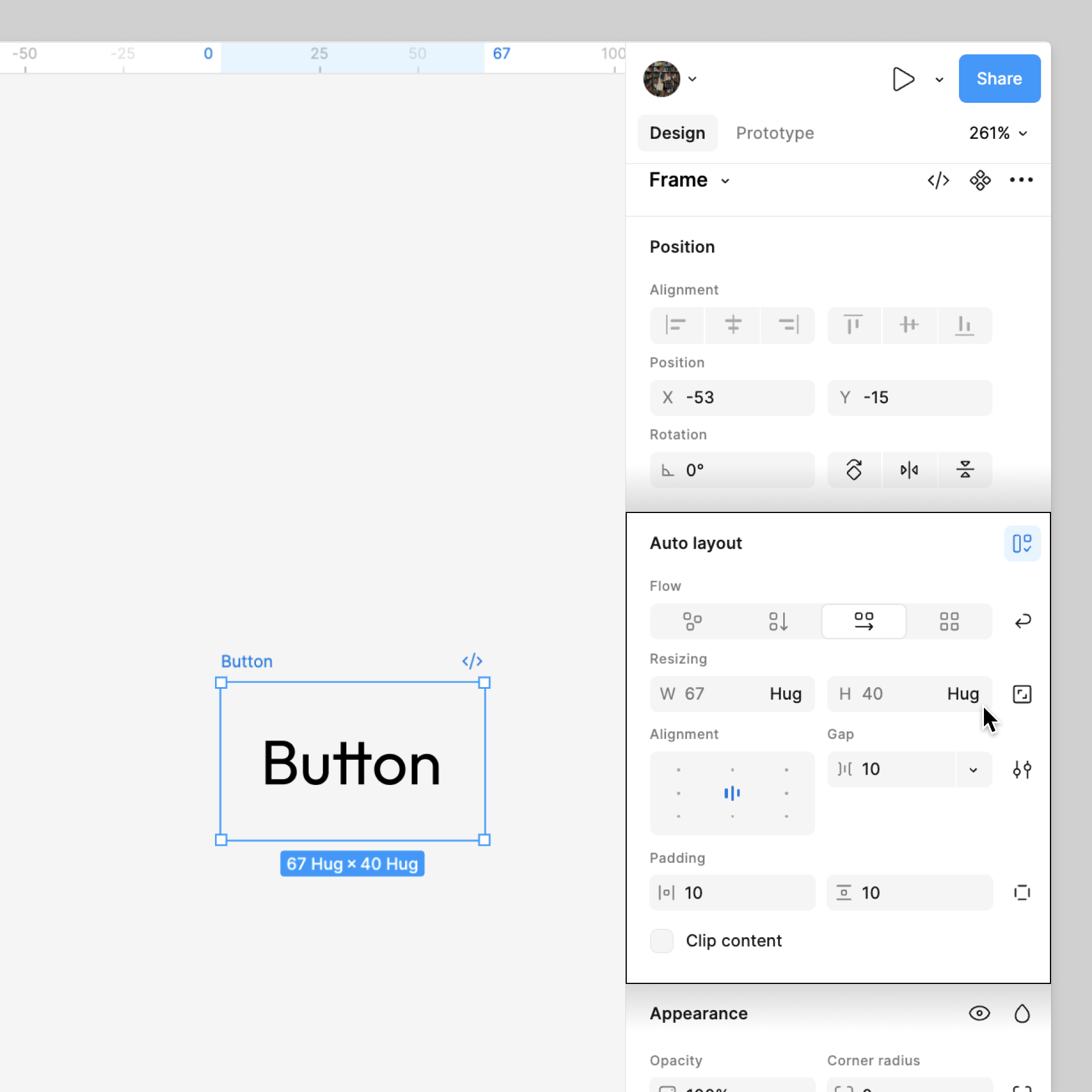

Apply auto layout
Our button isn’t looking too button-like yet, but we’re about to change that using auto layout!
Auto layout helps you organize, arrange, and space out design elements so that they adjust automatically as you make changes, saving you time and making your designs responsive and adaptable.
To apply auto layout:
- Select the
Labellayer. - Right-click on it and select Add auto layout or use the shortcut Shift A. This will add the text layer to a frame with auto layout applied.
- In the Auto layout section of the right sidebar, make sure the Horizontal resizing and Vertical resizing settings are both set to Hug contents. Setting the resizing to Hug contents ensures that the button frame will automatically grow or shrink when the label changes.
- Double-click on the new frame in the left sidebar and rename it to
Button.
Tip: Check out our Figma Design for beginners course for more hands-on learning opportunities.

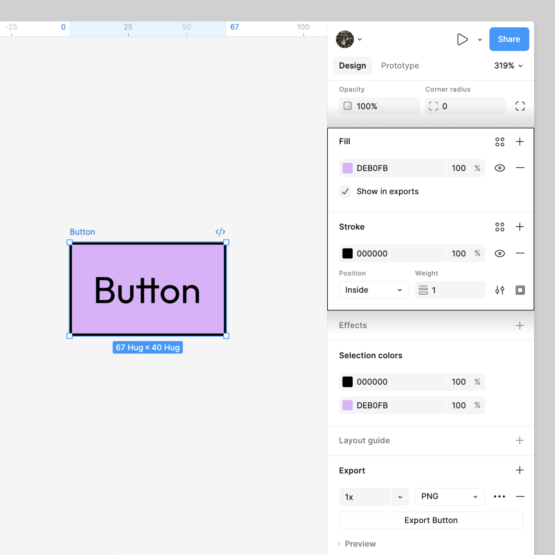

Style the button
When we applied auto layout, the existing text layer was added to a frame. This allows us to add visual properties like color, strokes, and effects to give our button some style.
Add a fill and a stroke
- Select the
Buttonframe and click the plus in the Fill section of the right sidebar to add a fill. - Use the color picker to change the color to
#DEB0FB. - Click the plus in the Stroke section of the right sidebar to add a stroke.
- Use the settings to configure the stroke:
Fill:
#000000 -
Position:
Inside -
Weight:
1
Fill:

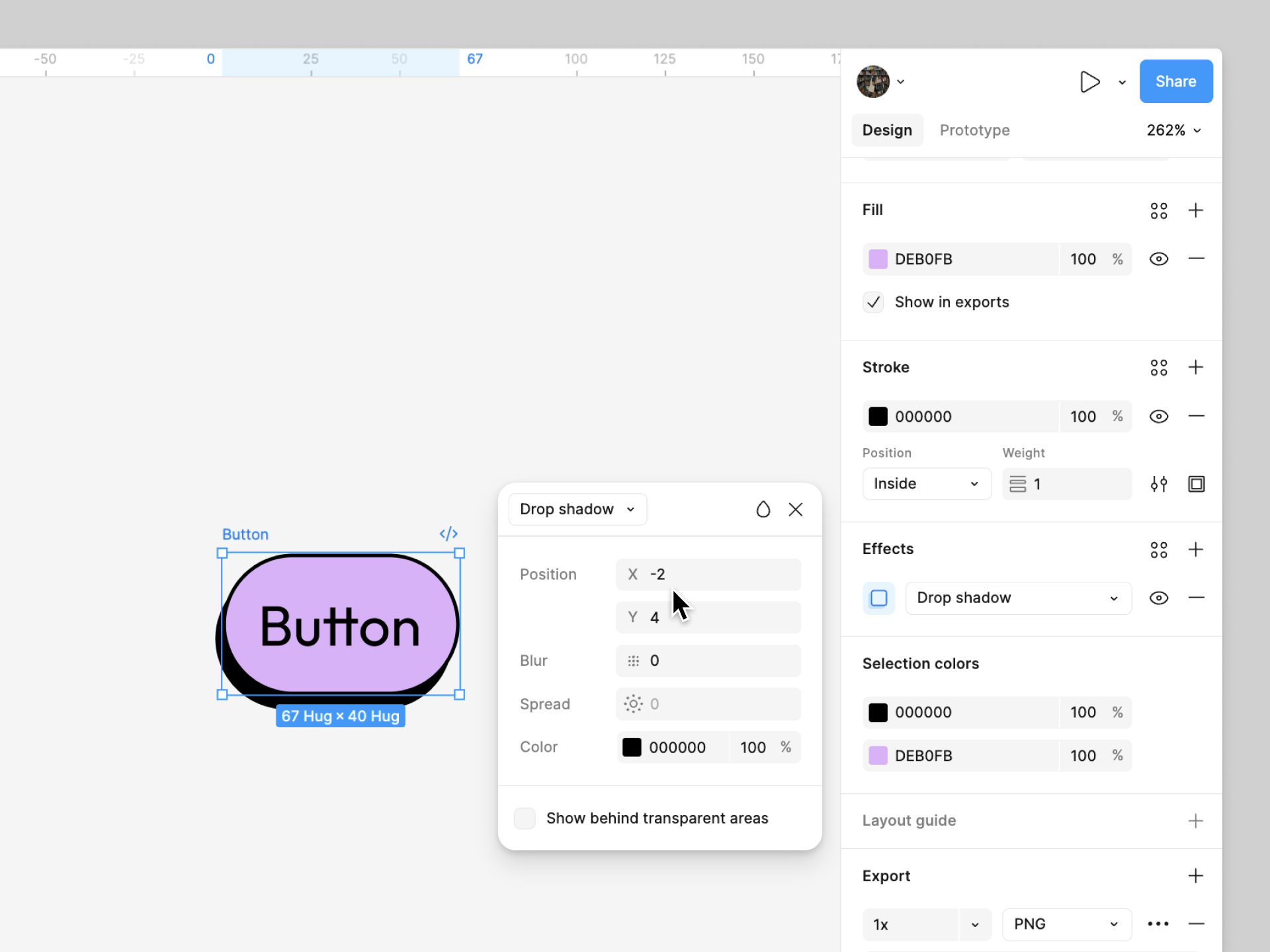

Apply a drop shadow
Applying drop shadows to buttons is an optional design choice, but one that can help enhance the clickable feel of a digital button.
To add a drop shadow:
- Select the
Buttonframe. - Click the plus in the Effects section of the right sidebar and choose Drop shadow from the dropdown menu.
- Use the settings to configure the drop shadow:
X-position:
-2 -
Y-position:
4 -
Blur:
0 -
Color:
#000000at100%opacity

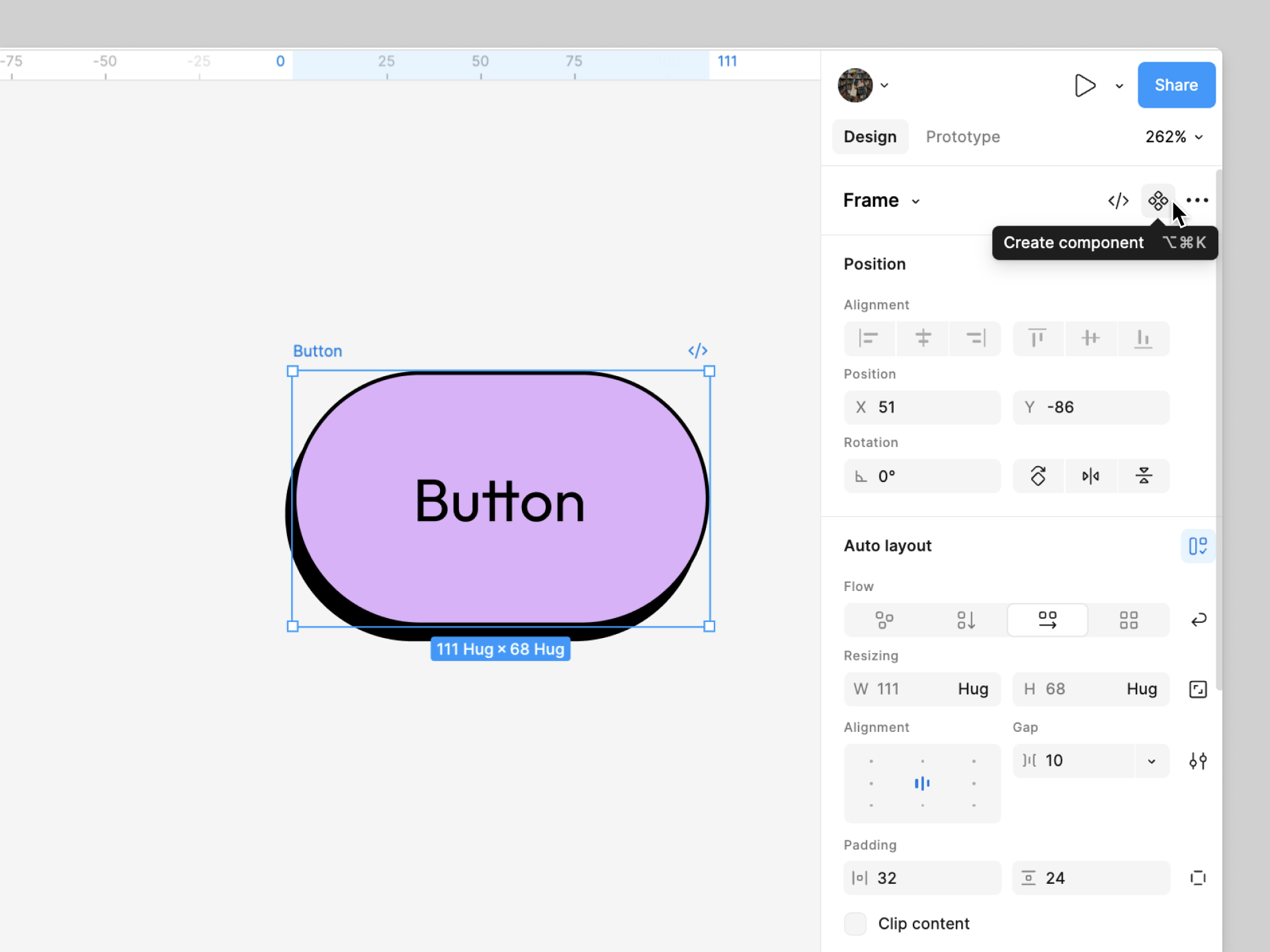

Refine the padding
When we applied auto layout, it automatically added padding between the frame’s boundary and the text layer inside. Right now, the padding is equal on all sides. Let’s update those values to create a chunkier button that will be easier to tap once we add it to our designs.
- Select the
Buttonframe. - In the Auto layout section of the right sidebar, change the Horizontal padding to
32and the Vertical padding to24.
Test out your button
The button looks great! Best of all, because we used auto layout, the button will resize based on the length of the label inside it. Test this for yourself by double-clicking on the text layer and typing Sign up or Continue.
Turn the button into a main component
It would be a shame to only use this beautiful button once. Luckily, we can turn it into a main component and reuse over and over again!
To create a main component:
- Select the
Buttonframe. - Click Create component in the right sidebar or use the shortcut:
- Mac: Option Command K
- Windows: Ctrl Alt K
If you take a look at the left sidebar, you’ll notice the Button layer is now identifiable by the purple component icon. Now you’ll be able to add instances of your button from the Assets tab in the left sidebar whenever you need! Learn more about using components.
