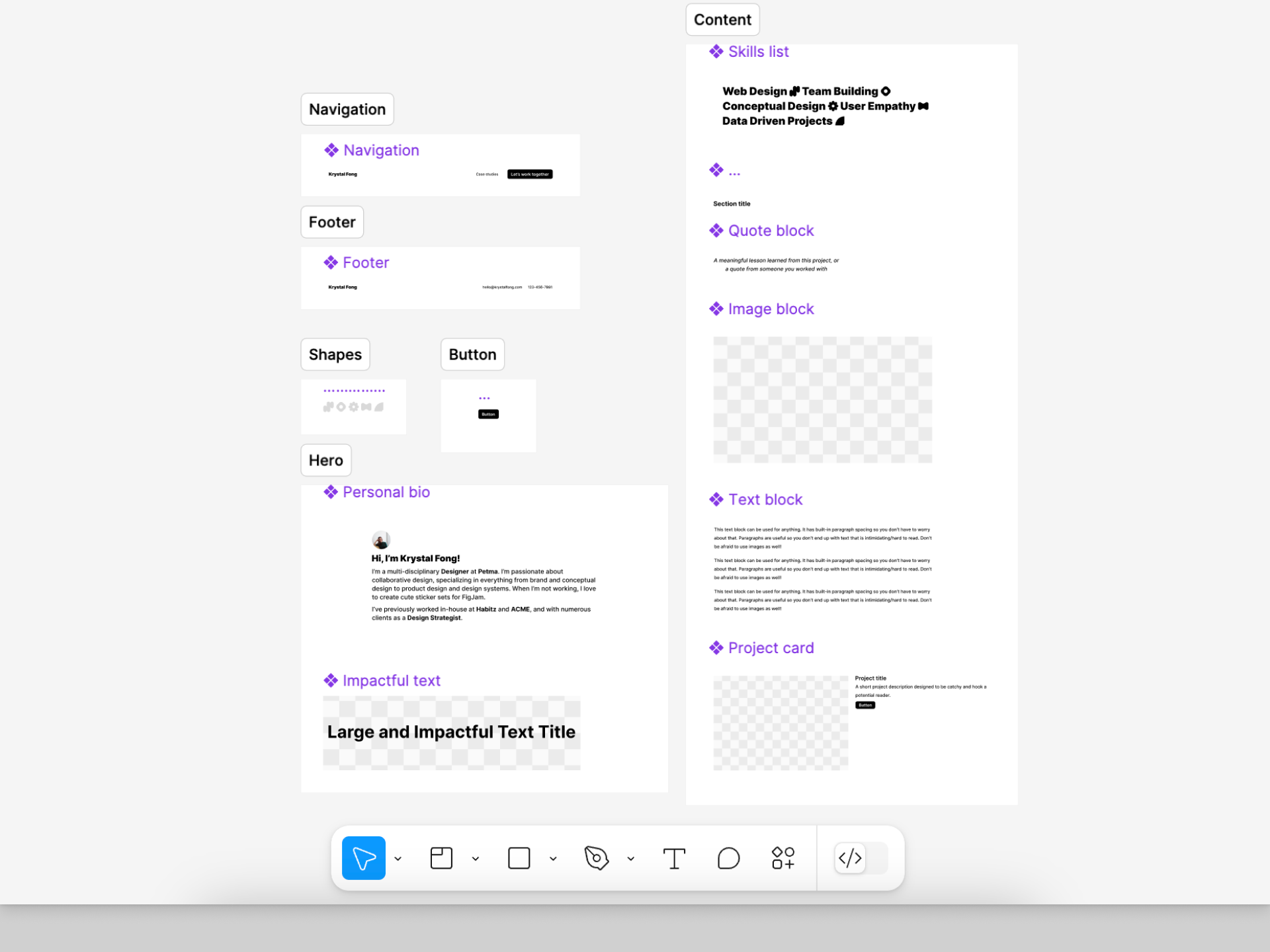

Organize the components page using sections
We’ll start on the Components page of our file. We’ve been moving our main components to this page throughout the course, but we haven’t organized them beyond that. Let’s organize our main components using sections.

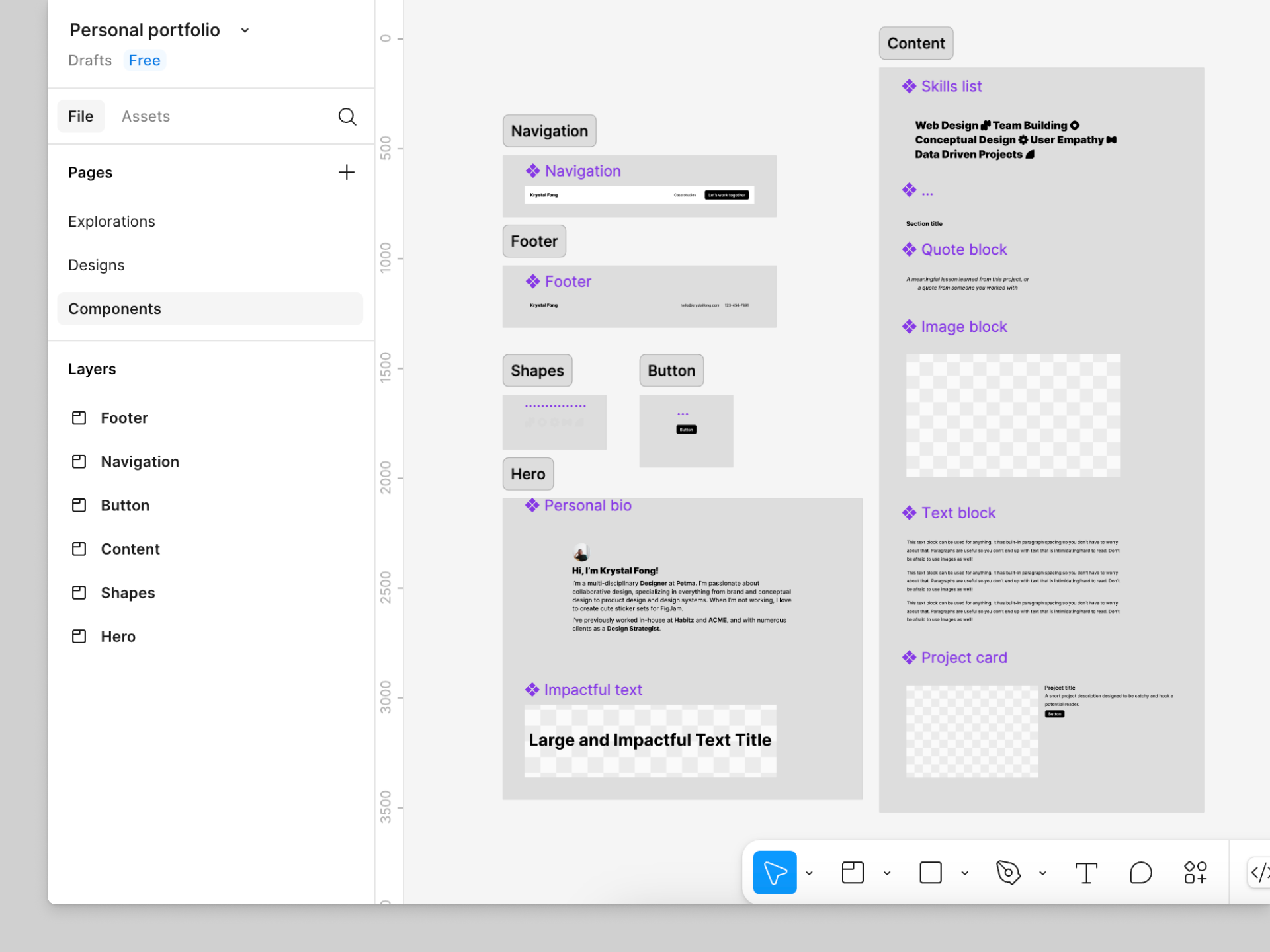

We learned a little bit about sections from our friends Kaitie and Lauren. Like frames, sections are a type of container layer that we can use to organize other layers. They are a great way to group related design elements, making it easier for collaborators to find what they need.
To create a section:

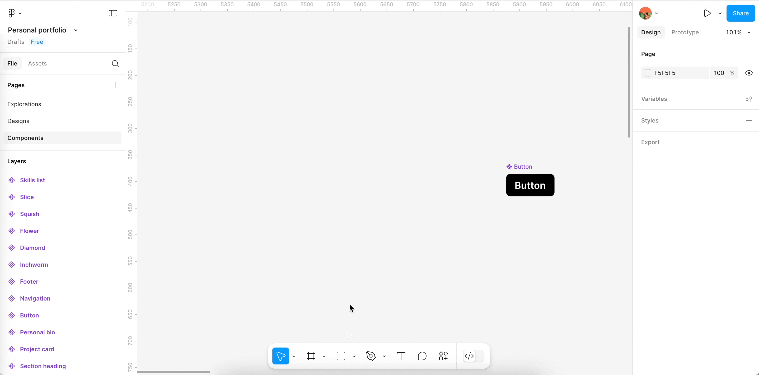

- Select the Section tool from the toolbar or press Shift S.
- Click and drag your cursor to add a section to the canvas.
Sections have a title field that you can use to give the section a label. Double-click on the field to rename it. We’ll call this first section Button
. Bet you can guess which element we’re going to add here. Select the Button main component and drag it into the section.
Tip: You can also click and drag to create sections over objects to place them inside.
We can also add multiple layers to a section at the same time. The two hero elements—the Personal bio and the Impactful text block—serve a similar purpose so let’s add them to the same section.
- Select the Personal bio and the Impactful text block main components.
- Right-click on the selection and choose Wrap in new section. Rename this section to Hero.
Tip: Placing components in sections also organizes them in the Assets tab.
We're going to add individual sections for the navigation bar, footer, and the custom shapes, and a larger section for the remaining components. Feel free to use a different organization structure. Just make sure that all of your components are inside a section before moving on.
You might also want to change the background color of your sections, which also updates the thumbnail background behind components in the Assets tab. Use this to improve color contrast and make components easier to scan and find.

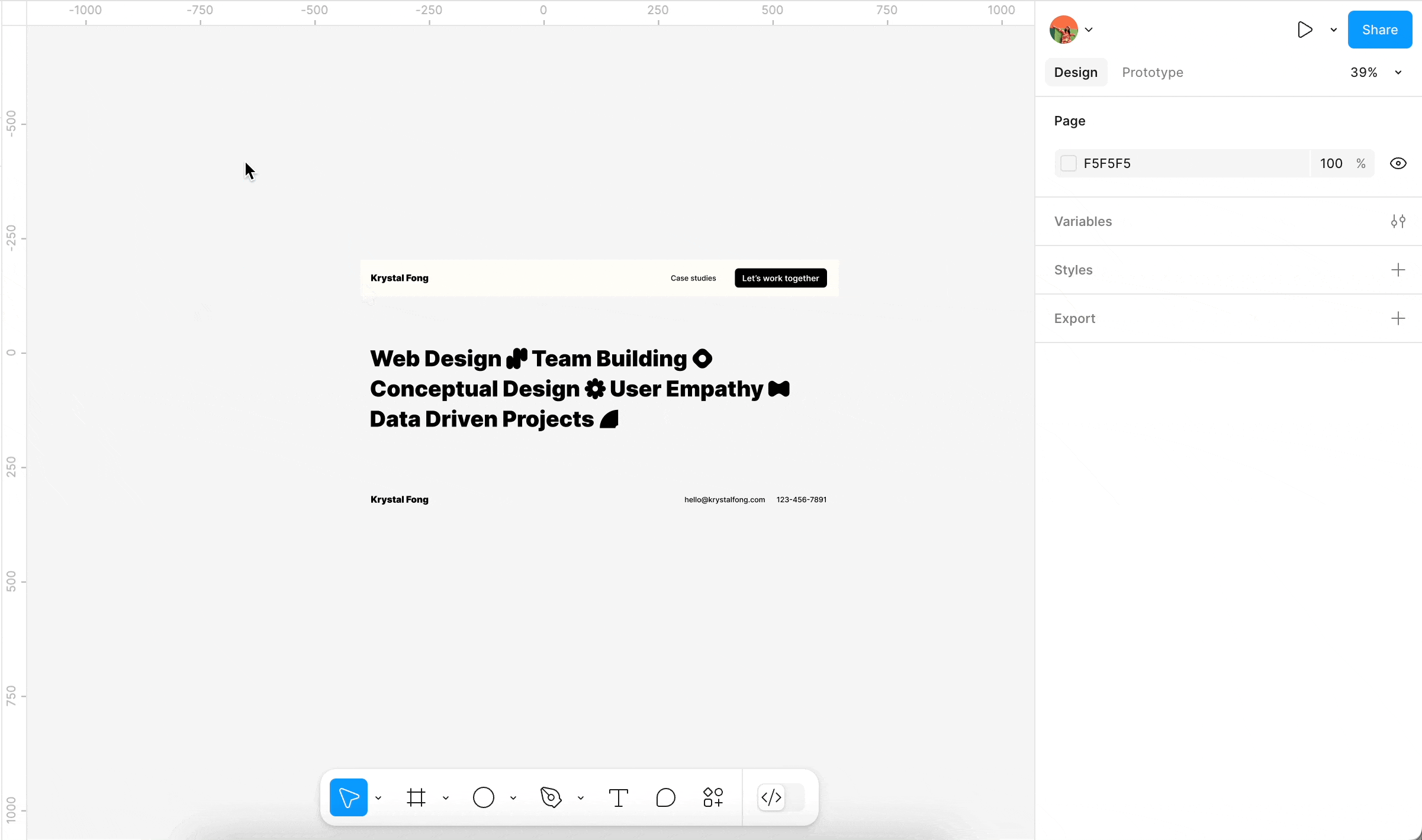

We’re planning to create two pages for our portfolio site, and they each have three parts in common. The Navigation bar, the Skill list, and the Footer.

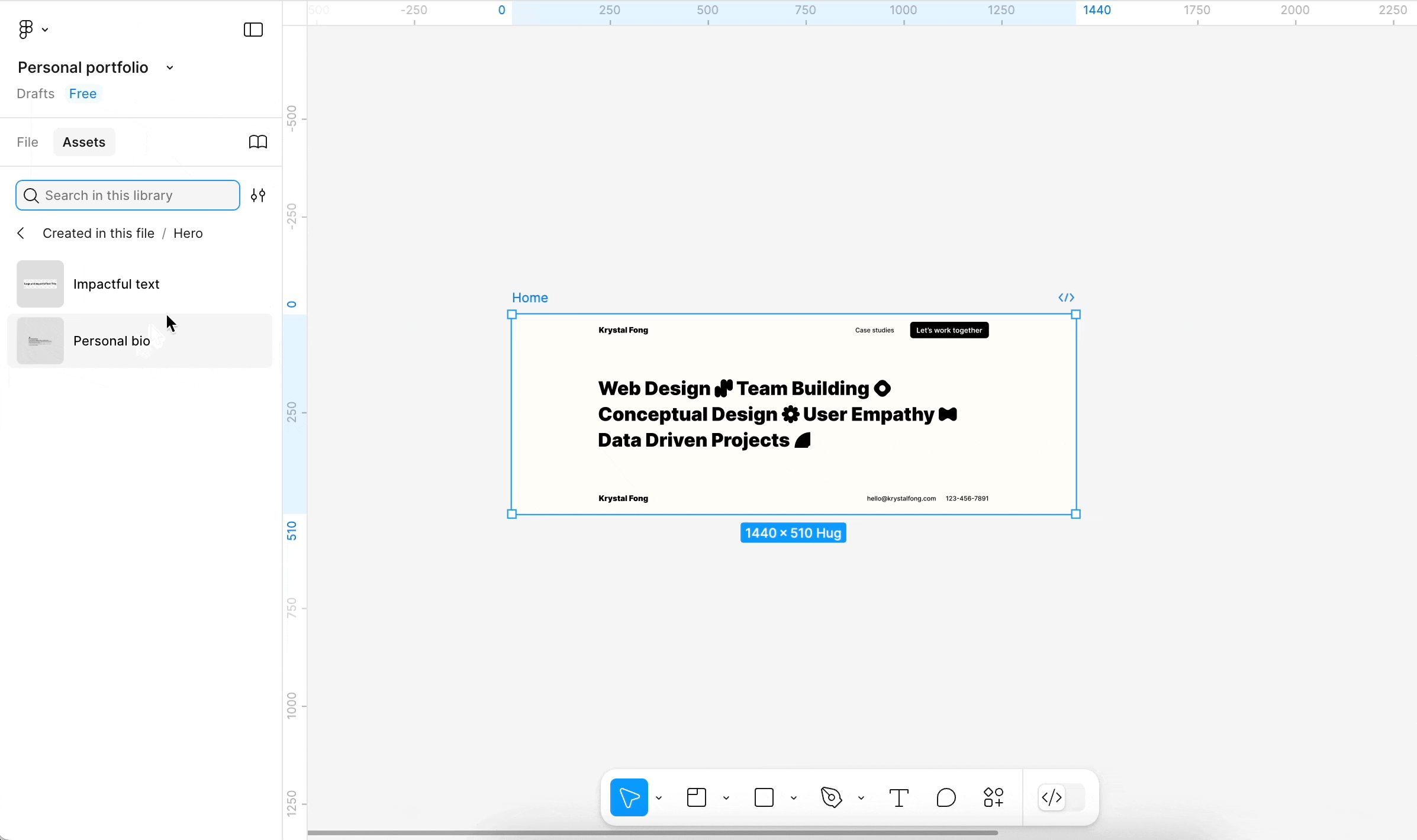

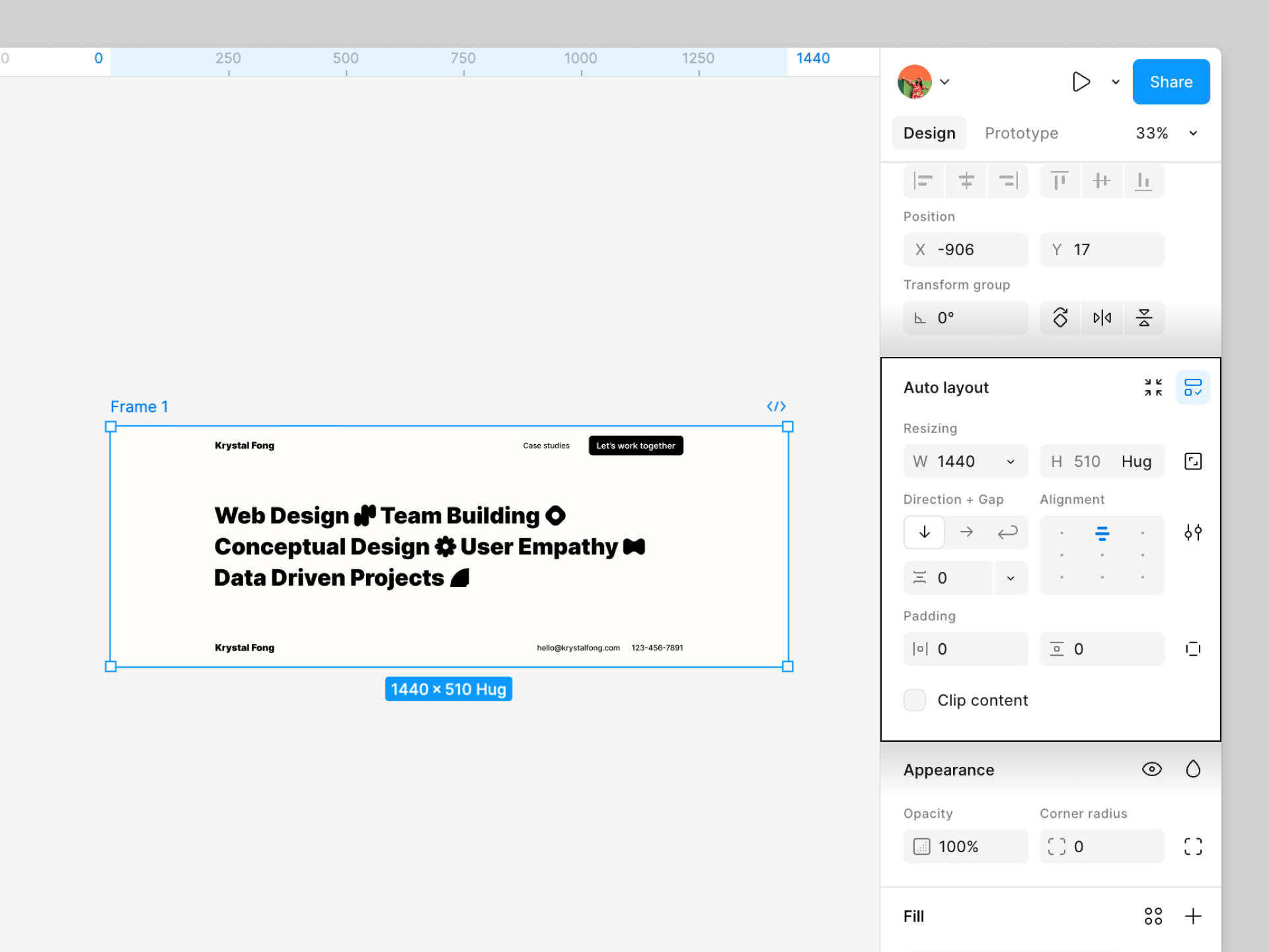

Let’s drag out instances of each of these components from the Assets tab and arrange them on the canvas. Then, select them and press Shift A to add them to an auto layout frame. Give the frame the same background color as the navigation bar: FFFDF8
Set the new frame's Width resizing to a Fixed width of 1440
. Make sure the Height resizing is set to Hug contents so it will grow as we add more stuff to our page. The Gap and Padding values should both be 0
(zero).
Since out portfolio will have two pages, let's duplicate this frame. Name one frame Home
and the other Case study
Don’t worry if your components don’t stretch the full width of the frame yet. We’ll update that later. But, feel free to update them now so now if you remember how!
Build the home page
Now comes the fun part—building our page layouts! Starting with the home page.

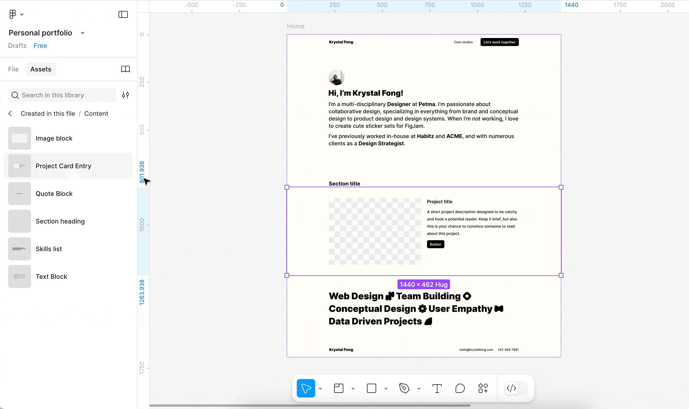

Drag an instance of the Personal bio main component into the Home page frame, and position it between the navigation bar and the skills list, and watch as they automatically adjust to accommodate the new content.
All of the work we did earlier to make these building blocks are making this a seamless drag-and-drop experience. Imagine how easy this would be if you were collaborating with a team, since they’d be able to leverage the work that went into these components and move much more quickly when building out their own pages.
Let’s add the rest of the content to our home page, including a section heading and a few project cards. You can add additional cards either by dragging in new instances from the Assets tab, searching for them in the actions menu, or by duplicating an existing instance. No matter which method you use, the frame will grow to accommodate the new content because its Height resizing is set to Hug contents.
If you want to experiment with a different flow on your page, you can also reorder elements by clicking and dragging them inside the frame or by selecting one and using your arrow keys.

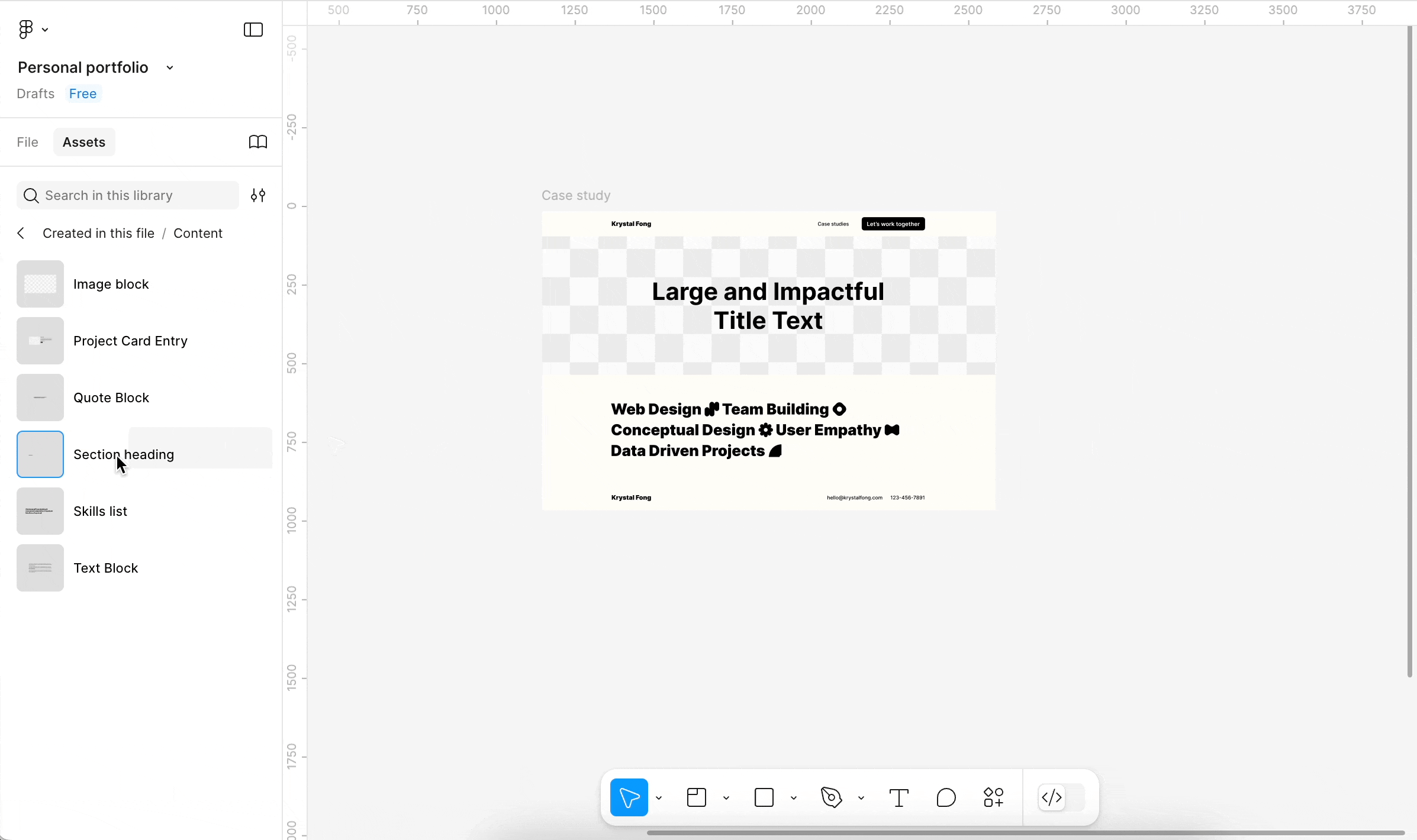

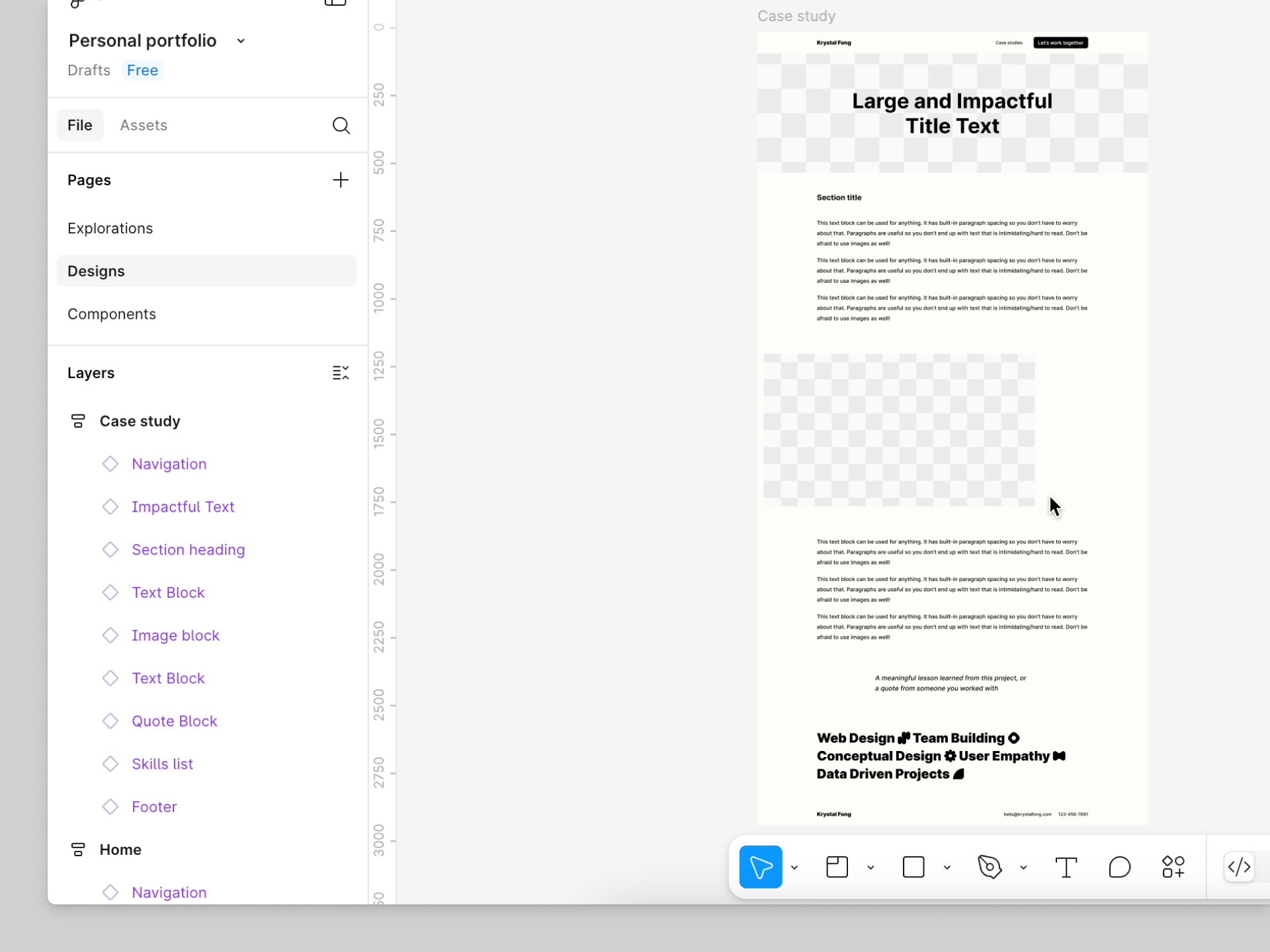

We’ll start by adding an instance of the Impactful text component to the top of the page below the nav bar.
Then, follow it up with a mix of paragraph text blocks, section headings, images, and a quote block. Choose the components that work best for you and your story. If you’re not sure what story you’d like to tell, feel free to pause and think about it! You can also check out some case studies published on Figma’s blog, Shortcut, for inspiration.
Tip: If you're new to product design, check out the Shortcut blog post Breaking in: A guide to landing your first product design role.
Remember that the page layout isn’t set in stone and you can easily remove elements or add new ones, if needed.
Once you’re feeling good about how your page is shaping up, select the Case study frame, press Enter
to select all the child layers, and change their Width resizing to Fill container.

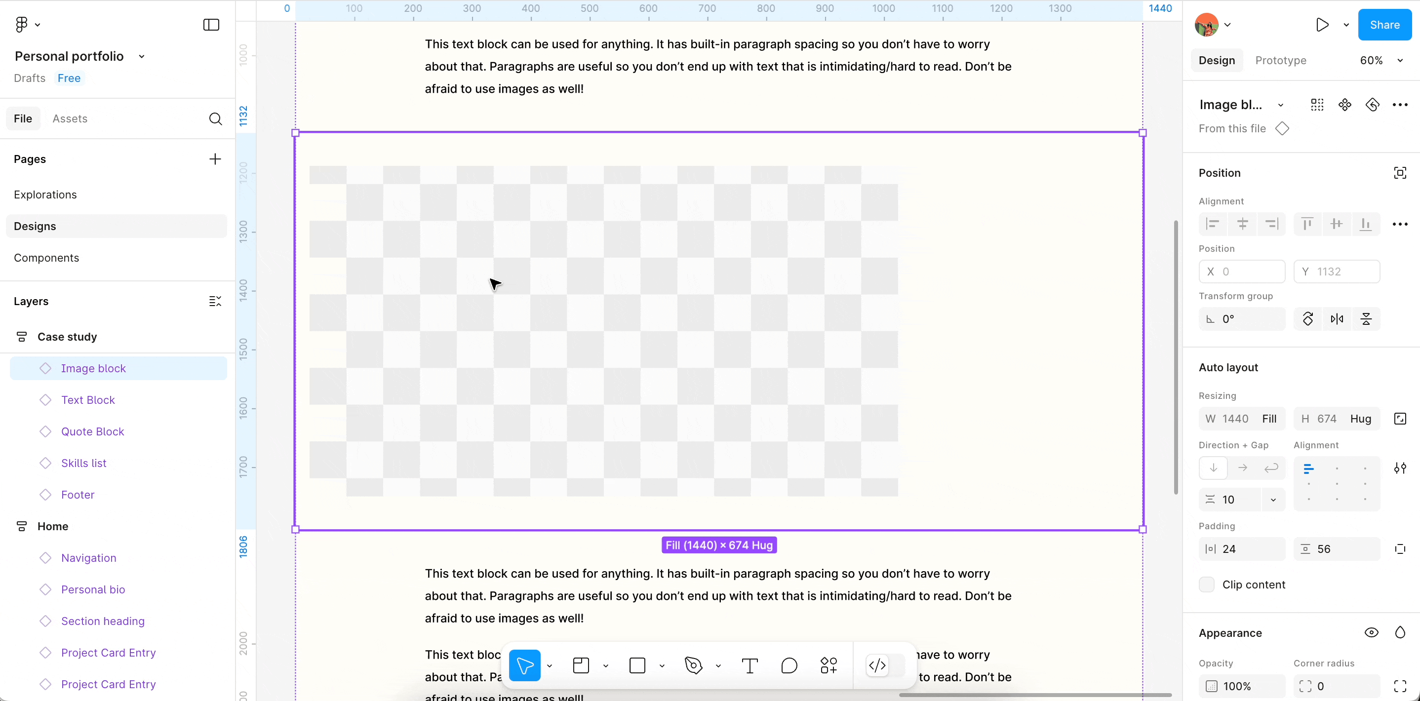

Oh wait, it looks like our image block component is still left aligned instead of center. Let's see what's going on here.

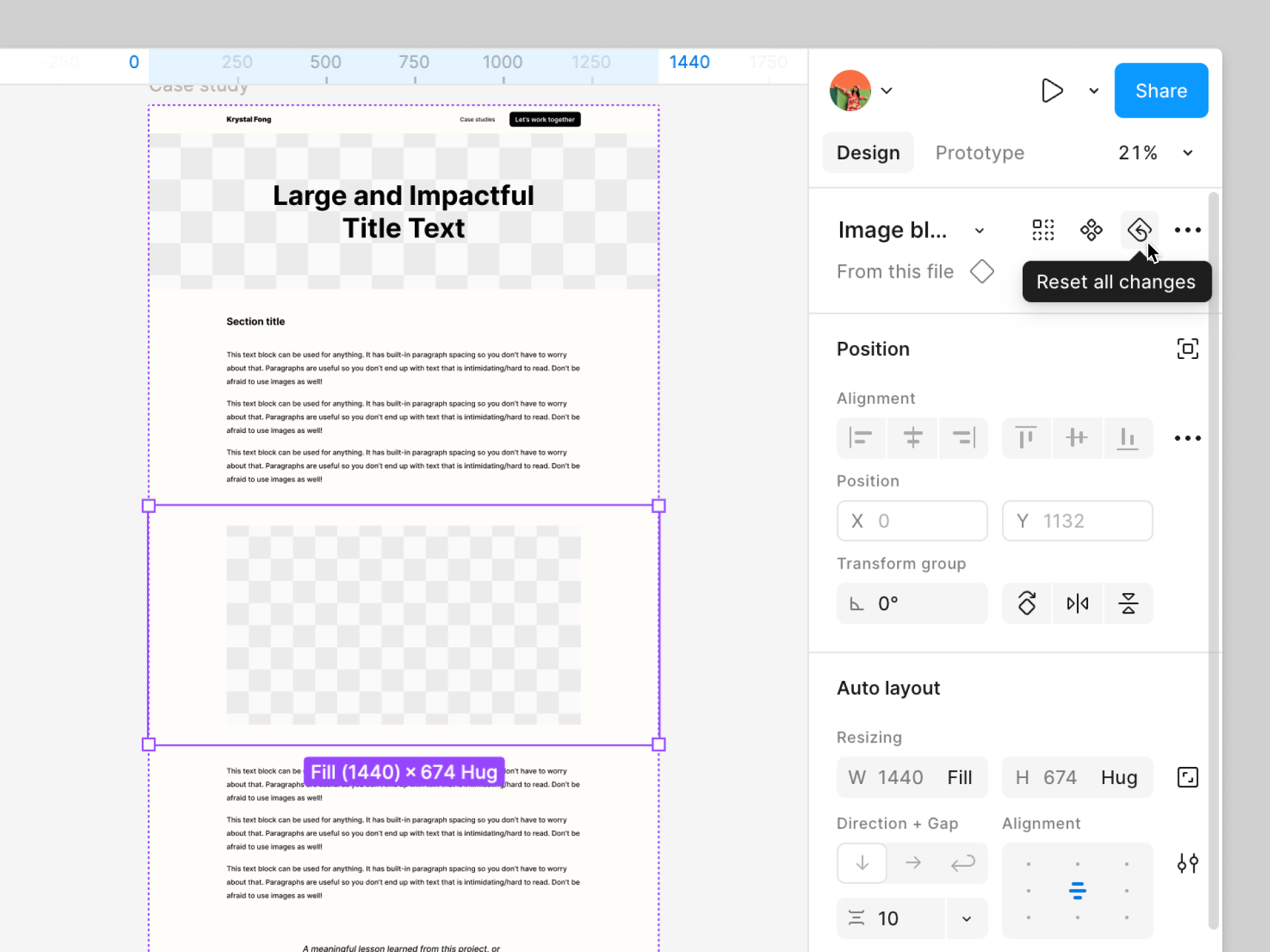

Right-click on the instance and select Go to main component. It looks like the alignment is set to Align top-left. Let’s update that to Align center. Then click Return to instance to quickly jump back to the Designs page.
Now the image block instance’s alignment should also set to Align Center. If you’re not seeing the instance update, go to the Instance menu and select Reset all changes.
