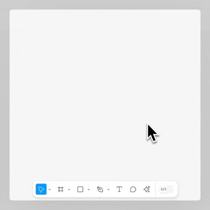

Toolbar and shortcut
- Click Section in the toolbar or use the keyboard shortcut ⇧ Shift S.
- Click and drag the location of the canvas where you’d like the section to go.
You can also click and drag a section over the objects you want to add to it.

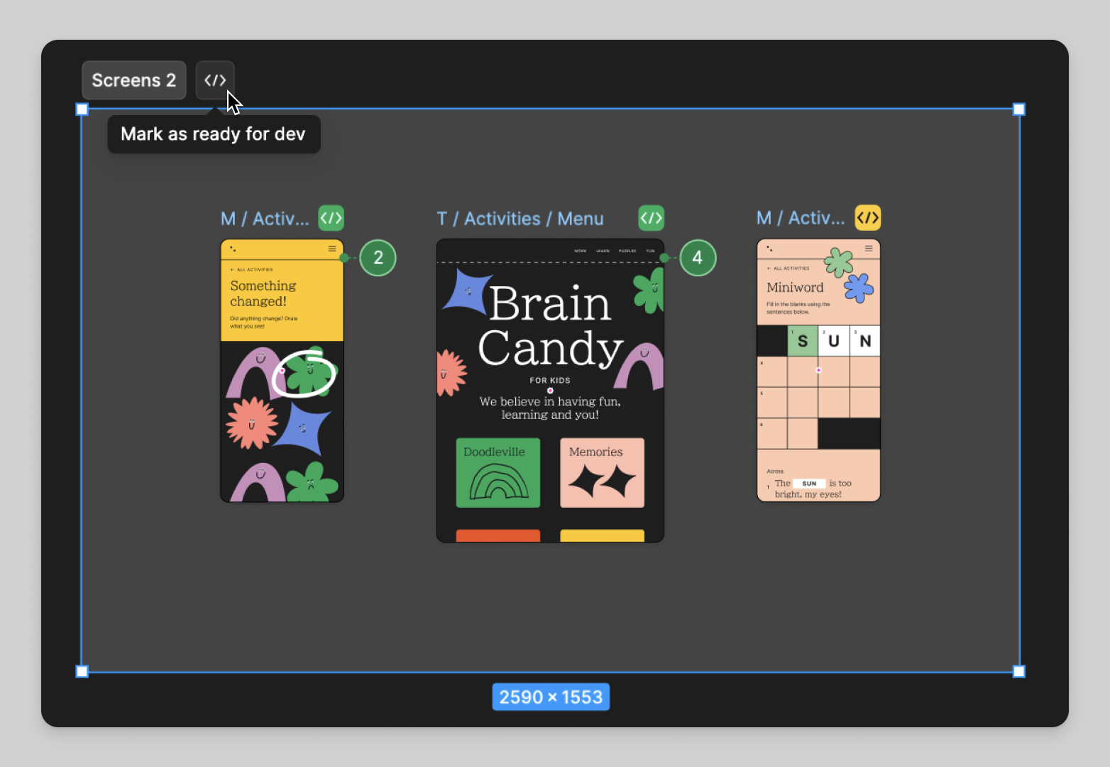

Mark a section as ready for development
Once content inside a section is finalized, you can mark the section as ready for development. This helps developers using Dev Mode by flagging the section for them.
To mark a section as ready for development:
- Select the section.
- Click Mark as ready for dev.
- To unmark a section as ready for dev, click the three dot menu in the Ready for dev label and select Remove ready status.

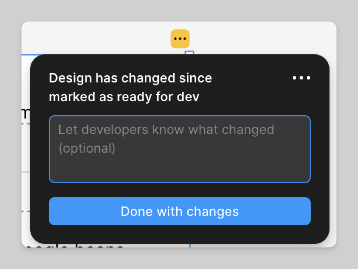

Update the dev status
After you’ve marked the a section Ready for dev, if you make changes to the design, Figma automatically changes the dev status to Changed. The Changed status helps developers keep track of designs that iterate after being marked as ready for development.
To resolve the changed status for a section, click the Changed status indicator and enter a reason for the change. After, the dev status is returned to Ready for dev.
